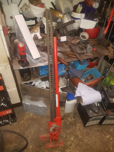

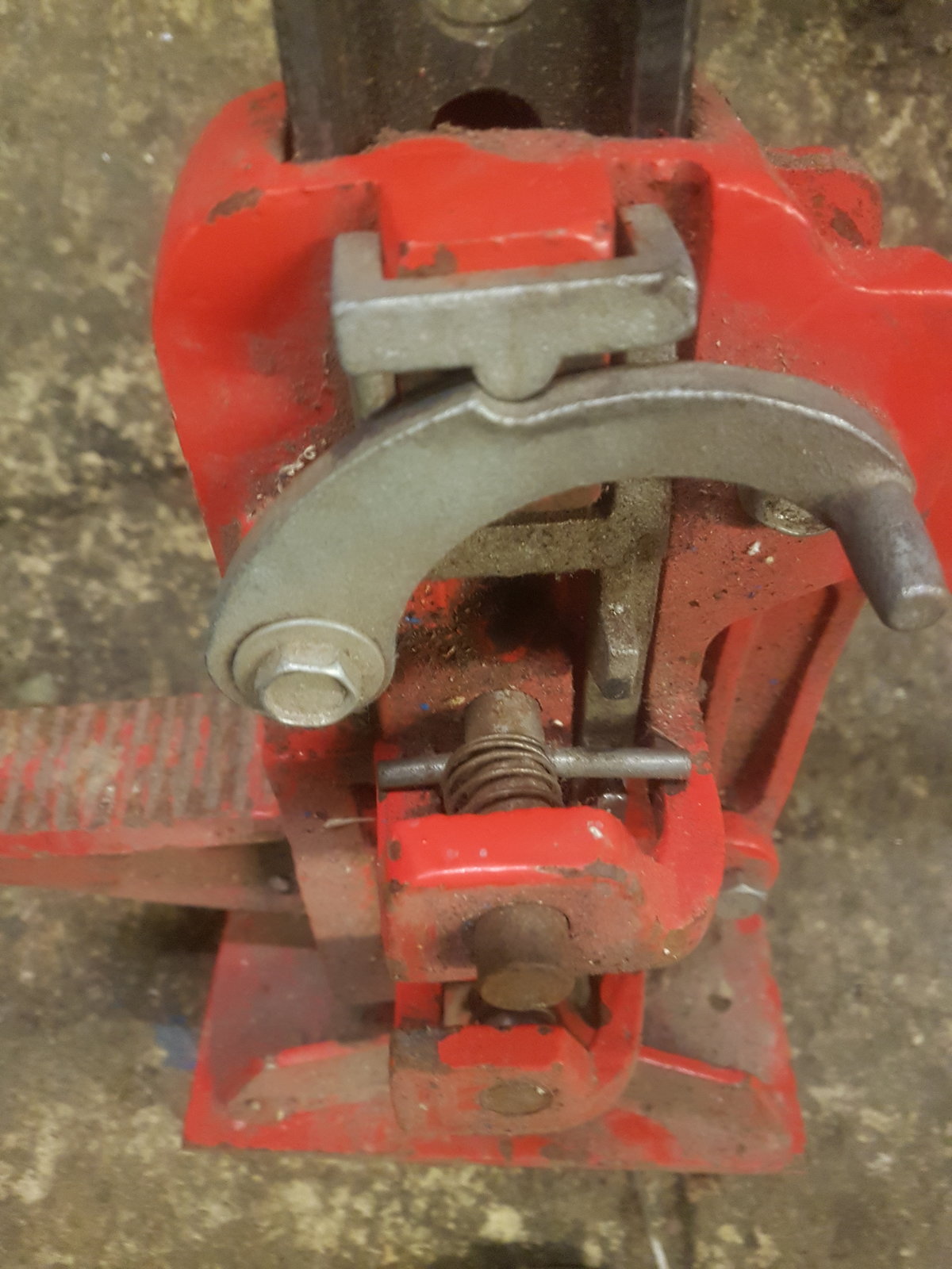

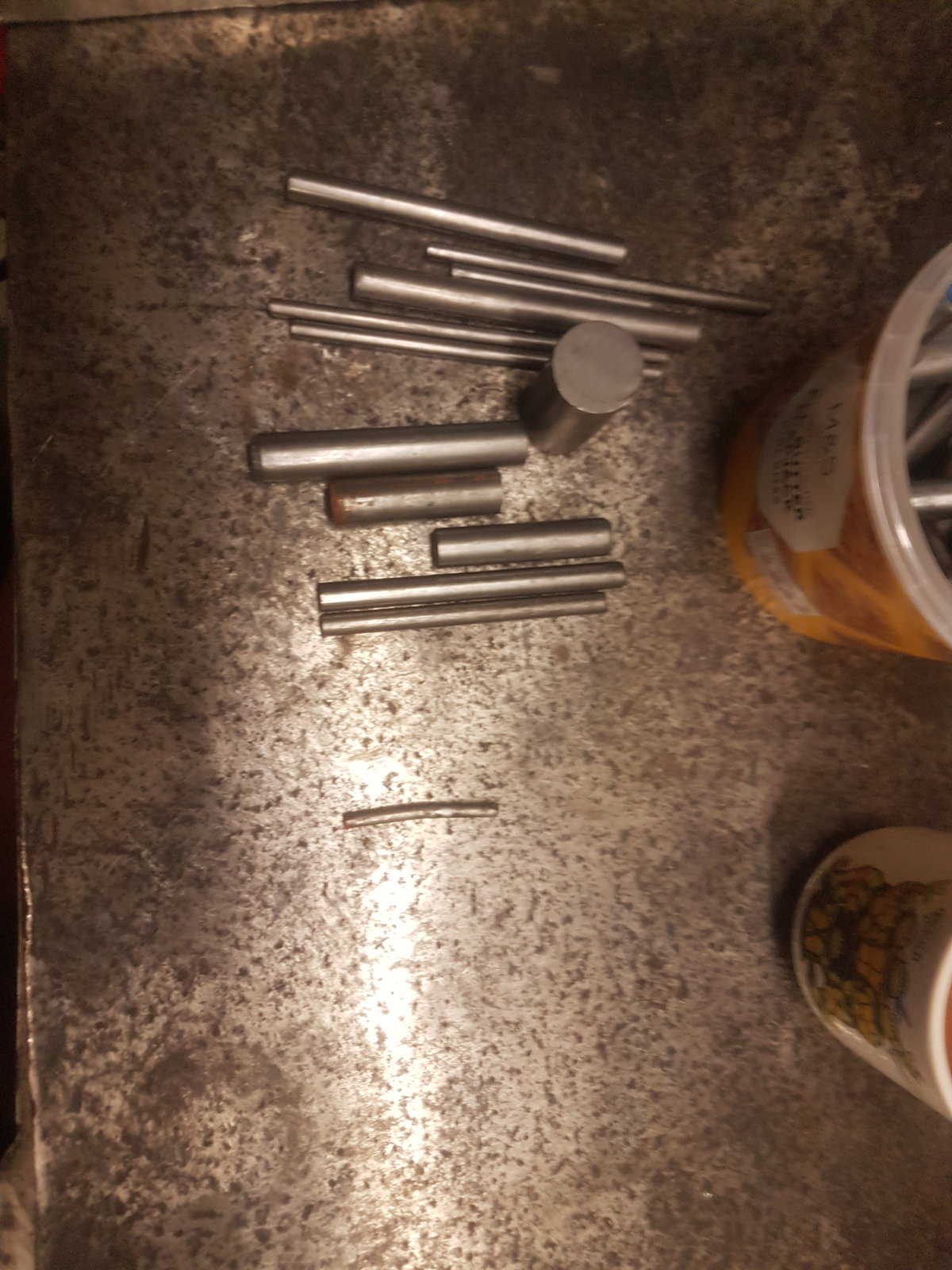

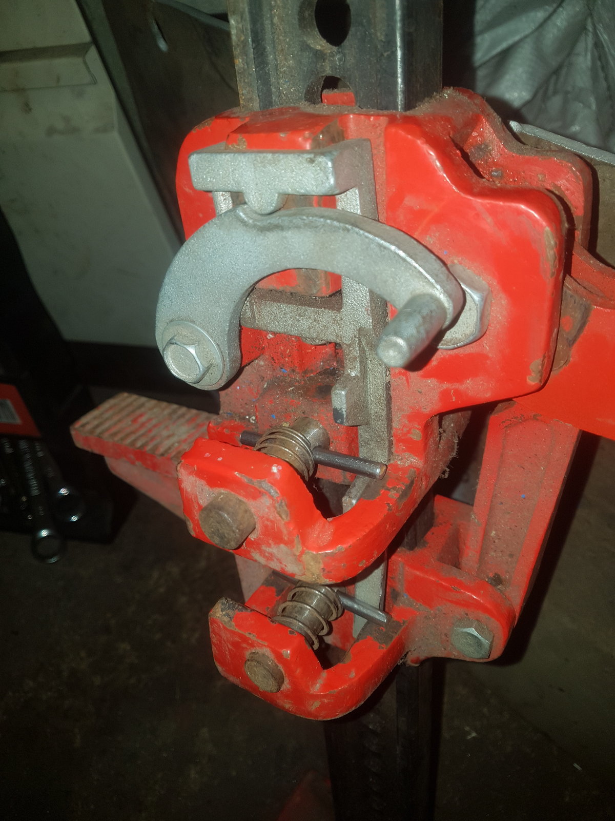

After the Sealey spares messed me about I had no choice but to make my own pins for the Hi lift
It sure isIt’s handy having a lathe
It sure is
It starts getting a little scary when you need a bigger one
I dont think I could get a bigger one down there through the house and all that!
Definitely parm. If it dont fit ...make it fitClearly you aren’t thinking enough, where there’s a will there’s a way.
