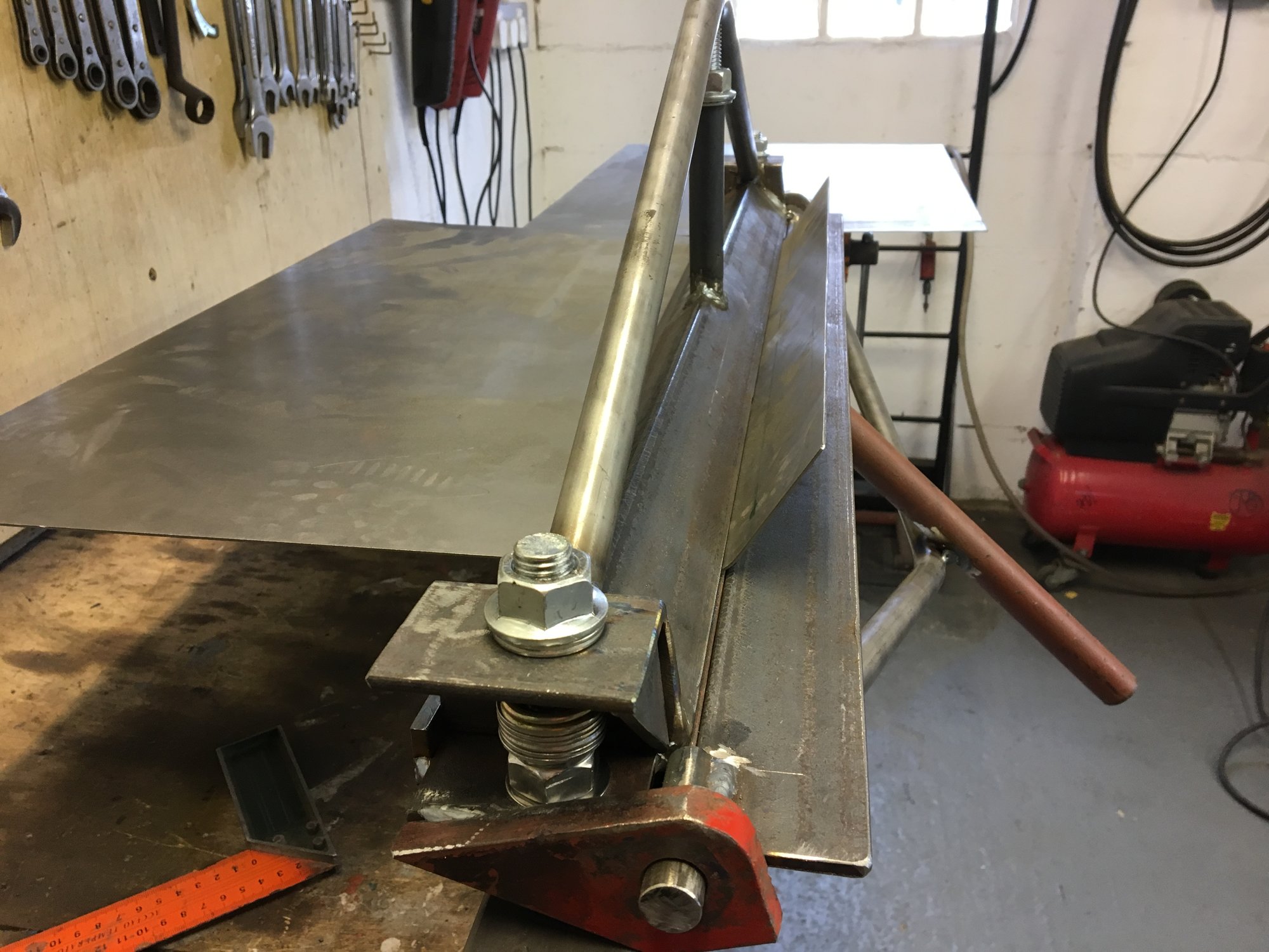

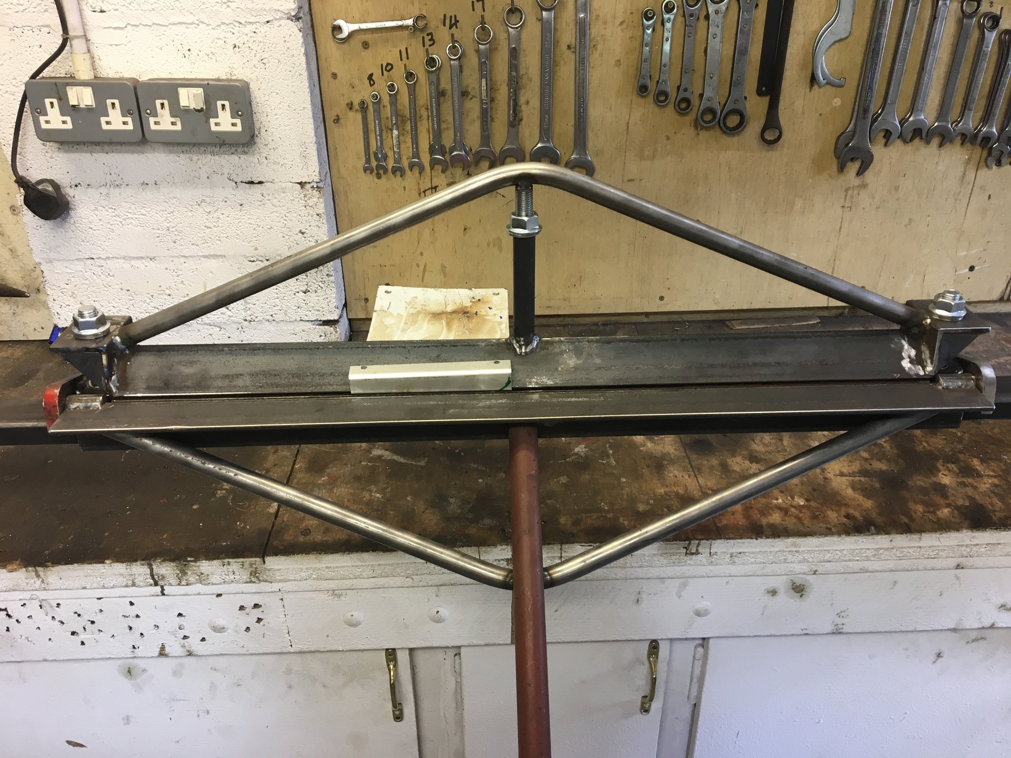

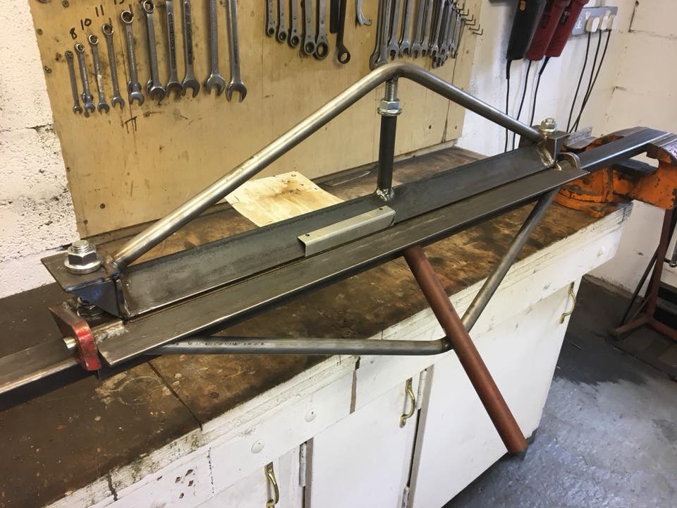

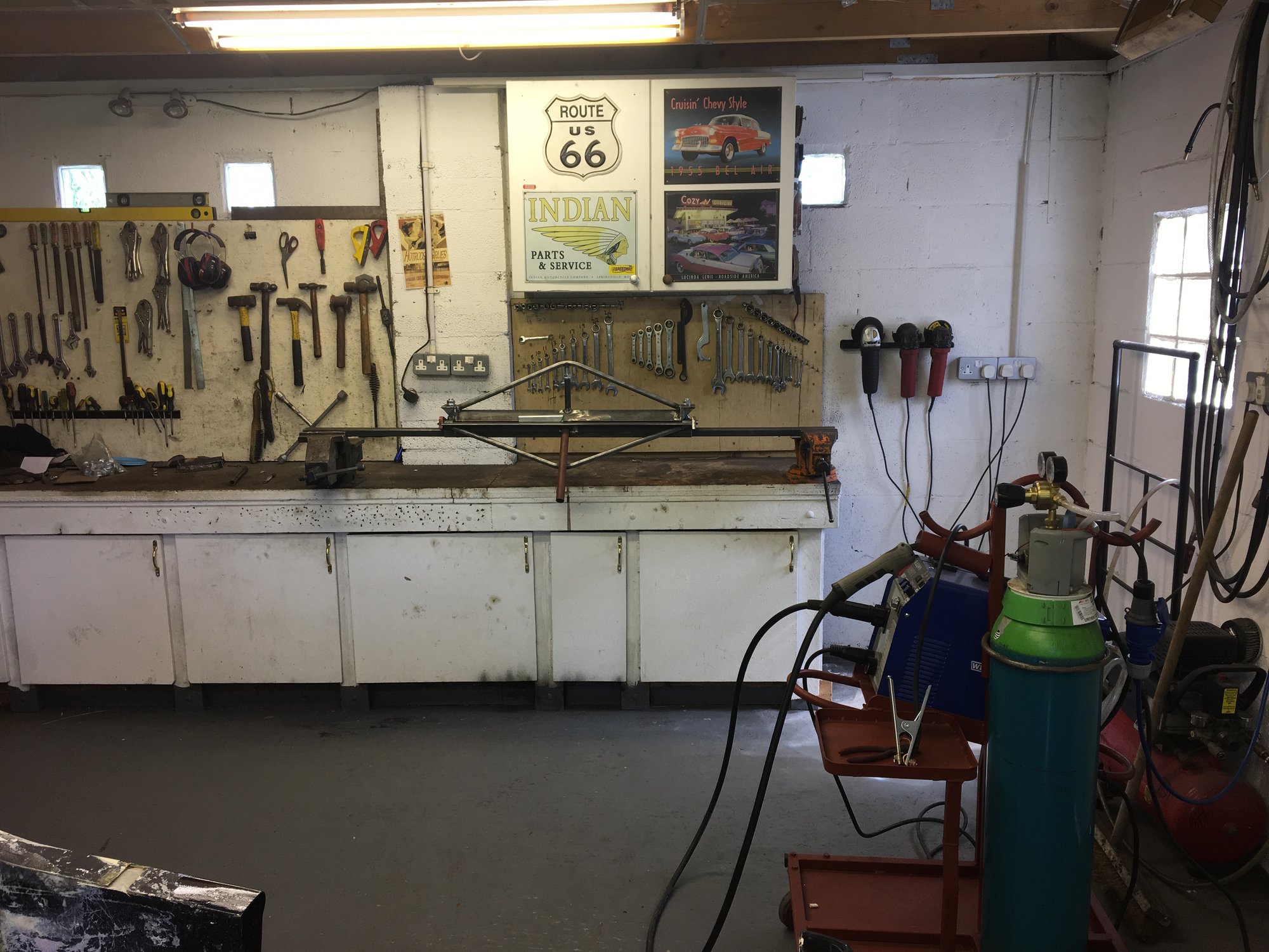

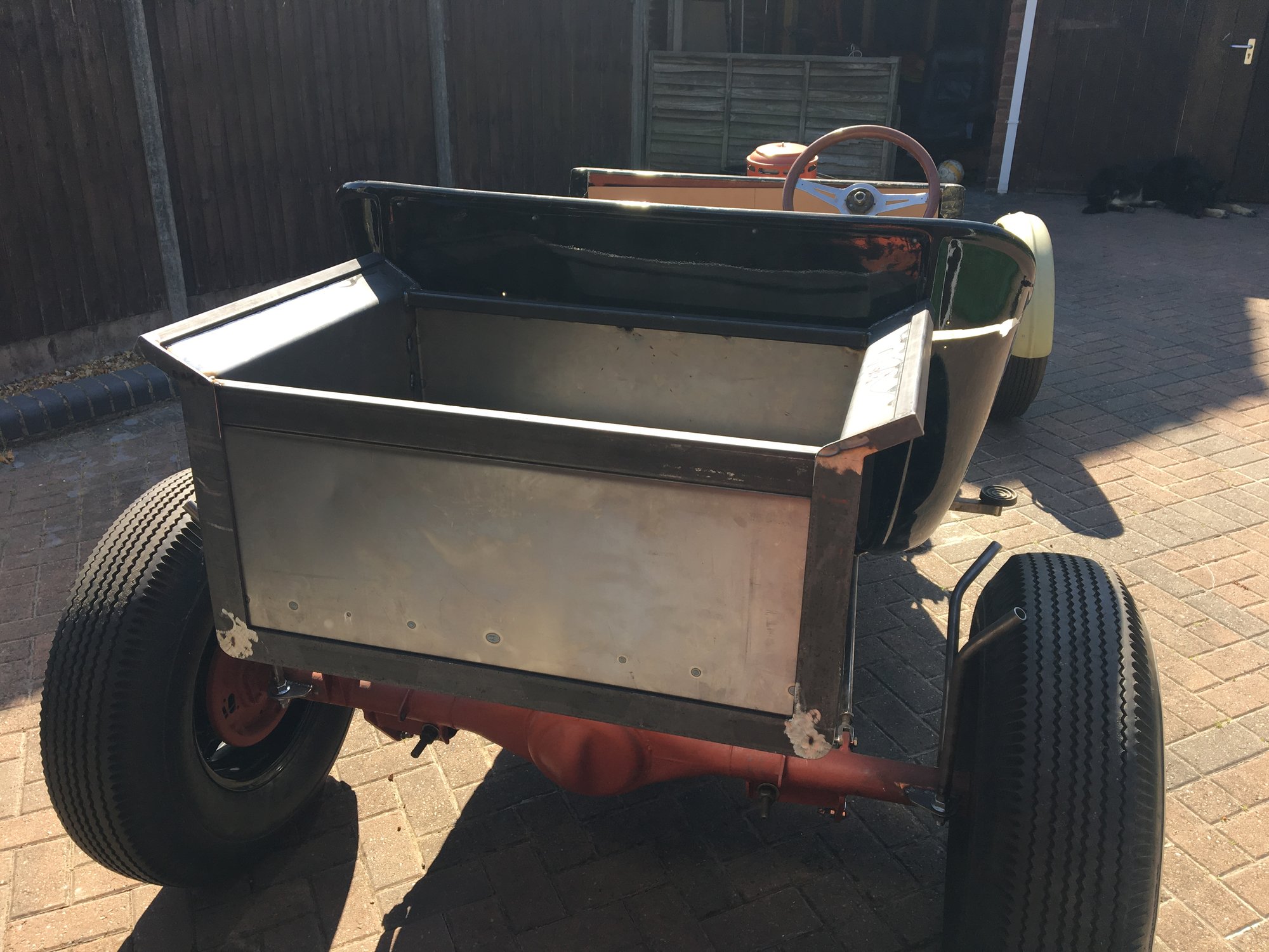

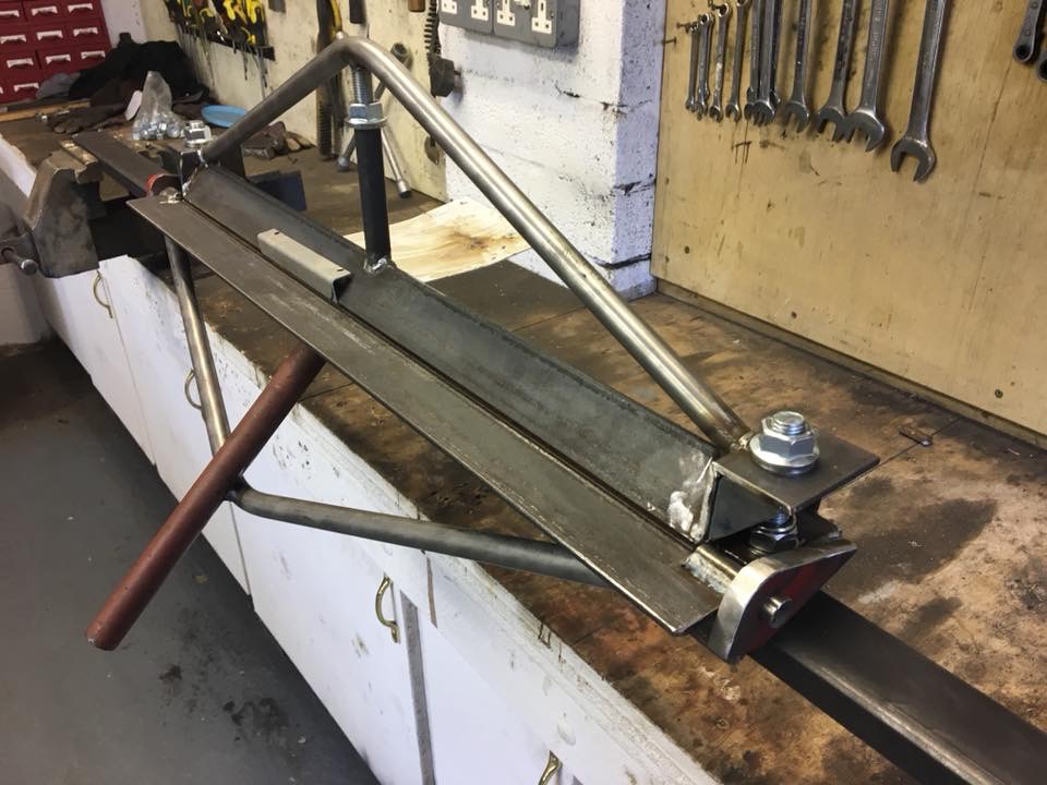

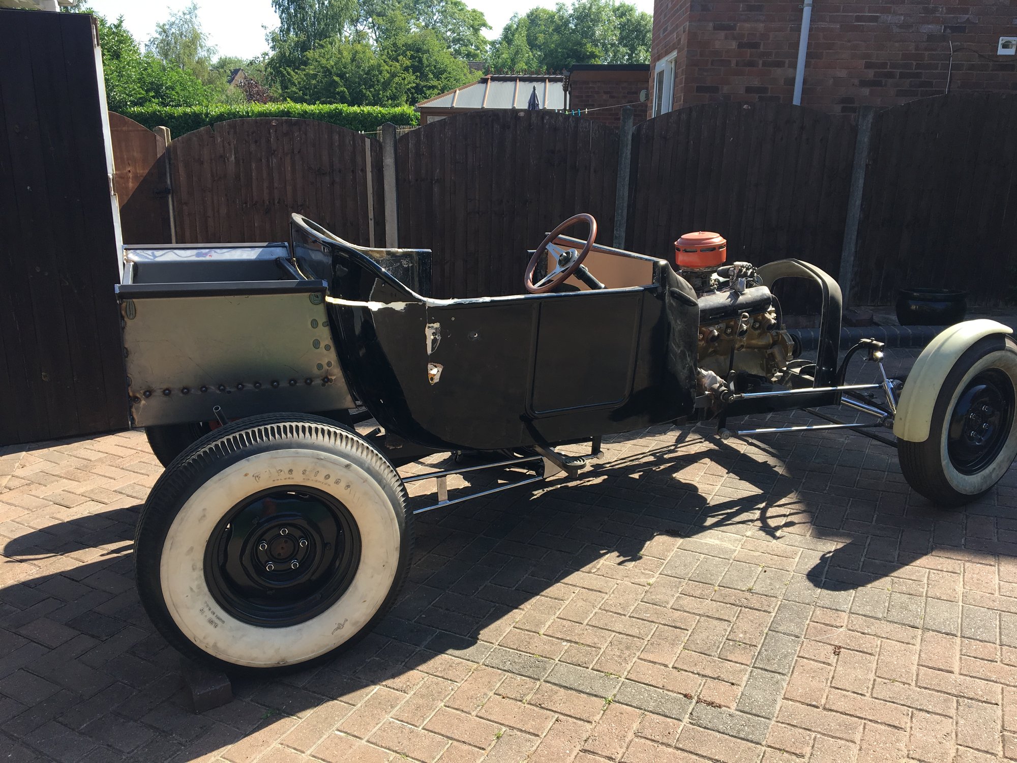

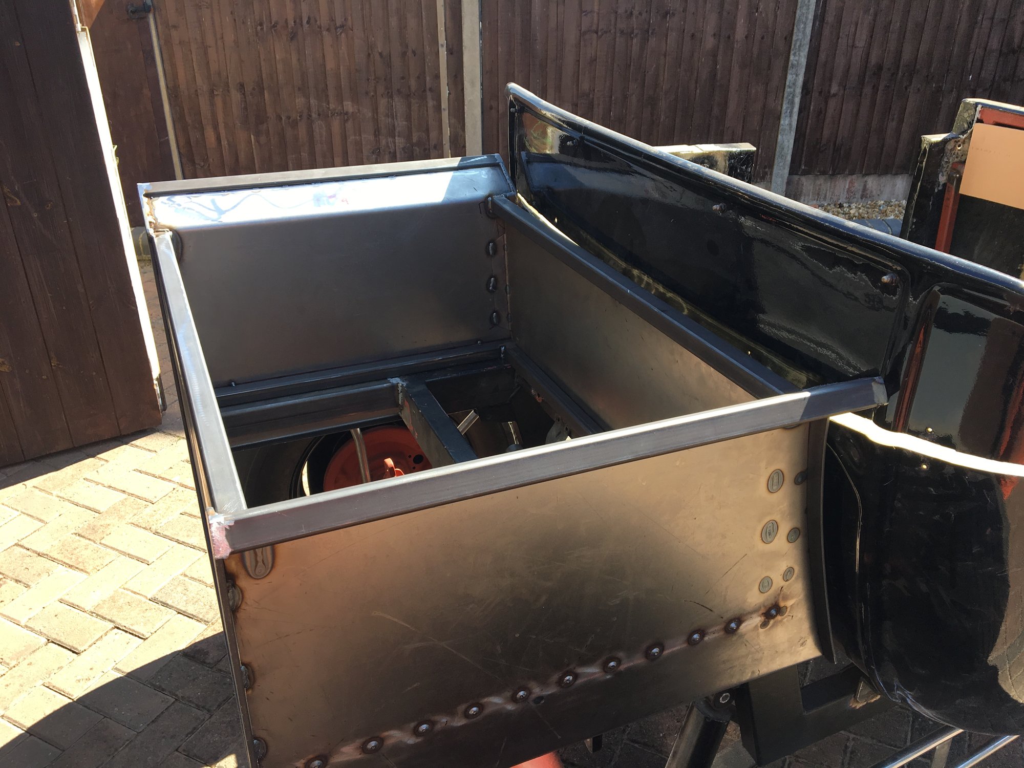

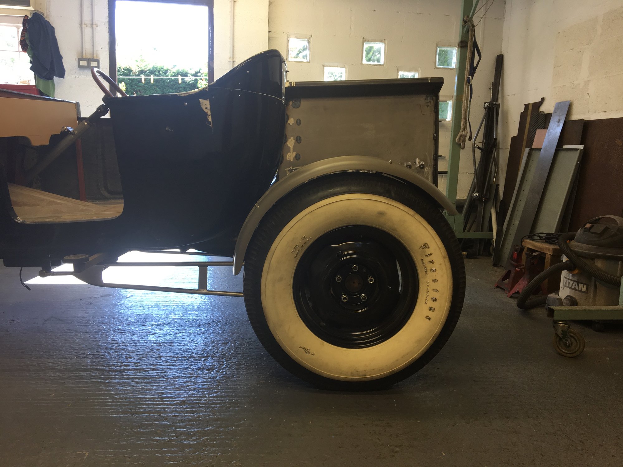

I’m building a hot rod and plan to make a steel pickup bed for it, so to make life easier I decided to make a sheet metal bender.
Didn’t take many pics, but you can get the general idea of it here.
I’ve welded it to a length of 2 x 1 steel tube so I can simply clamp it solidly between the two vices on my work bench, rather than make a whole table or legs for it to sit on.

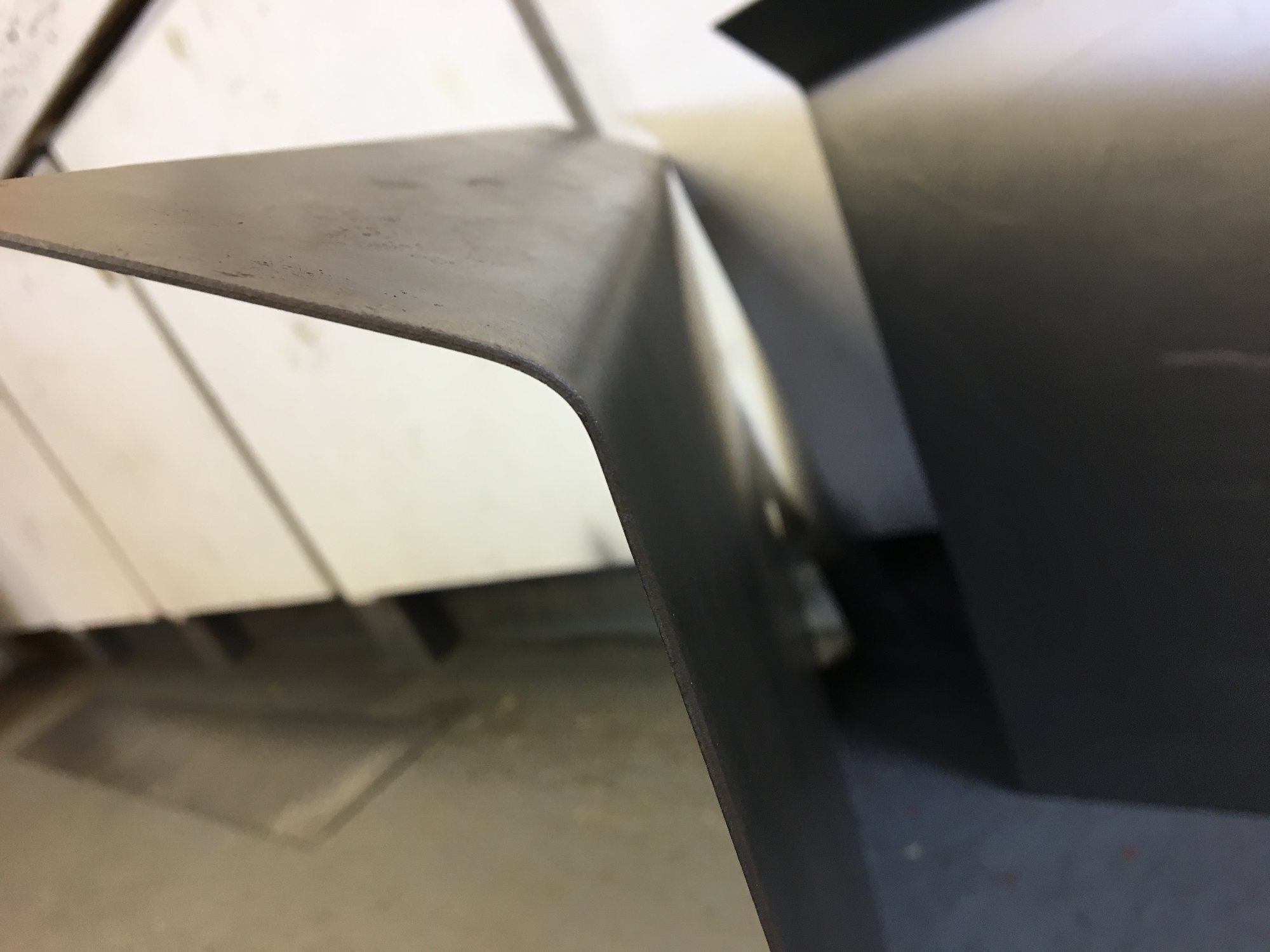

I’ve only tested it on some 1/16” alloy sheet, but it seems to work well enough. The real test will be bending the same thickness of steel, full width......
