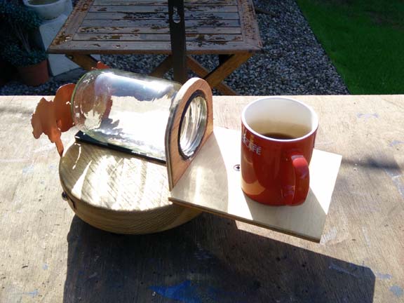

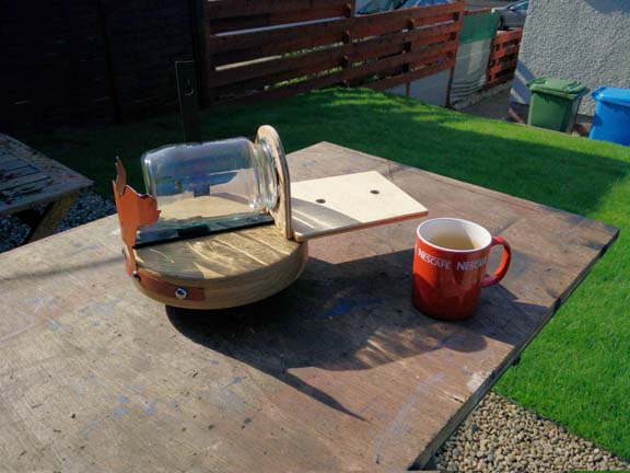

Finally, I finished the red squirrel feeder . Tbh, it was starting to annoy me kicking about in the cave, bit it's dropped off and now I can move on to the next thing in the line. Not 100% happy as I kept changing my mind on the design, but at least it's gone...... (Pics don't show it clearly , but there's a 'stem' at the back so that it can be hung up if necessary)
As I was going up the drive to their house, what was running ahead of me? A beautiful red squirrel !!

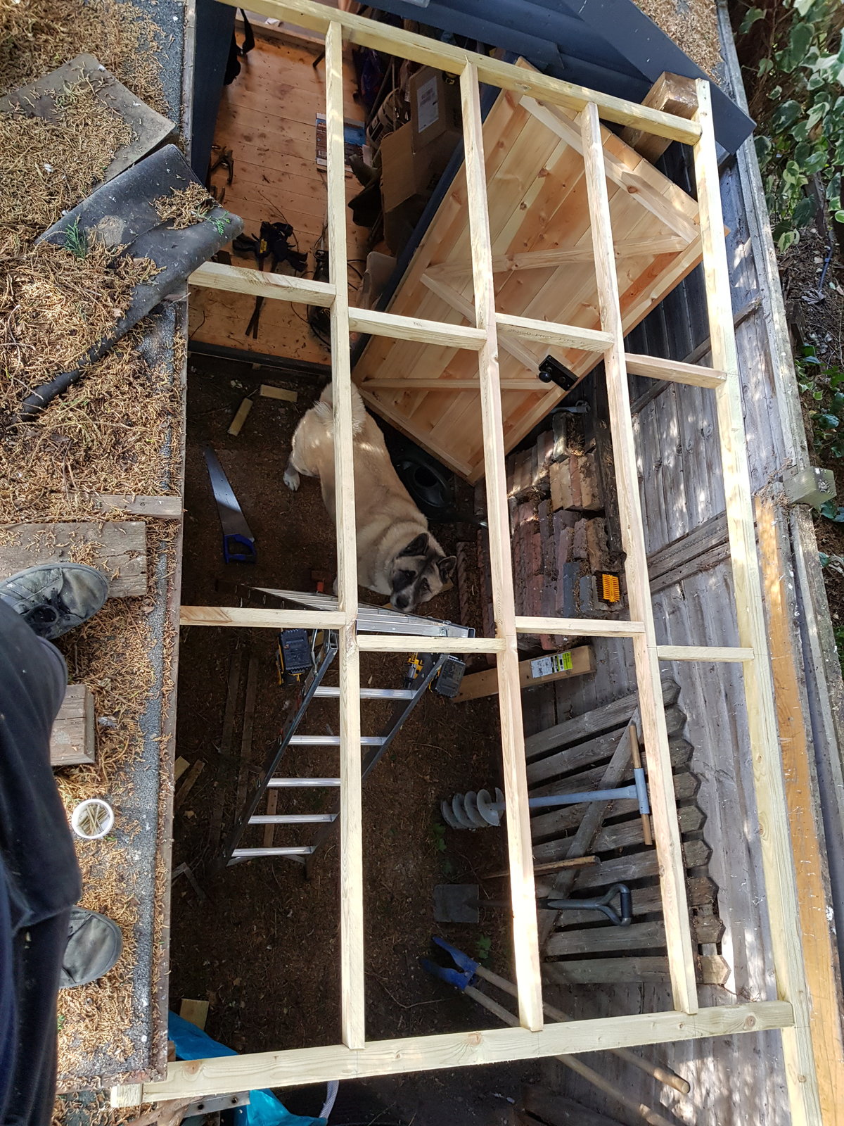

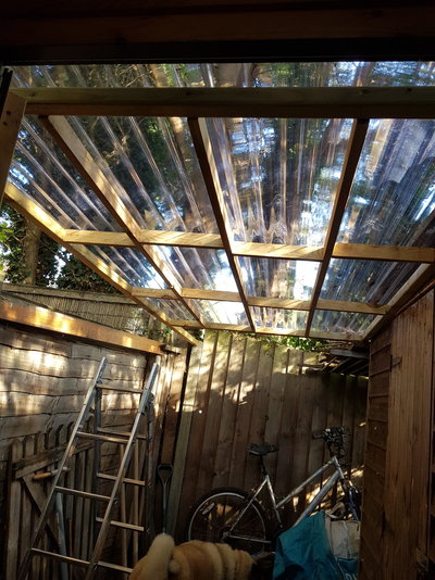

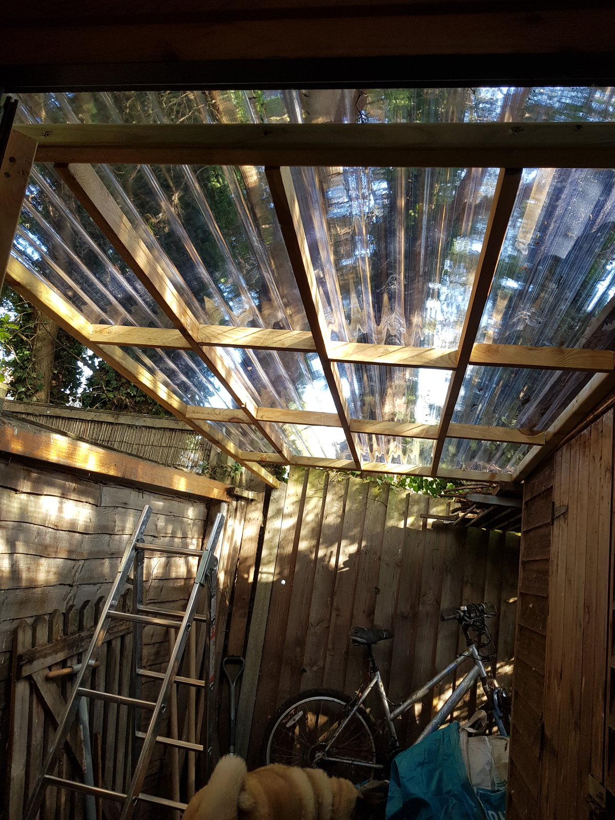

This is the other side of the shed in my last post, the garden backs onto some massive conifers, in an effort to make the most of the space, this roof should catch the dead leaves and pigeon poo. It's not square (The space it covers isn't) and not as solid as I'd have liked but was done on a bit of a budget. Again Baloo thought he was helping.

That's Baloo guarding the shed, he's been "helping".
9x2 might be pushing it a bit but I agree this is very under-built, no way was I standing on it. The conifers will keep the snow off it so it shouldn't ever really have much load on it, plus it's better than the bed frame sat on hanging basket brackets in the top right of the second picture.Hope u were not standing on that.
I'd have run two 9x2 as per the current joists then used 2x4 I. Between cross wise to stop the sag and keep the materials down
Even 6x2 on the edges would have helped and nail a batten on to support the 2*4
I don't do heights well so always build roofs strong9x2 might be pushing it a bit but I agree this is very under-built, no way was I standing on it. The conifers will keep the snow off it so it shouldn't ever really have much load on it, plus it's better than the bed frame sat on hanging basket brackets in the top right of the second picture.

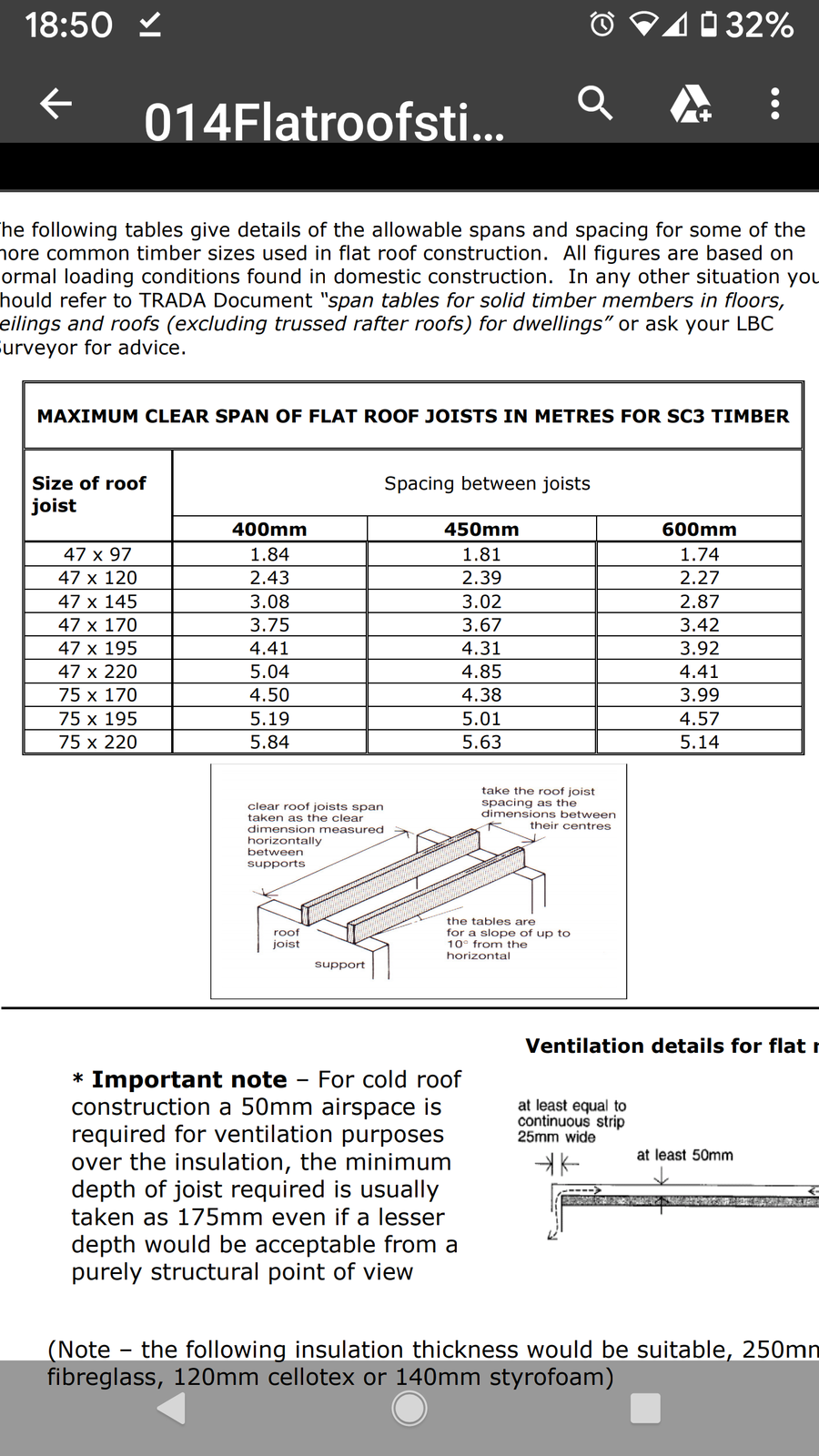

It's about a 10 foot span but only 8 foot has the sheeting on it, I may well have to bulk it up next year, should have used at least 2x5 according to that chart.I don't do heights well so always build roofs strong
What's the span out of curiosity
I've replaced a few like that. Always increased in size as I replaced with full size twinwall and needed to climb on top.It's about a 10 foot span but only 8 foot has the sheeting on it, I may well have to bulk it up next year, should have used at least 2x5 according to that chart.
Sheds and fences on all 4 sides should shield it from the wind a bit, I might suggest she chucks a couple of bricks up there if it gets a bit blustery.If the wind gets under that plastic roofing, it'll be difficult to stop the damage it's capable of doing to it.
Is there any way of preventing a gale getting a hold unde there?
