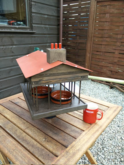

. It's presence is part of a joke which I won't explain here.

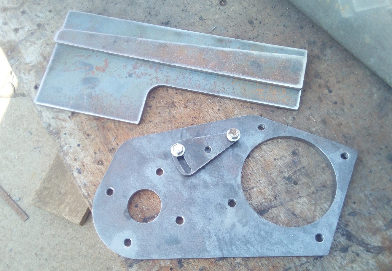

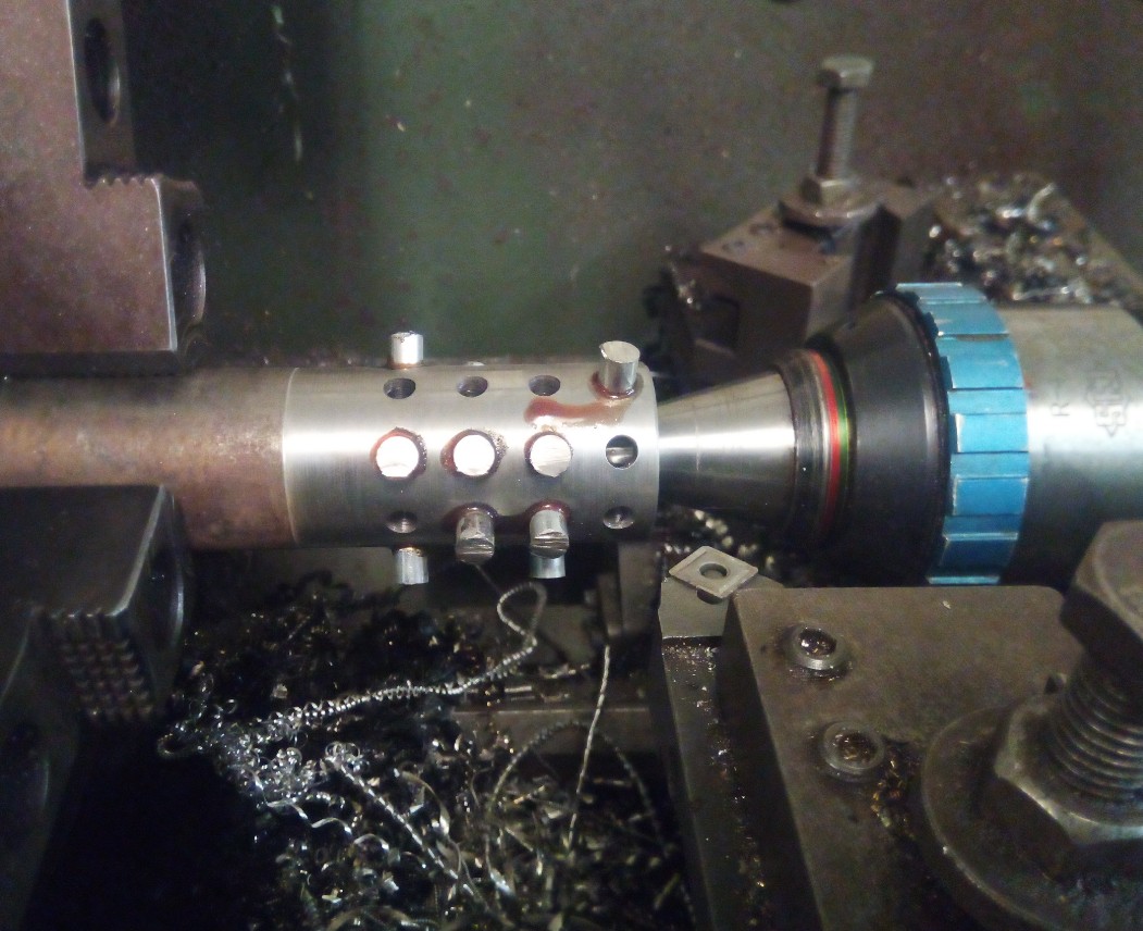

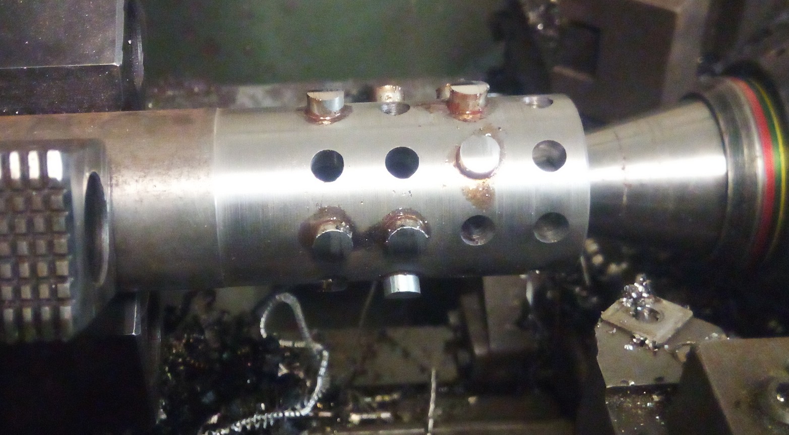

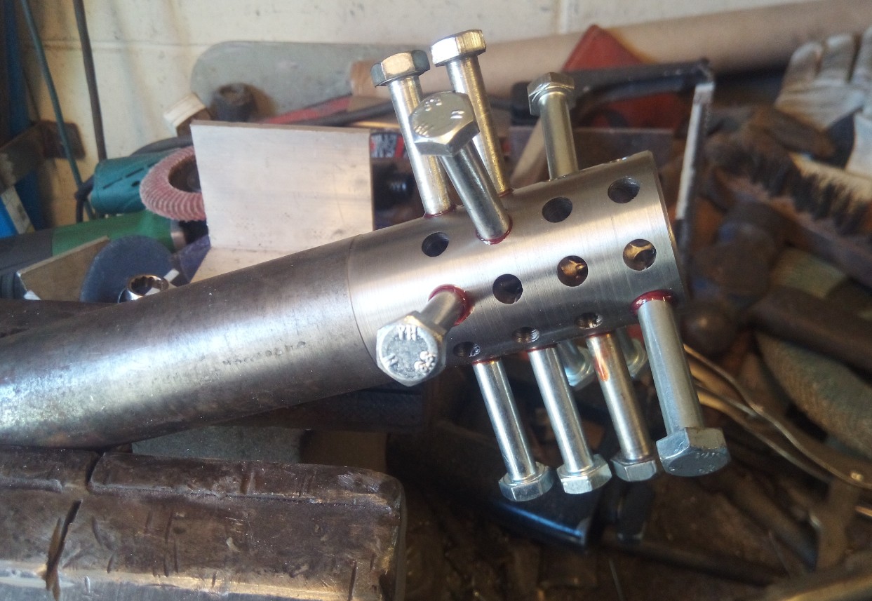

Screwed some bolts into the prox sensor trigger.
Chopped them to rough size with the grinder and then put into the lathe ready for turning.
All done.

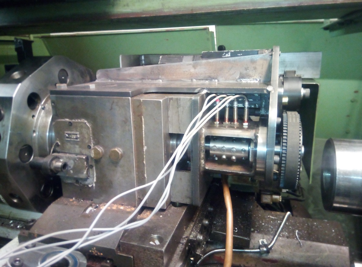

Wire brushed to deburr and then fitted onto the shaft, also fitted and adjusted the prox switches.
Tested them out and they are working fine although I may have been better making the pins 6mm dia rather than 8mm, time will tell.
Tomorrow I hope to get the prox switches wired, motor power and encoder cables cut and soldered into new plugs then with a bit of luck I can try out with the small drive I currently have in. If the drive is too small I will have to rob one from the Beaver mill until a suitable one comes up on eBay.

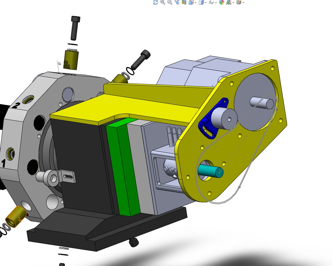

It is the turret I made for my CNC Lathe, the gearbox I had on it developed backlash so positioning was intermittent and thus no use. I decided to redesign the whole back end and fit a bigger motor and do away with the gearbox.
You can see the turret in the following video, if you look closely you can see that sometimes it is not quite at the right position when it clamps. The teeth on the Hirth coupling align it properly but the backlash got worse and often the teeth didn't mesh and it wouldn't clamp.
It worked well for many years but the gearbox was second hand when I bought it so I suppose I can't complain that it eventually packed up.In action not text book but nearly there

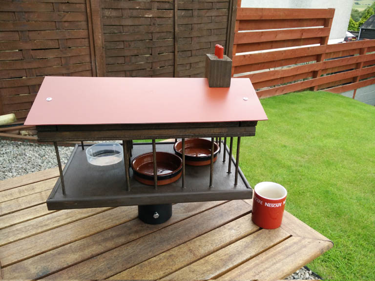

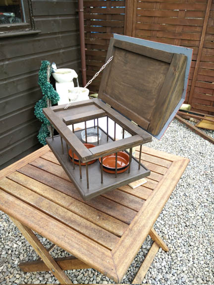

All designed to keep gulls, crows etc out
Yebbut, will it prevent furry thieves?
If furry thieves are squirrels, they absolutely can do that.Good point, but as it'll be on top of a post 4[ish] feet off the ground, they shouldn't be able to get to the food.
Unless, of course, they can do this - in which case they're welcome to stuff themselves......
My dad had a bird feeder handing on a tree, squirrels just climbed straight onto it so he put it on a long chain - they grabbed a lower branch with their back legs, sprung towards it and grabbed it with their arms, then pulled it back to the branch so they could comfortably eat. He's threaded a pipe over the chain now, it looked like it worked until one slid down like a fireman/stripper.
