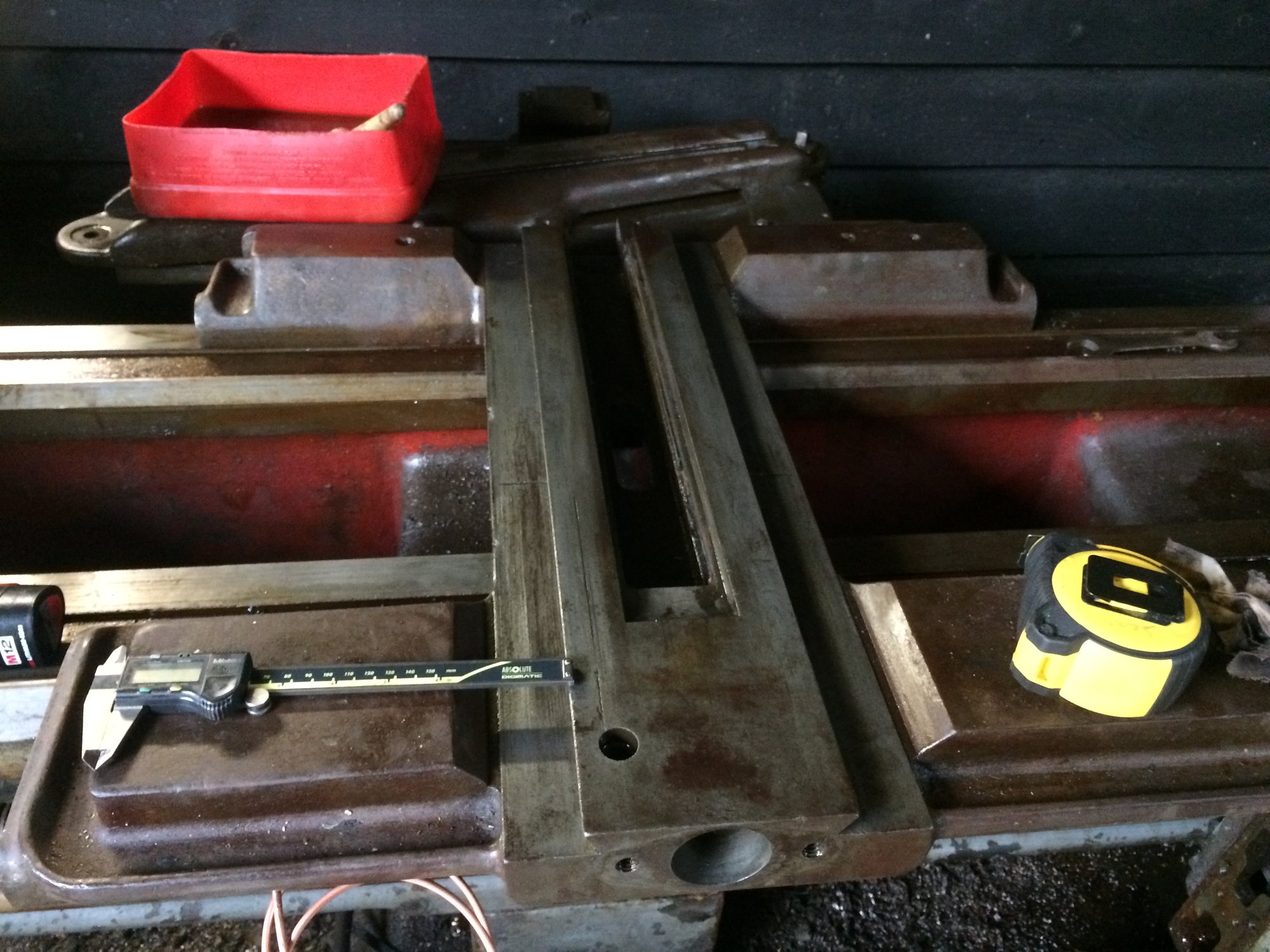

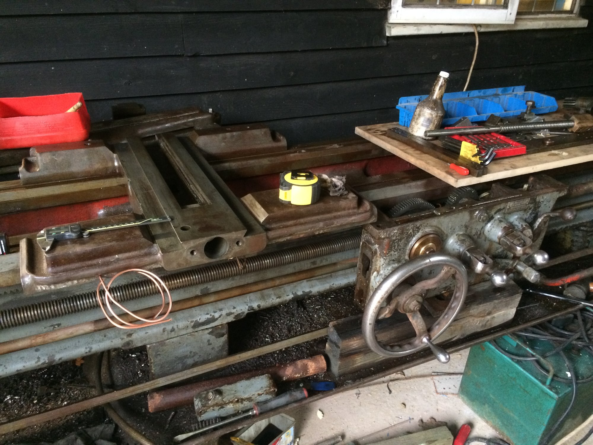

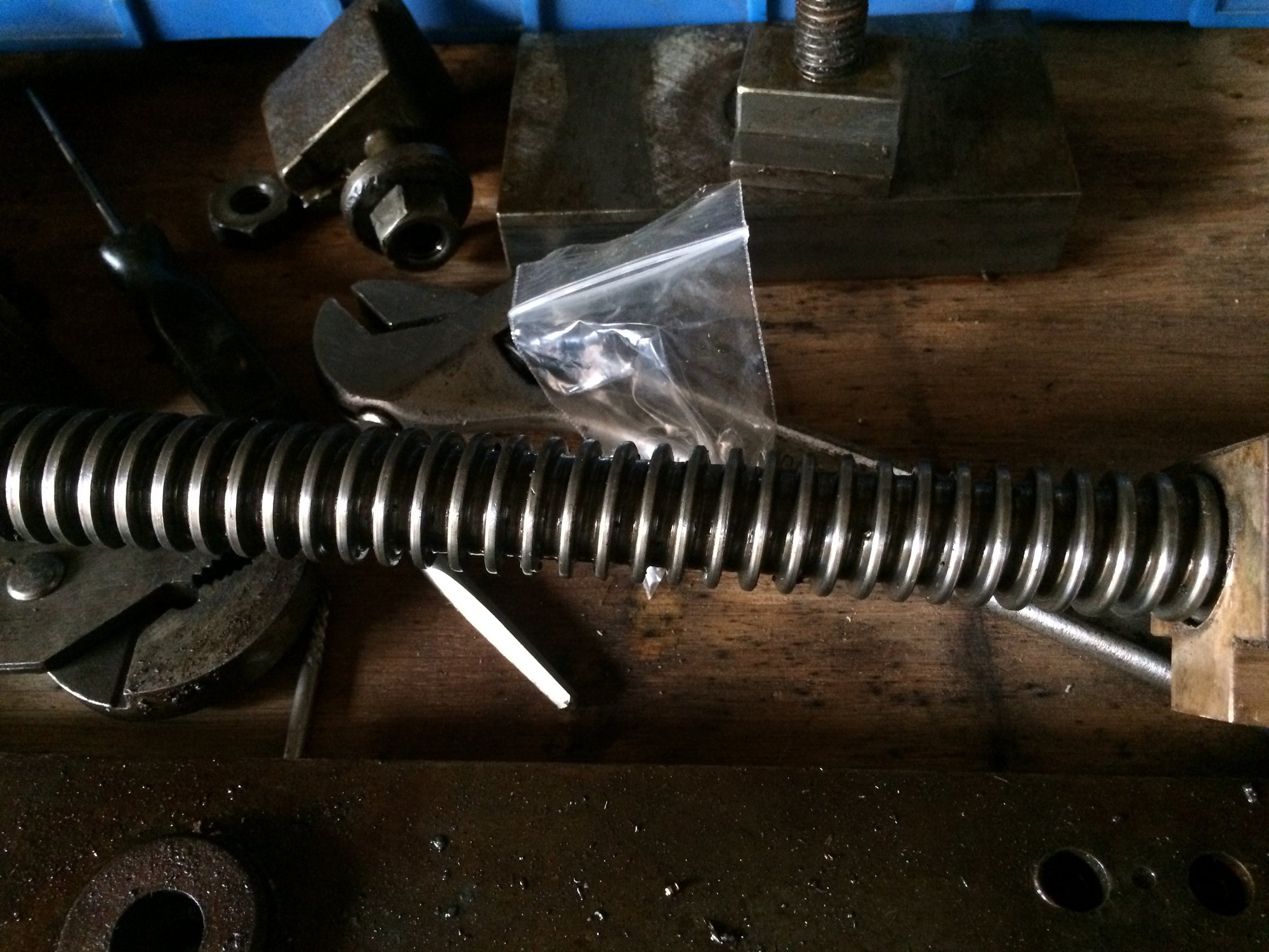

That thought has gone through my mind I will admitThe crossfeed screw on my m300 was shot. Replaced it with a ballscrew and nut, cheep as chips of eblag. Zero backlash now![]()
Before it became trendy it was a £7.75 ph job back in the late nineties.Glad I knocked on the head to be s coach builderHow long is that crossfeed screw? Ive been reading up on machine truing and scraping, I must say it seems to be a lot of work, and a true trade type of job. I couldnt imagine doing years of it. Good luck!

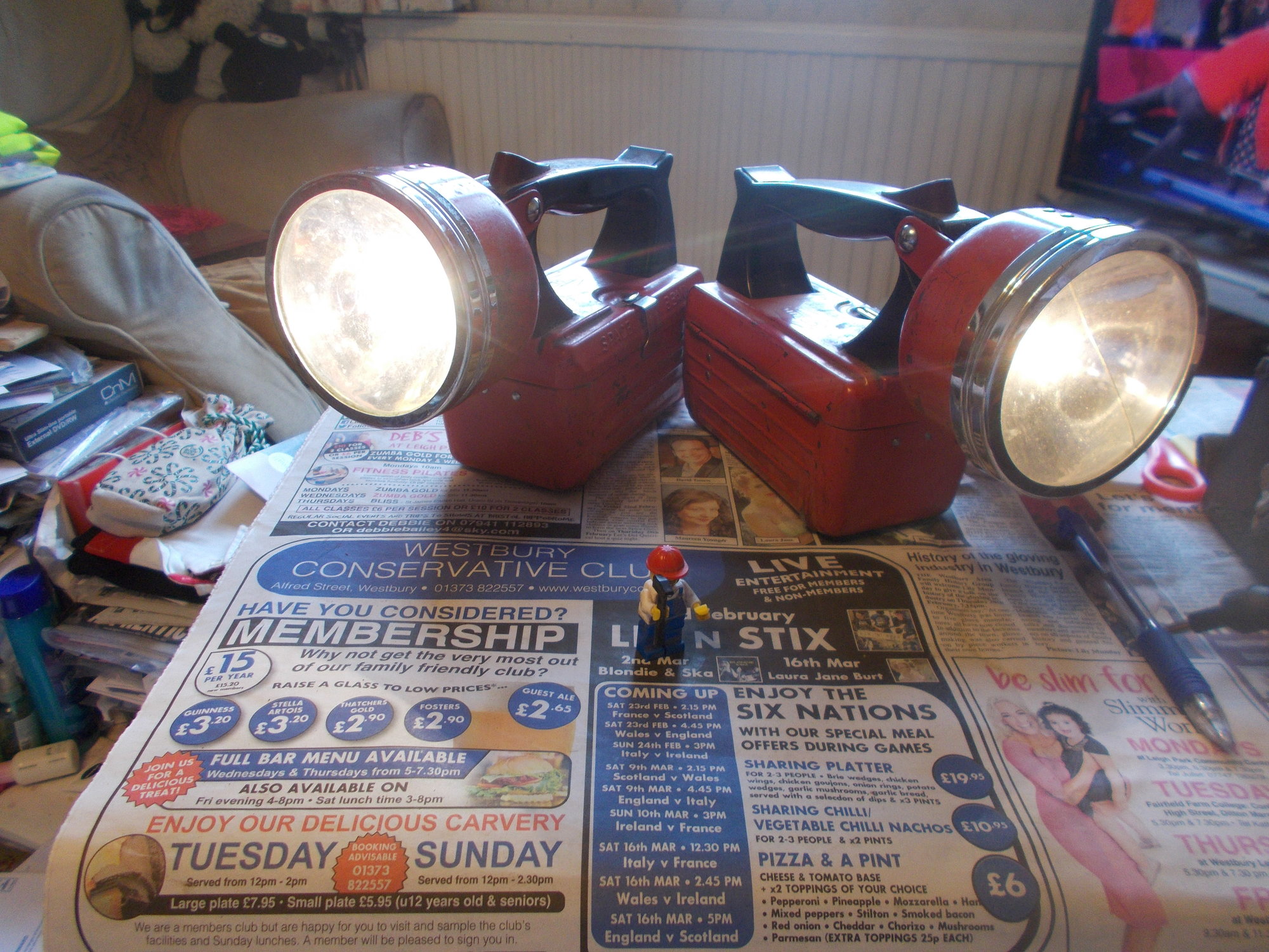

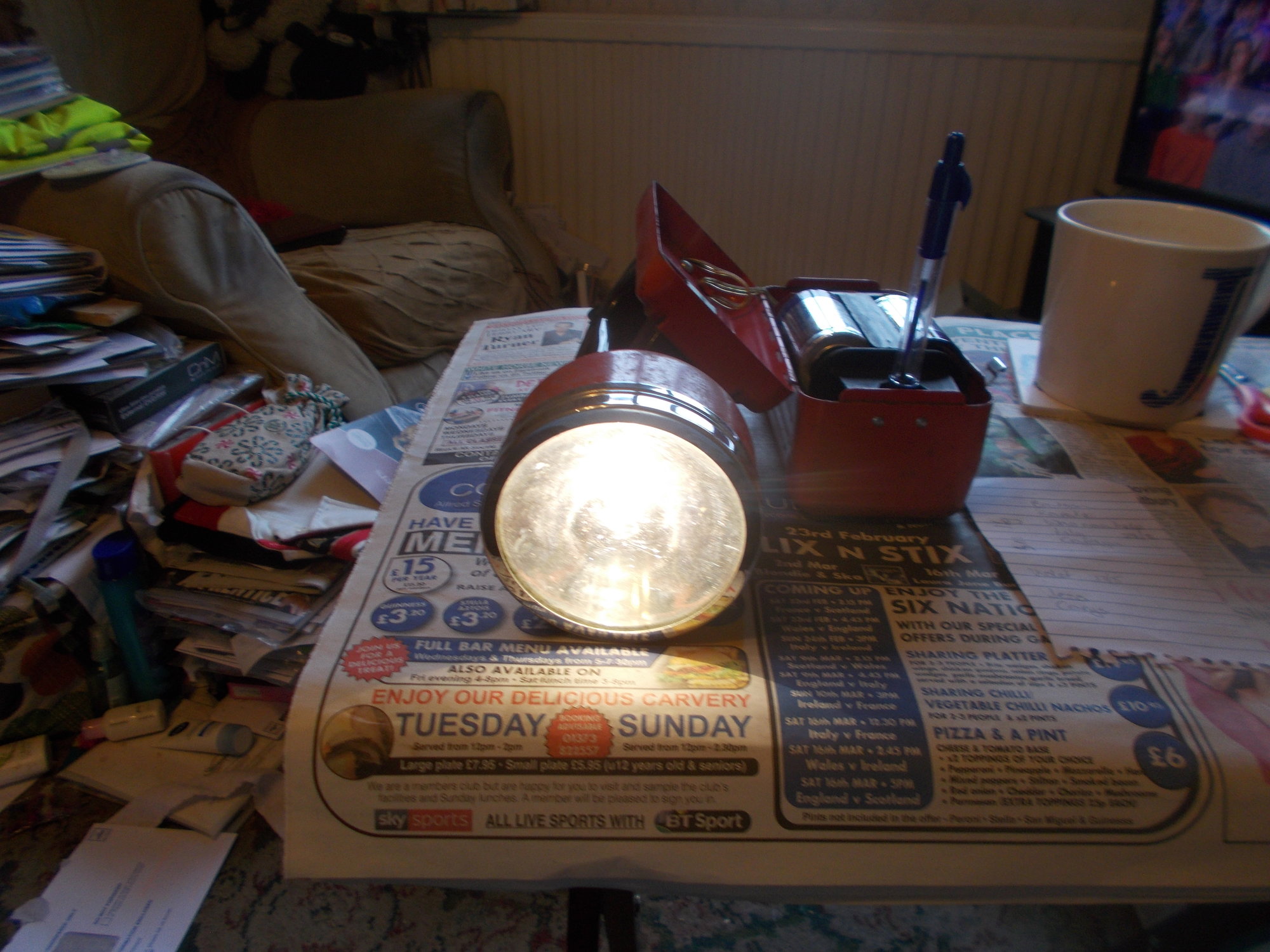

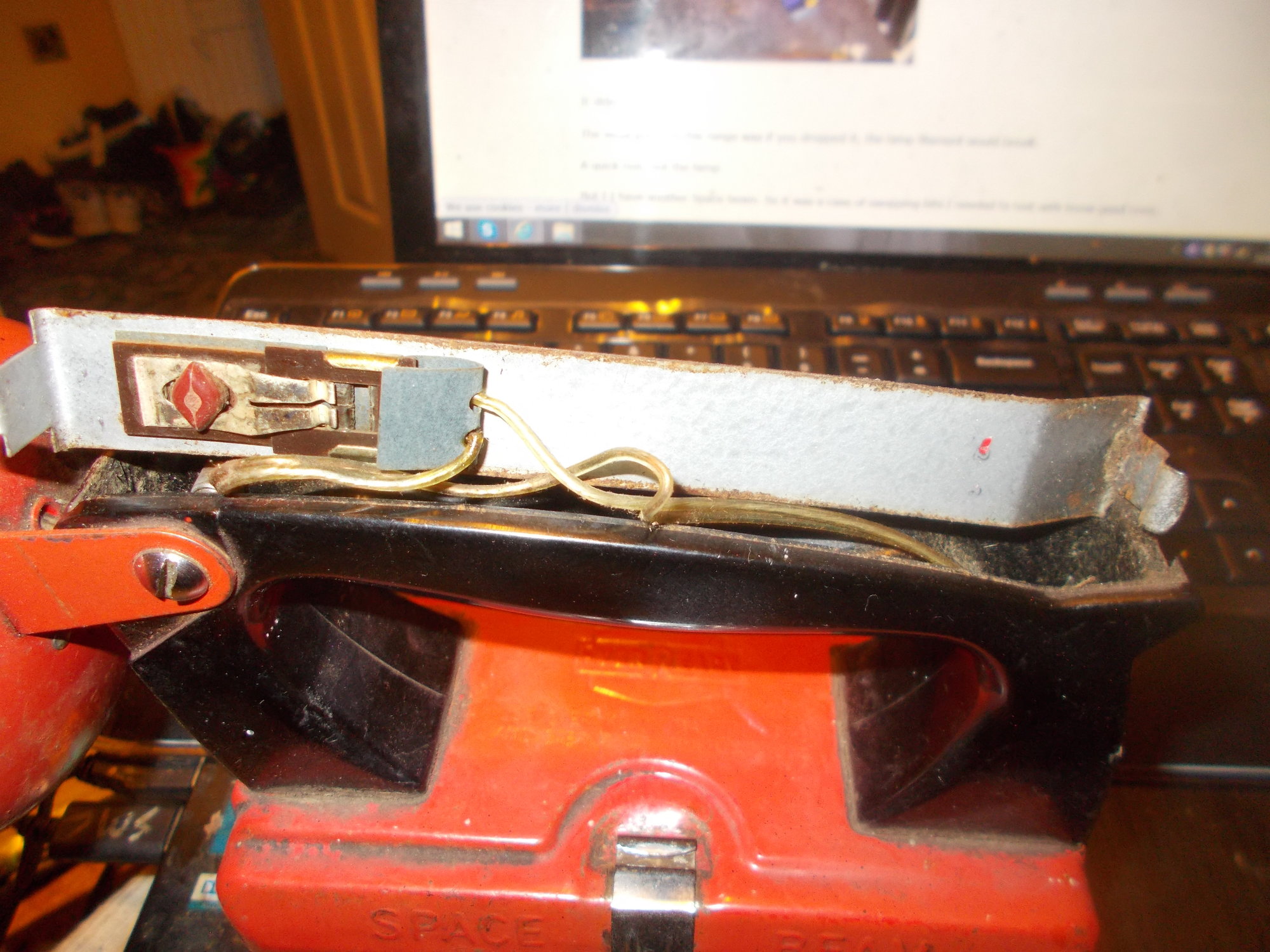

Yesterday I got this Ever Ready Space Beam Torch.
It didn't work.
The weak point on this range was if you dropped it, the lamp filament would break.
A quick test, not the lamp.
But I I have another Space beam. So it was a case of swopping bits I needed to test with know good ones..
Traced it down to the twin core cable had gone open circuit. It is the old fashion clear coated bell cable. I have some of that.
So.

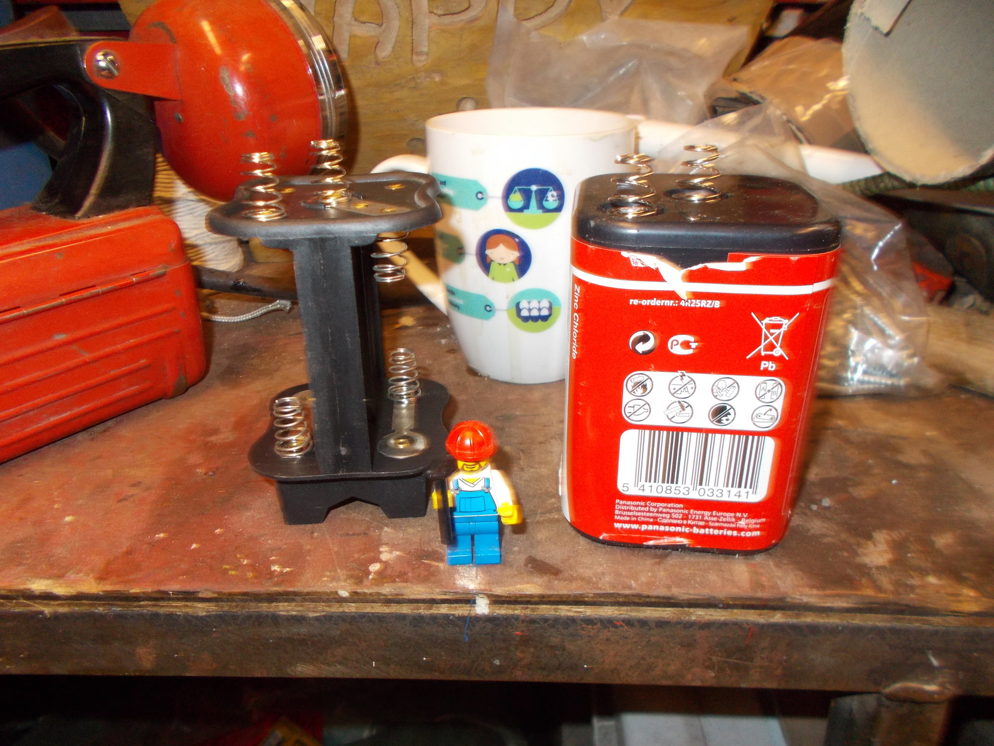

Yes, there is a pen. The sad fact the adapter to hold 4 D cells is a fraction too short. The original battery is a 6volt 4R25.

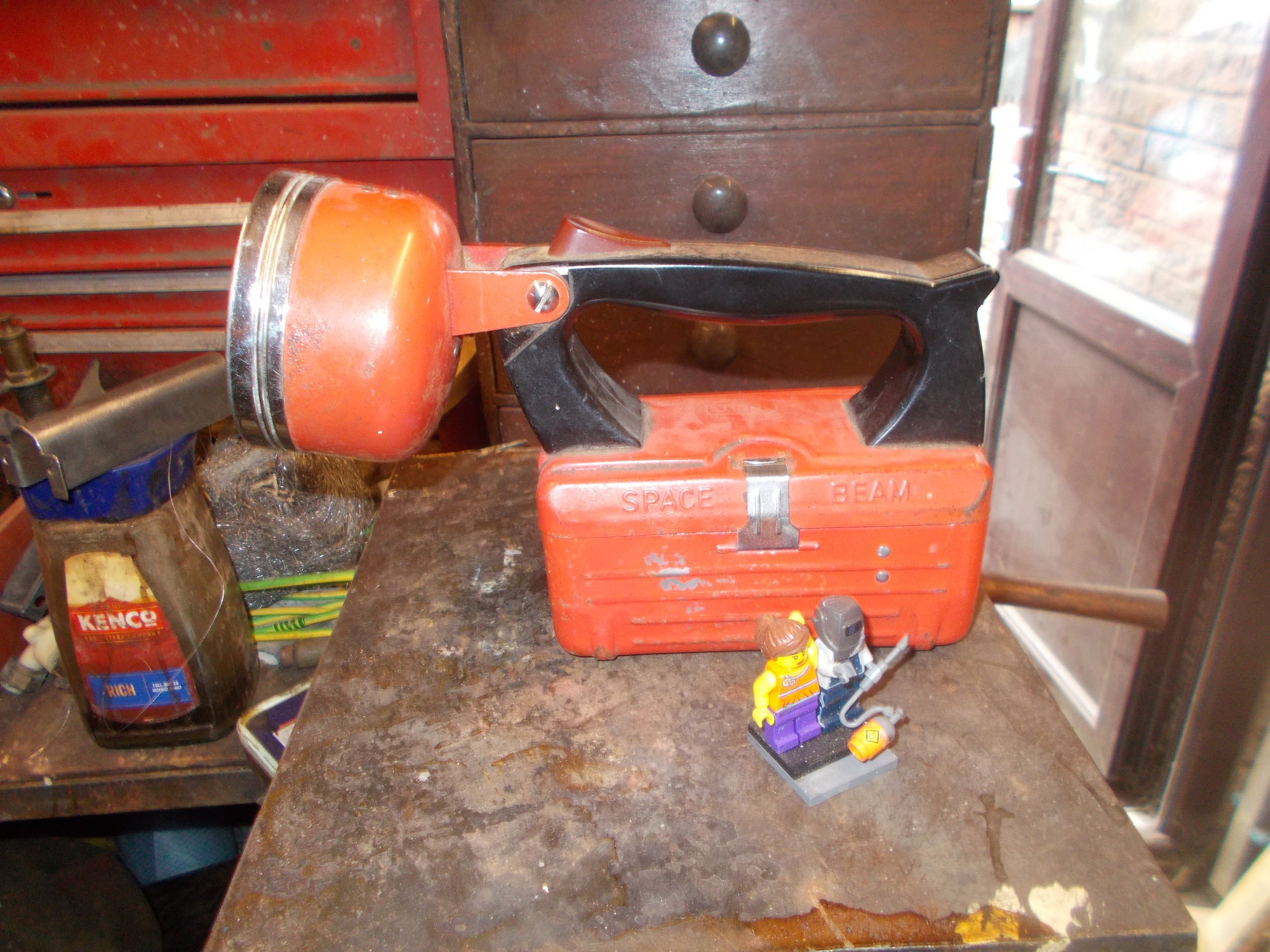

Here are my 2 space beams fully working.
Wow big or what how times have changed and I bet the price of batteries. nice
