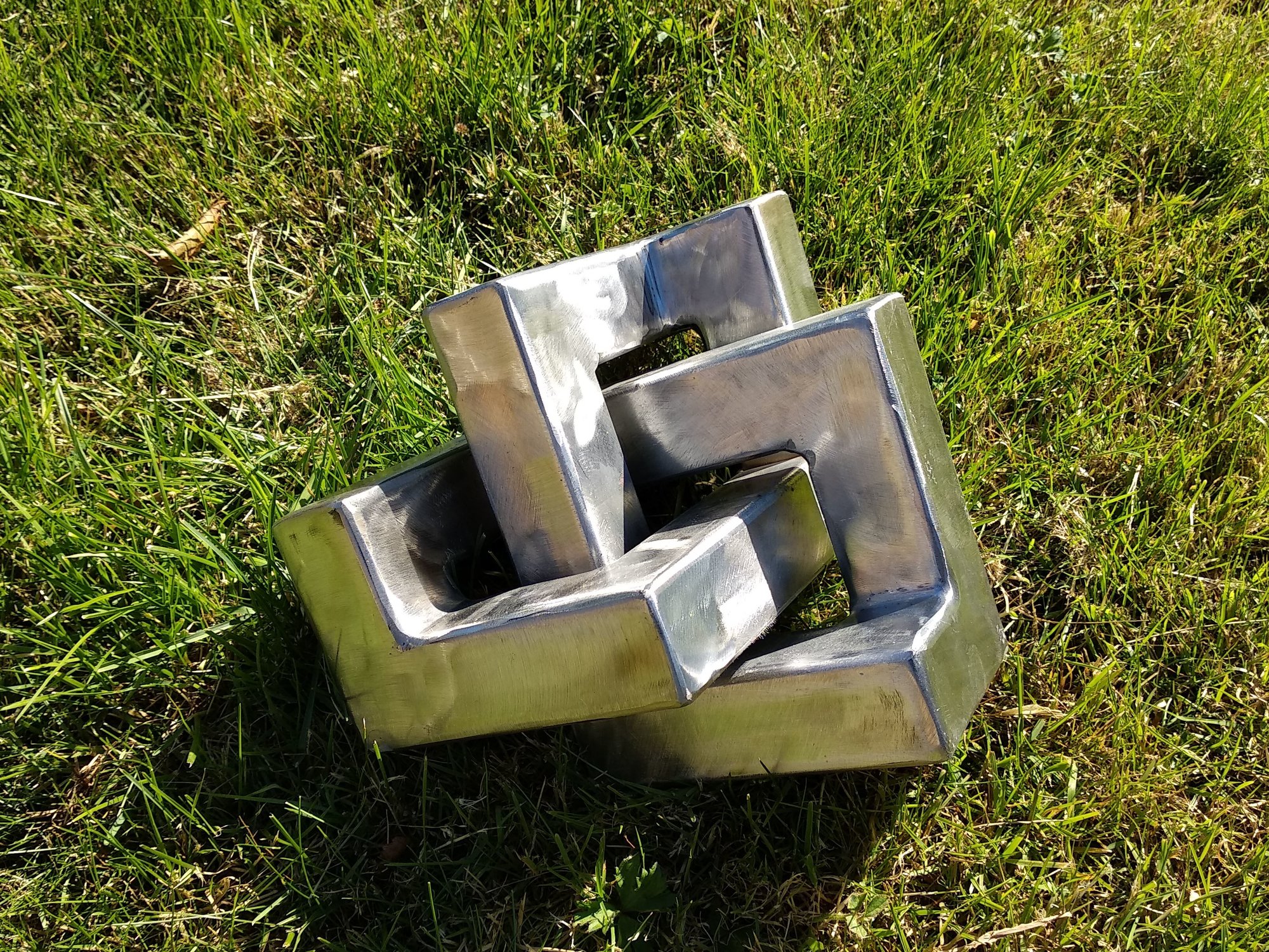

That's enough mitre joints and grinding for the weekend...
I've heard it called a 'welders knot' but also known as a trefoil I believe. I'd done a 3D CAD (Inventor) plan during quieter moments at work and I'm glad I did; only three parts to make in varying quantities - and I needed the rendered image to refer back to at times! This really put Femi bandsaw through her paces and she excelled herself. I learned loads during the welding process and went a bit nuts with the grinding...
Made it from 40 x 40 x 2.5 Box section, weighs a bawhair over 3kg (CAD got it almost spot on) and ended up with three separate shapes to weld together in the end so there's three unwelded seams on the inside that I can't get to. With a bit more planning perhaps possible with two? Made a schoolboy error and there's some swarf rattling around the inside. Quite pleased with the accuracy I achieved.
And I need more clamps.
Impressive!
But what does it do?
You need more clamps??? Doesn't make you special..![]()
Heh! My wife also tells me that. We should start a club… not many of us around..Yeah, that's a valid point... paperweight, doorstopper - a tenuous objet d'art perhaps?
And, for the record, I am special - my wife tells me so at regular intervals...![]()
I like that, theres places in London that WOULD sell that as a door stop and at well over £100 too!

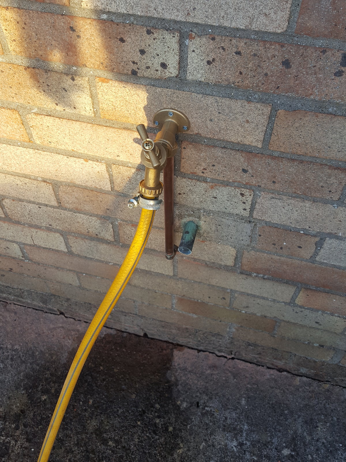

Was out cutting next door hedge she come out with a watering can to do the garden I said why have you not got a out side tap reply never got round to it
And lots of work later View attachment 145473
