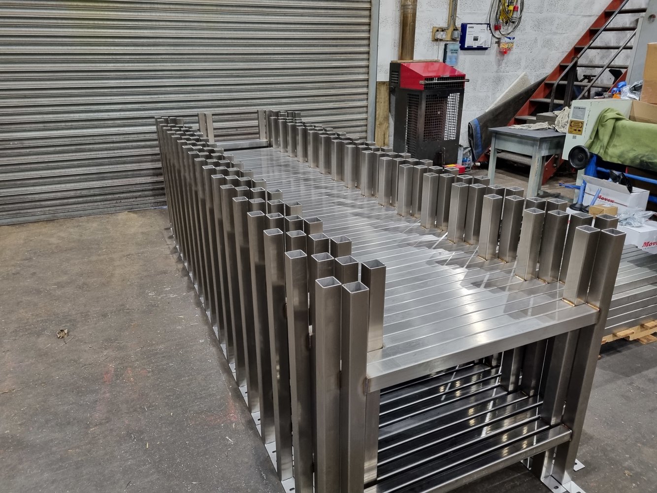

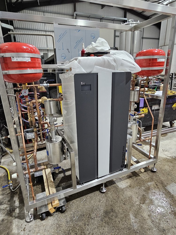

this particular one is heading to Aruba
Am I the only one who has the "Mission Impossible" theme running through his head, now?

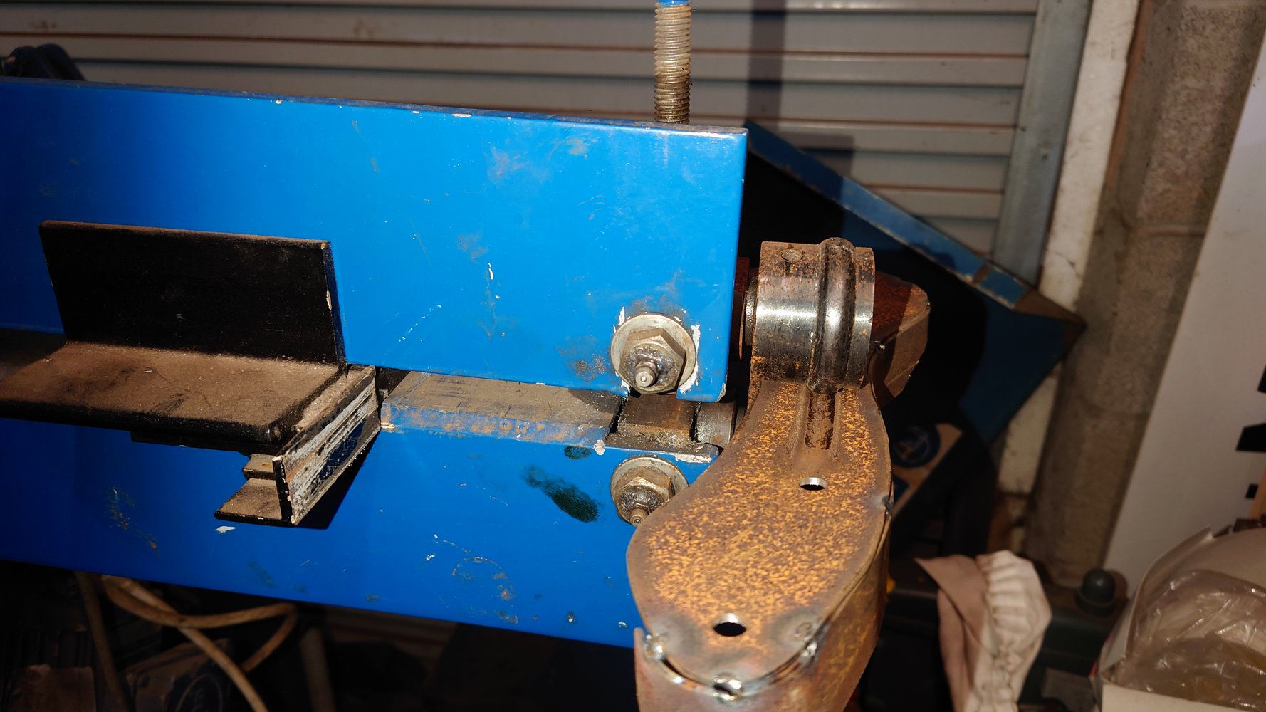

It would be much better if I could get some reverse cutting blades
Bad idea I think, knowing just have to look at abandsaw blade to snap them! Im onto my last blade which is a Milwaunkee with the rubbish weld alignment. The teeth and blade has otherwise done well, and a lot of extra stress with the kick each time the weld goes around !Turn your existing blade inside out!

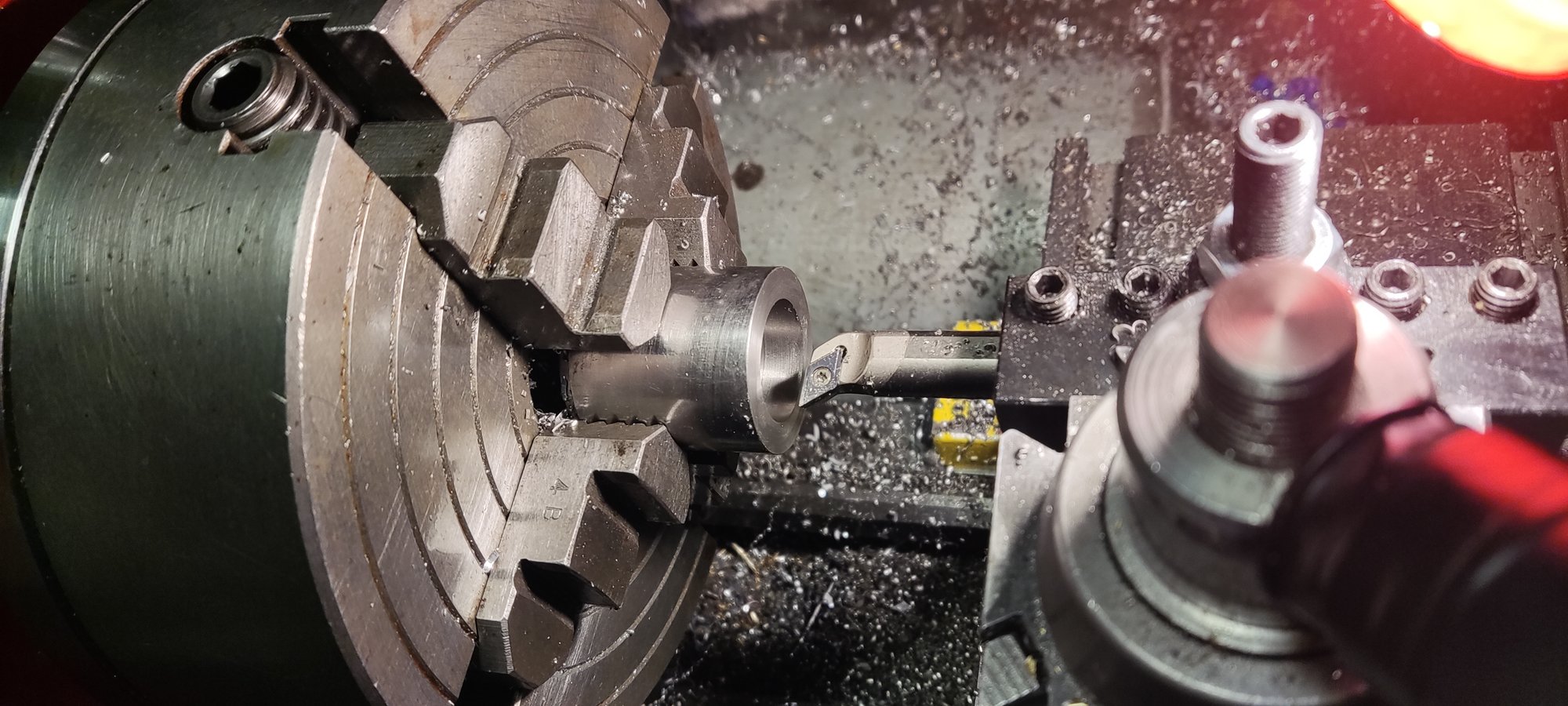

Turning a bit of stainless as I had the 4 jaw in there. 23mm bore. Trying to get some projects done and this one has been nearly a year!

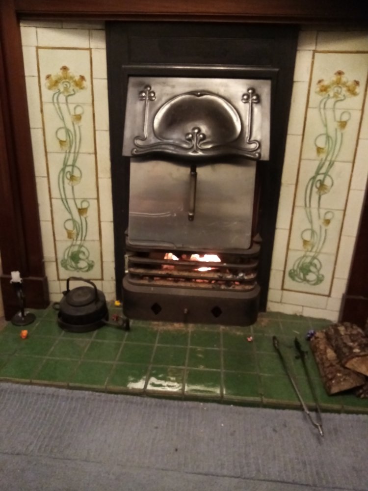

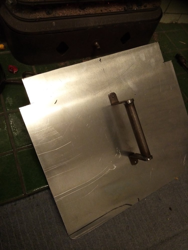

Made a blazer or bleezer as they are known here about. Great for getting the fire away fast. Beats a sheet of newspaper propped up on the coal shovel![]()

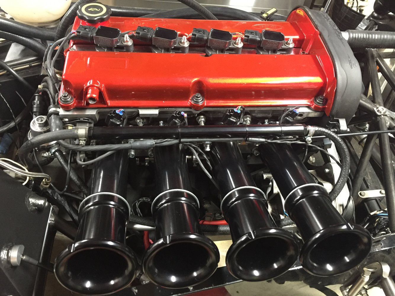

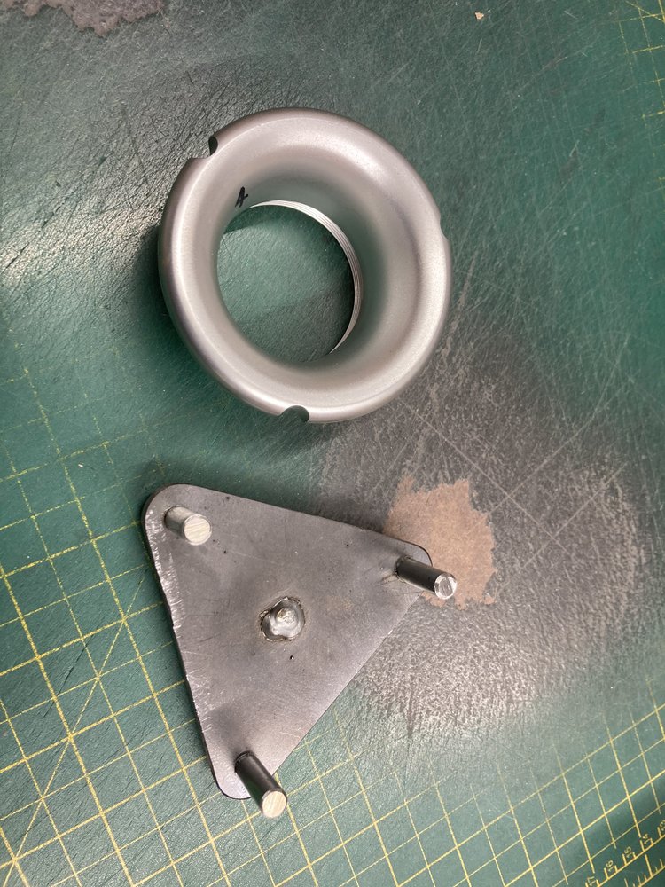

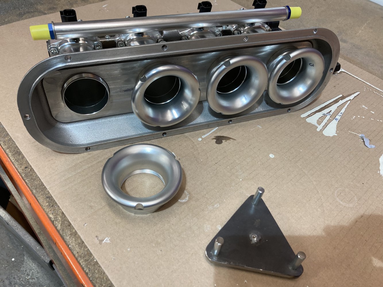

ATPowerThe thing I built is the triangular shaped part shown in the pictures. It’s a special tool with three 8mm pins at exactly 88.25mm PCD to snugly fit into the three divots in the lip of the velocity stacks on this throttle body set-up. Without a tool like this you can’t torque the stacks enough for an air tight seal. The tool looks simple, but if the PCD was off by even 0.5mm it wouldn’t work. Tricky to make with basic tools. Buying the ‘correct’ tool would have been £42, so I thought I’d give this a try.
Nice, show us more please.Yes - AT Power. Yours looks good. What's it in?

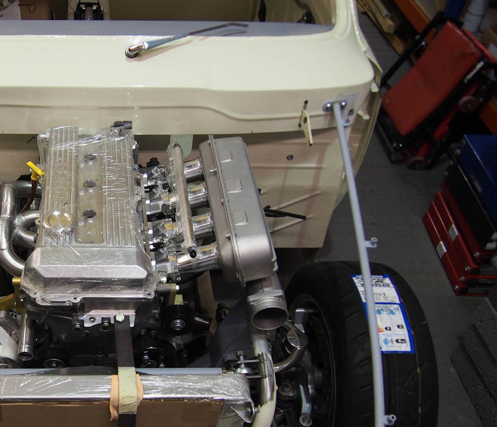

Here's mine. 2.5 Duratec in Mk1 Cortina.
Very nice !!Yes - AT Power. Yours looks good. What's it in?
