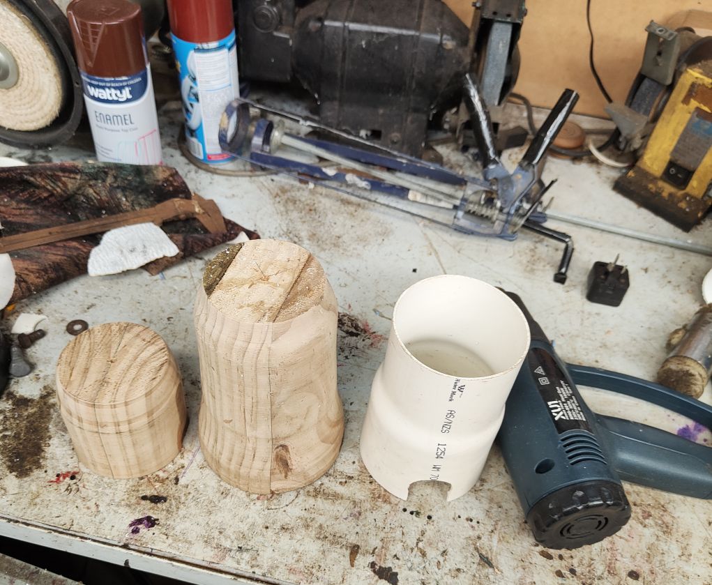

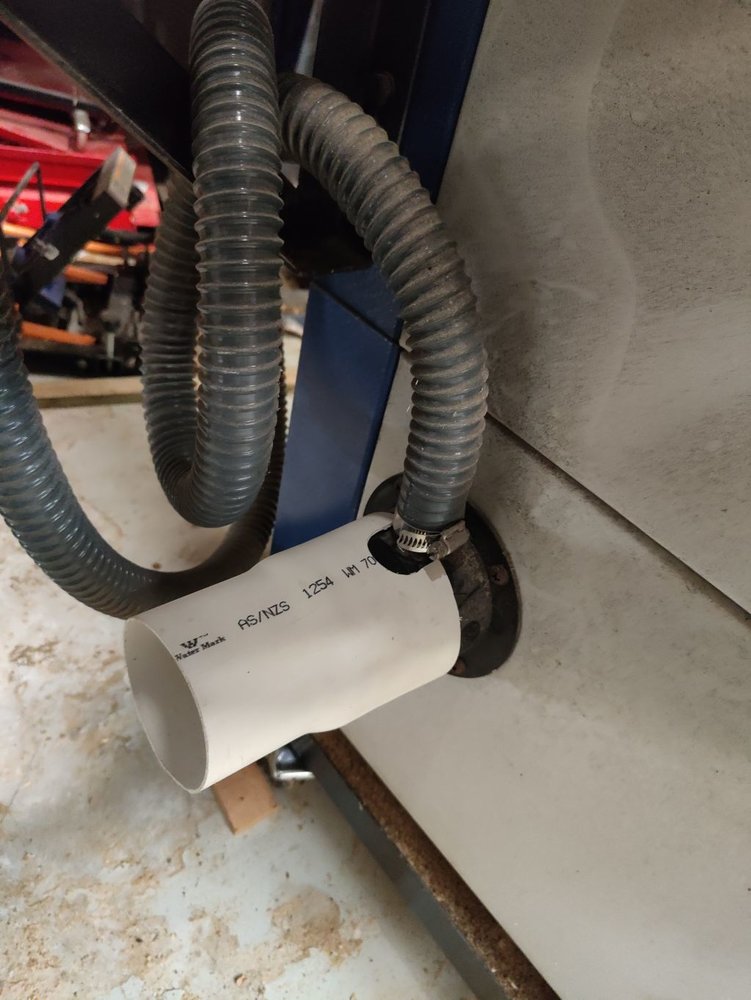

Also for my sawbench. The dust extractor port on it has a spigot around 25mm long then there is a hose takeoff to the top of the guard to catch sawdust there. The extractor hose doesn't stay on. I made an adapter form an offcut of 90mm downpipe. Glued up some wood offcuts, turned the former and used a hot airgun to soften the plastic. It took a couple of goes to get it tight fitting.
I think I need a 3D printer - it would have been faster and I would have been able to reinforce areas with a 3D print.
