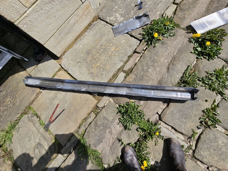

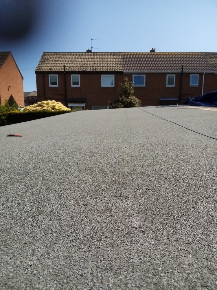

2m of lead roughly formed around a bit if 2" x 2" ready to "simply" drop into the stone gutters on the porch. I say simply, it would be if there wasn't a stone roof on it and the roof felt getting in the way.
It didn't go into too badly, about 8 Fs to the metre
I did the other one yesterday while the weather was fine. No pics as I was lathered in Soudal lead sealant.

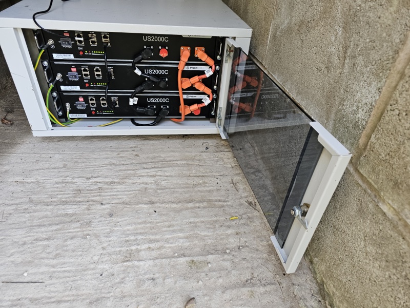

The sun is cracking the flags today, I added the two solar batteries I bought a couple of weeks ago to the existing battery just in time. I've exported over 100kWh since installing the solar last autumn, hopefully this and the solar diverter will stop this. Now I know it all works I'll tidy up the cabling and move onto the solar diverter that directs any surplus into the immersion heater.
