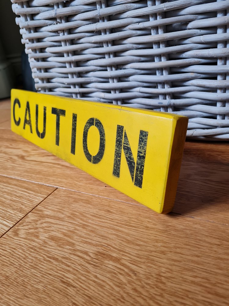

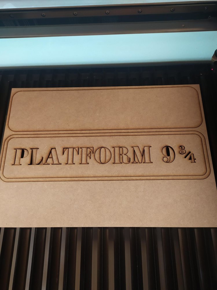

Quite into doing these little signs at the moment.
Kinda a repro industrial feel.
A few minutes here and there, and an offcut of second rate timber.

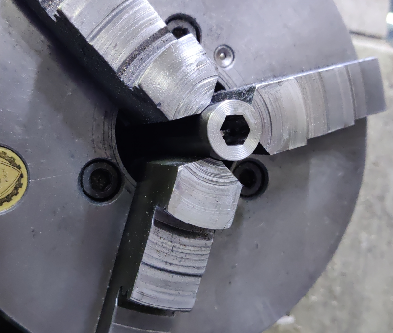

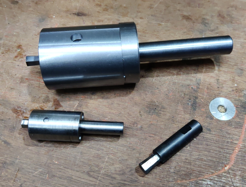

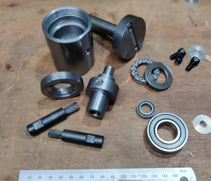

Today & yesterday I made these bits (apart from the bearings and screws, unsurprisingly):
I then put them together to make this (the big one, with its little brother that I made from a kit a while ago):
I then tried it out and made this...
... 8 mm AF, 15 mm deep hexagonal hole in a bit of 16 mm stainless steel bar.
The design was very closely based on the one from the Hemingway Kit that I'd previously made. I basically just doubled most of the dimensions and then tweaked it for 12 mm silver steel broaches and to suit standard size bearings (as you can't get bearings in exactly double the size of the ones in the Hemingway kit).
The Hemingway kit one will do up to 6 mm AF and up to 7 mm deep, but I want to be able to cut a 14‑ish millimetre deep, 8 mm AF hole for an upcoming project and I thought it would be fun to see if I could scale up the Hemingway design.

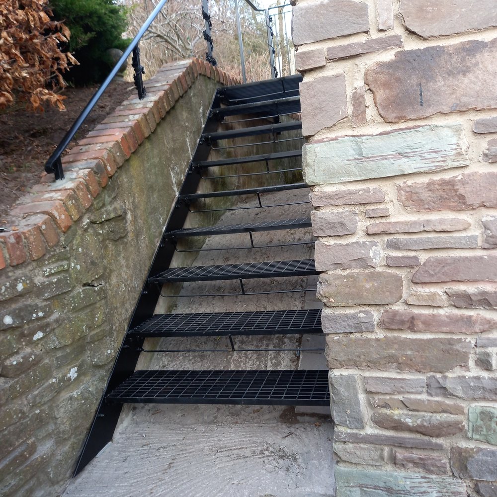

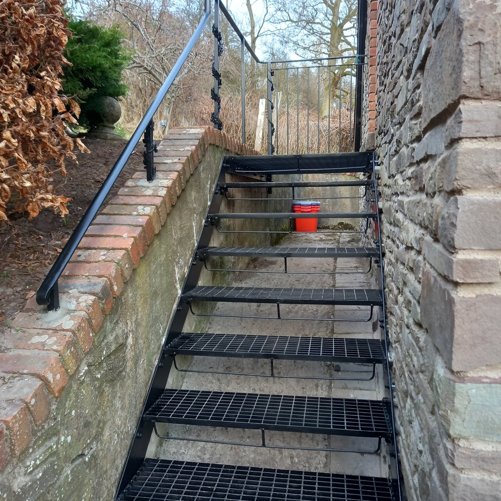

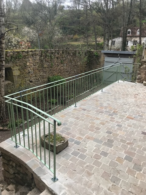

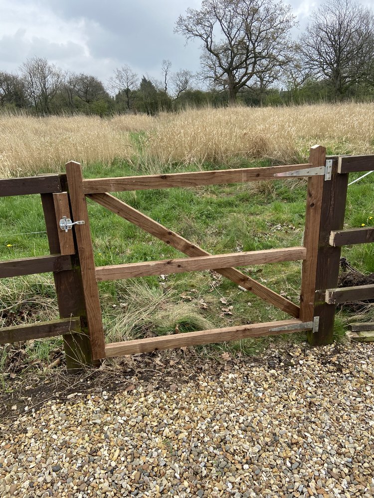

Link not workingNot made today, but installed the railings I made last month. Back tomorrow to give a final coat of paint.

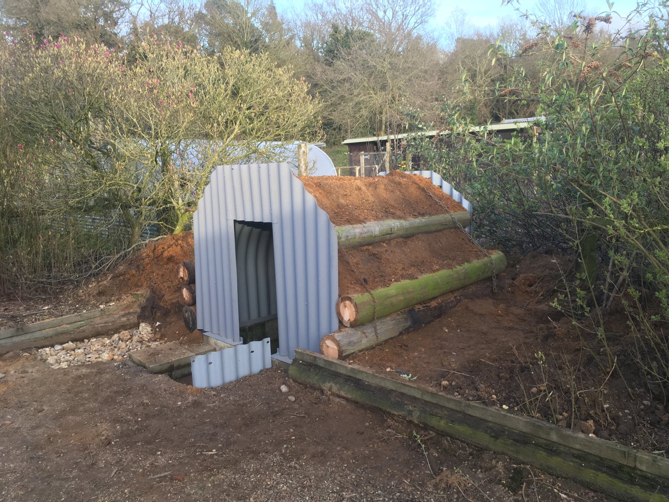

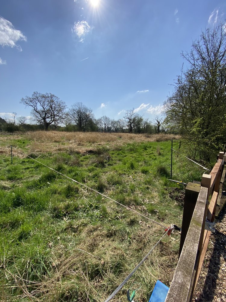

Nice piece of land you have there, what you now want is a flailmower.Fenced half the new paddock off and started hacking the savannah down with the strimmer. Its called “marsh field” on old maps and I can see why. I reckon i can hide a small turnip patch at the back without yard woman knowing
