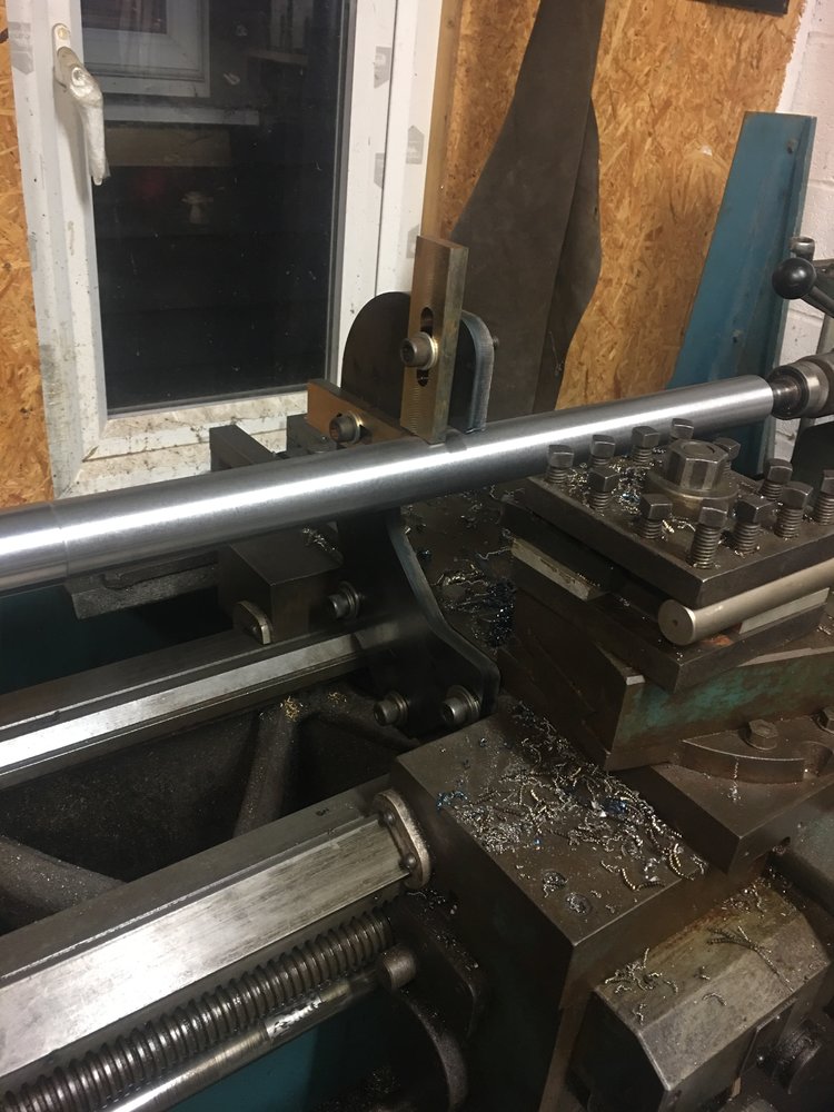

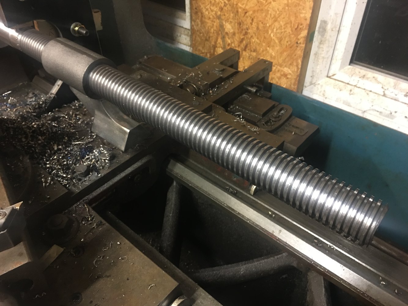

You donut, why didn't you ring me?Made 44mm vice screw and a quicky travelling steady
Needs bsw bolts for steady. Got stuck in traffic and ruined half a day getting them , got home and they’d given me unc
Then I found some at home whilst looking for m12
Power been off since Friday but they’ve connected generators now so I could get on

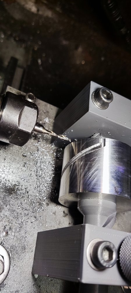

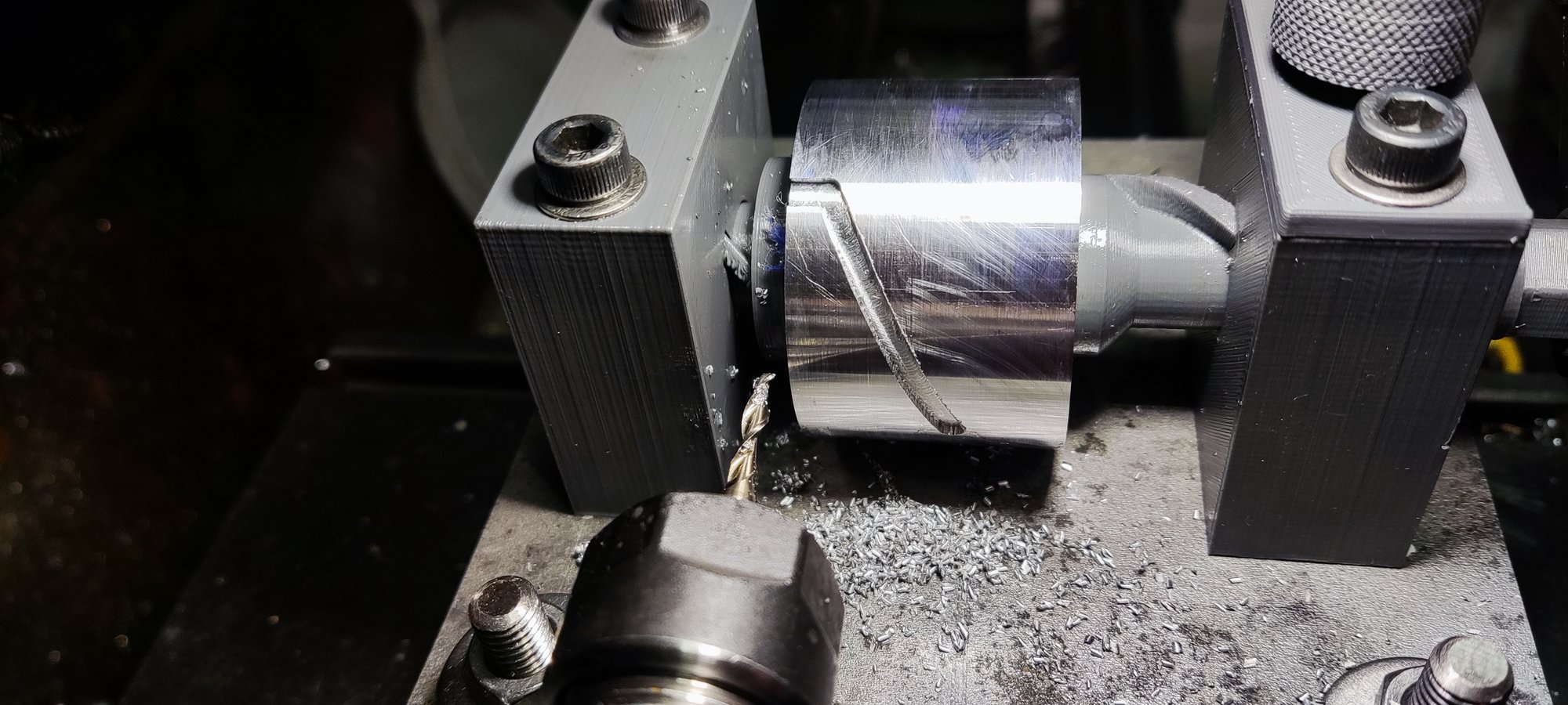

I had an attempt at helical milling with @Onoff 's printed jig.View attachment 389407View attachment 389408View attachment 389409
It works! Three 1mm deep cuts.
Difficult to feed smoothely and can see it in the finish.

Would a four or six flute cutter make any difference to the finish of the helical?As per the pm I think they're "chatter" marks. Basically the irregularities and imperfections of the print being faithfully transferred and "copied" by the cutter. I'm oddly pleased it copies so accurately!
I used silicone grease on one of the assemblies to smooth the action.
Are you cutting that dry? I reckon some cutting lubricant would help.
