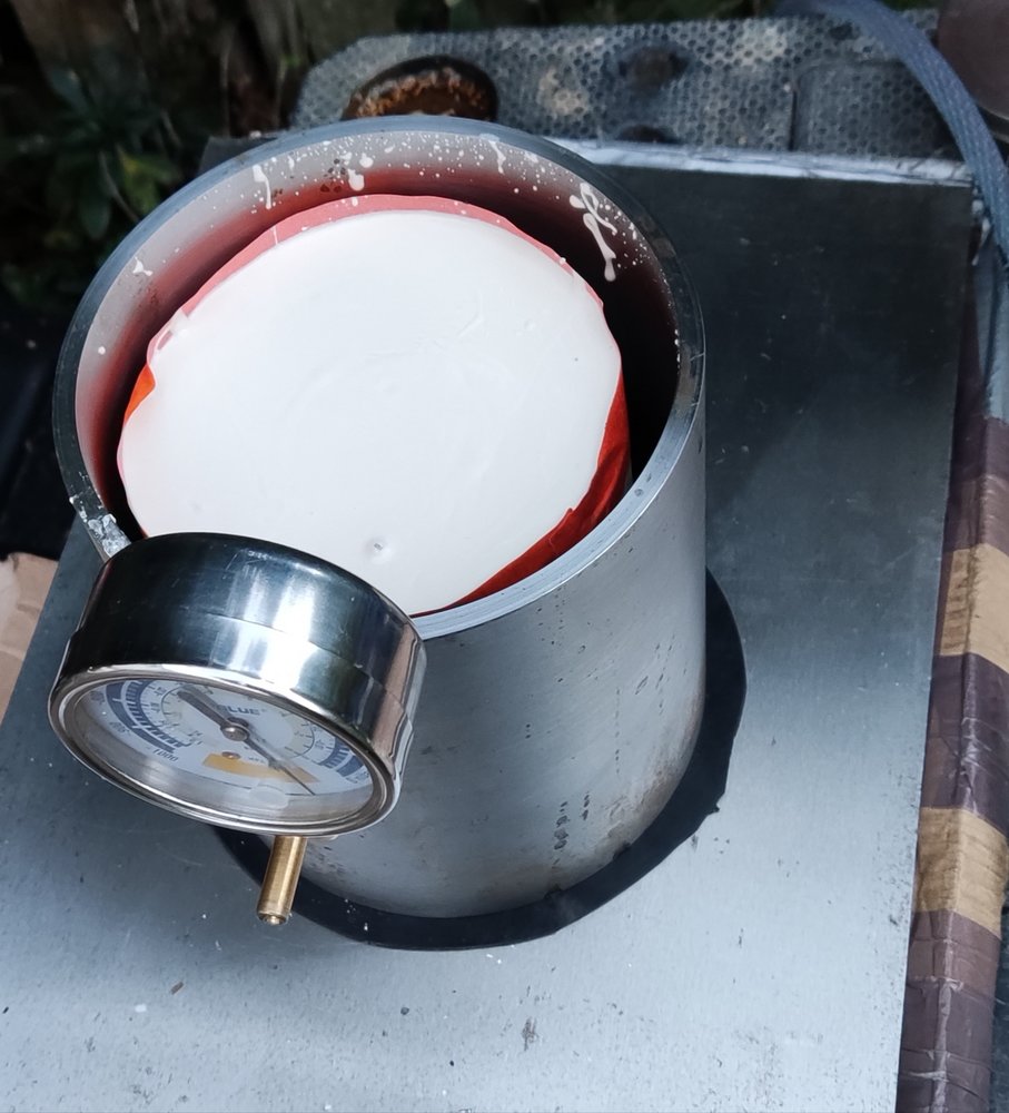

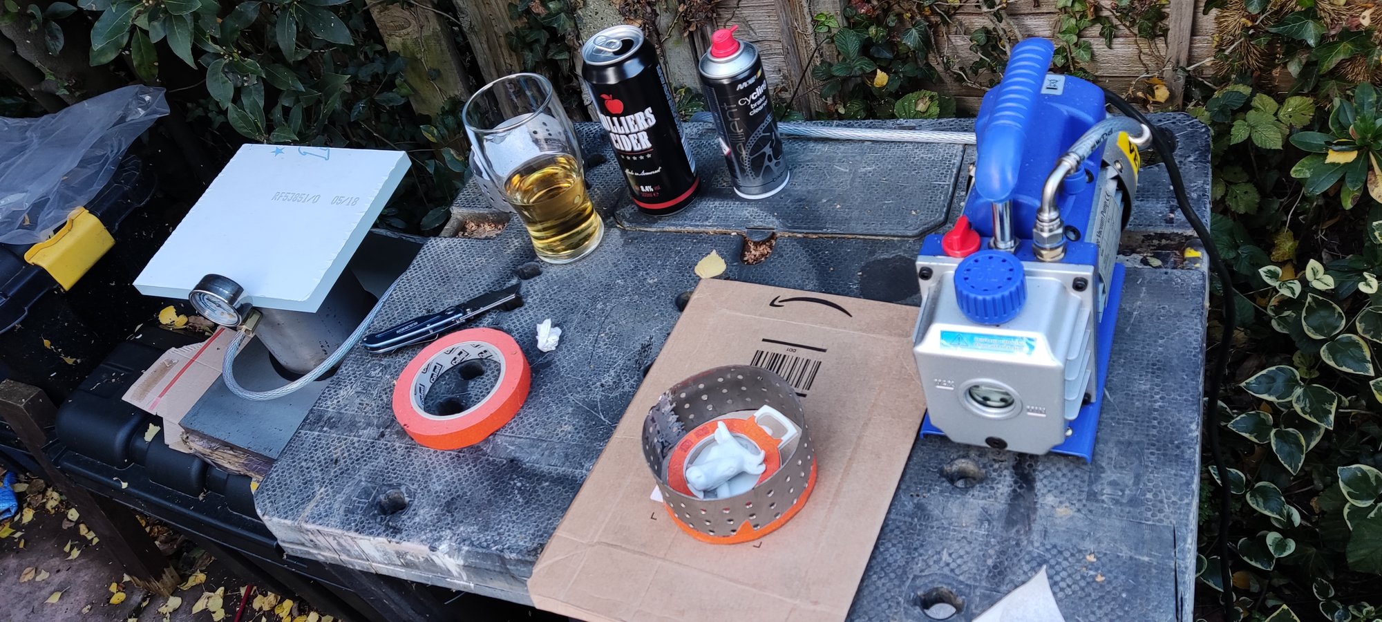

Stick the form to the base plate of the mould with silicone mastic then when it's set make the rest of the cast .Found a spare couple hours to mess about.

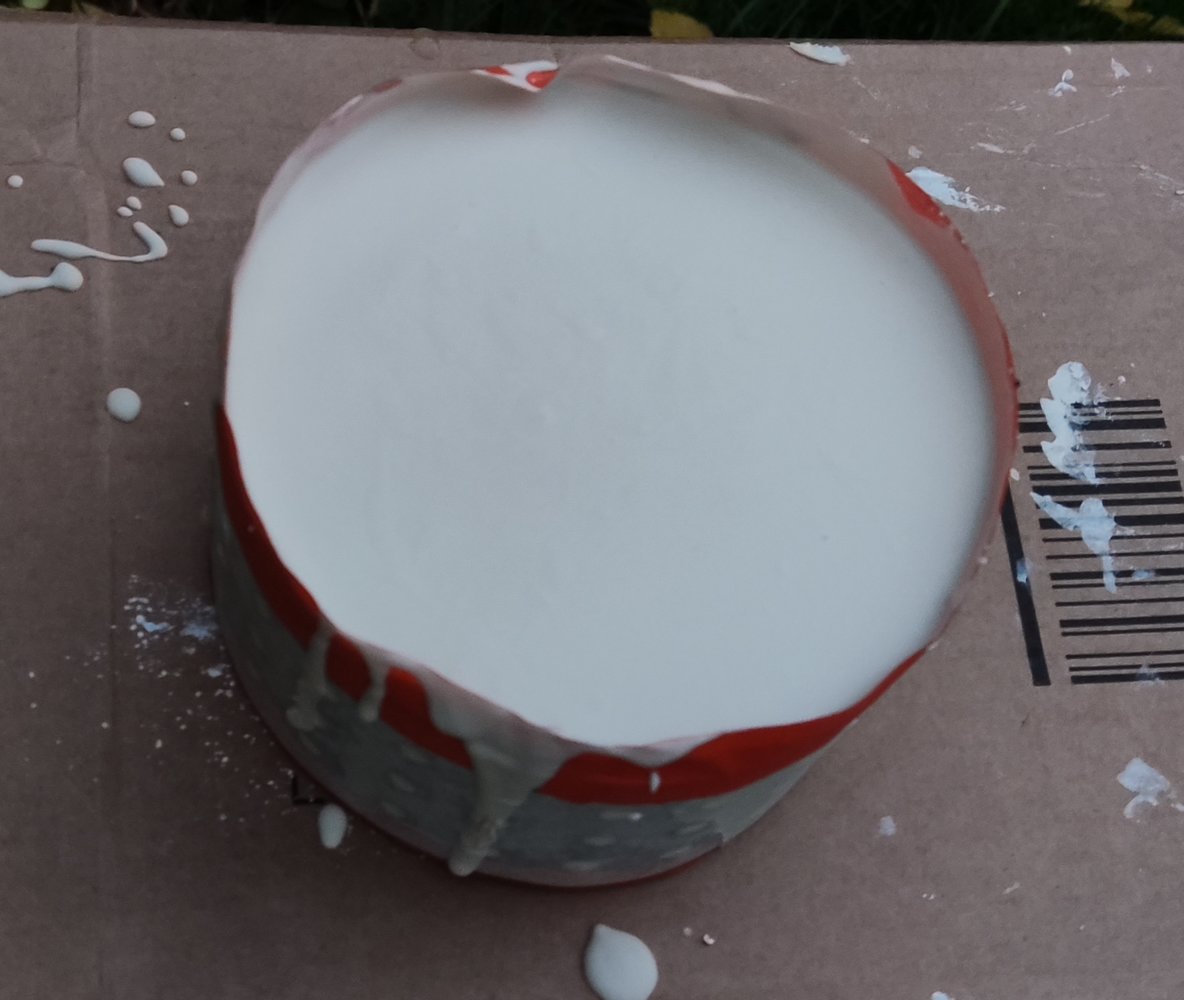

Took me way longer than expected to pour the plaster and may have messed up the timing, but it was still very runny. 3 mixutes to mix, powder to water. 1 min to vacuum. 1 min to pour. 2 mins to vac and release.
Upto this point it was going quite well,but who knew that PLA floats!?!
Saw the cows nose bobbing above the surface. Stuck my fingers to try and position it until started to set. I may have cocked this up!
Theres not much clearance between the print and flask so I wouldnt be suprised if it cracks in a thin place.
I went with the measures for a 4" * 63mm flask, 262ml water, 652g plaster, Id say about right, only a little excess.

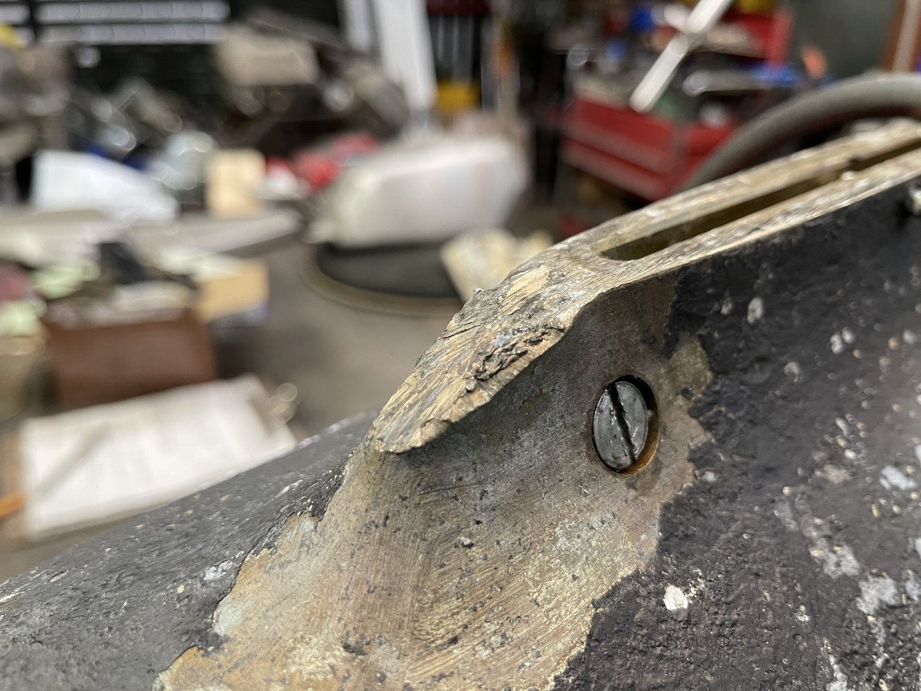

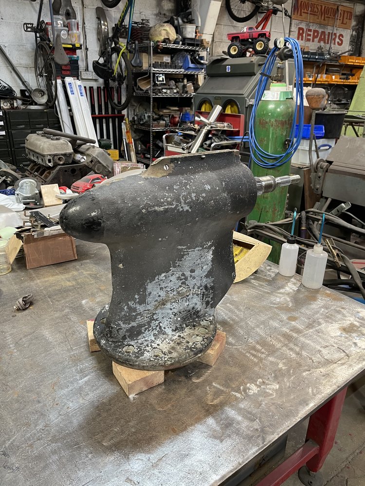

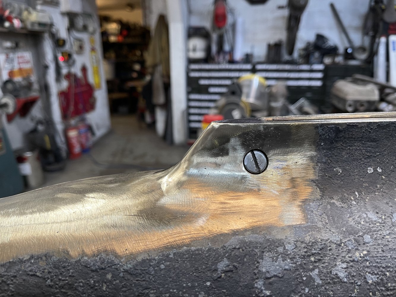

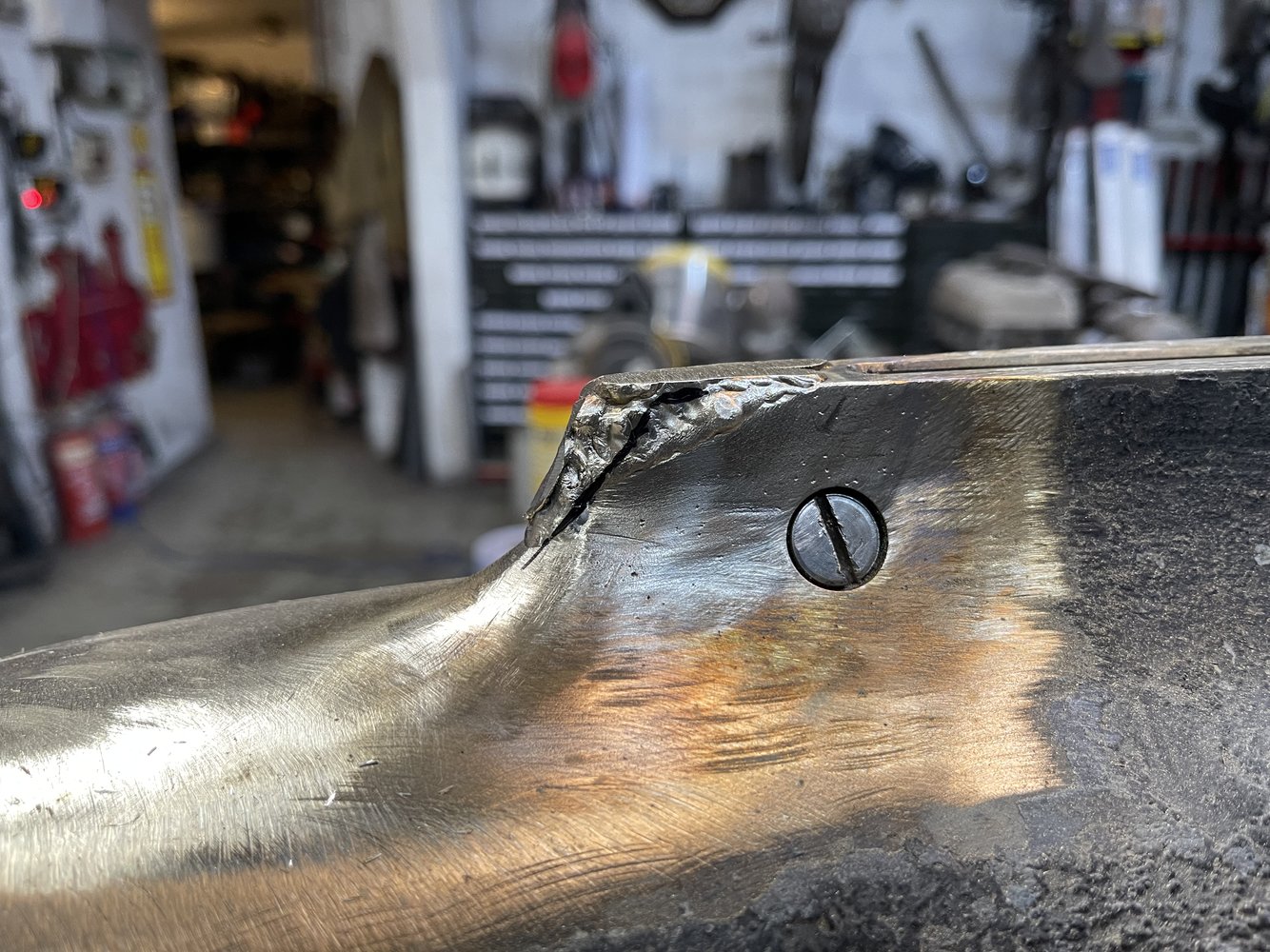

Is it bronze?I spent my afternoon building up and resculpting a big gouge in a marine pod. Not the simplest thing to weld as I was using long 6mm slithers of the parent material as filler rod but it came out ok.
