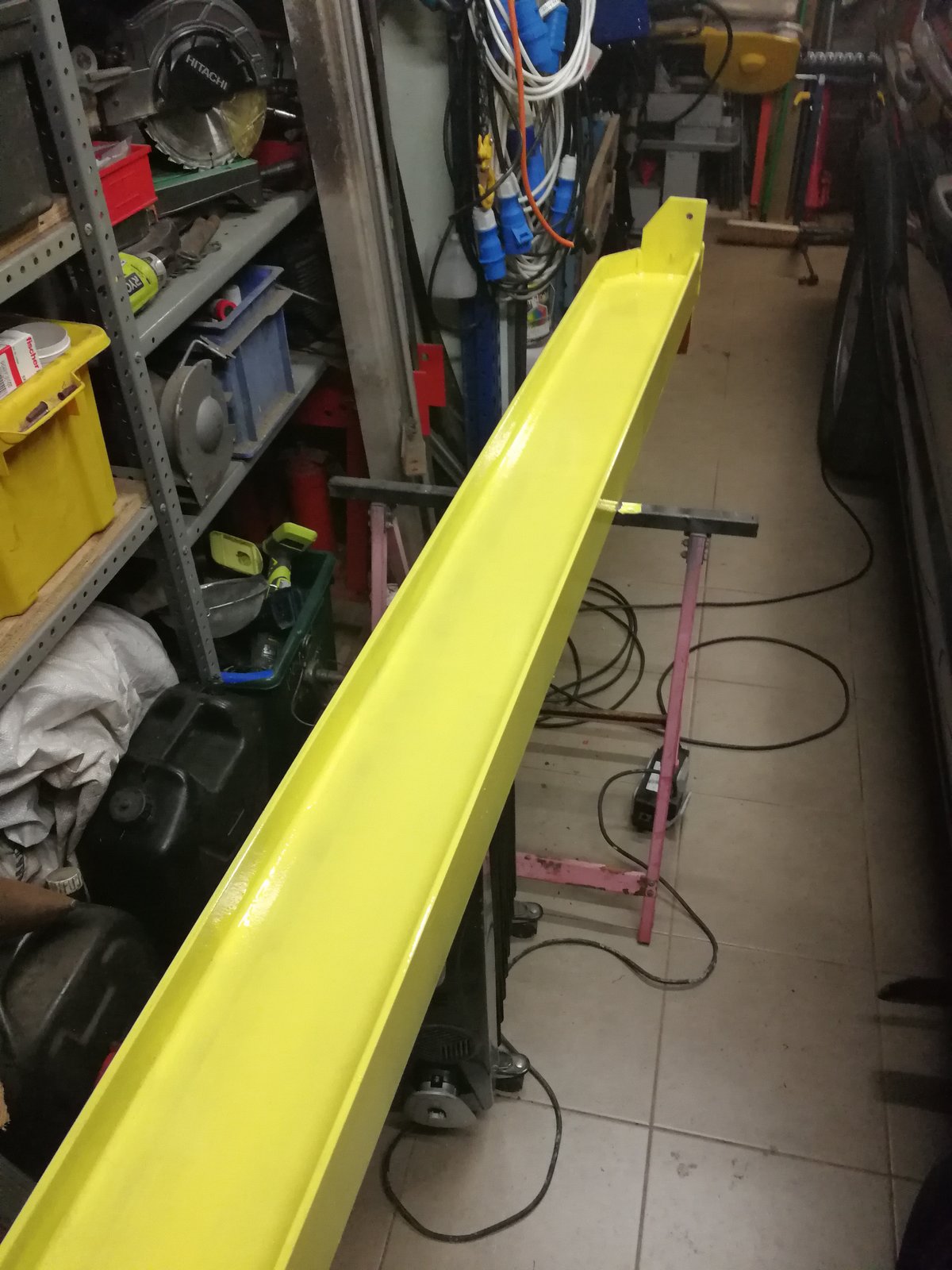

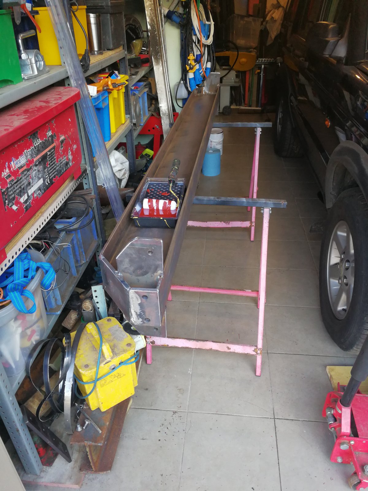

Not today but over the last 2 weeks managed to make some more progress on the lifting frame
Cross beam ready for painting
6 days later it's yellow, cold weather really slows down the paint drying time

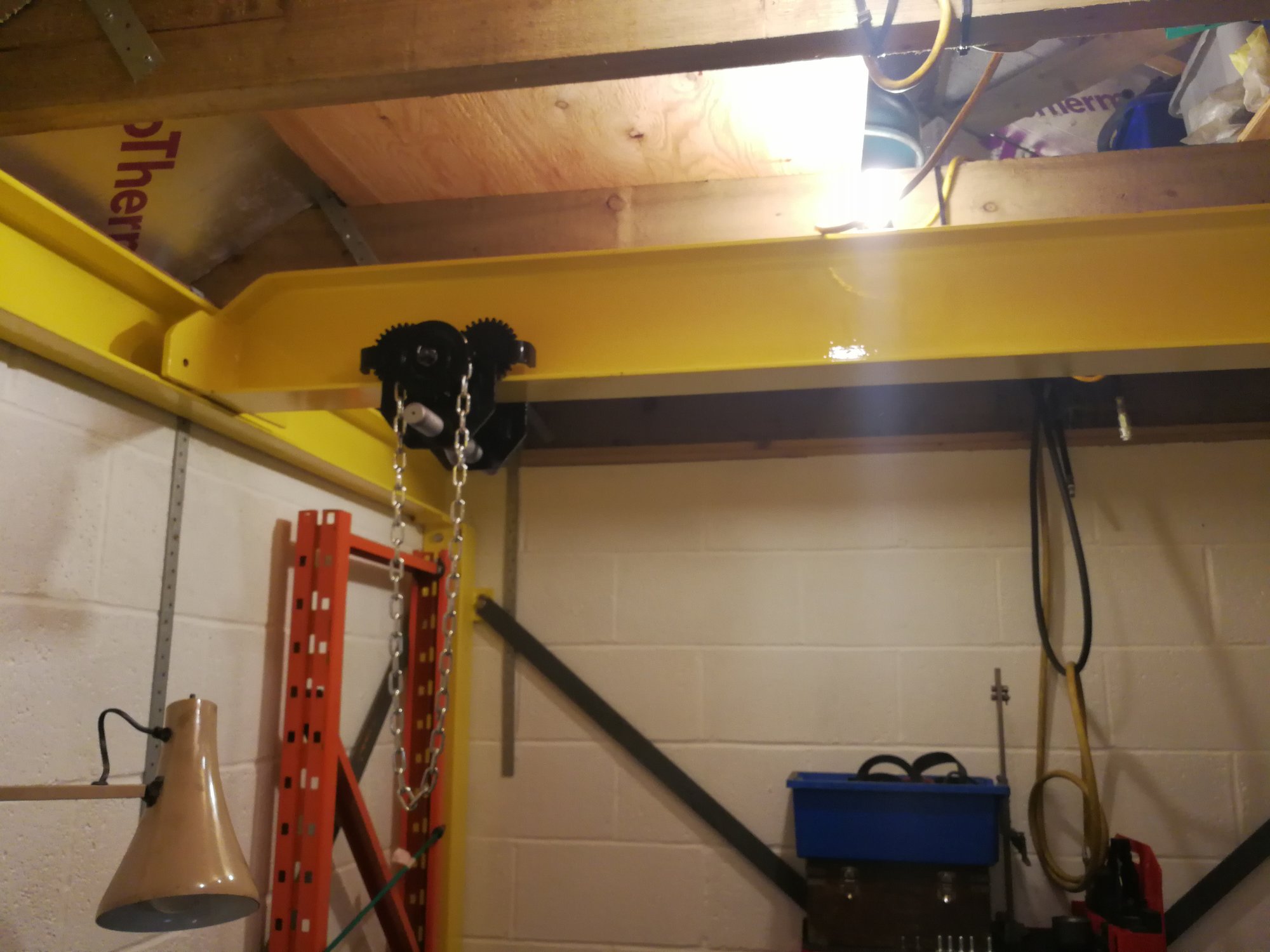

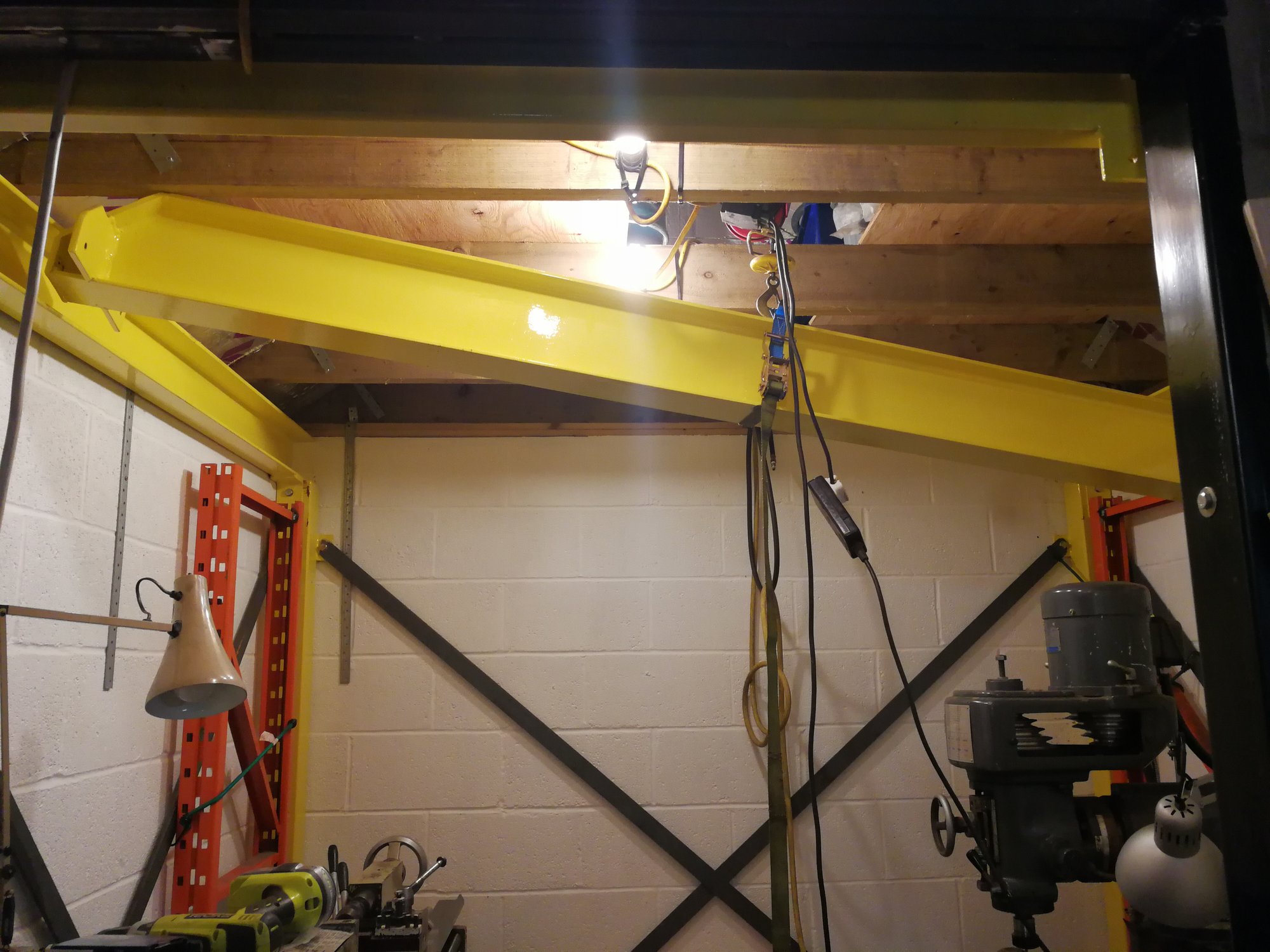

Lifting into place
Acquired some wheels off an old Dell Server cabinet, needed to slim them down to fit and open up the centre hole
Turned down some tubing from the scrap bin to make spacer tubes, think it was an old bottle jack handle off a Range Rover P38
Had to try the girder truck for size
And fitted the wheels
The toothed wheels are part of a roundtoit plan to have some drive mechanism to traverse the girder but for now its useable
