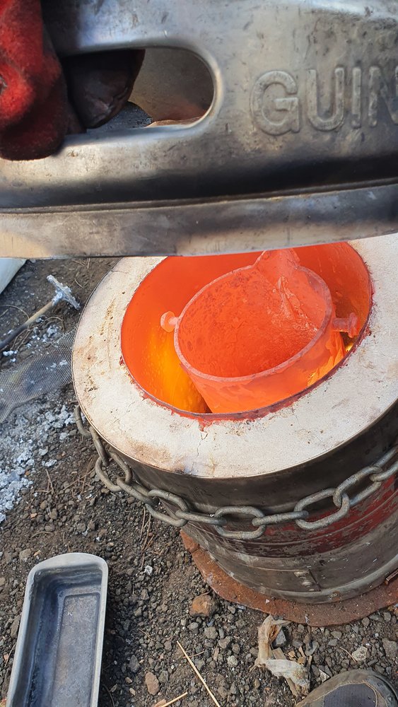

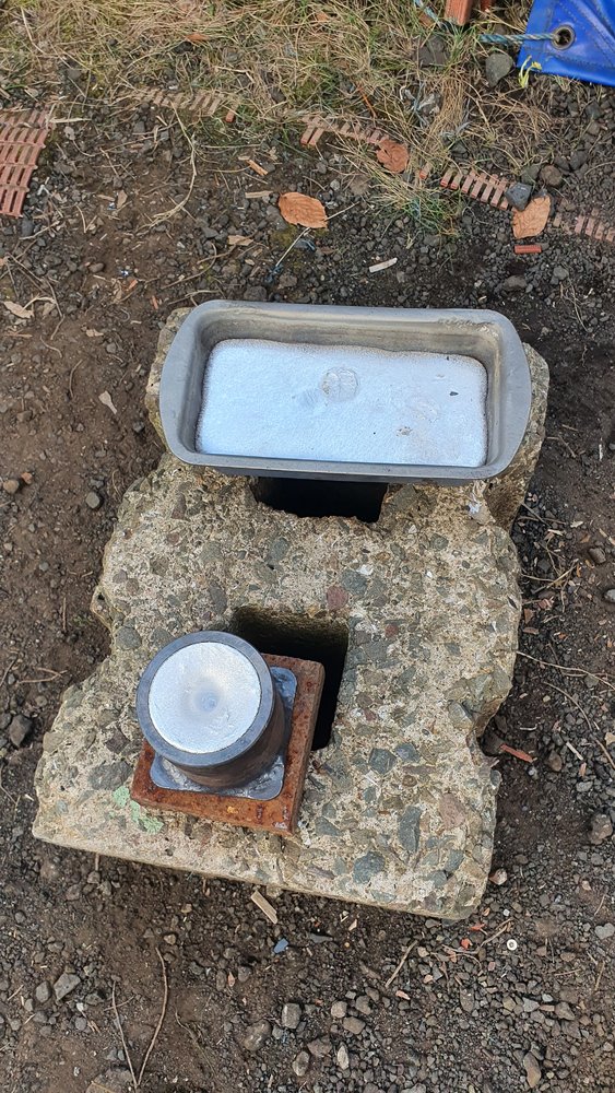

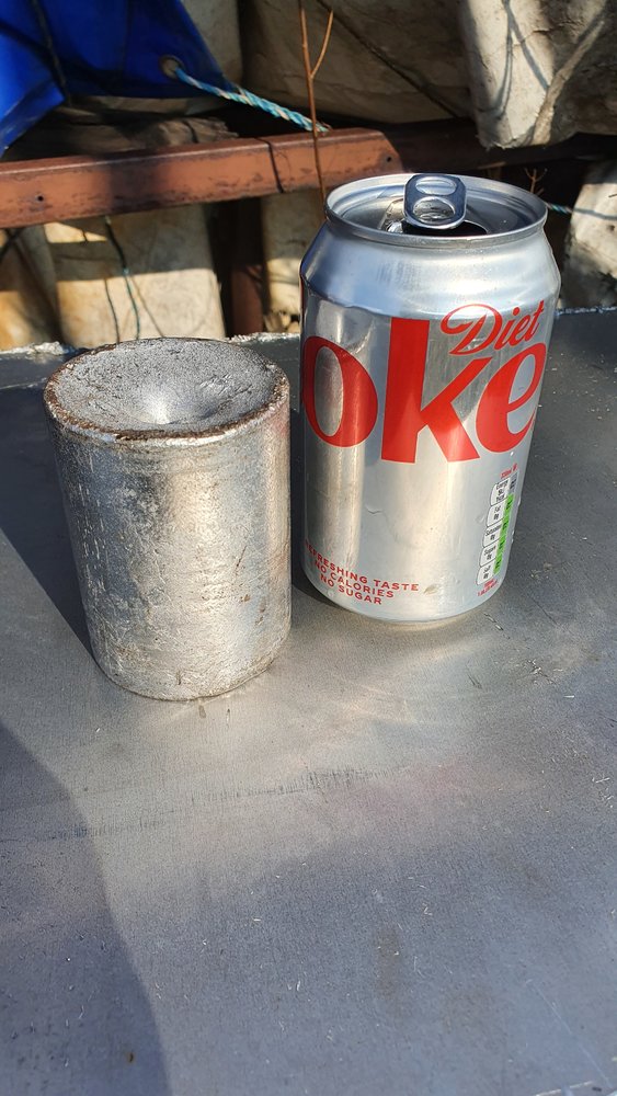

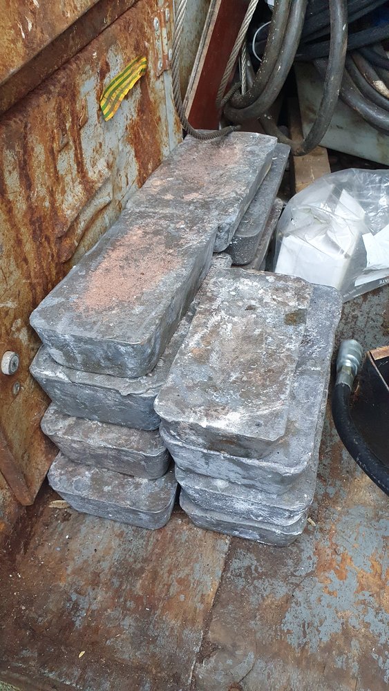

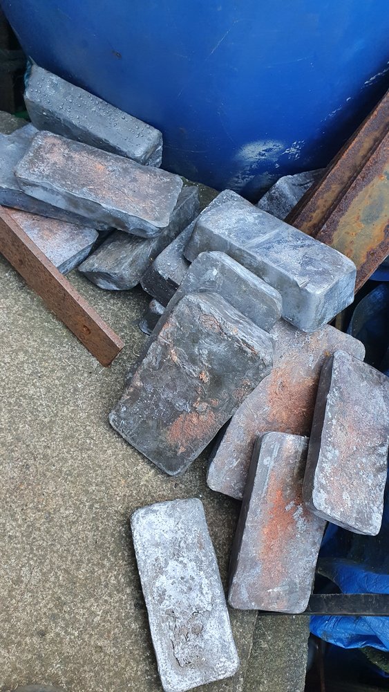

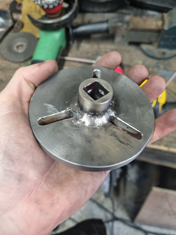

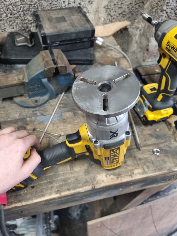

It'll actually be used with a breaker bar. It's made to be bolted to the flywheel of seized outboard engines to rock them back and fourth and free them up. The slots were done on a small waterjet, I just machined it smooth, made the socket and welded it up.If you are doing it for fun or scrap value it looks good.First tests melting ali, have only done lead previously aka poor mans gold as I call it
View attachment 339344View attachment 339345View attachment 339346
The lead
View attachment 339348View attachment 339347
If for machining you need to heat your moulds, then top up. It stops a lot of the shrinkage you can see.

You dont want the mold hot, just be sure it is dry and let it cool off to ambient before pouring.
I've tried that at the beginning, thinking the same and had bad results, then I did some reading up. For thick sections you should cast against a cold chill. Gives smaller grain and no porosity or shrinkage.no experience with casting here... but I always thought mould as hot as possible was the best bet? and let the pour cool as slowly as possible?
maybe stick a lid on it after the pour to keep the heat in?
When solid, heat treatable alloys should be water quenched then heat treated for best results.
