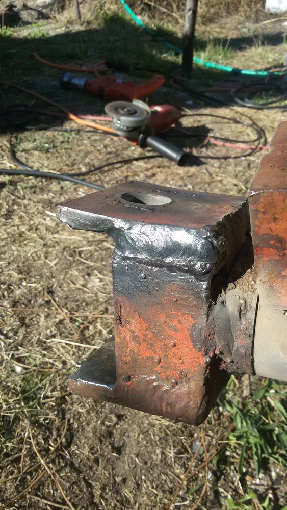

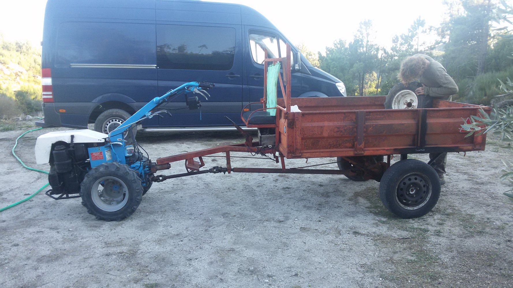

This one cost €1,400 or thereabouts. Not sure what tooling it came with but certainly a rotovator and mower and, apparently, a sodium floodlight. Lots of it are a bit ropey, there's hardly any shoes left on the trailer brakes, a lot of bodging all round, but plenty of bodging still left for me to do. The trailer handbrake consists of a toilet chain welded to the foot break pull-rod, which has bent it. Gonna bodge that better. Anyway, it's very nice to have people bring me their machines to weld up and hammer on.I like your post ,

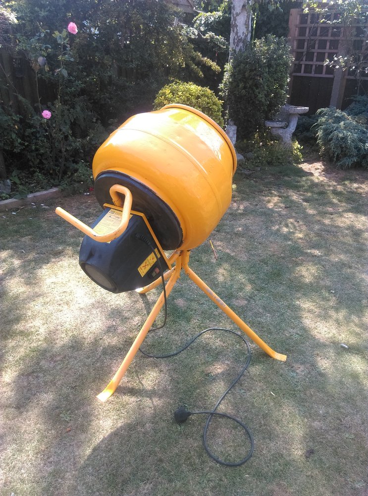

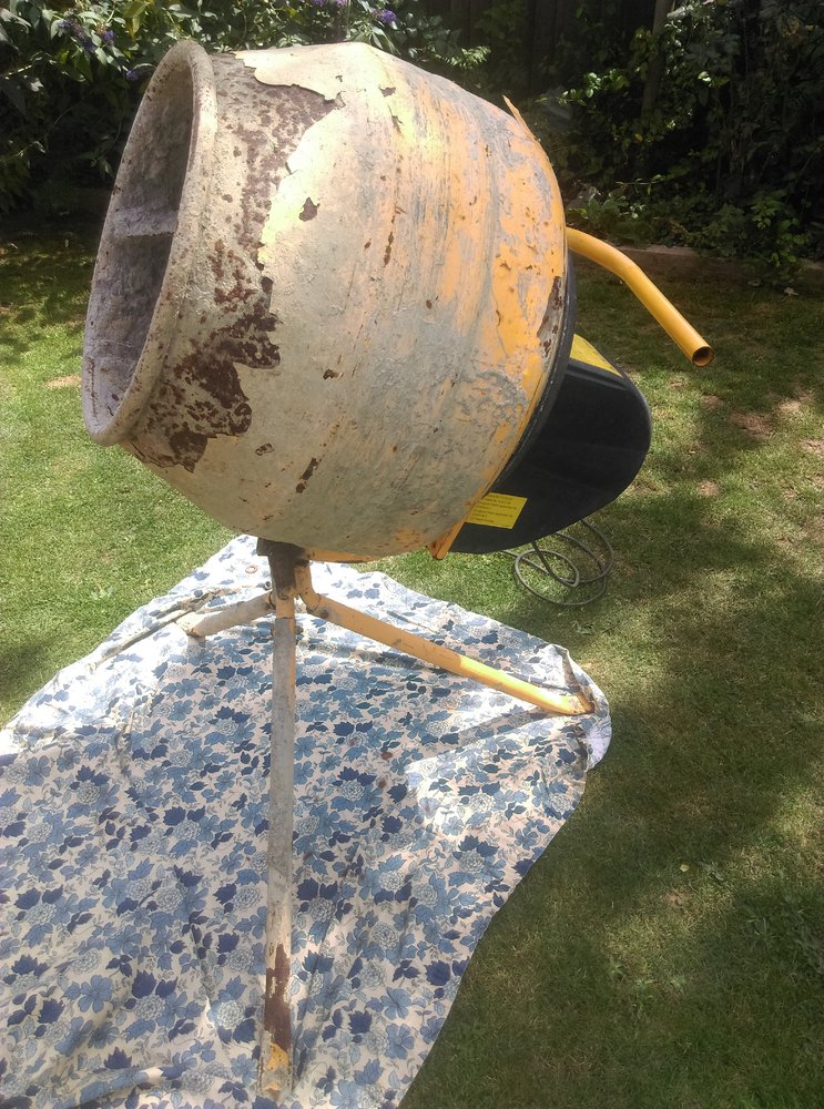

That’s really impressive, I’d have thought it was due for a trip down the scrapyard. Goes to show what a bit of time and skill can do…Walking the dogs earlier in the year and saw this mixer had been put outside a house with a load of other scrap. It looked too good to scrap so I popped back with the van and took it home.
put it together and it was seized-

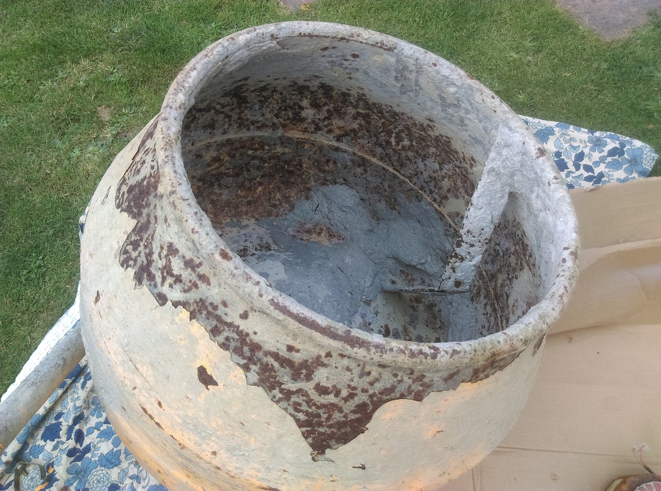

Drum looked ok, hardly used-

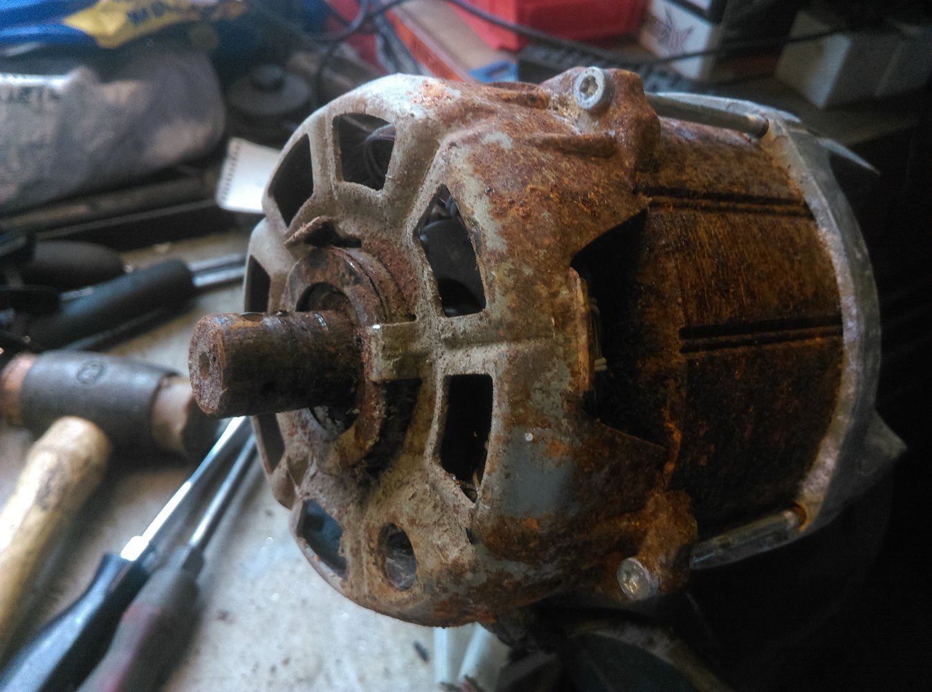

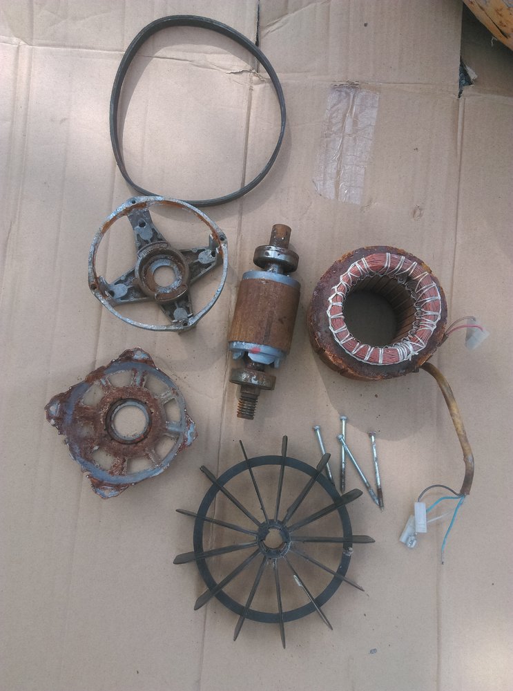

I took the belt off and the drum spun round so motor is siezed then , stripped it down-
View attachment 311117View attachment 311118

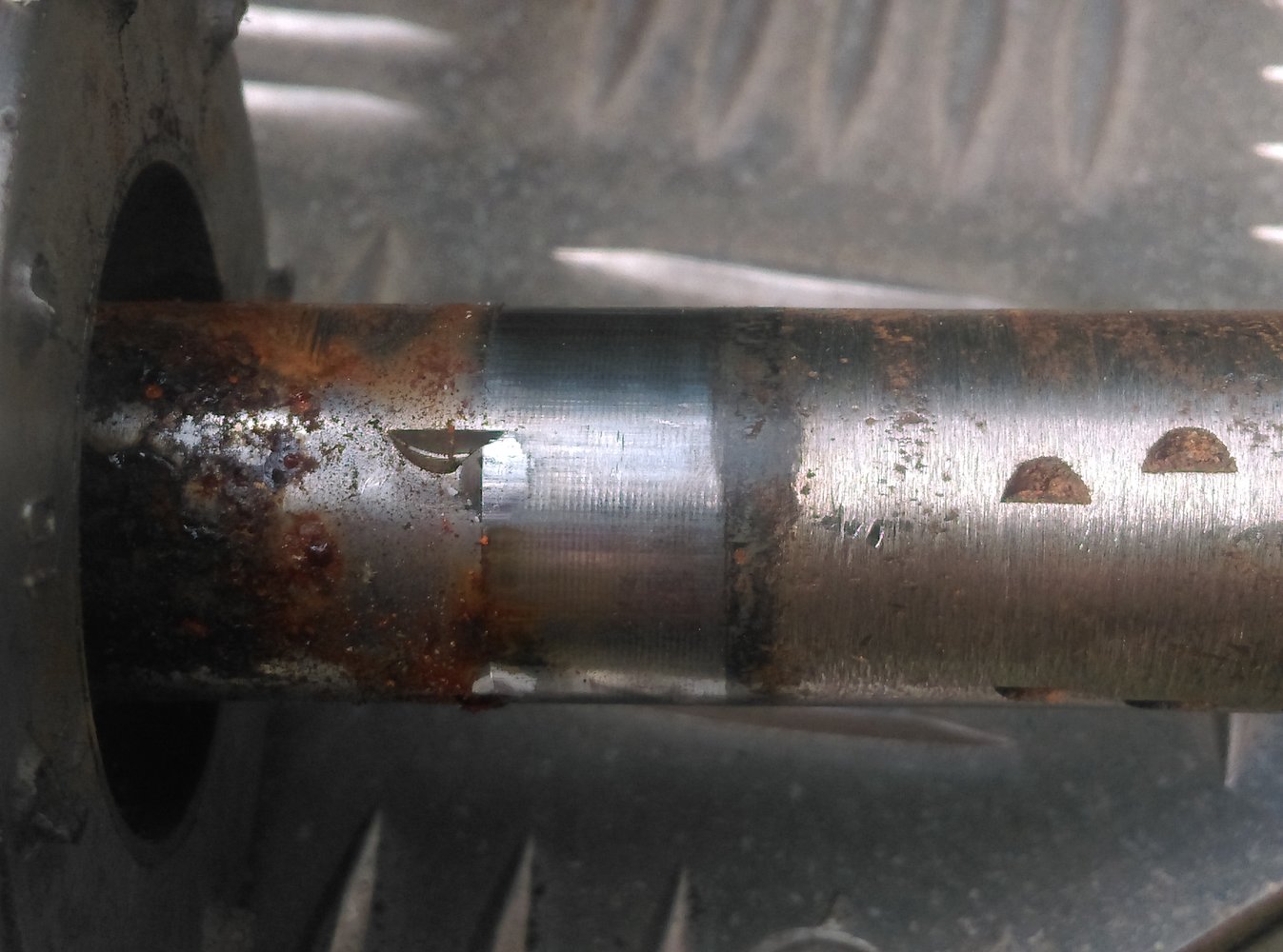

motor bearings were siezed, they were held on the shaft nicely, I ‘spose it saves manufacturing the shaft properly
cleaned it all up, painted the motor, covers etc and all back together. I had some yellow Rustoleum paint at work which was almost a exact match!!
I know its a diy only mixer, but its perfect for me to do small jobs around the house, etc. It all comes apart and stores in the drum so doesnt take up any room either.
Well pleased with it.
fabulous job done there ,and cant beat rustoleum eh .Walking the dogs earlier in the year and saw this mixer had been put outside a house with a load of other scrap. It looked too good to scrap so I popped back with the van and took it home.

If you always spray clean it down after emptying the barrel into the barrow and use three or four shovels of mixed ballast & a couple of buckets of water for the final 10 min barrel clean it will last you years .Walking the dogs earlier in the year and saw this mixer had been put outside a house with a load of other scrap. It looked too good to scrap so I popped back with the van and took it home.

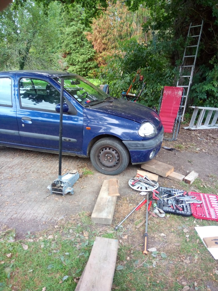

Clio II, 1.6 petrol, power steering and air con. Eventually fought the starter motor out, bloody nightmare.
New starter motor, well, it's half way in, but no further. Just won't go.
Spoke to local garagist, he had the same issue, ended up pulling the transmission shaft.
Really, don't want to do that...
Want to cry....
So inaccessible...

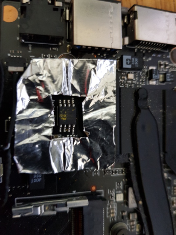

thermal paste isnt a glue, its a transfer medium, so if you need it to create a mechanical bond you need the glue,
