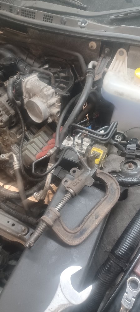

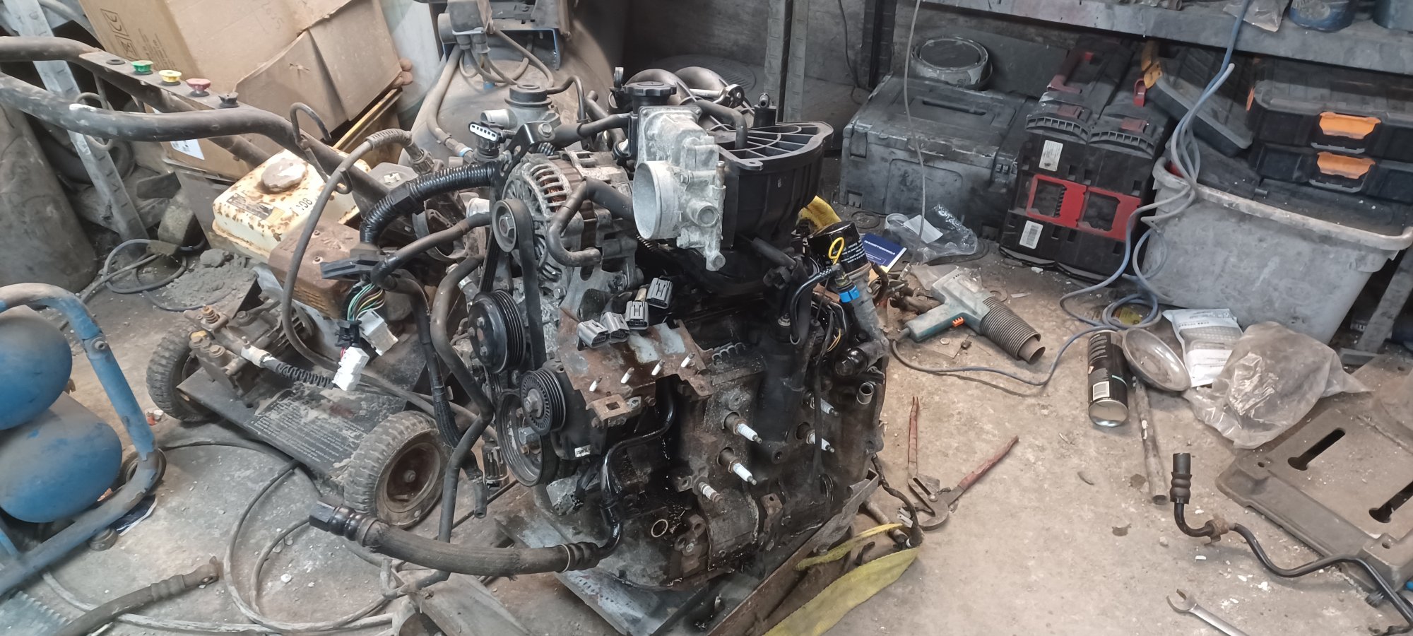

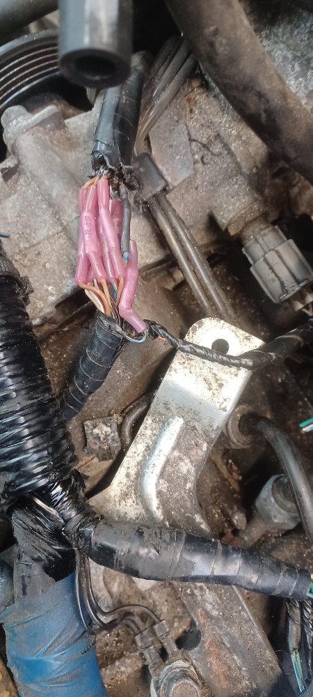

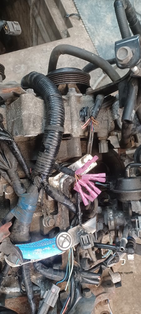

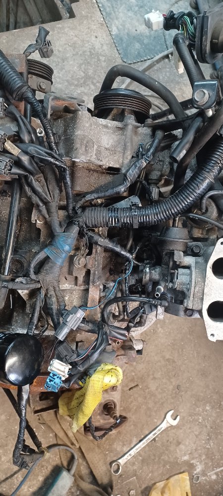

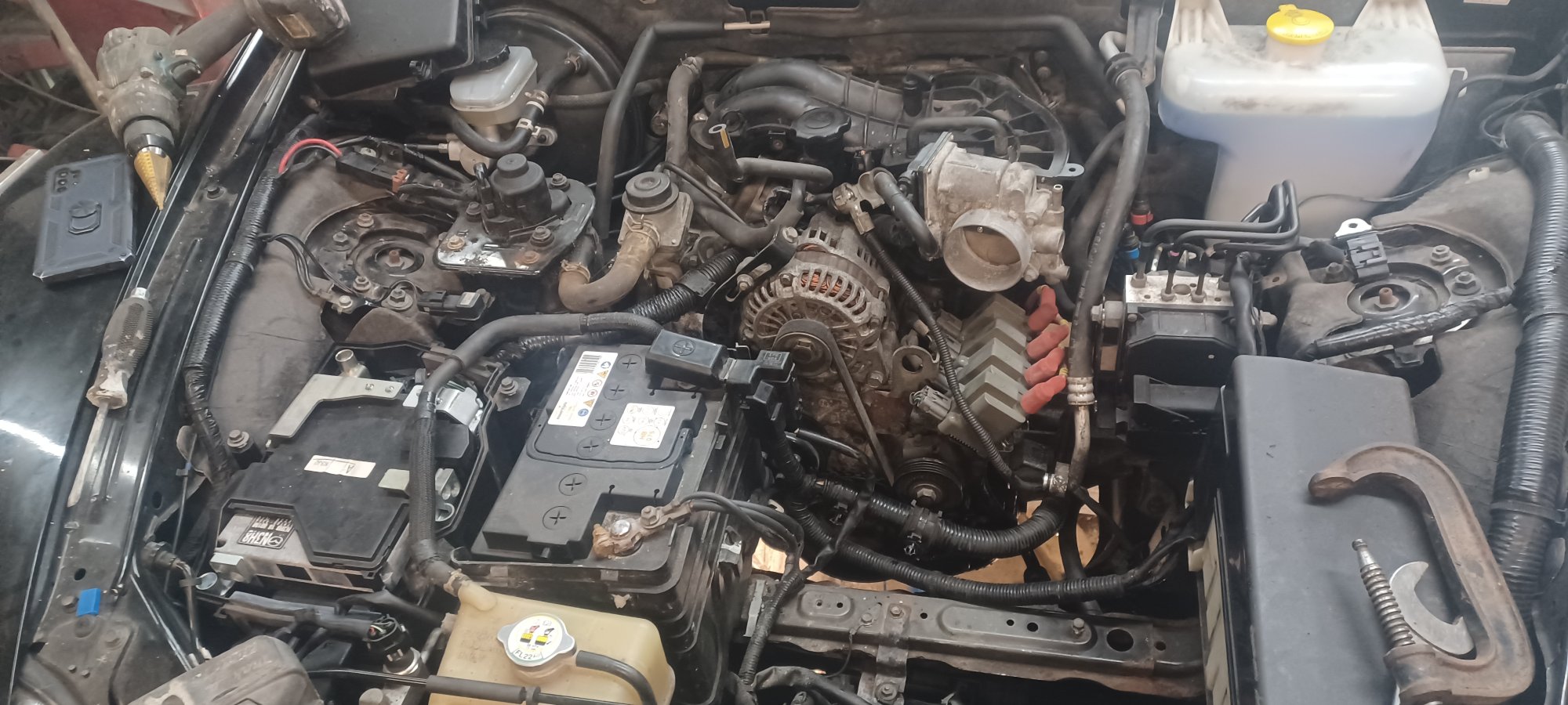

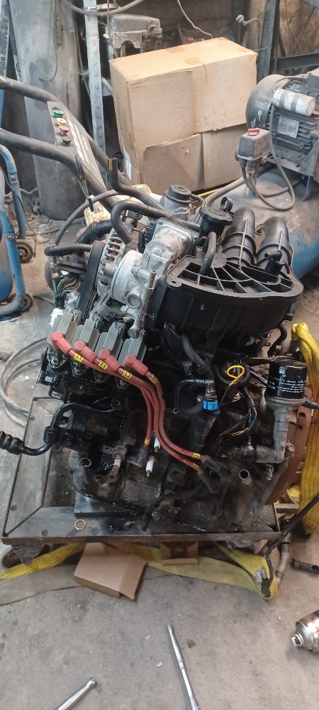

time to put this car back together...omp loom repair was a bit complicated, having to meter it out for 2 white/red wires (meters as common in main loom so no issues there) and 3 brown which involved checking pinout and identifying each individual wire. got there in the end
and then just dressing the engine, hunting out coolant hoses out of stock that fit, finding oil cooler hoses to replace the 2 cut ones, putting my spare rrp coils and msd leads on it (big sad, those where my test set, now i dont have any...)
i need to chase the threads on the l1 plug as it wont screw in, then its time to fit the engine.

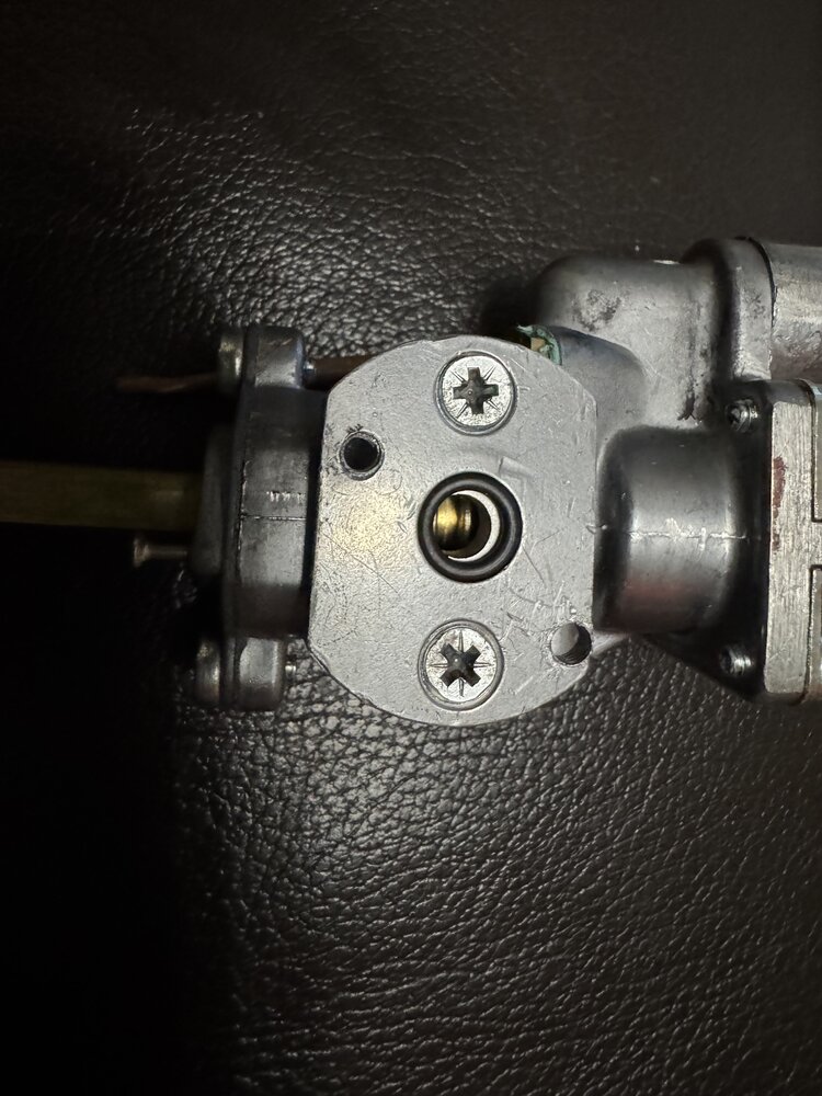

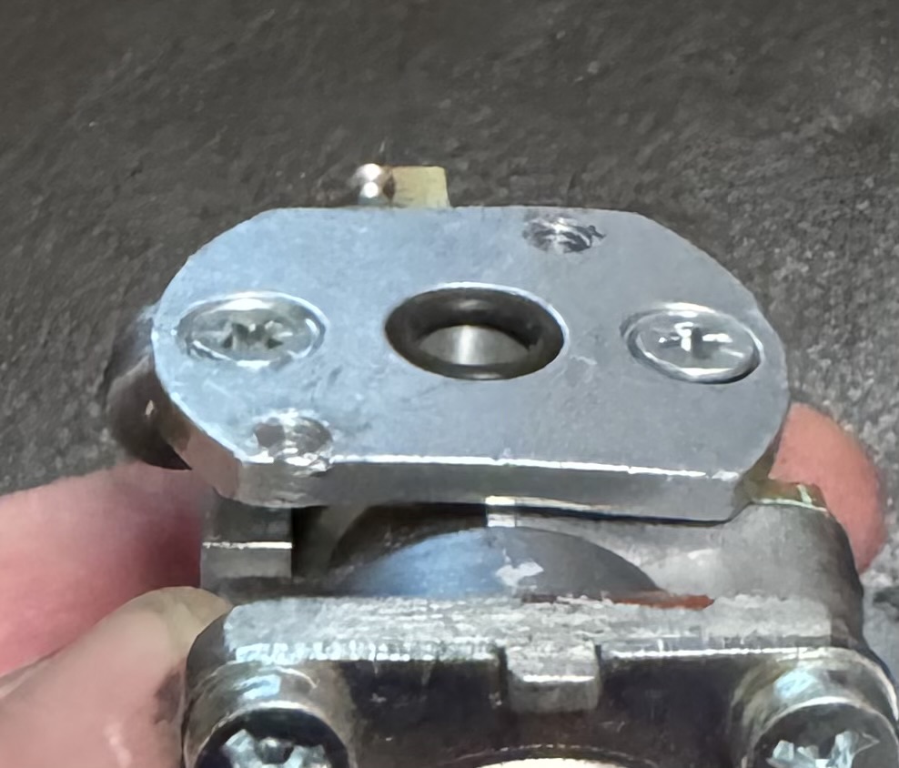

Shanghai Special Wurx - You Phone description, we make.After fixing the oven when the Flame Safety Device failed and smashing my head off the kitchen extractor at the same time, the oven was broken again.
This time oven knob (thermostat for the technical term) wouldn’t turn. Ordered a new to fit today and stupidly amount of stripping down to get to the faulty item. Removal was going OK until the controller for the automatic ignition decided explode and took a lot of trial and error before it functioned properly.
Fitting the new part though wasn’t going to happen and I should have checked it first as it was badly built. The mounting screw holes were way off and not enough material around one of them to hold the screw securely. The plate they were machined into was also warped so unlikely to have made a secure enough seal to the gas rail.
Instead I had to completely strip the old part and rebuild it numerous times until it worked properly again. 3 tedious hours stripping, rebuilding and repeating until I got it right before refitting with lots of leak detector spray to be on the safe side. Fully working with a smooth action again. If anything fails on the oven I’m blowing it up.
The quality (not) replacement part

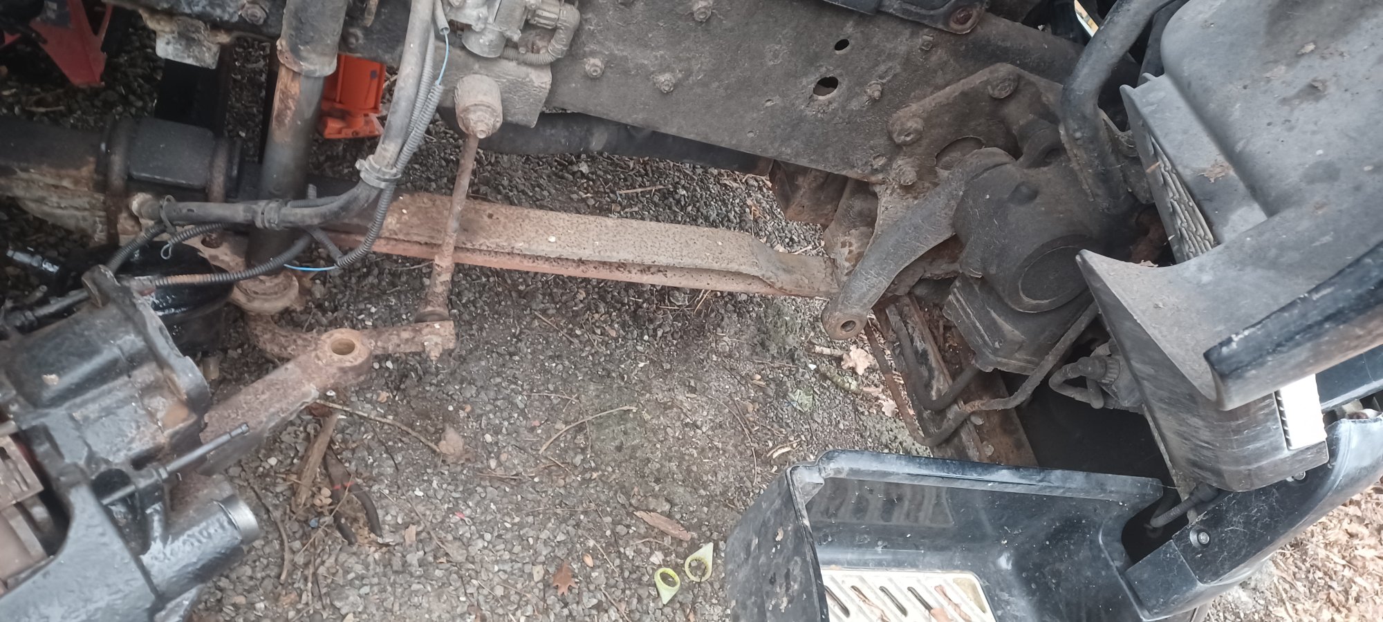

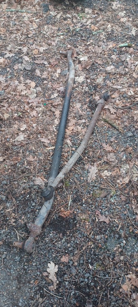

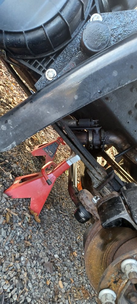

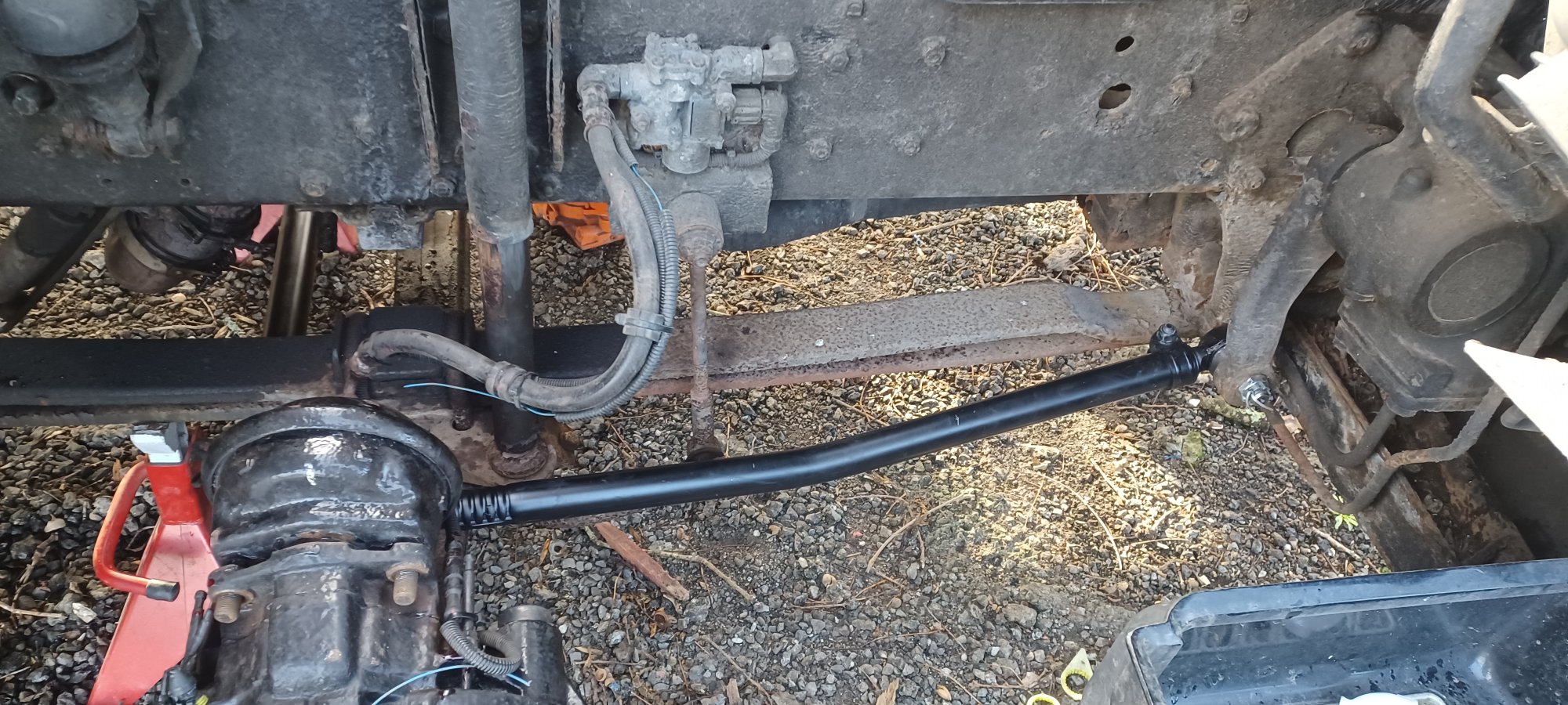

so to finish this off, it deadjusted itself again the next time i drove it. today i took a bit of time to fit the replacement mech id had sitting on the bench a while. in the process of doing so i had to remove the steering control arm as its in the way of the lower bolt. not a issue, right?
the caliper having been refitted, i hand threaded the nut on to ensure it isn't cross threaded, then the big impact was used to run it down.... and the thread immediately disintegrated. balls. worst thing is this is the end with the non replaceable rod end. so that's a new control arm needed then. having taken it off i had a feel of the ball joint, to find it rough as a badgers. hmm says i, what's the betting the ball joints on the steering drag link are just as bad.... indeed they are, so that will be both arms i need then. £250 later those are ordered....
still at least the caliper is good now....
