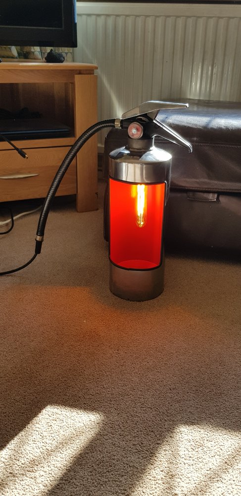

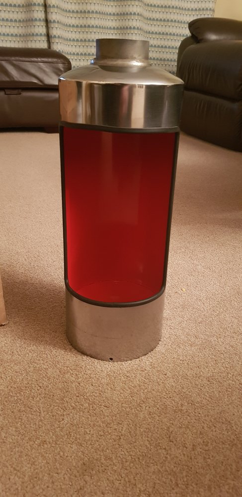

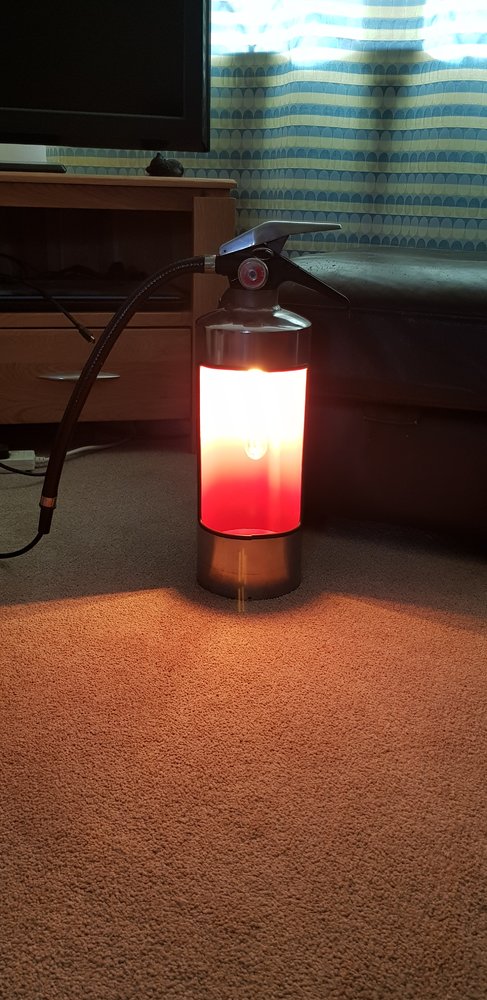

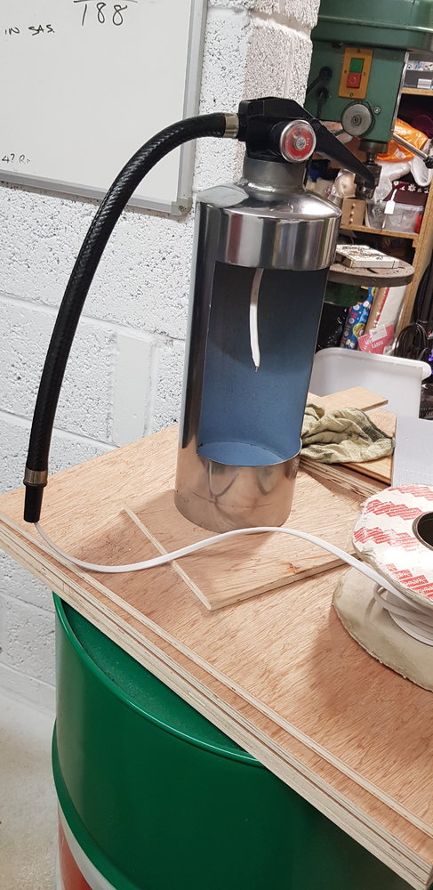

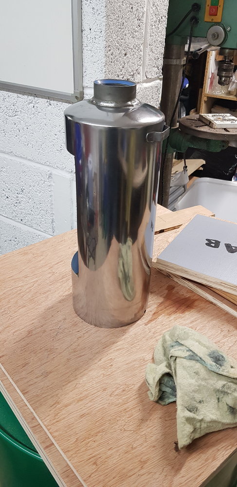

Good use of dead extinguisher.I found an old Powder Fire extinguisher in the shed.
A few hours of shot blasting,
A brave pill before setting to with the angle grinder and cutting disc and many, many hours of polishing.
I made a lamp.
View attachment 284740 View attachment 284741 View attachment 284742 View attachment 284743 View attachment 284744
Now that's goodI found an old Powder Fire extinguisher in the shed.

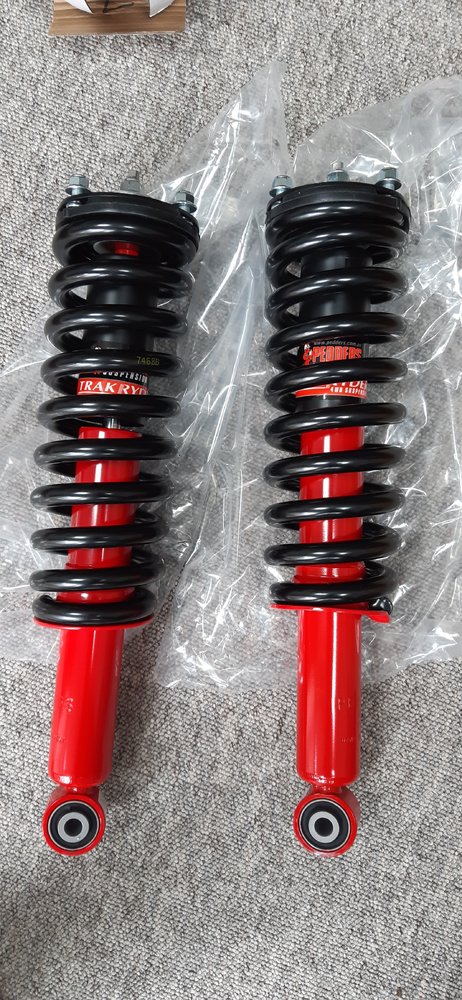

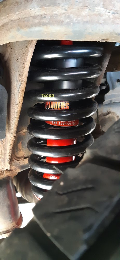

Good choice. Though i am biased!I got some new shocks for the Surf last week and fitted them on Sunday.
Nice pair of pre assembled Pedders struts, top mounts and standard length springs.
View attachment 284403.
The old ones got an advisory for rust on the last MOT and as I'd already done the rears I thought I'd treat the old truck!
The job was supposed to be an easy one ! The only trouble I thought I would have was poping the bottom ball joints out but they both came out after only 8 precision wacks each with the club hammer...

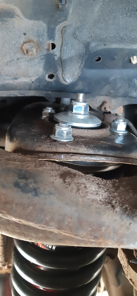

The problem I did have was getting one of the 14mm nuts off the top mount on the drivers side, took over an hour of swearing and grinding to get it free, all 3 on this side were slightly rounded off before I started compared to the other side that was fine. Naturally it was the one at the back I couldn't get at with a socket or proper sized grinder.View attachment 284409
Anyway it's all done now and the front of the truck is now about 3" higher than it was!

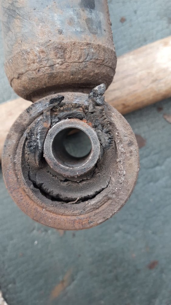

The old ones had seen better days....
Got your moneys worth from the lower bushes. Im sure you know, but make sure you do up the bolts through those bushes at ride height. They have a LOT of work to do and are very much the weak point of the design.
