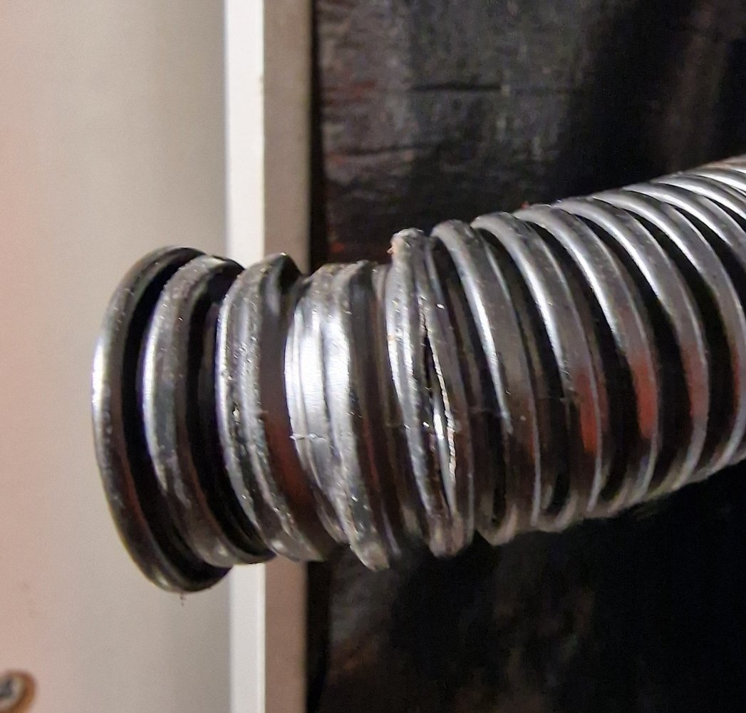

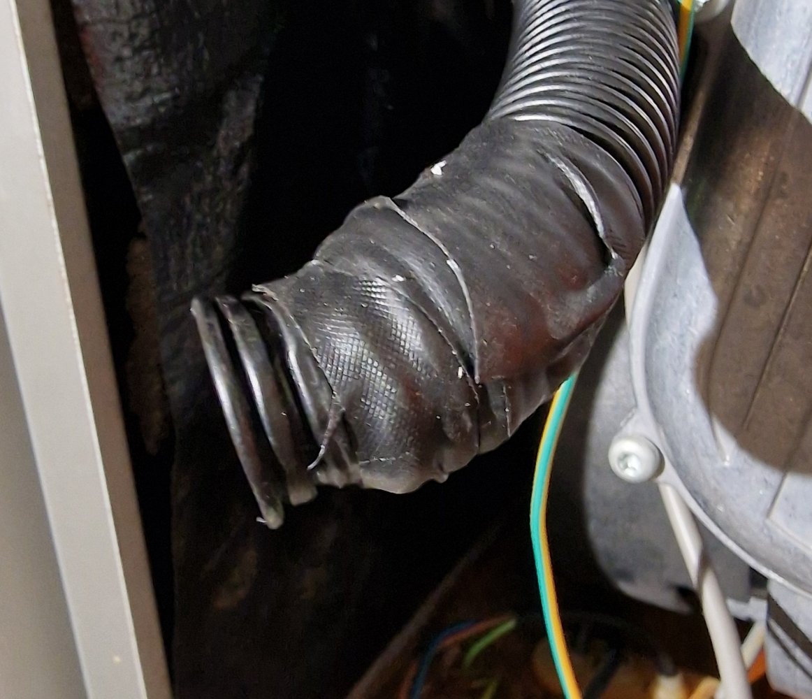

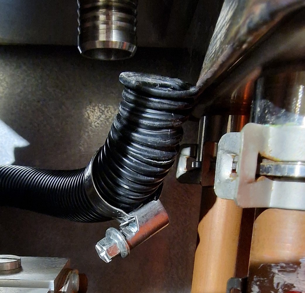

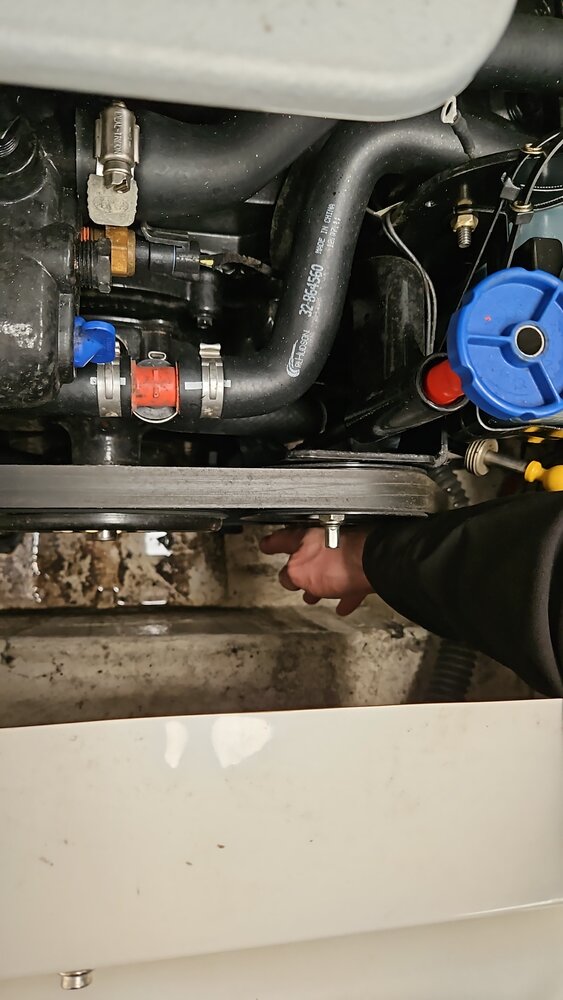

Did last few jobs on Astra, a leak from the washer bottle which has been annoying me dripping on me at annoying moments when I'm under it on the ramp turned out to be at the fitting as it came out the washer pump. Moulded pipe a funny shape with a 90 bend on it and corrigated pipe, so more awkward to replace with a generic bit of hose on it. So put some heat shrink around the outside of it where it was sloppy and shrank it tight in position.

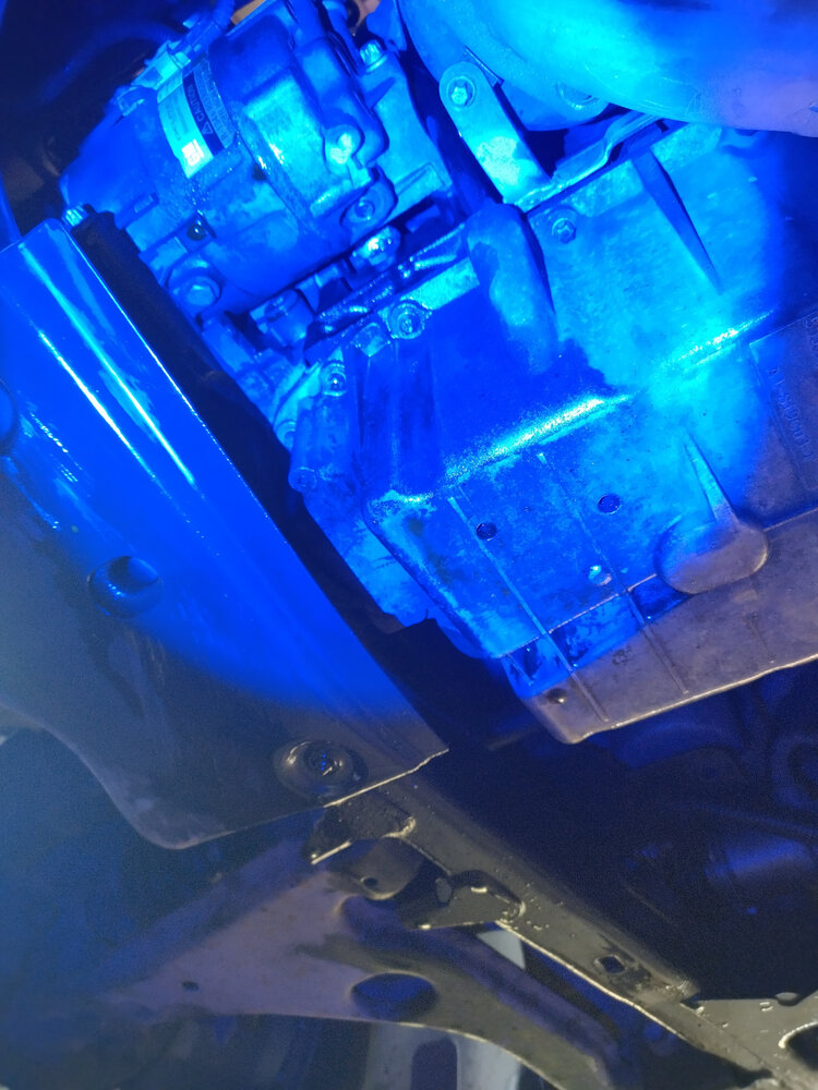

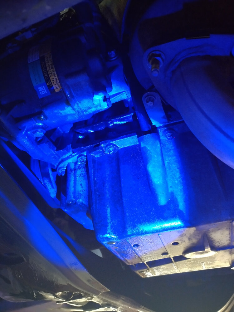

Brought it home, lifted it on the ramp, and after 50 miles there's still some engine oil from somewhere though not enough to be noticable on the dipstick etc, just makes a mess. So I've cleaned it off again and dosed the engine oil with UV tracer because if I know its not right its not right, and we'll take it out and put a few more km on it, and then back on the ramp for the UV torch with funny sunglasses treatment this weekend.

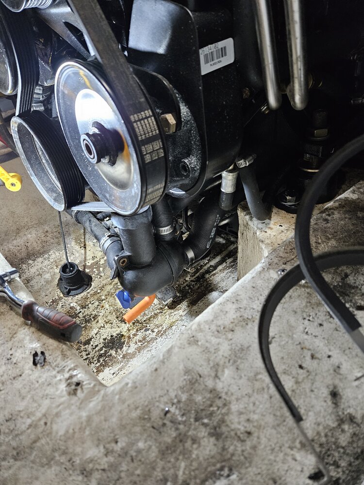

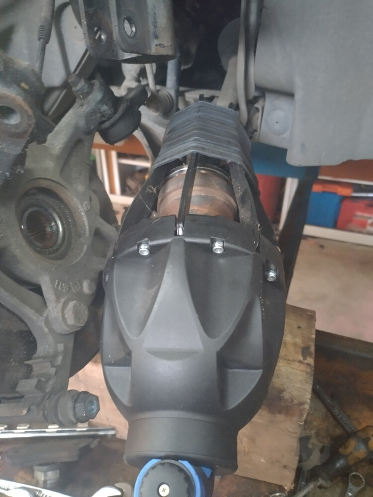

Oil leak tracing stuff a day after I hope I've fixed one that's been plaguing my Lancia for a long time. I've had the engine out more than once to check seals etc, Replaced gaskets, seals, carefully flattened sump flanges etc . . and it still wanted to coat one front wishbone in oil.
but will hopefully do the job.
