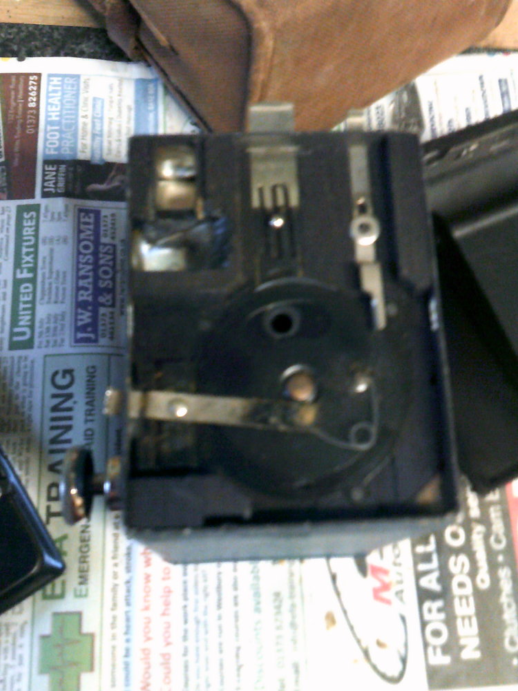

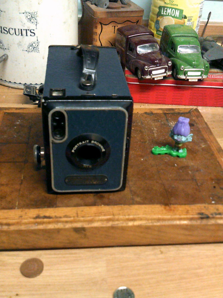

I have one of those. One of their factories used to be at the top of my road.This odd Ensign box camera just needed the shutter fixed.

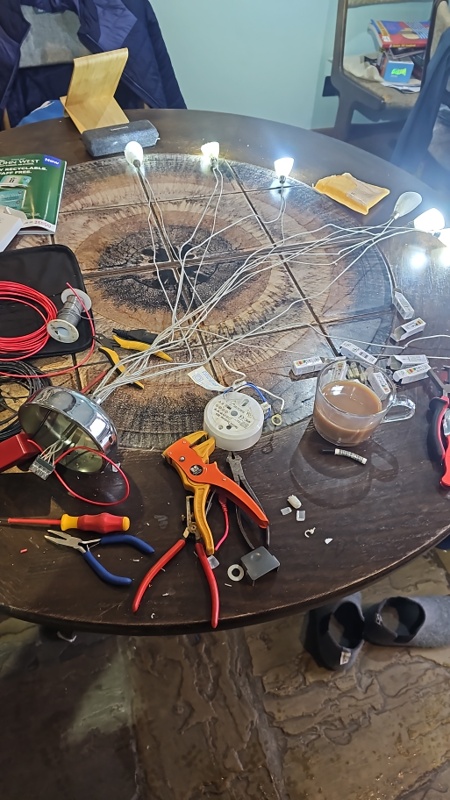

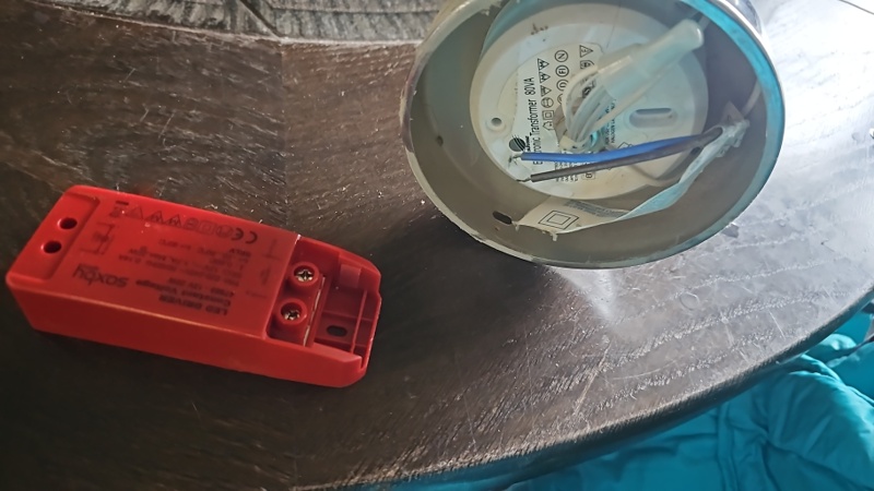

For high ceilings you can't beat having the simple slide in /out ceiling roseThe wife bought a strange light fitting for our bedroom about 20 years ago. It has 7 bendy arms with G4 bulbs at the end. Originally it came with halogens, but about 5 or 1p years later replaced them with LEDs. But there was a snag, the 12v driver didn't fire up until you hit 20W, as many halogen transformers do. So I left one halogen in to take it over the 20W until I got around to replacing the driver.
So about 10 or 15 years later, I decided to fix it. I knew it was dim and occasionally flickering because of the temporaey bodge.
I couldn't find a circular driver over 15W. With 7 x 2W LEDs, that's a bit close to the limit so I opted for a none circular 20W driver. I would have gone a bit higher but then it wouldn't have fitted in the base.
After trimming off some excess plastic, it fits in the base, just. I gave it a good clean and test on the kitchen table as our bedroom ceiling is really high, I had to get the scaffy tower out to get to it.
I'm a couple of LEDs short, I thought I had plenty but they turned out to be the old Halogens that I put back in the old LED boxes years ago doh!
But it's a lot brighter now and doesn't flicker. When i bought some more LEDs, I noticed quite a lot of reviews mention they don't work or flicker, I wonder how many are using Halogen drivers.....
