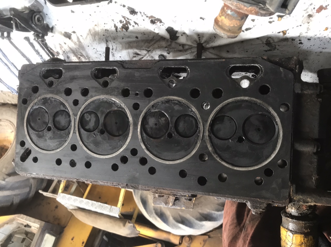

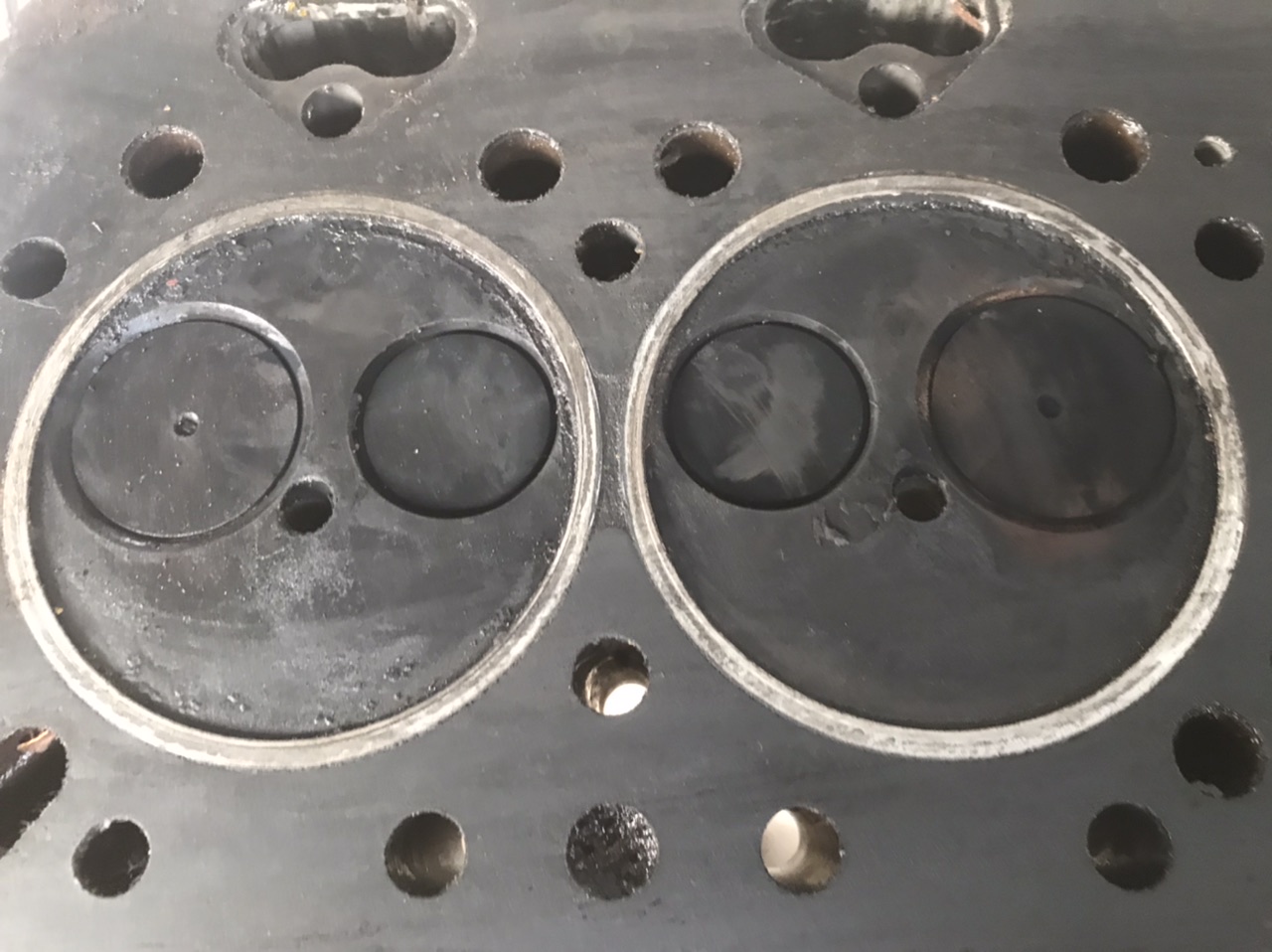

Does the head need skimming?
Would be a good idea.Does the head need skimming?
Not sure, haven't got the gasket off yet. Hoping to get back to it on TuesdayDoes the head need skimming?

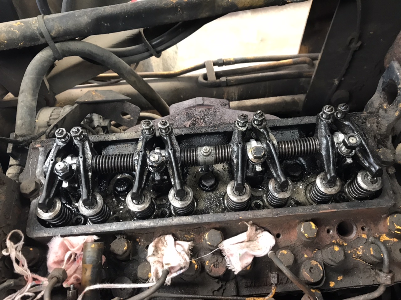

Is that the non turbo Leyland engine?Not a repair but a start of one hopefully. A sick JCB 3CX engine.

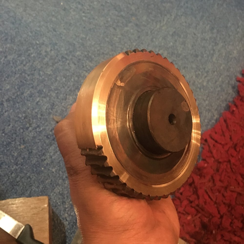

How do you weld bronze?
With a welder and the appropriate rodsHow do you weld bronze?
Everything is to a point I suppose....Is that the non turbo Leyland engine?
Thought they were indestructible!
Not been to look at the cooler yet, but it’s not a late one with it on the side, just checked my photos.James that looks like the old 1004 perkins engine, some of those ran a water/oil cooler heat exchanger sandwhich plate under the oil filter, the later ones had the cooler strapped to the engine block but again were water fed. They can leech water into the oil, worth checking to see if it has one.

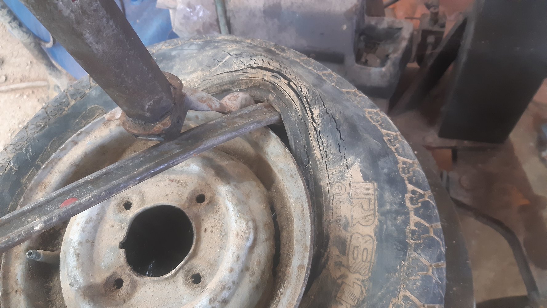

Yep, trailer tyres do get overlooked.![]()
20 years younger tyre fitted and a quick and dirty blow over with whatever paint i had mixed means my trailer should be a bit safer![]()
wot make of tire is that . the size of them are a bit thin on the ground now . that looks like a camac tire![]()
