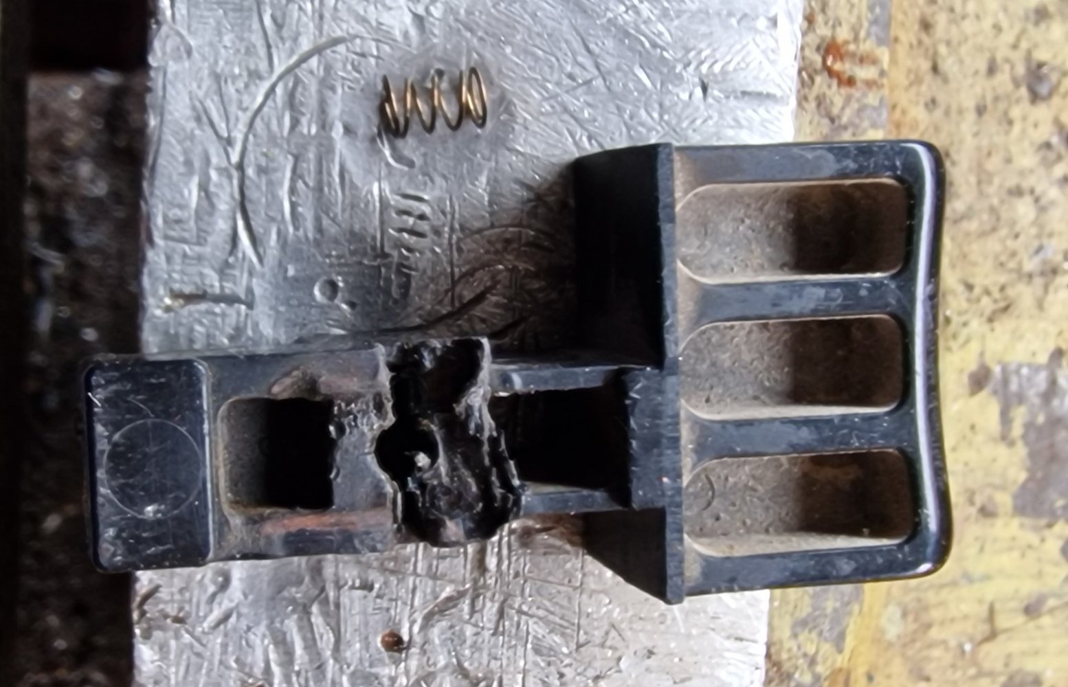

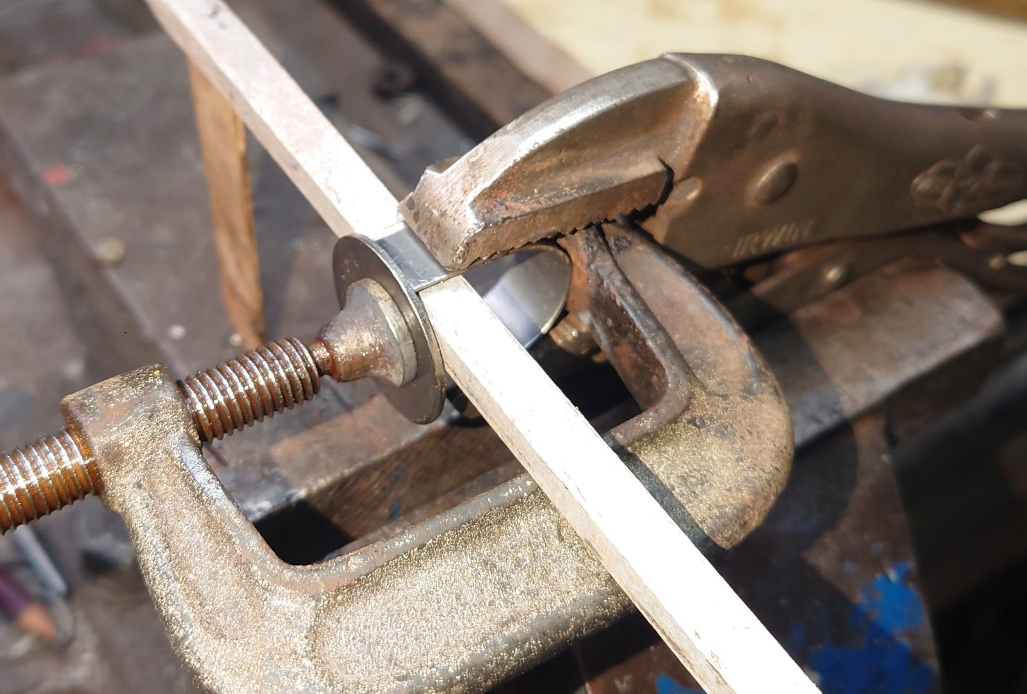

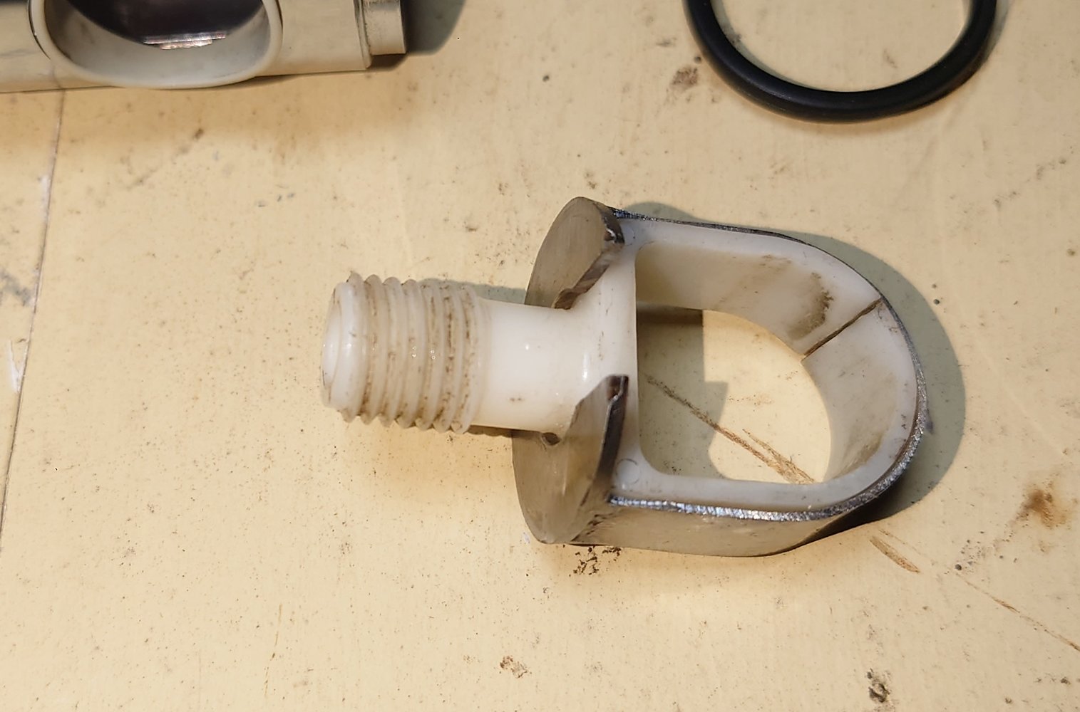

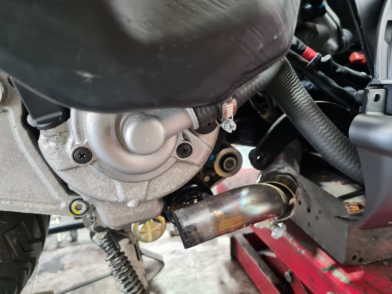

Today I fixed a Blue Point 3/8 stubby ratchet I recent bought on eBay.
It was cheap because it didn't have the lever or plunger to operate the valve, but at £18 I thought it was worth the chance.
I used 1mm stainless to make the lever and a piece of 4mm welding rod took care of the plunger.
1mm is maybe a bit light, I put a kink along the length and it works fine for now. I can always remake it with 2mm.
I put a nice flexible tail on it, gave it a drink of air tool oil and it operates as intended.
I used it straight away when replacing the cam belt on the Mrs car and I'm really quite impressed.
I might keep a look out for a 1/4 drive one.
I was going to go battery power but I think air better suits my needs.
I also have a 1/2 inch Lidl air ratchet and it's awful, no power and incredibly noisy, so I'll look for a better make.
