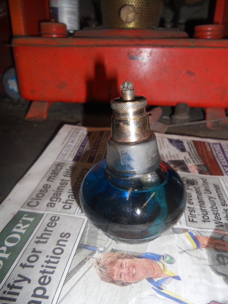

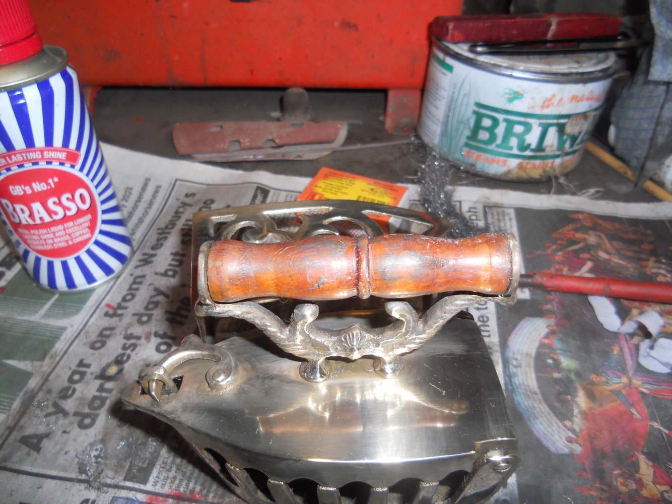

This Monitor Camping stove ambled into my procession.
It is complete, but it also had extra bits.
So we did the basic safety checks and tried to fire it up.
It leaked more fuel than it burnt.

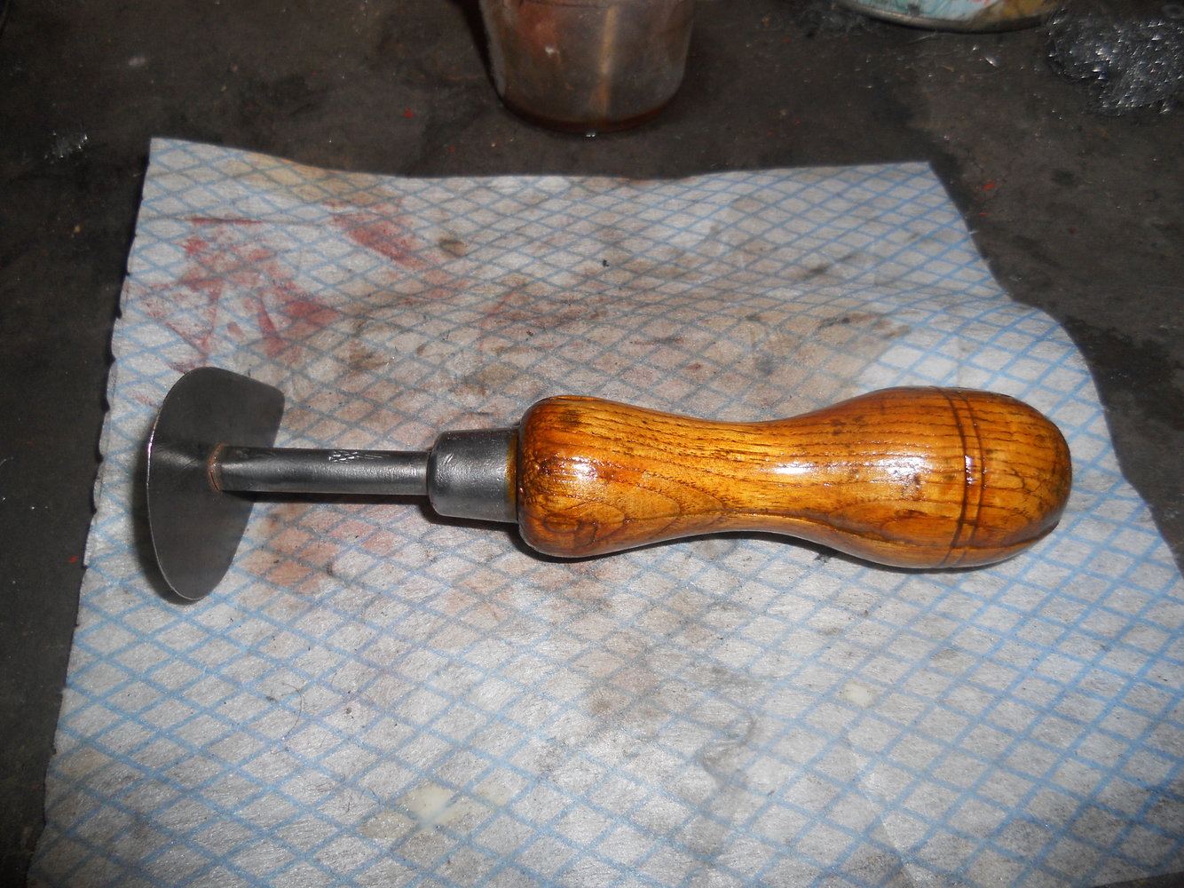

The burner fits into the body and a lead seal is used to make it fuel tight. This is the old one.
All new seals fitted. Along with a new cup washer.
It is now fuel tight and burns well.
A quick polish.
Tined was cleaned up.
