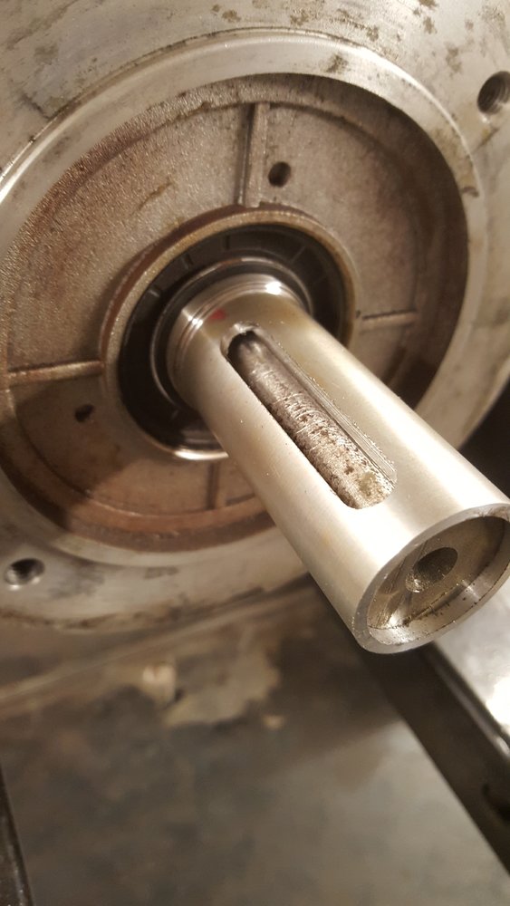

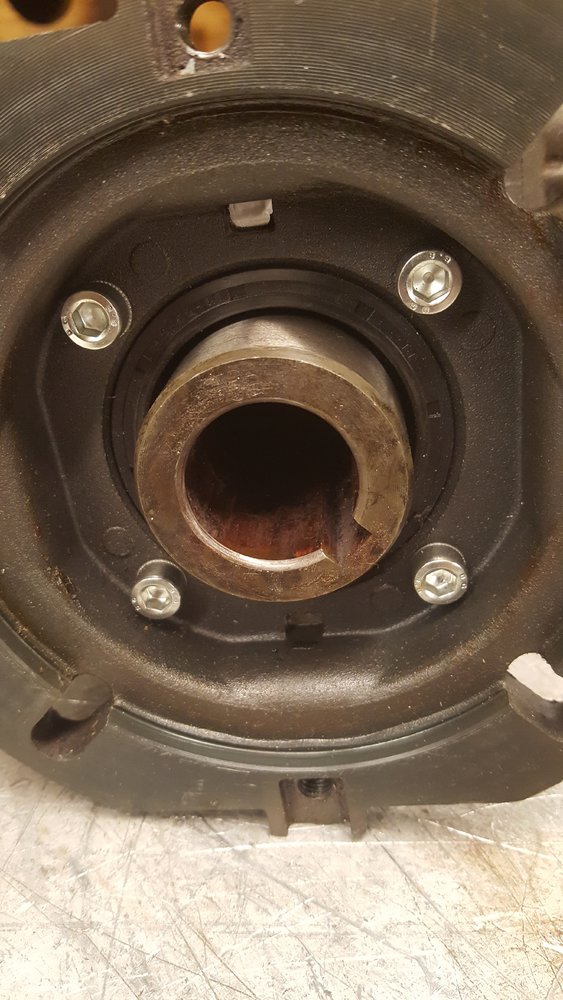

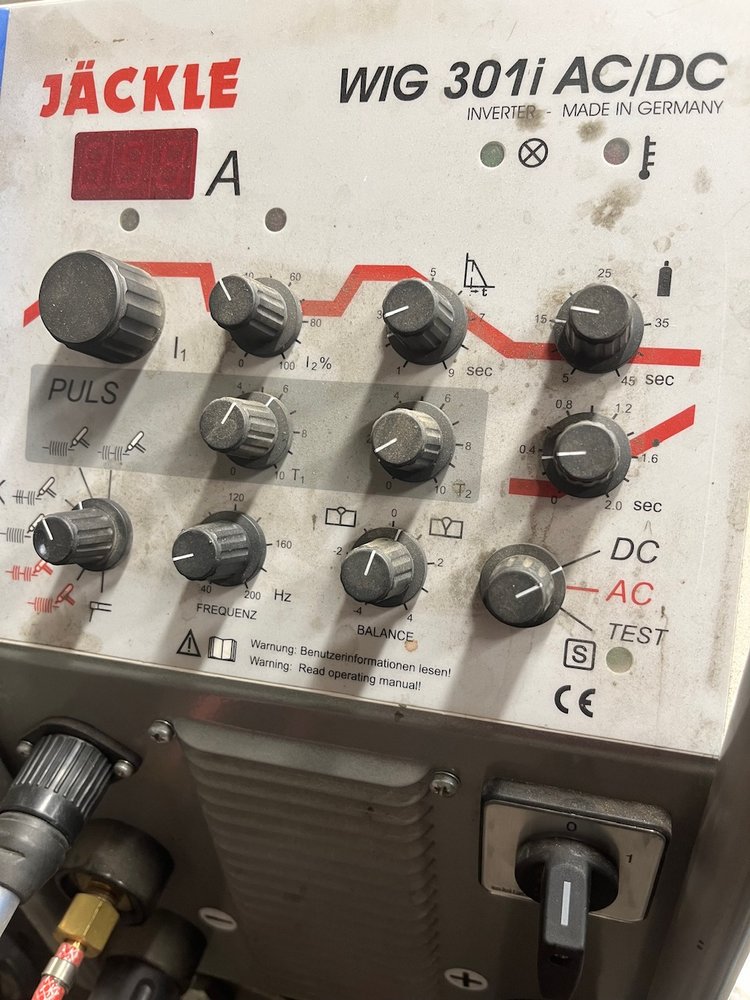

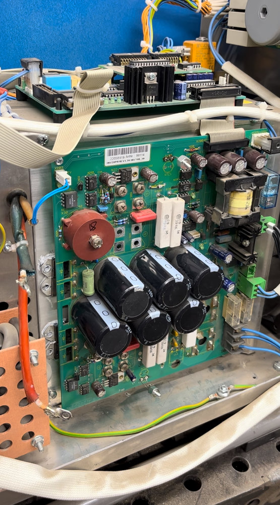

Finally got these one back to life.
It was badly repaired by someone else who destroyed power section which caused several additional damage.
Unfortunately they used very rare Mosfets which are hard to find.
Anyway.
Now it’s working again.
Hi,Very cool a German made machine.
Is it 3 phase?
Have you got any pics of the innards just curious as I seen one similar for cheap locally which had let the magic smoke out. I am tempted to take it home and see if I can put the smoke back into it.

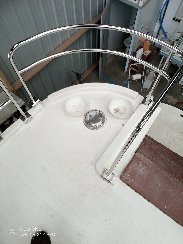

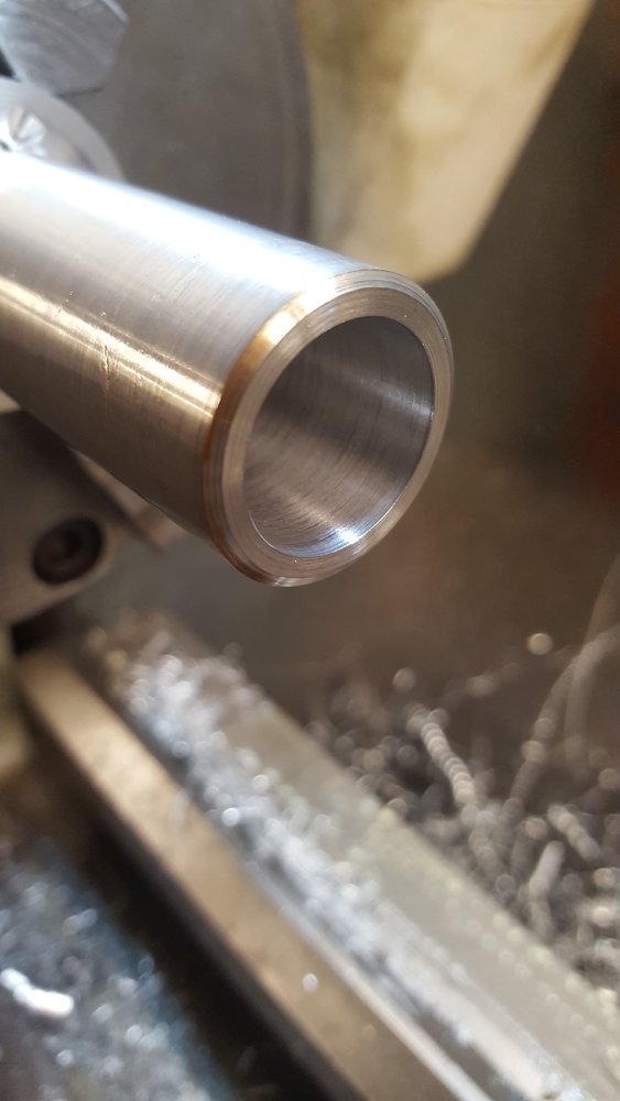

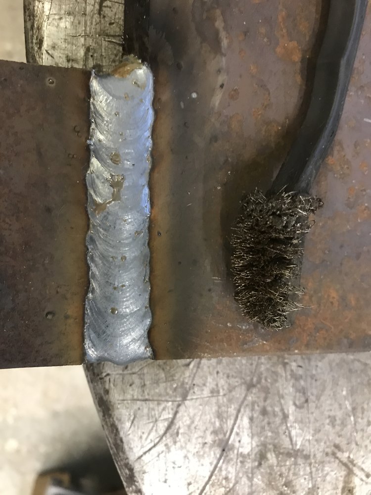

great job you made of that MatIt doesn't look like it's welded, but it you zoom in, the bottom inch on the left isn't as shiny as the rest, cut it tacked it, with arc stainless rods, then decided to tig it.
Had completely the wrong settings dialled in, cooked a hole in it.
Chopped a bit of same size diameter pipe, from dead balcony, slit it, hammered it inside, built back up the hole, welded the joint, looked a dogs dinner, got my finger (B&D) file going, cleaned off raised puddles, and then 800 grit to attempt to polish it up.
You have to look for it, it's fairly tidy, I am no tig pro.
Thank you, even my wife said it looks good, I've been asking my company for years to send me on tig training course.great job you made of that Mat![]()
you need to be asking them for a pay rise looking at that repairThank you, even my wife said it looks good, I've been asking my company for years to send me on course.
