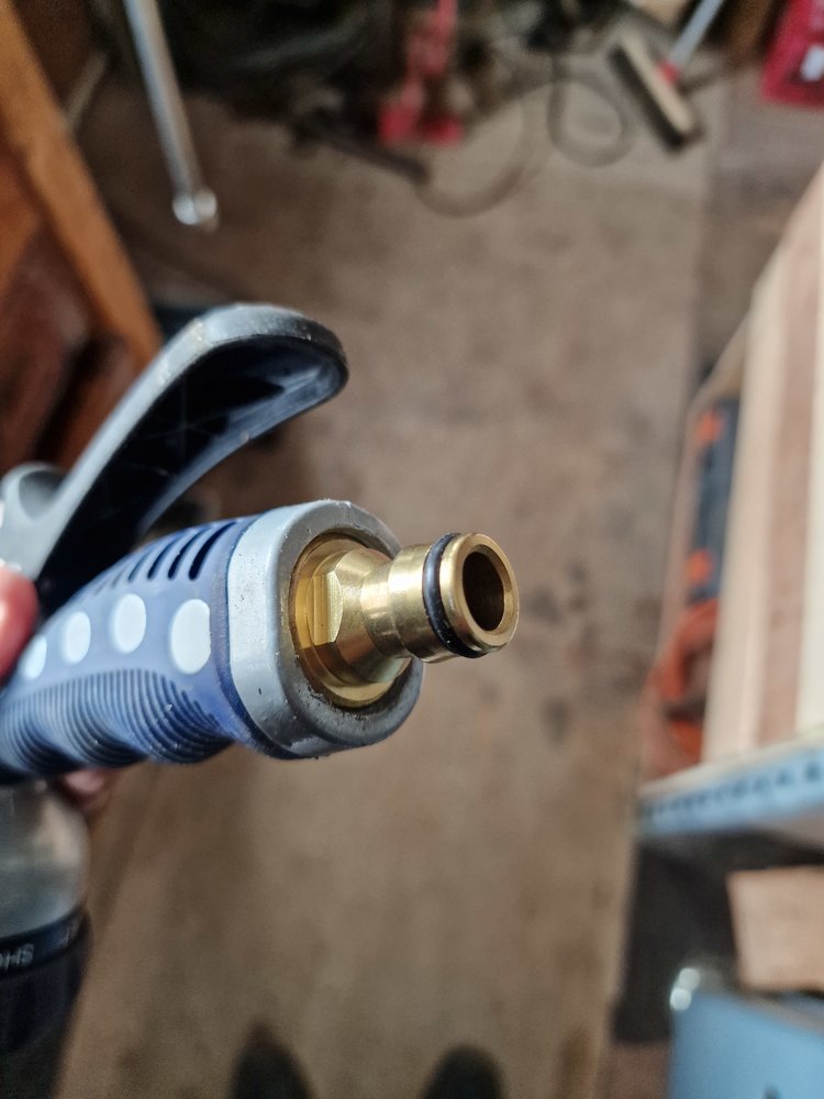

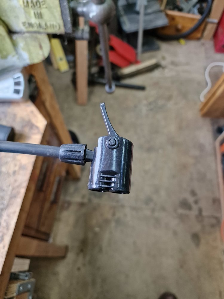

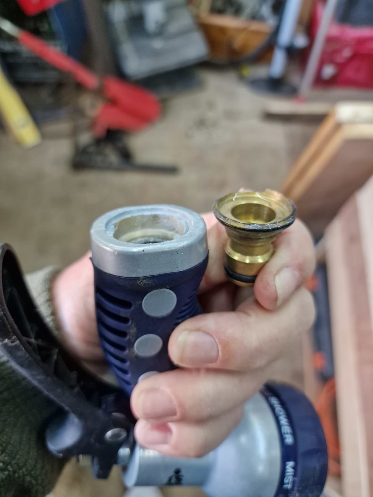

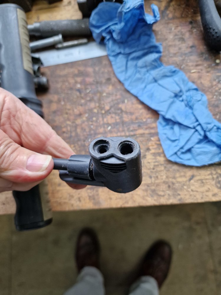

How do you get the old one out and new one in place? Glue/resin??Another easy fix. How many people woukd chuck this away and buy new?
£1.49 spent at Toolstation, 5 minutes extracting the broken piece, job done!
View attachment 388917View attachment 388918
Ah - I was looking on my phone and couldn’t see the threadIt's screwed in. Grip the handle in a vice and with a very small cold chisel and ball pein hammer, tap the old piece tangentially to shift it. After one turn it wash free enough to unscrew by hand.

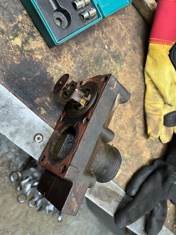

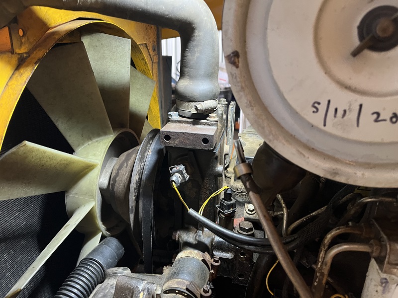

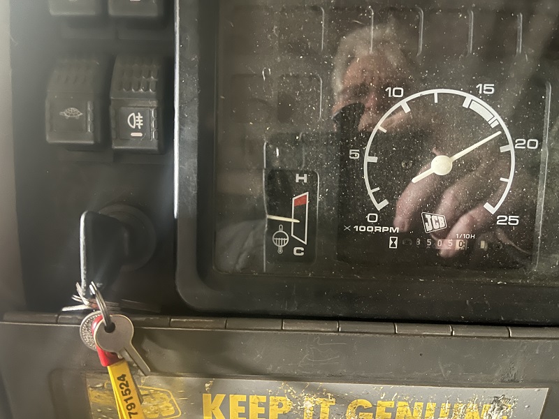

I was told way back when I first started driving and fixing cars, the fact a stat stayed shut or opened at temp in a saucepan on the stove meant not a lot compared to when it was installed in the engine. Pump pressure could open a weak one and lead to over cooling, despite it staying shut in the pan.This really has me puzzled, I tested the old thermostat in a pan of boiling water - it resolutely stayed SHUT. So why was the engine over cooled and not overheating![]()
The over cooling was cured by installing a new thermostat so this defies logic - can anyone give me a logical explanation of what's happening here ?

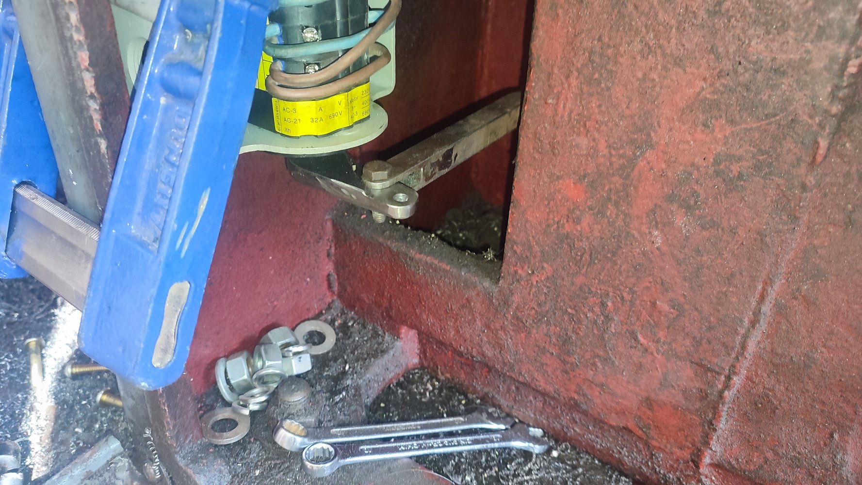

Finally got my lathe to work in forward and reverse. In the process learned about starting windings, and 4 pole change over switches and DOL starters.
View attachment 389507 View attachment 389508
I'd love 3 phase, but can't justify it, as I'm only a hobbyist. There's actually 3 phase crossing the corner of the workshop, so it's potentially viable, maybe someday...That's why I prefer working at 3ph motors, the wiring is so much easier, no start windings to worry about & to reverse just swap 2 phases.

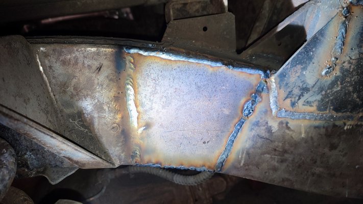

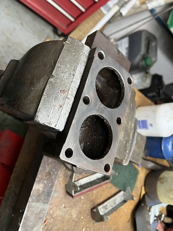

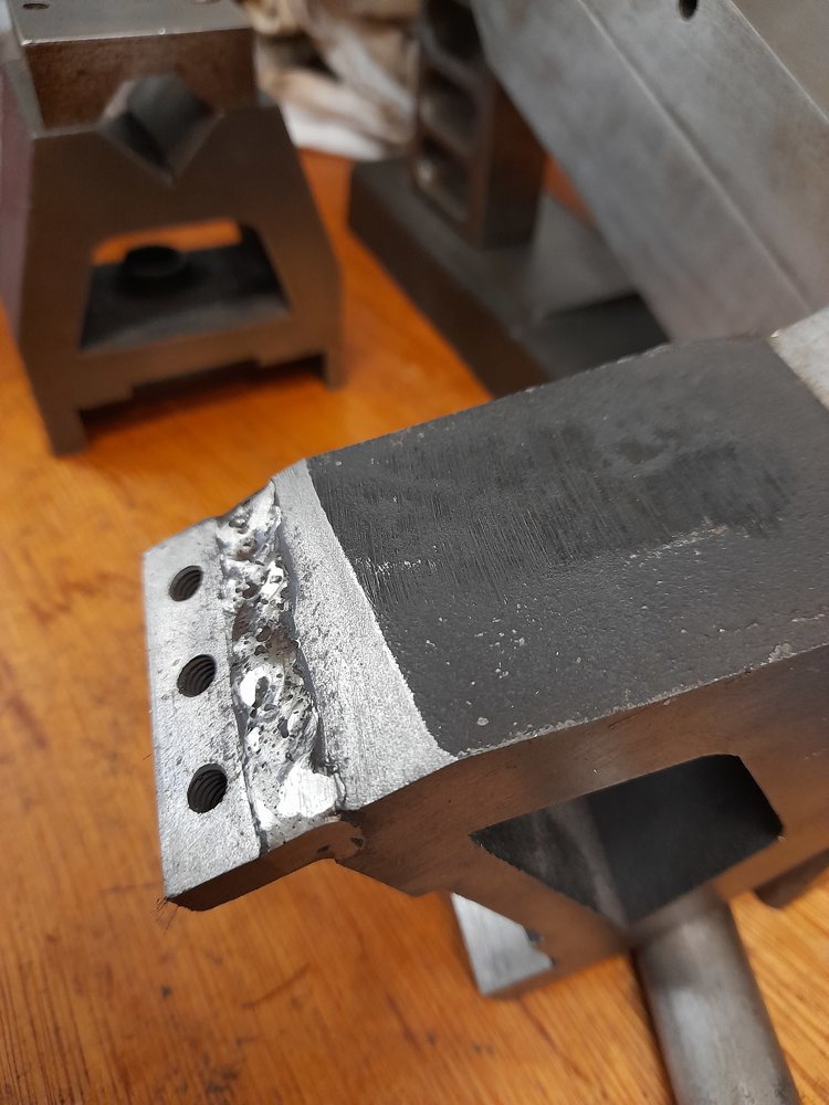

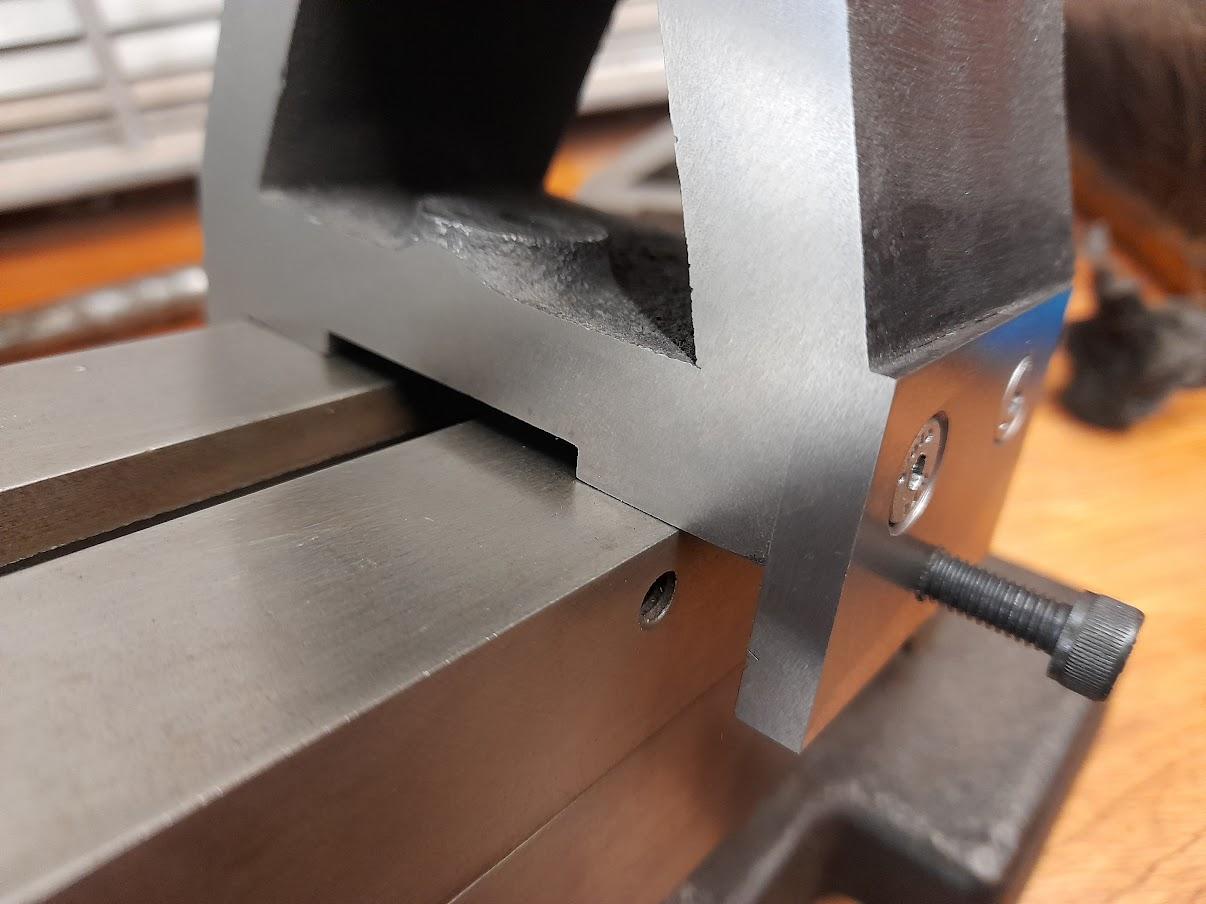

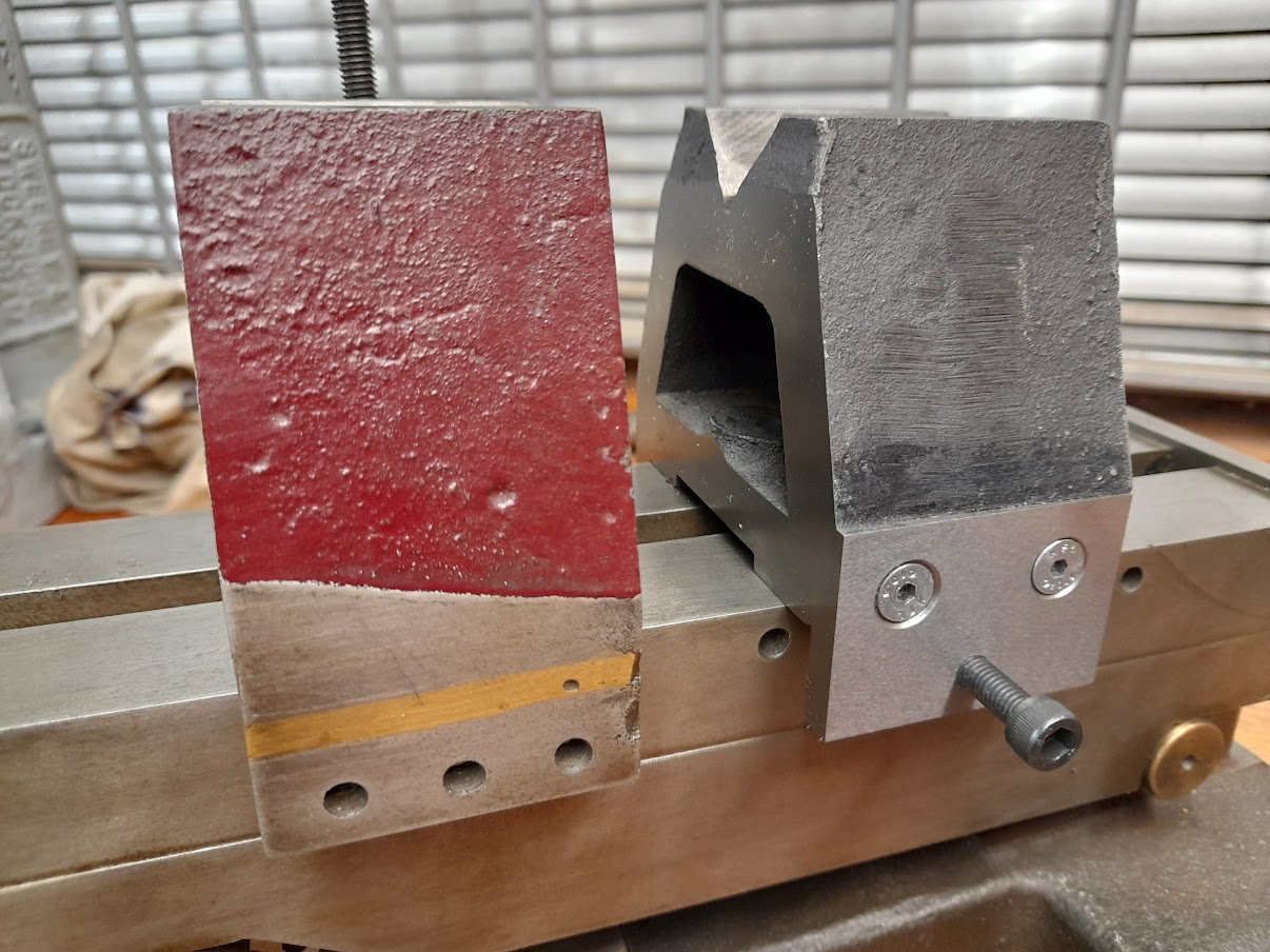

how did you manage to not melt the paintI recently acquired a between-centres sine table at a very good price. The castings on both movable supports have in the past been broken and repaired. Although it does not affect operation, I considered the weld repair hideous and deserving of immediate repair. I'll probably repeat the same repair to the other casting that has been brazed.
Here are the before and after photos:
The brazed repair wasn't mine. I did the other one with the two countersunk socket screws.how did you manage to not melt the paint
Doing the next one. Cast iron dust everywhere.I recently acquired a between-centres sine table at a very good price. The castings on both movable supports have in the past been broken and repaired. Although it does not affect operation, I considered the weld repair hideous and deserving of immediate repair. I'll probably repeat the same repair to the other casting that has been brazed.
