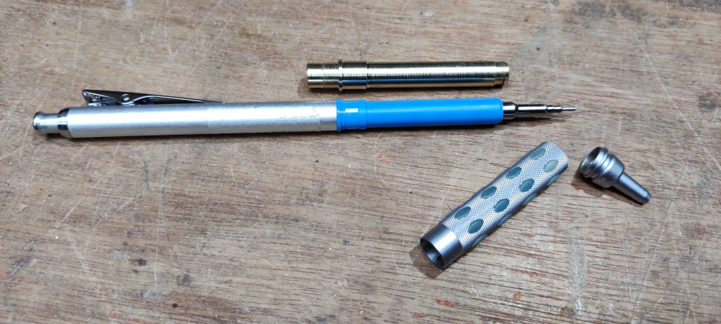

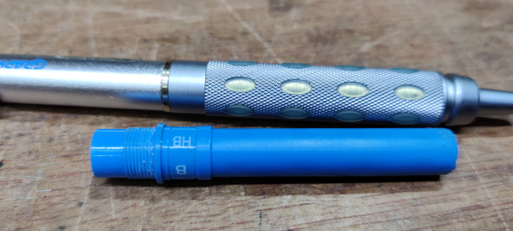

A last straw occurred today. I mentioned a while ago that there's a plastic bit in the Pentel Graphgear 1000 pencils that is the weak joint in an otherwise excellent pencil (I particularly like the retracting tip that goes inside the body when the pocket clip is lifted). My ninth one broke today (albeit at a different joint to usual, but still the same plastic piece). I decided it was time to bite the bullet and have a go at making my own. I'd been quite nervous about making the two threads (one of which was something like M7.7×0.5 and the other M7.1×0.5!), but I took my time (turning the chuck by hand) and I made sure that I drilled the 5.8 mm through hole last so I wasn't cutting a thread on a really thin-walled part.

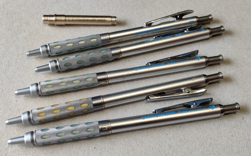

I've still got at least three (maybe more) of the other broken pencils that I put in a drawer somewhere in case I ever got round to doing this (and doing it successfully), so I'll have a go at making a few more soon. I've got a detail drawing showing all the dimensions so that should help with the repeated manufacture.
All being well, the new collar should last far longer than the plastic ones do.
