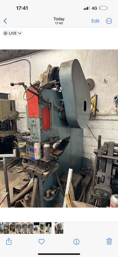

I don't know of it is the correct term bR39Da used but the flywheel can be spun backwards but it is not engaged on the crank.I don't understand what that means.
Is this a single revolution clutch arrangement ?Turning the wheel backwards is a bit like a bicycle wheel, it freewheels and doesn't drive anything

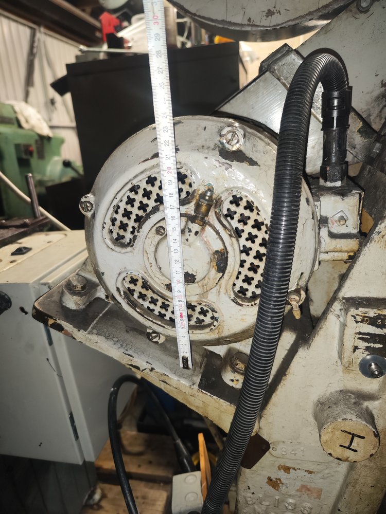

Yes please! I presume the motor output is geared down to quite slow, or it's a sort of 'one shot' pedal, so it only spins and presses once - not at 1400rpmI might need to make a little video of it working so people who are interested can see.

It didn't when I got because the 'clutch' was stuck at the top, it never made it to the trigger.If you turn it backwards with the trigger down does it engage ?

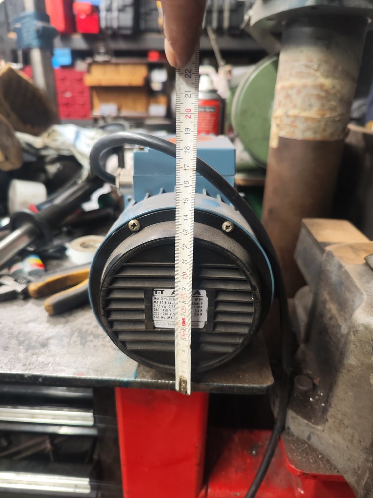

Why would you want to vary the speed on the motor ?Made a very quick video. Might make a better one once I have actually connected the motor up to a VFD.
I have set it up so that the 'clutch' is in the same position as when I got the machine (while it was stuck in the down position).
Not sure about class 4 or hi-slip, it is a 700 rpm 0.5hp, 3-phase 400V motor.Why would you want to vary the speed on the motor ?
is it a class 4 or hi-slip motor ?
