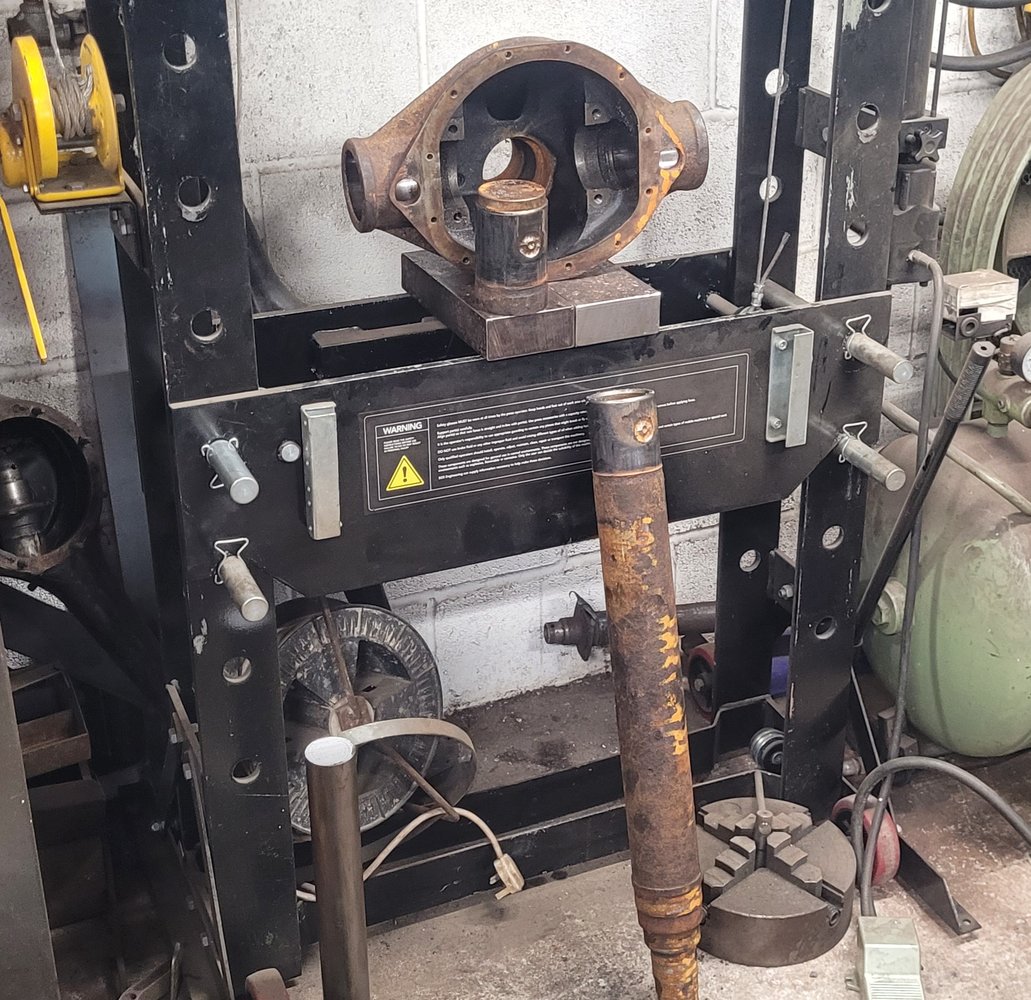

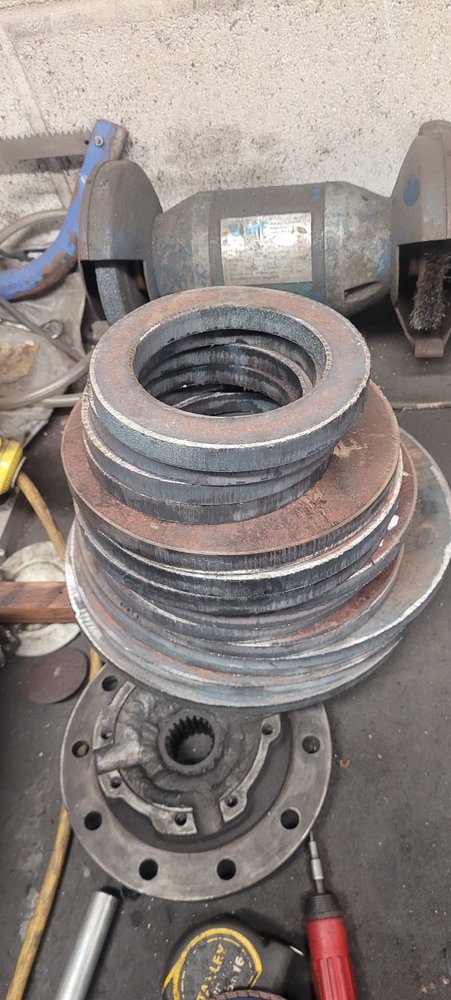

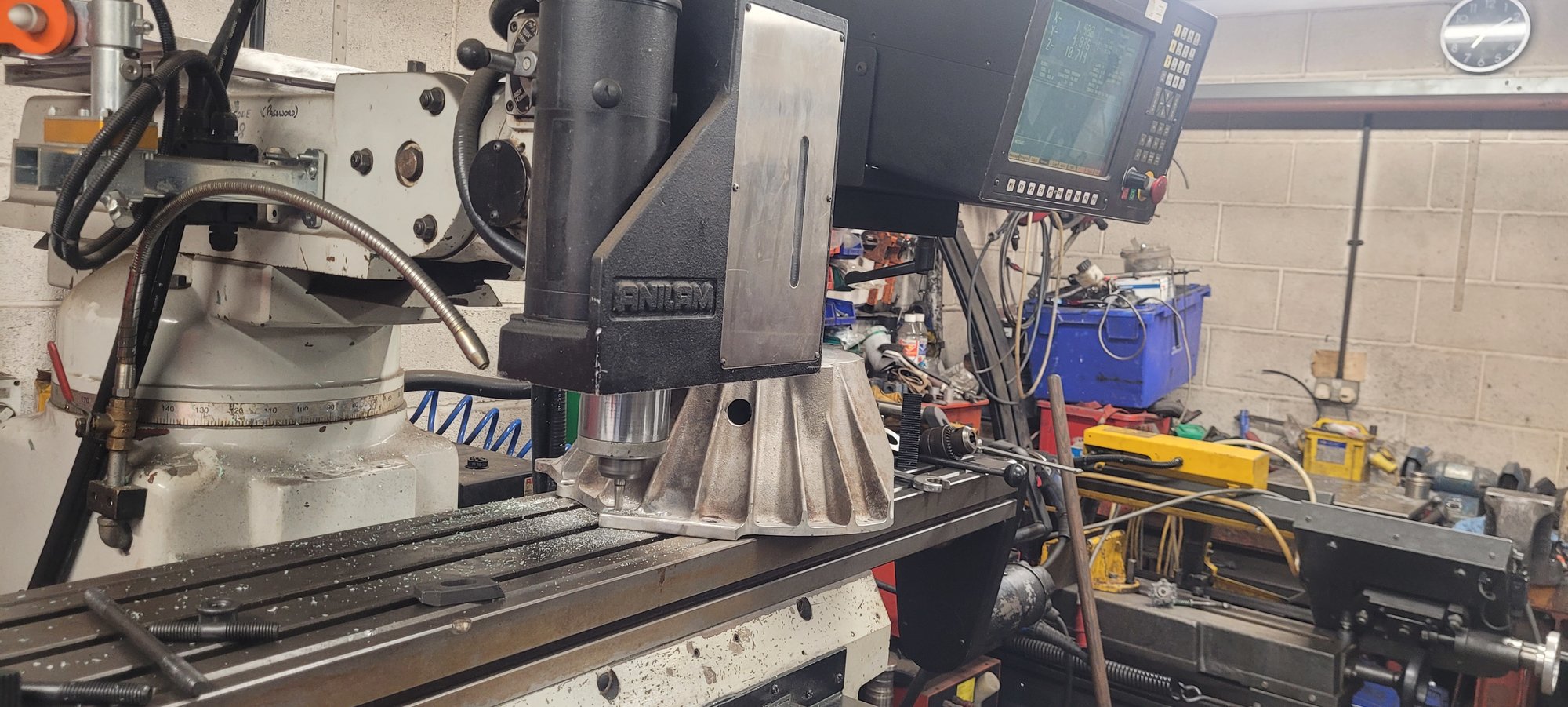

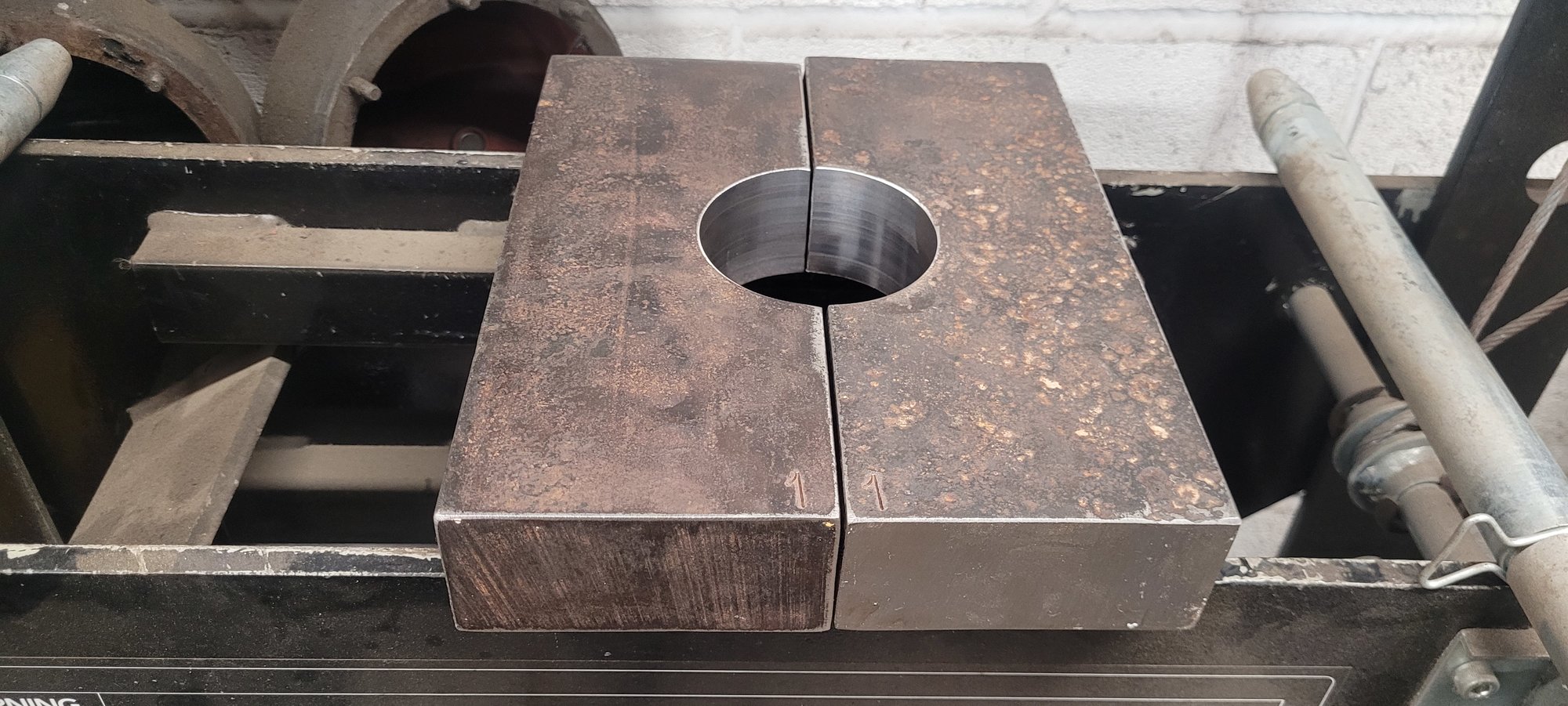

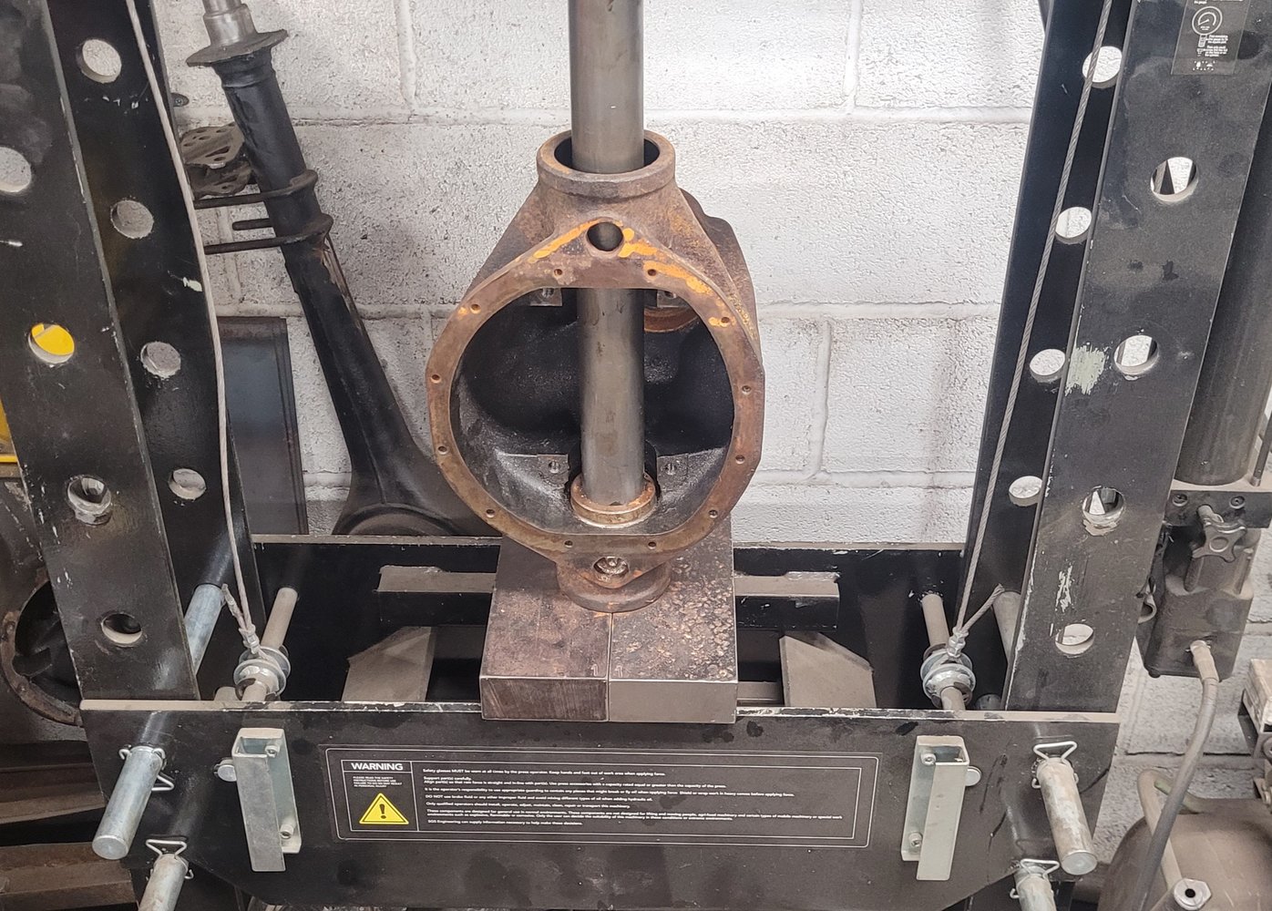

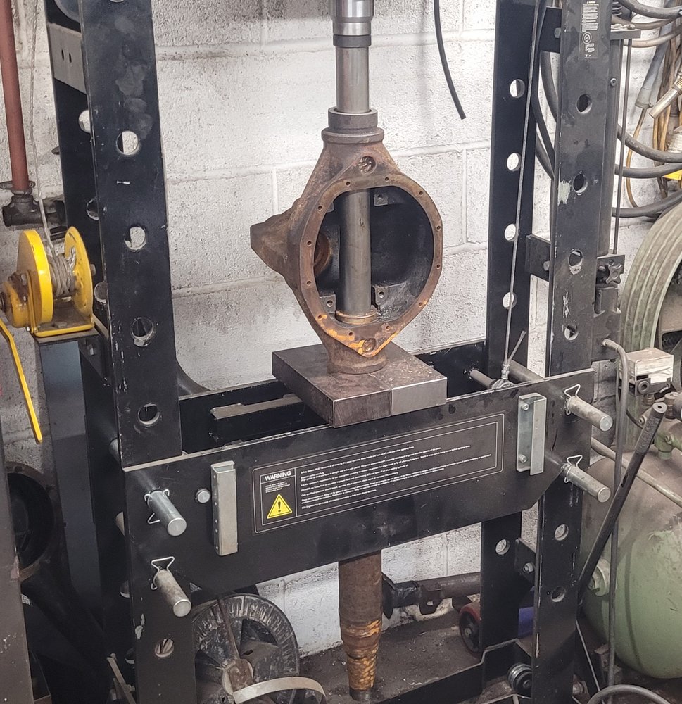

Glad to see the press getting some useI bored a 84mm hole in some 50mm thick plates and pushed the axle tubes out of center.(after die grinding the plug welds out with a carbide burr )
It's a belterGlad to see the press getting some use![]()

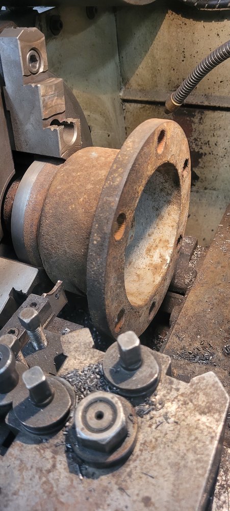

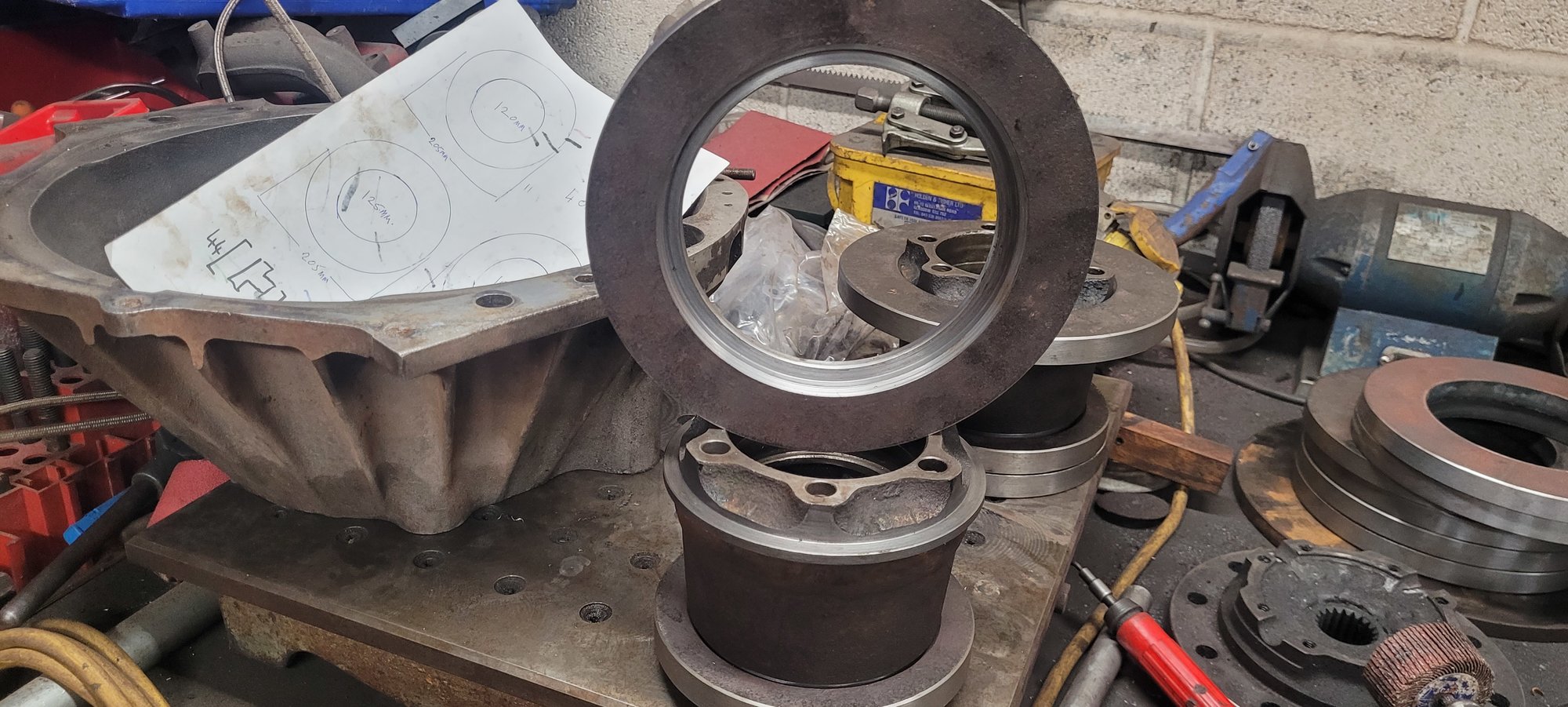

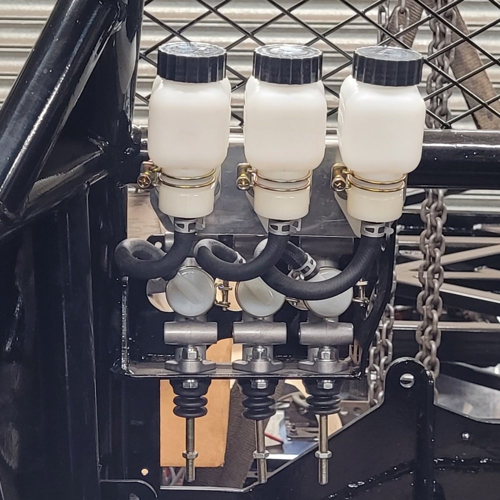

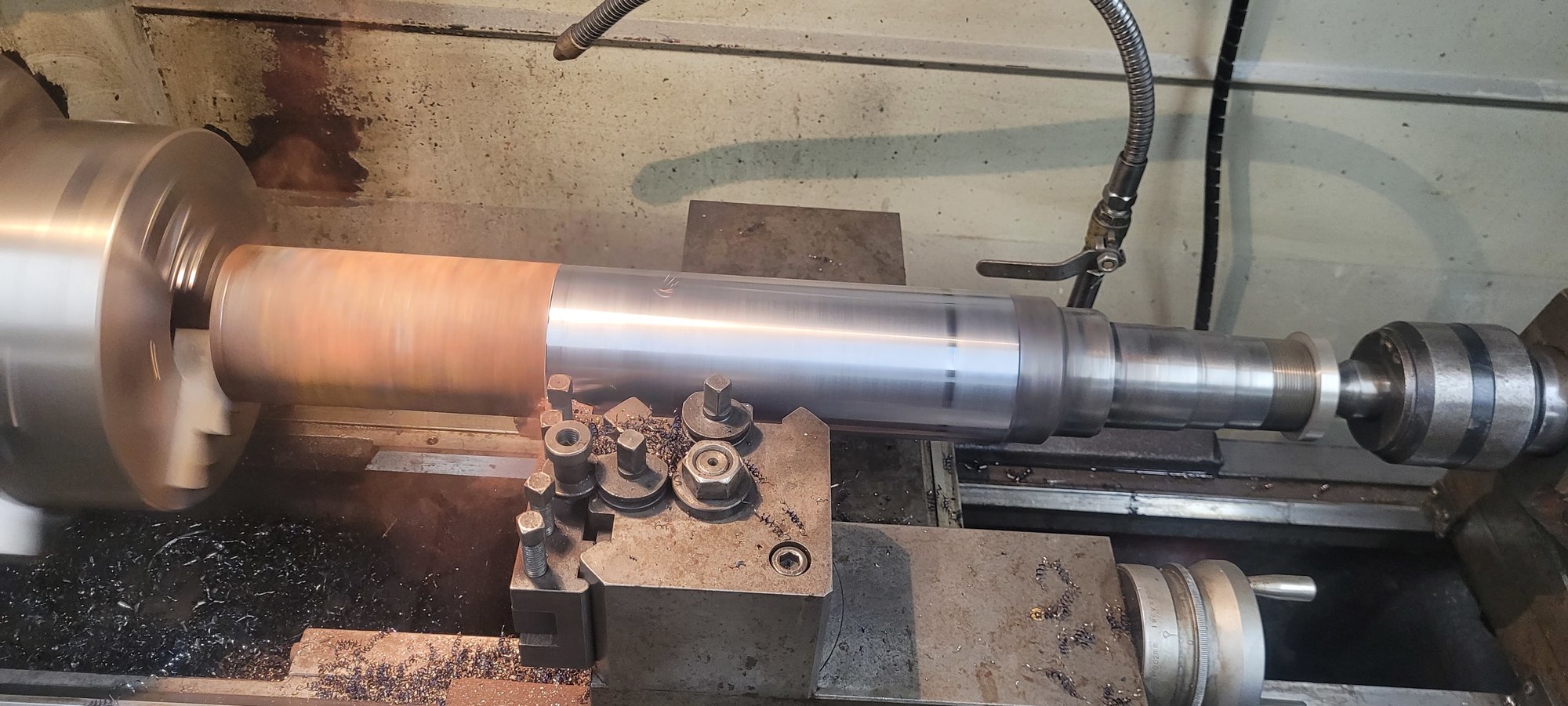

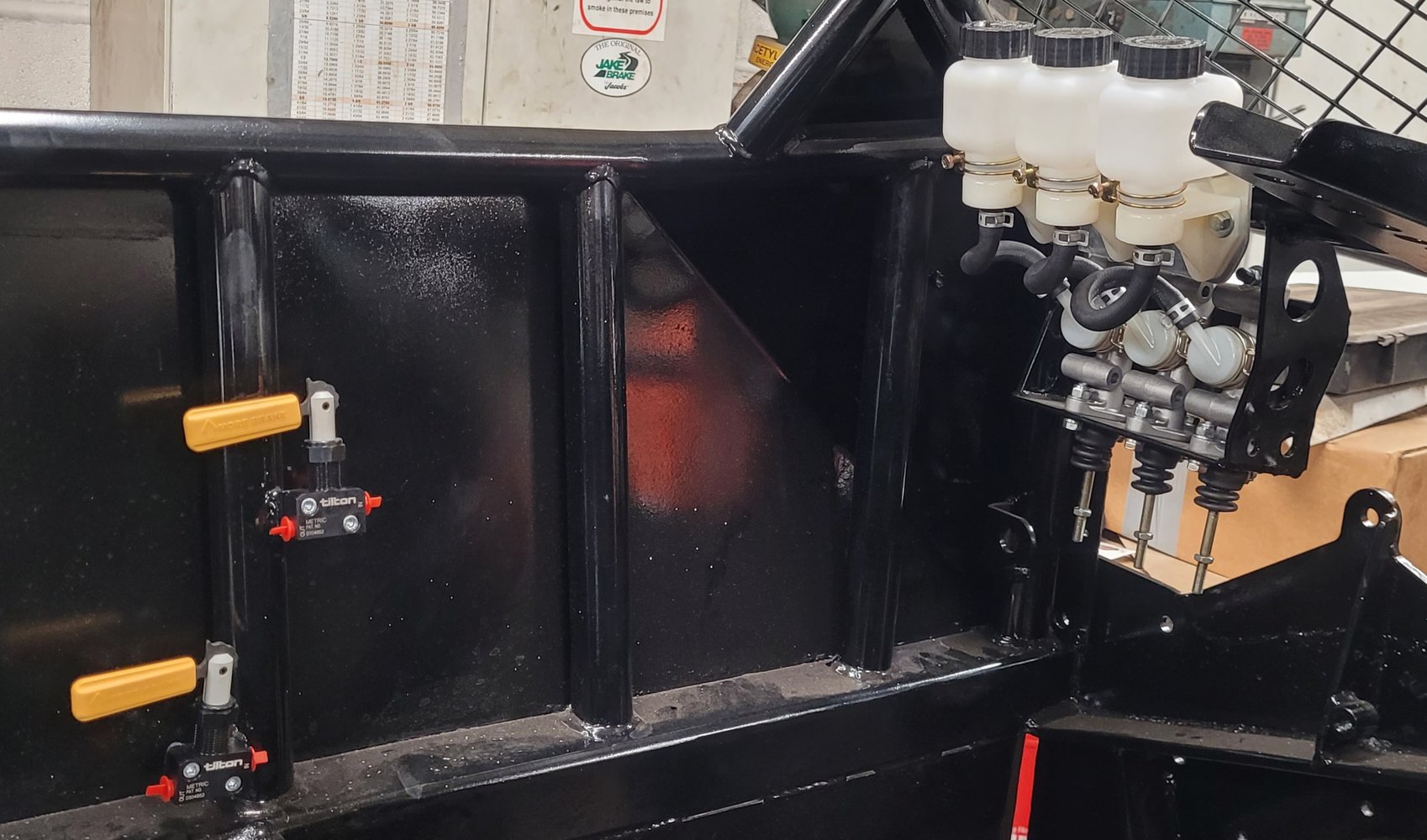

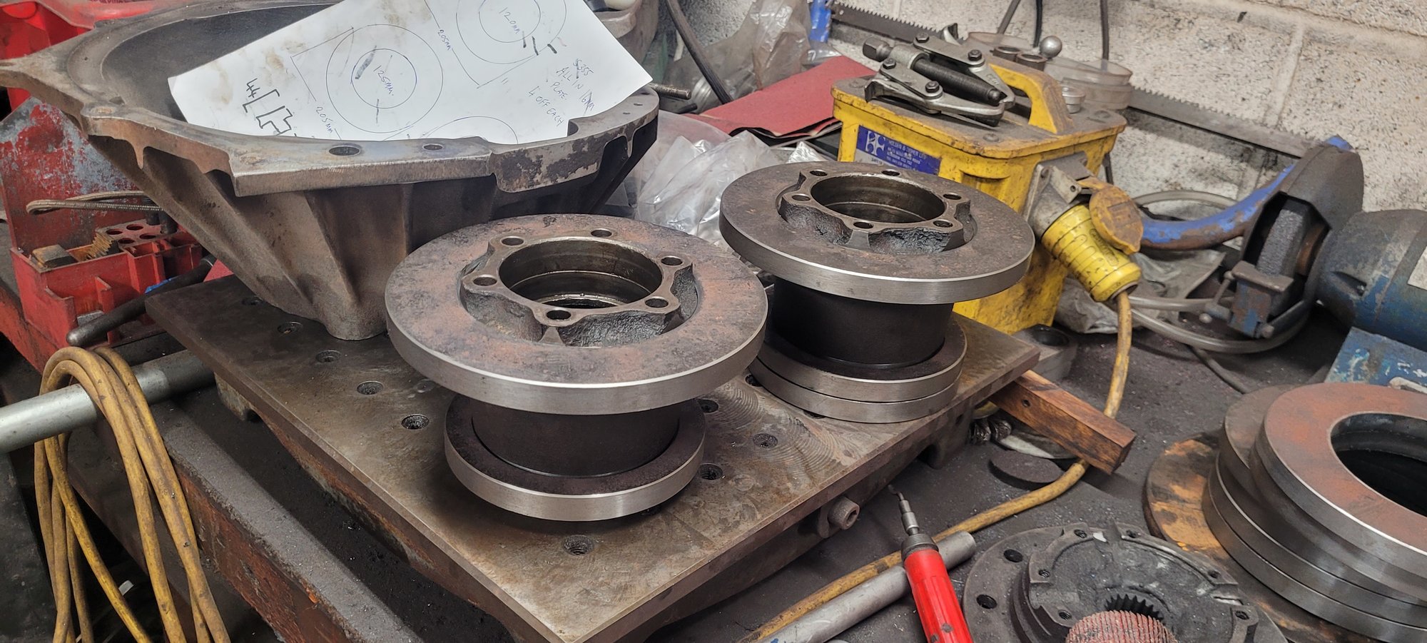

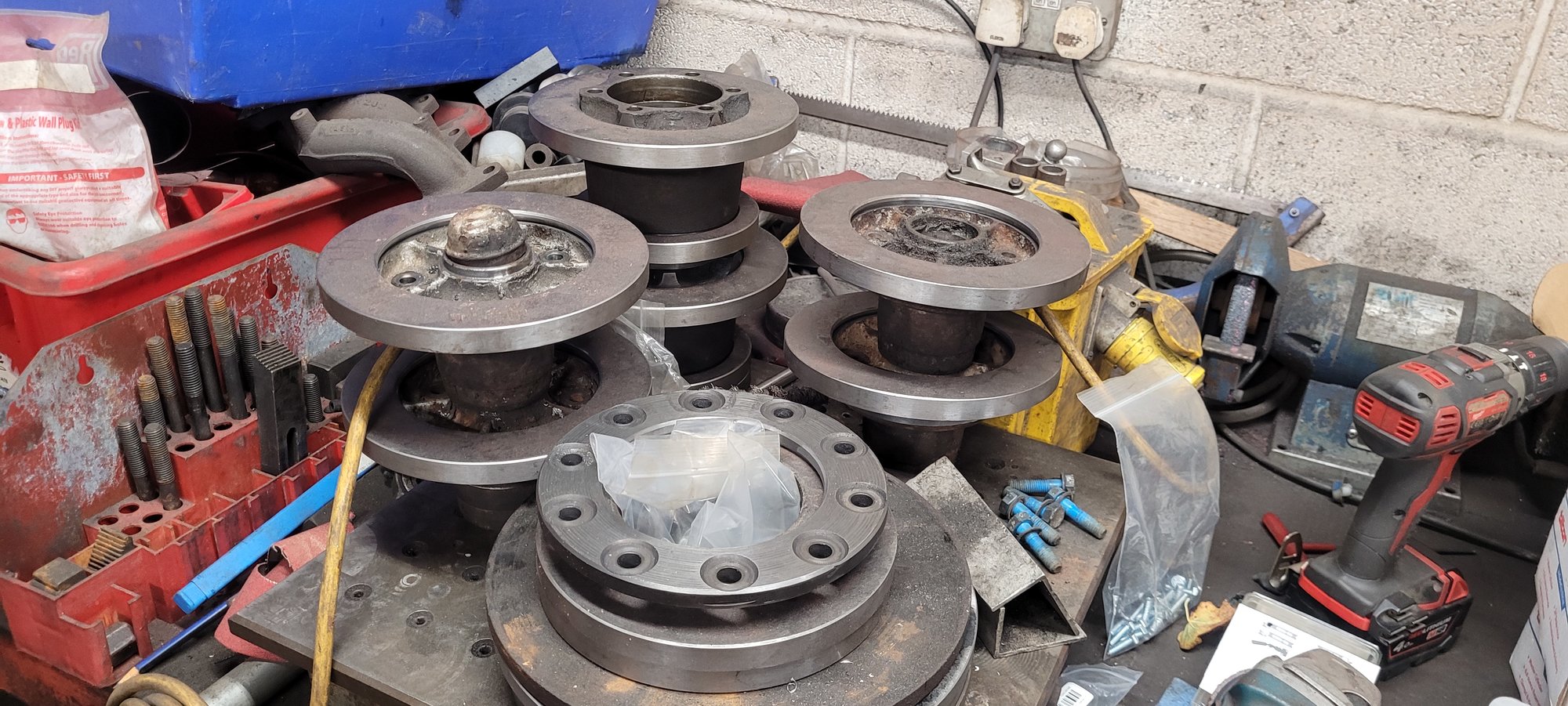

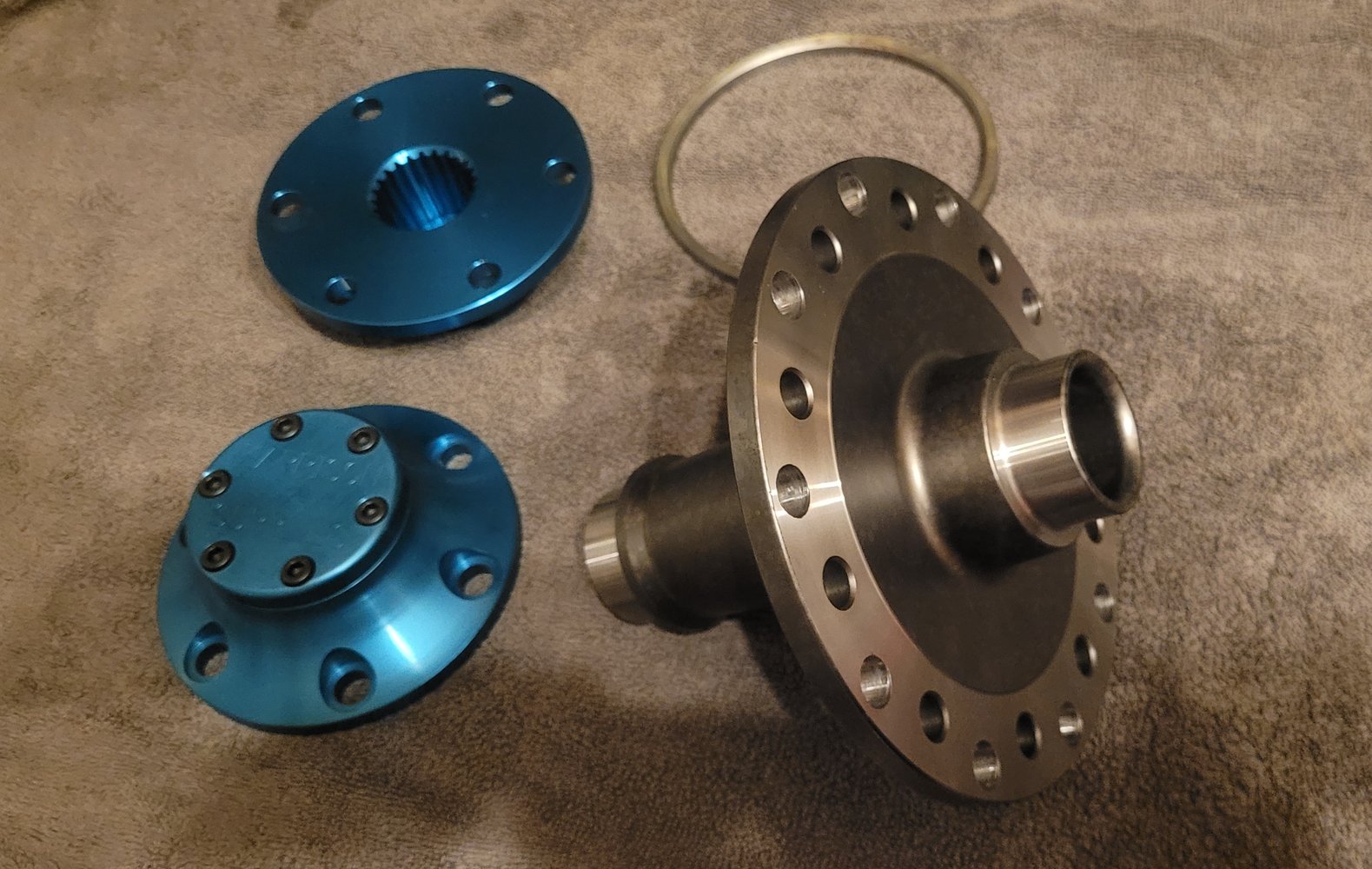

Front hubs semi finished ,brake master cylinders and proportioning valves in.
View attachment 468750View attachment 468751View attachment 468752
Can you just buy the setup ready to go?Front hubs semi finished ,brake master cylinders and proportioning valves in.
As in what?Can you just buy the setup ready to go?
where would the fun be in that!Can you just buy the setup ready to go?
You can get generic pedal boxes but nothing really suitable for this application, plus a 3 cylinder tilton pedal box is a bit spendy so I make my own.
That's sort of what I am getting at.You can get generic pedal boxes but nothing really suitable for this application, plus a 3 cylinder tilton pedal box is a bit spendy so I make my own.

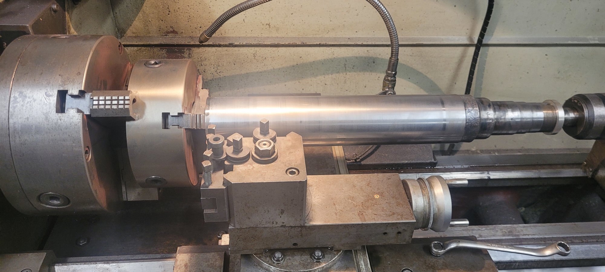

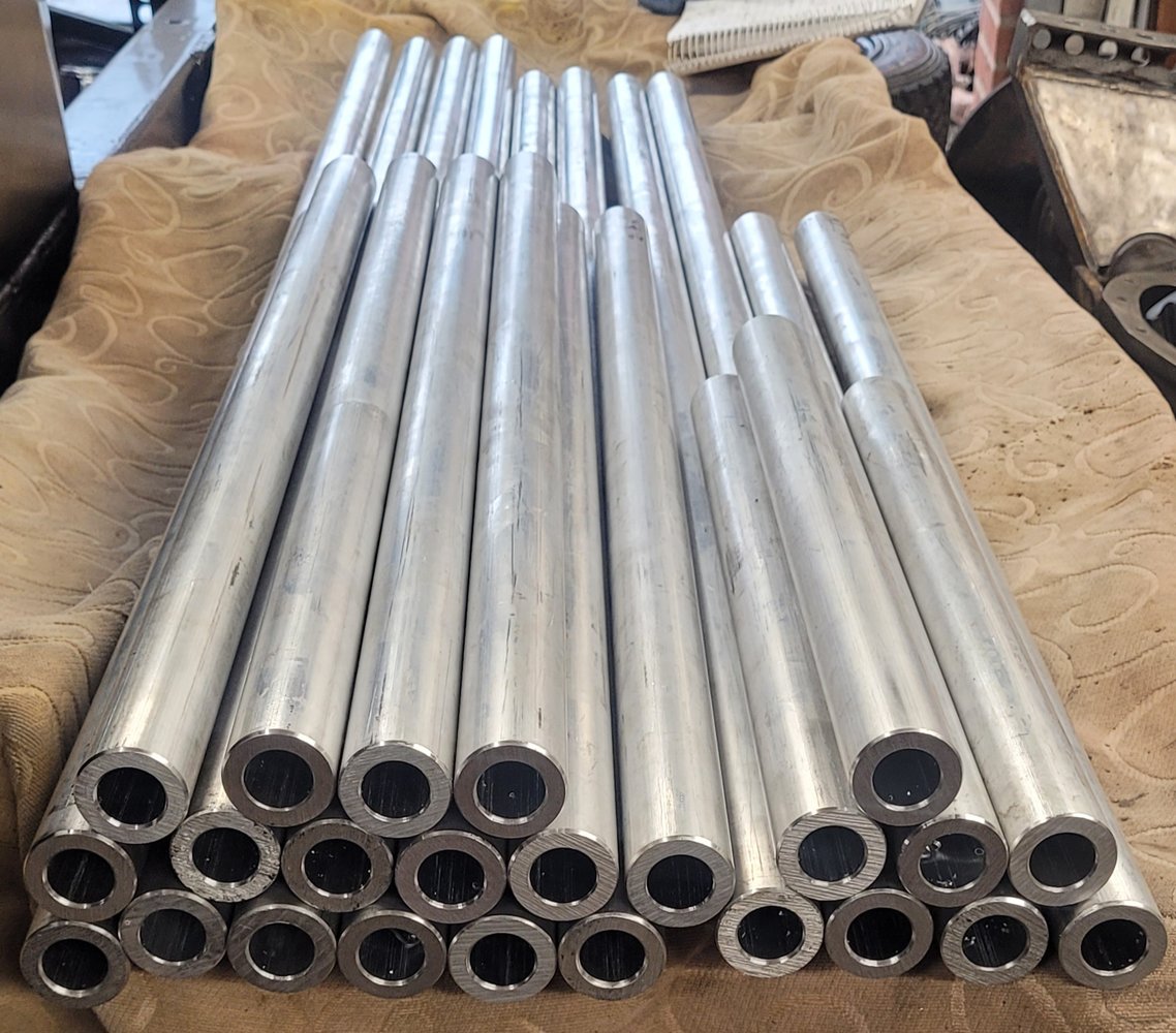

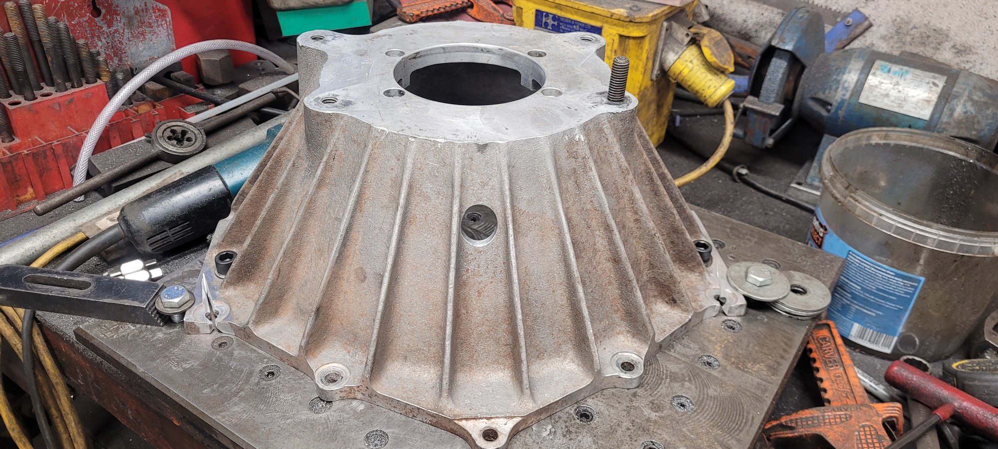

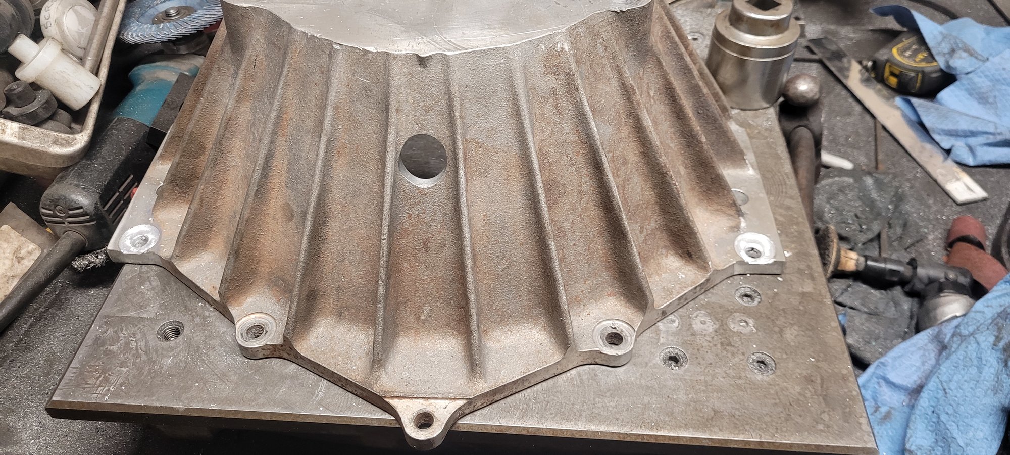

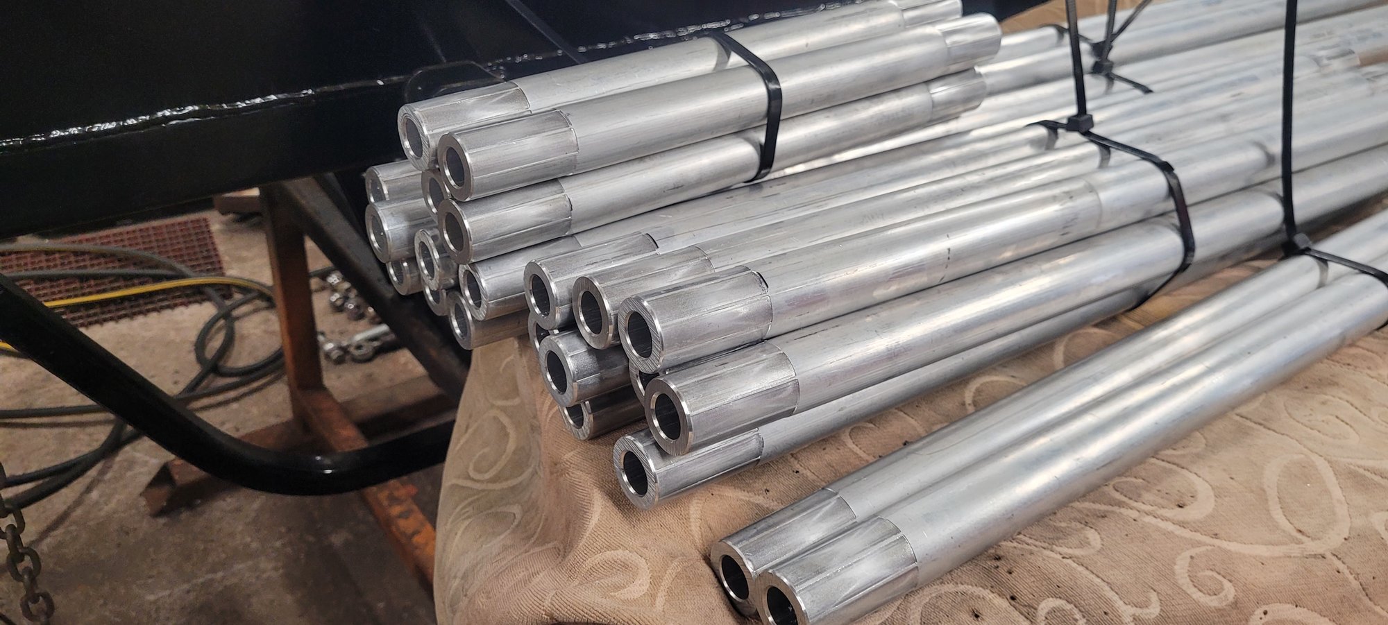

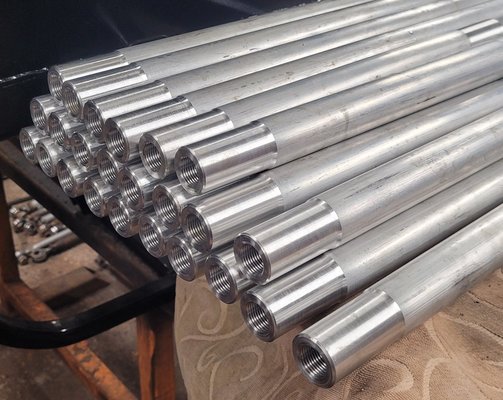

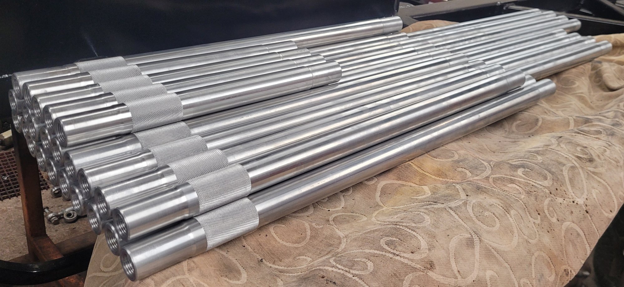

How many link bars are on one car then?Finished off the link bars ready for anodizing and repaired a couple of cracks in the bell housing.
View attachment 483379View attachment 483382View attachment 483384View attachment 483385View attachment 483386

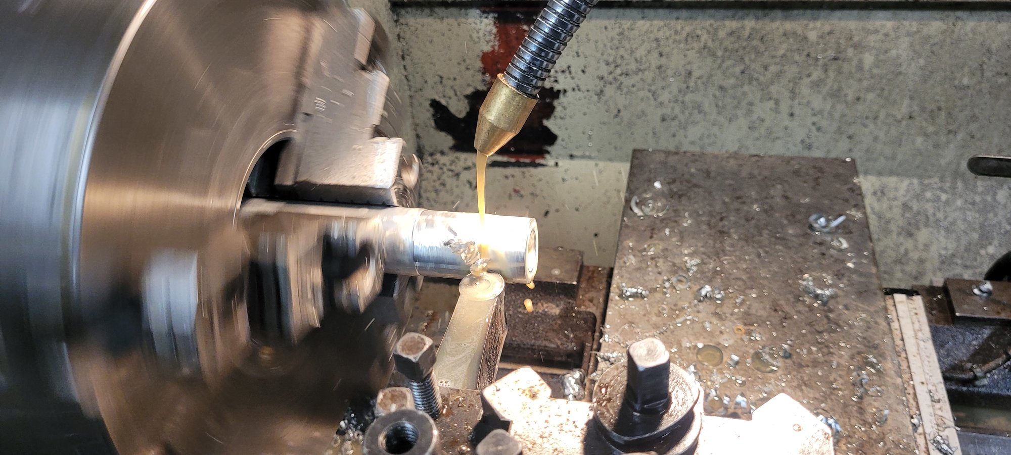

13 with the drag link and track rod ,I also made one or two spares while I was at it.How many link bars are on one car then?

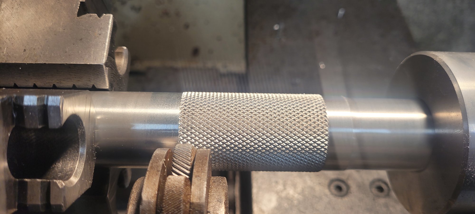

Echo that, superb knurling too. 110%looking real good quality work![]()
