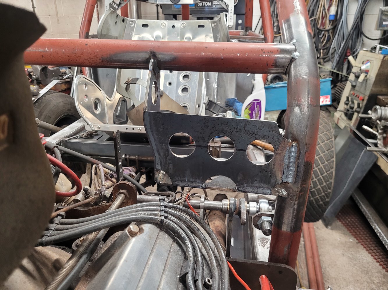

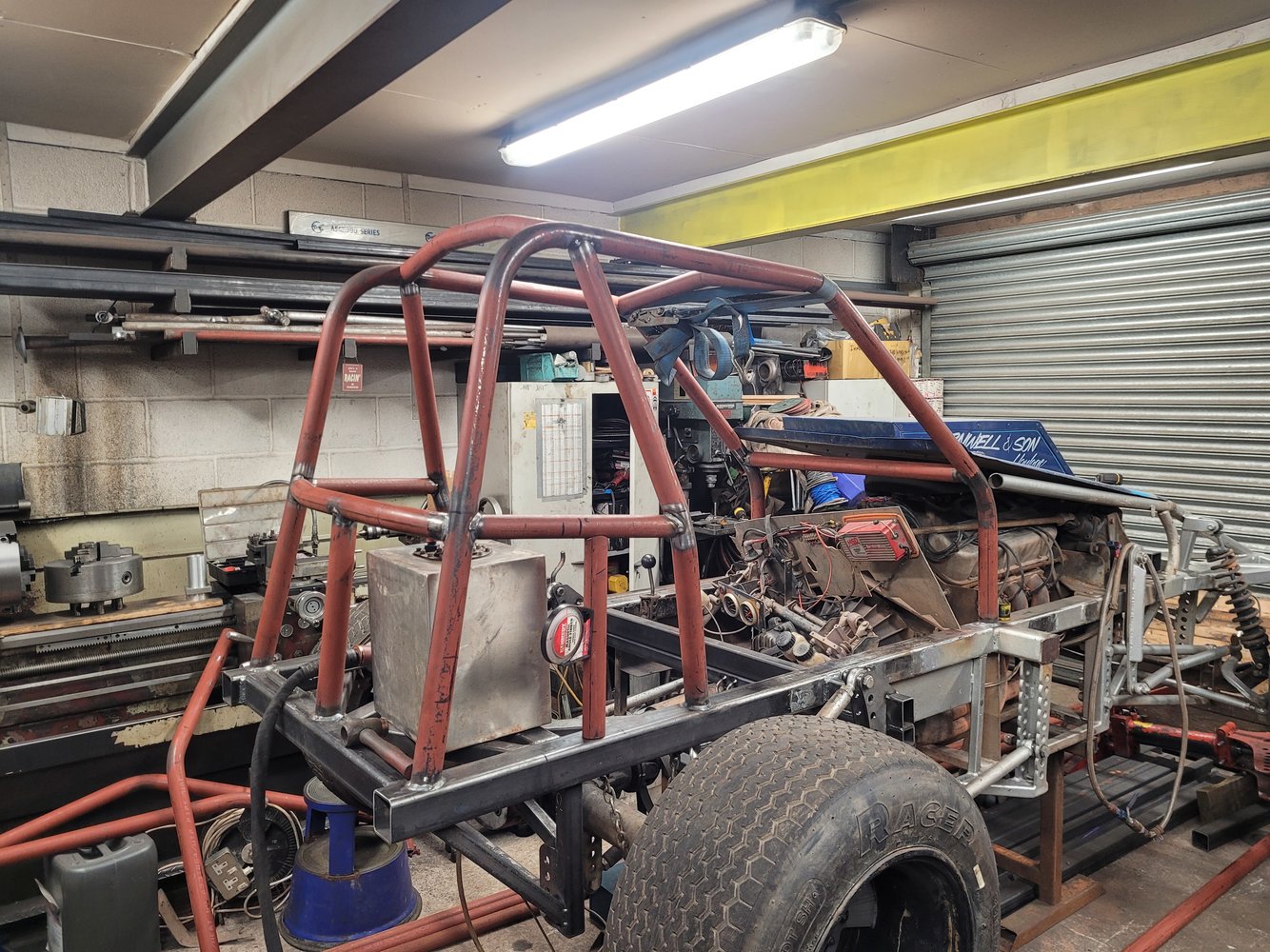

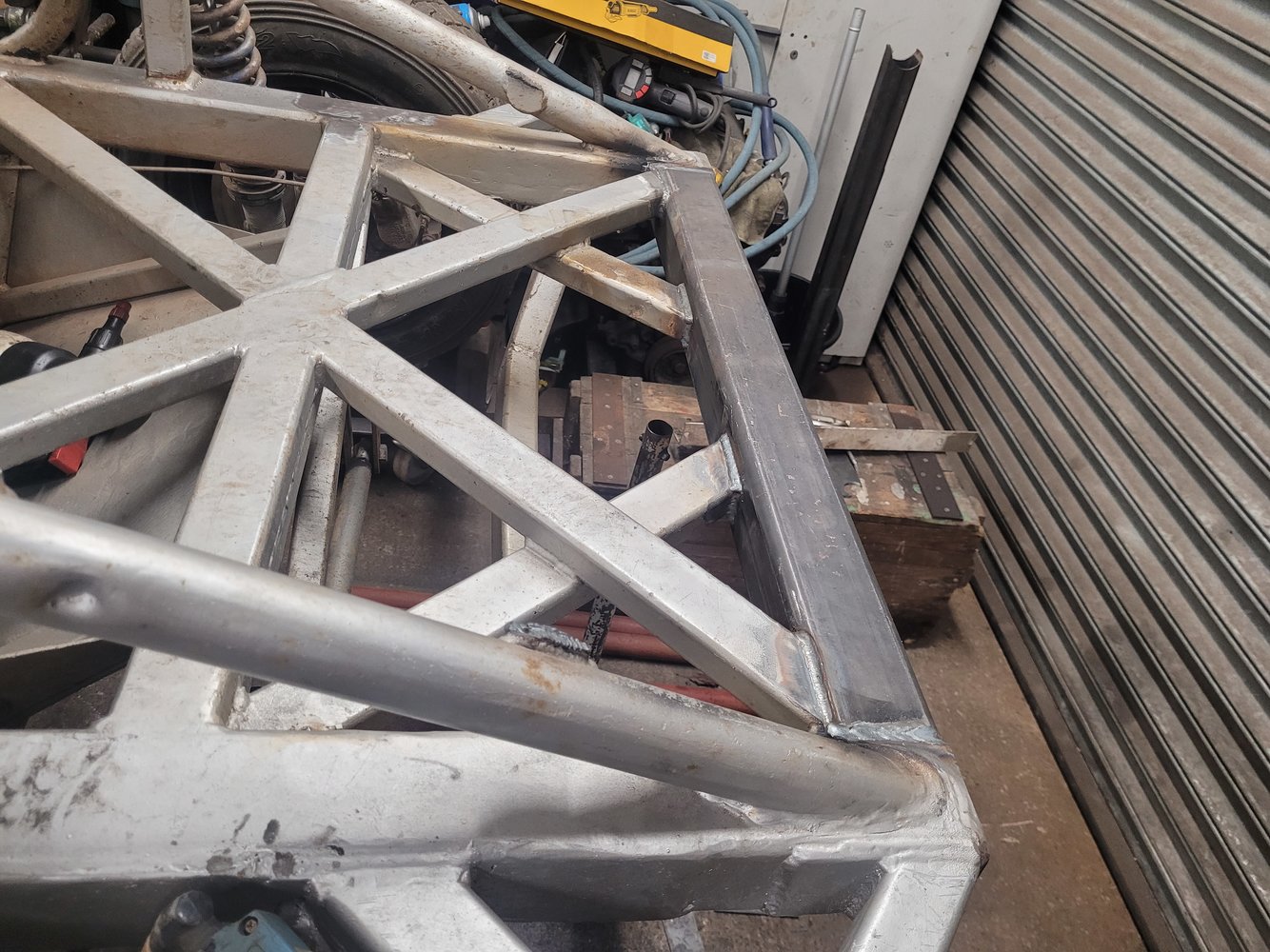

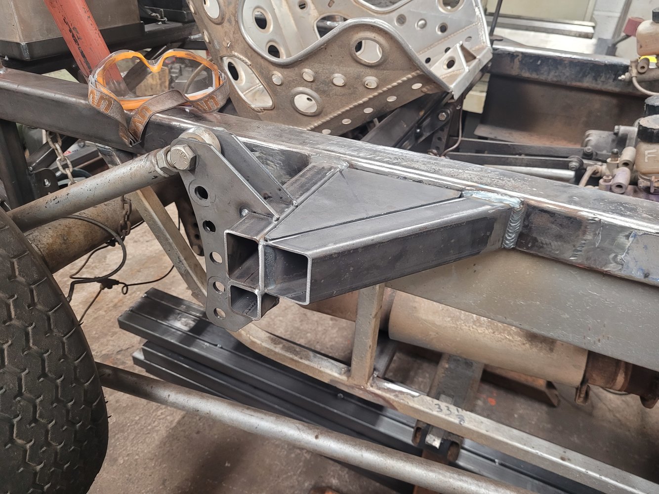

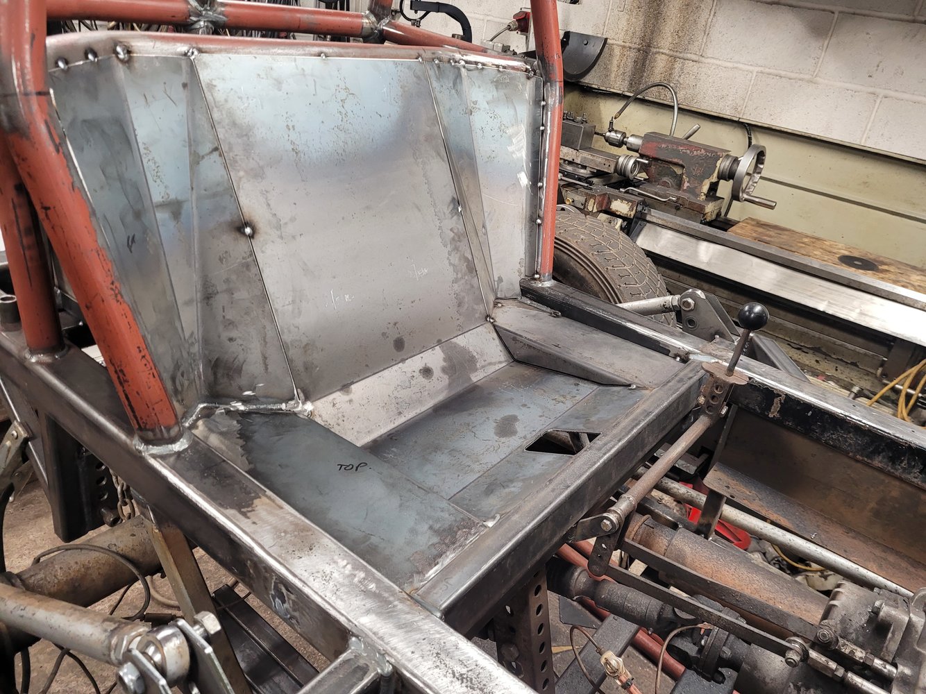

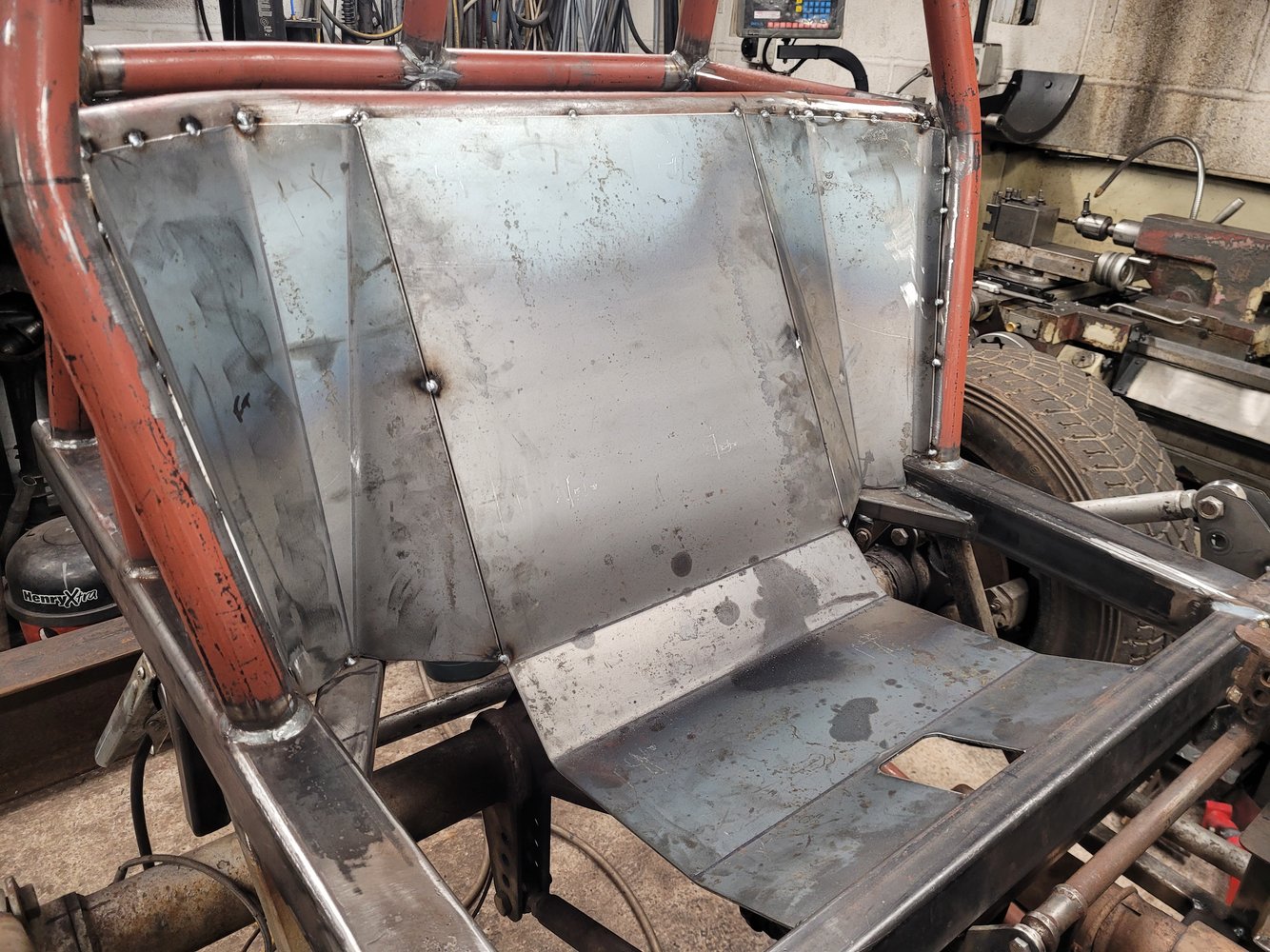

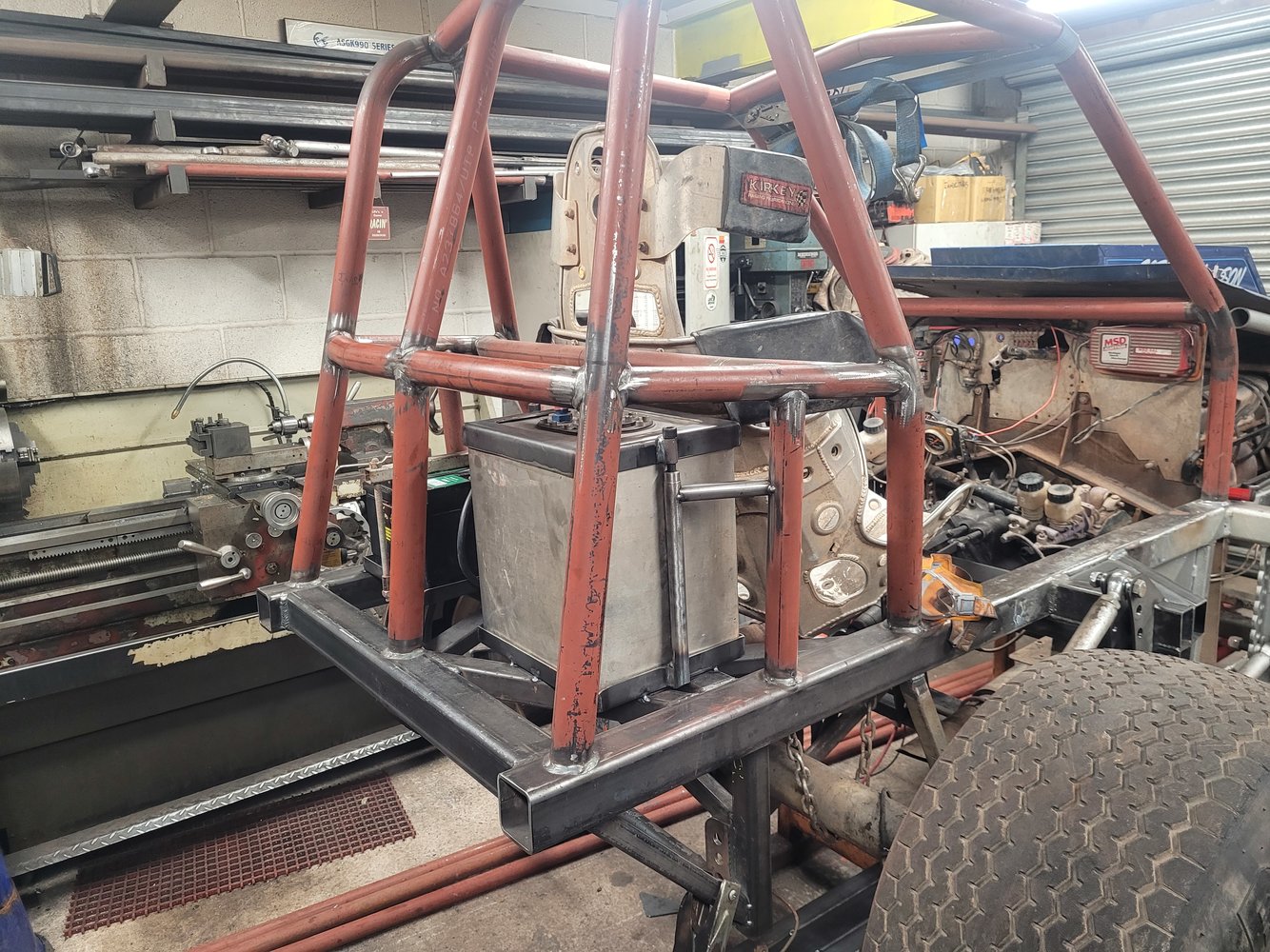

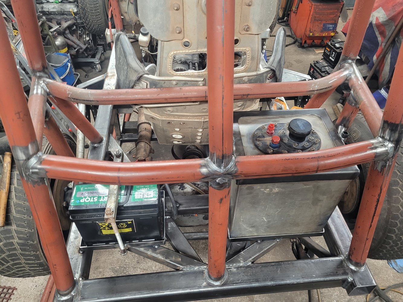

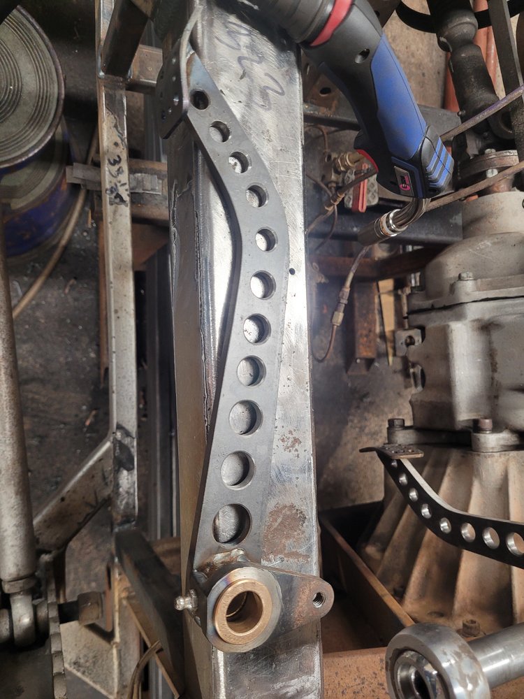

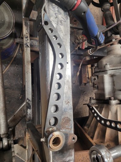

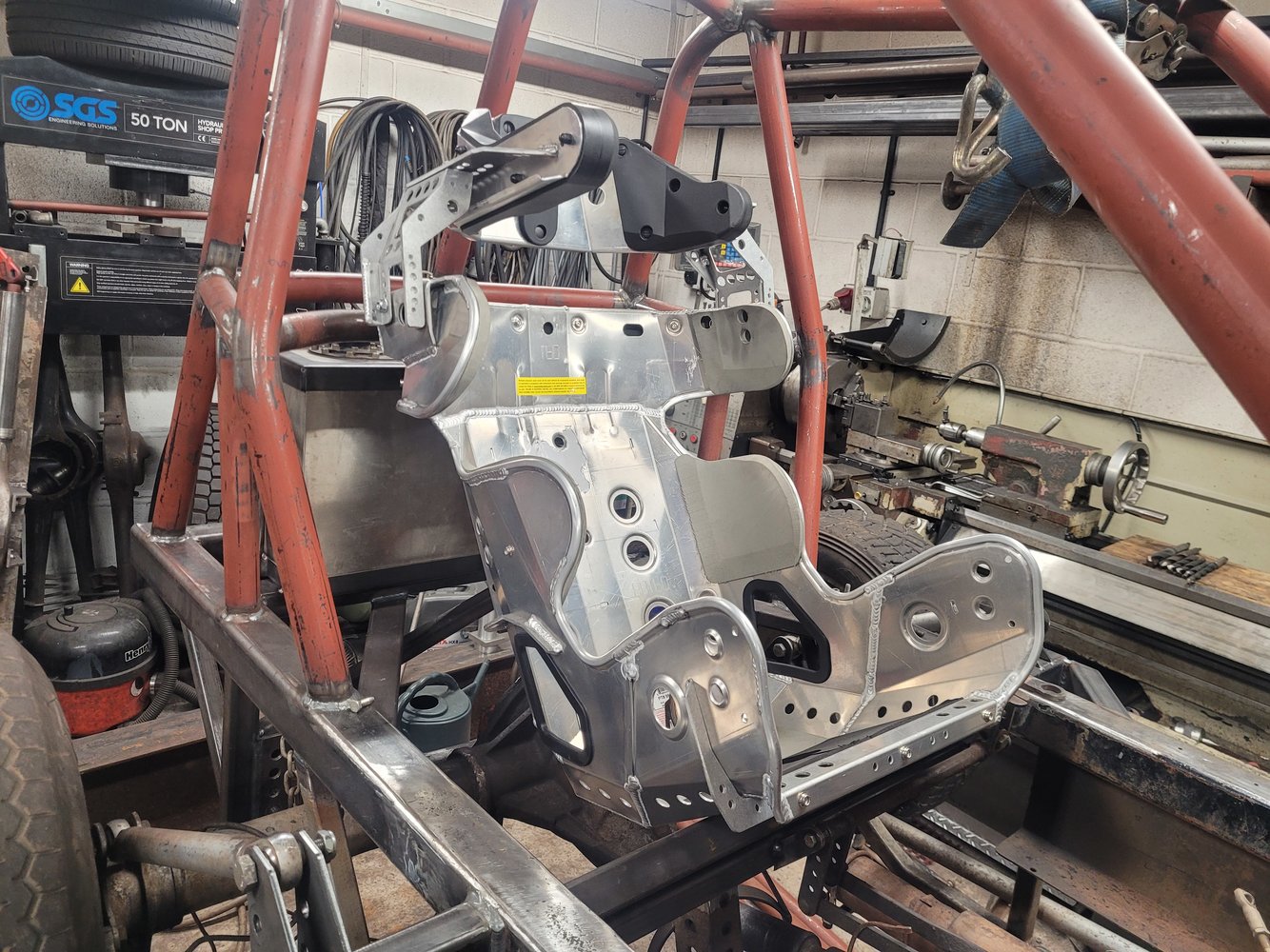

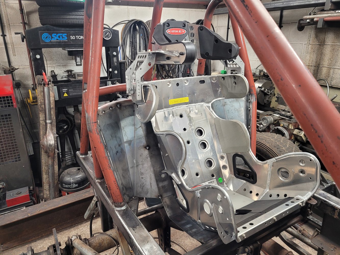

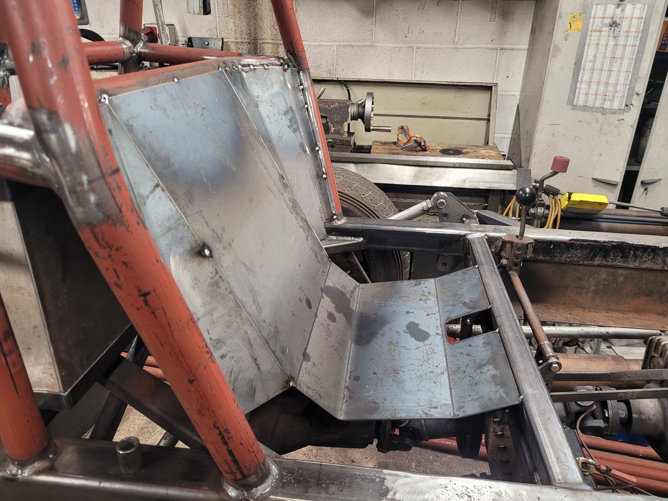

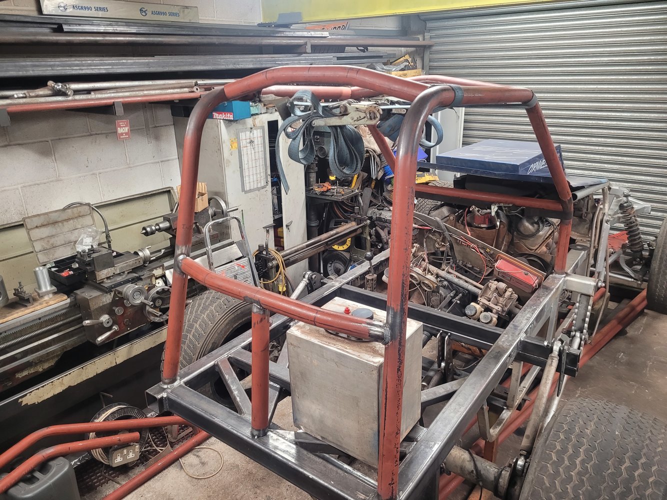

getting thereLittle bit more
They do take a beatingThere's some serious bracing in that, I assume these take a fair beating. Very nice work btw
is that 1/8th steel plate under the seat as the f2 has
if the prop shaft lets go your nads will well suffer
Yeah it's all in 3mm the rest of the floor by the seat area has to be plated too but I've had enough todayis that 1/8th steel plate under the seat as the f2 hasif the prop shaft lets go your nads will well suffer

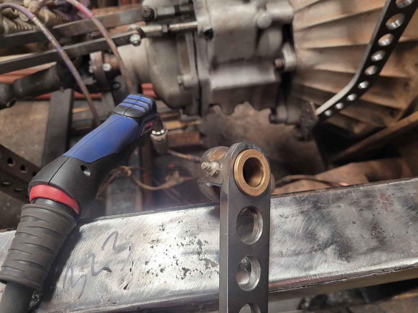

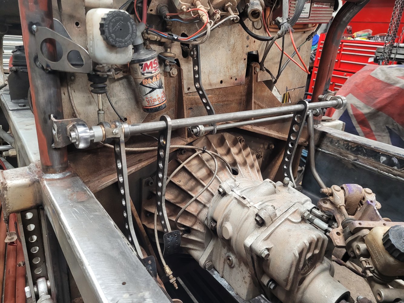

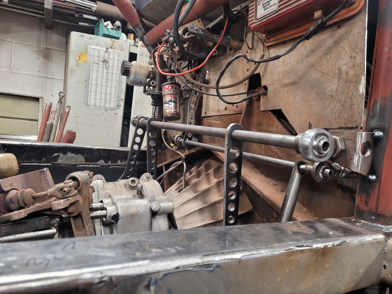

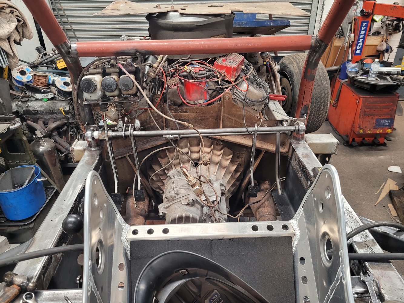

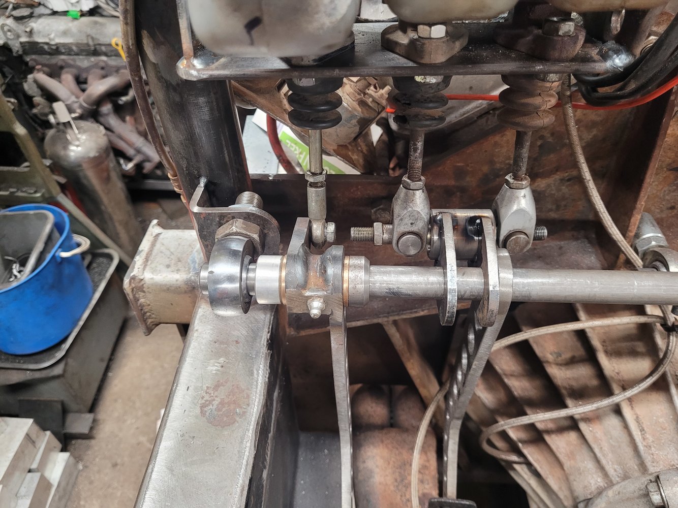

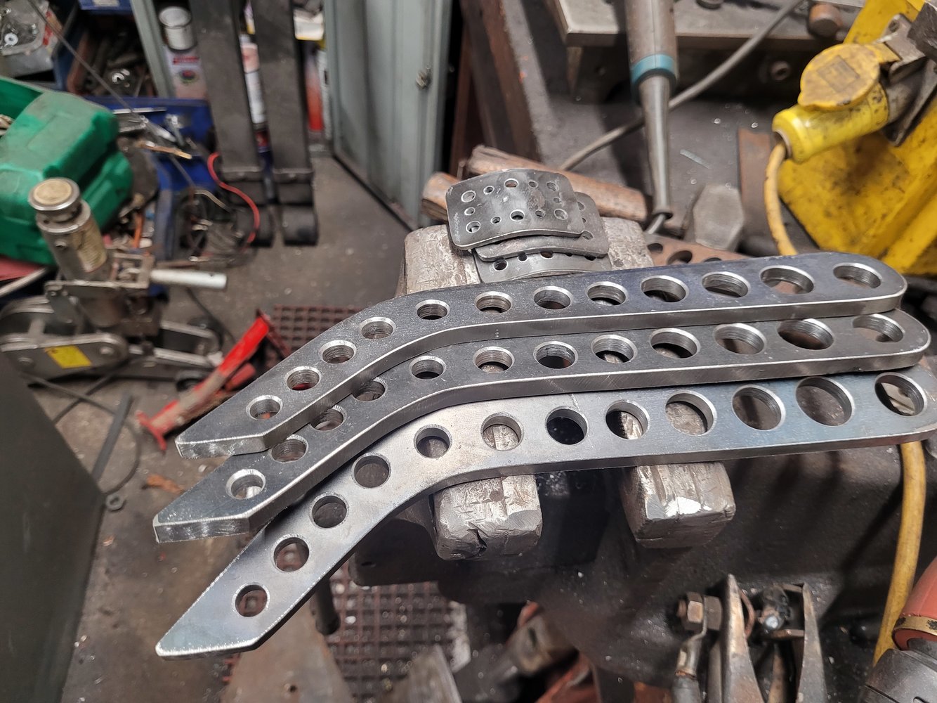

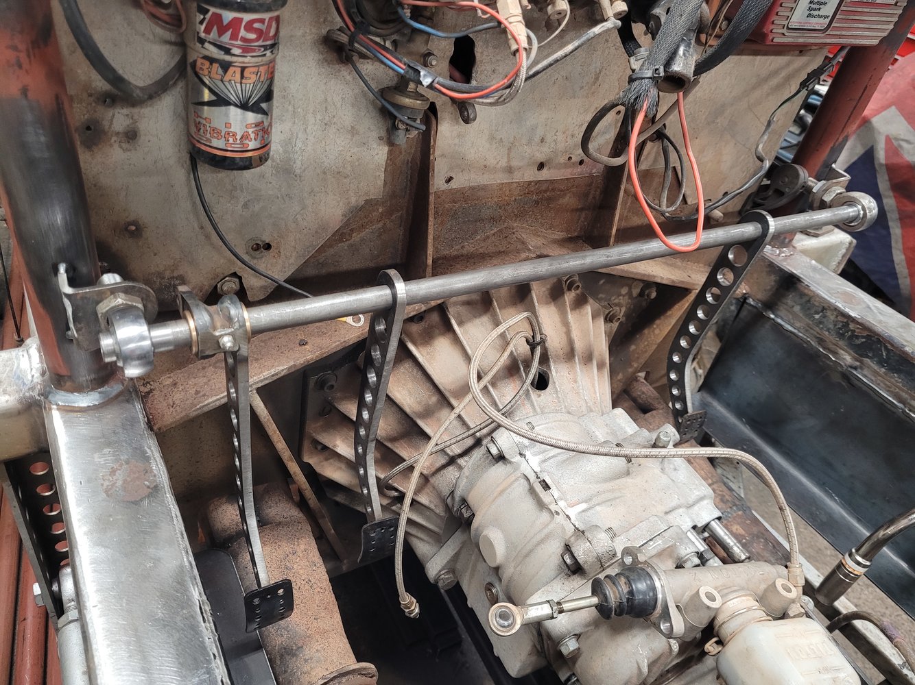

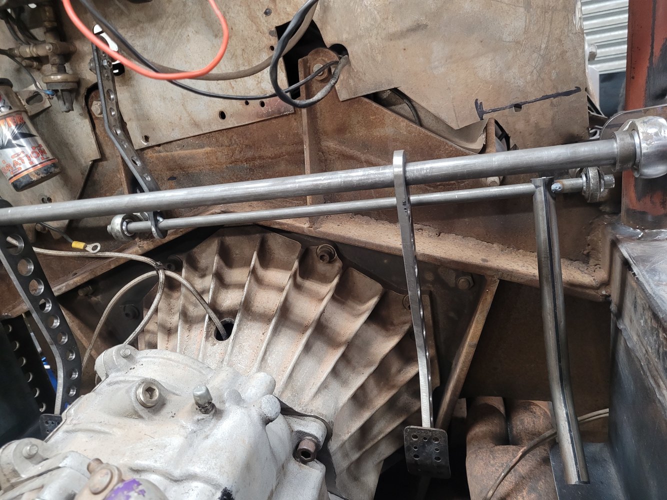

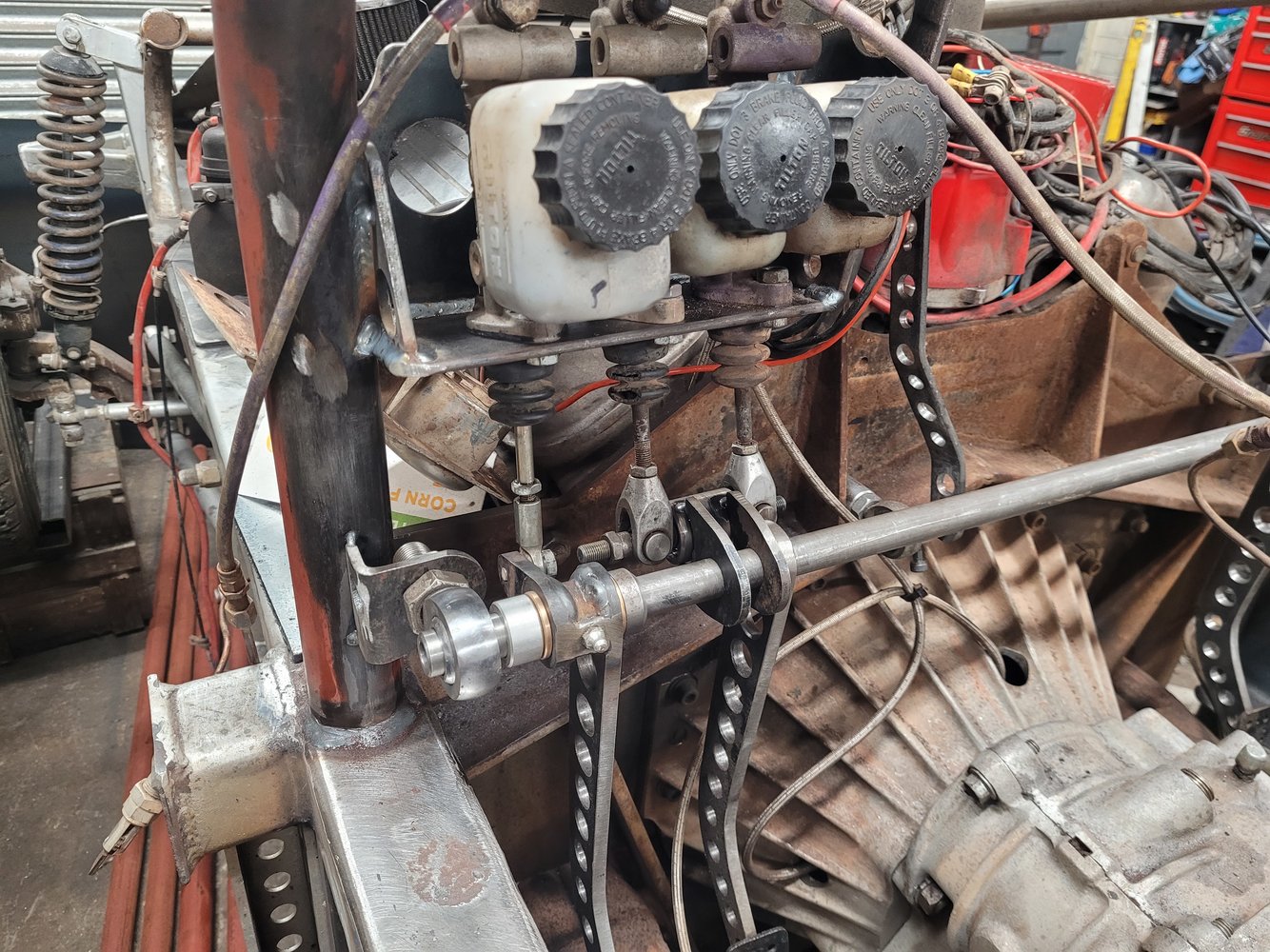

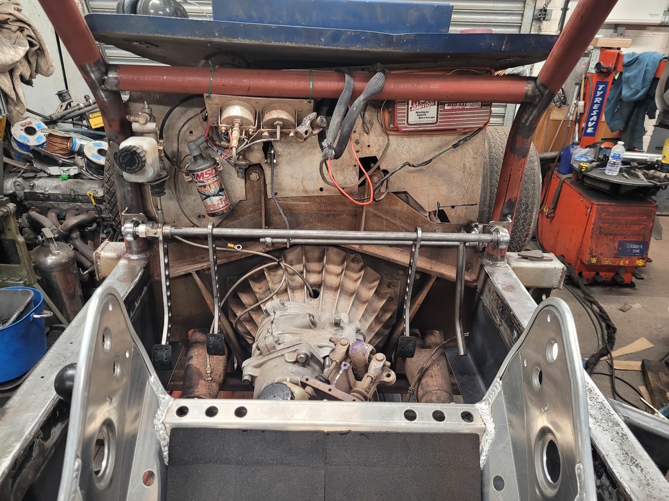

love the lightening holes in the pedalsFiddly bits take forever, made a start on the pedal bar and clutch pedal.
View attachment 433299View attachment 433300View attachment 433301
dont think it will help it go any faster mind the weight of it

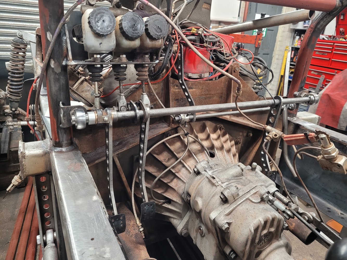

Are those pedals in their final positions? Looks awkward with the throttle and brake so far apart. Surely the transmission will get in the way?Fiddly bits take forever, made a start on the pedal bar and clutch pedal.
The throttle peddle isn't in yet I need to make the cross shaftAre those pedals in their final positions? Looks awkward with the throttle and brake so far apart. Surely the transmission will get in the way?
Or is this thing a left foot drive, with everything 4rse upwards!
so two brake pedals then i presume left foot braking is normal on these then?The throttle peddle isn't in yet I need to make the cross shaft
