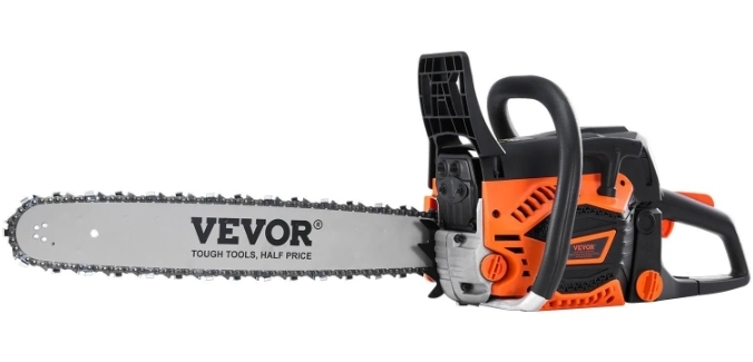

It has paid for itsself now. Strip it down and port it, that would be fun.I just bought this.....

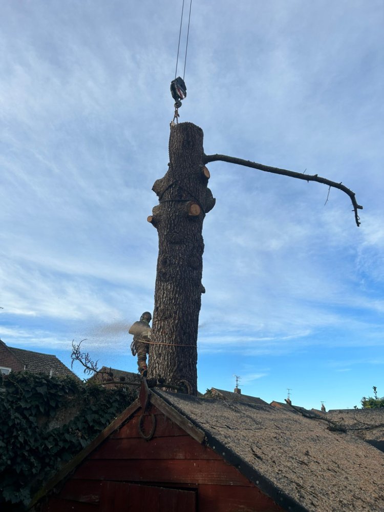

Only needed for 1 proper tree job & lopping it into Firewood length sections really - so at £80....![]()

I've only just run it for an hour or two! Also, no idea how to port one - & as its not a motorbike I think I'll keep it as it is & just try chopping the tree down & up with itIt has paid for itsself now. Strip it down and port it, that would be fun.
