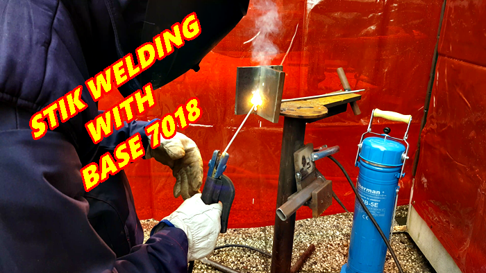

    Welcome guys if someone of you would like to watch my video I inviting you for visit my YouTube channel.
    If you like it or if you don't like .or you think is something not correctly please feedback in comment

    Trying to be positive but.....Is it my eyes or are his welds full of holes.....shrinkage holes

    @AdiWeld I think you need to go back to welding school before you start giving out instruction.
    The amount of issues with your technique and video is too great to list

    Rod and is absolutely completely wrong take the bottom of the rod of out of the slag by picking up the bottom of your hand a good 3 inches. I would always hold the stinger with one hand, and I think your arc should b thighter you could jam in that rod further into the corner on first run. It’s hard enough to learn welding without showing people bad habits,

    Aye not getting into the centre with that first pass
    Should be up left right x mas tree triangle and you have to mutter " mickey mouse / donald duck as you hang on to the edges to fill the uc i could do that in one pass with a 3.2 mm rod

    I quite agree he is dwelling too long in the corners, no actual “root” going in.

    I do agree but he came on here with an instructional video naturally we were gonna criticize. Instructional videos are meant to be the 100% right way

    I'll add a my two pence not worth much but hey as stick welding goes in position like that is hard unless you do it every day or you very skilled. There are issues there. But the op asked for criticism and it was given maybe a little harshly but he's taken time to video edit and share takes courage I'll give him that. But maybe asking for advise to tighten up his skills first before trying to pass on information

    Nope, don’t agree. The guy has got a dozen videos on YouTube purporting to instruct people how to weld. He may be a new member but he is misleading people and teaching them bad habits.
    I’m not the best welder in the world, nor the most knowledgable, and hence I don’t make instructional videos.
