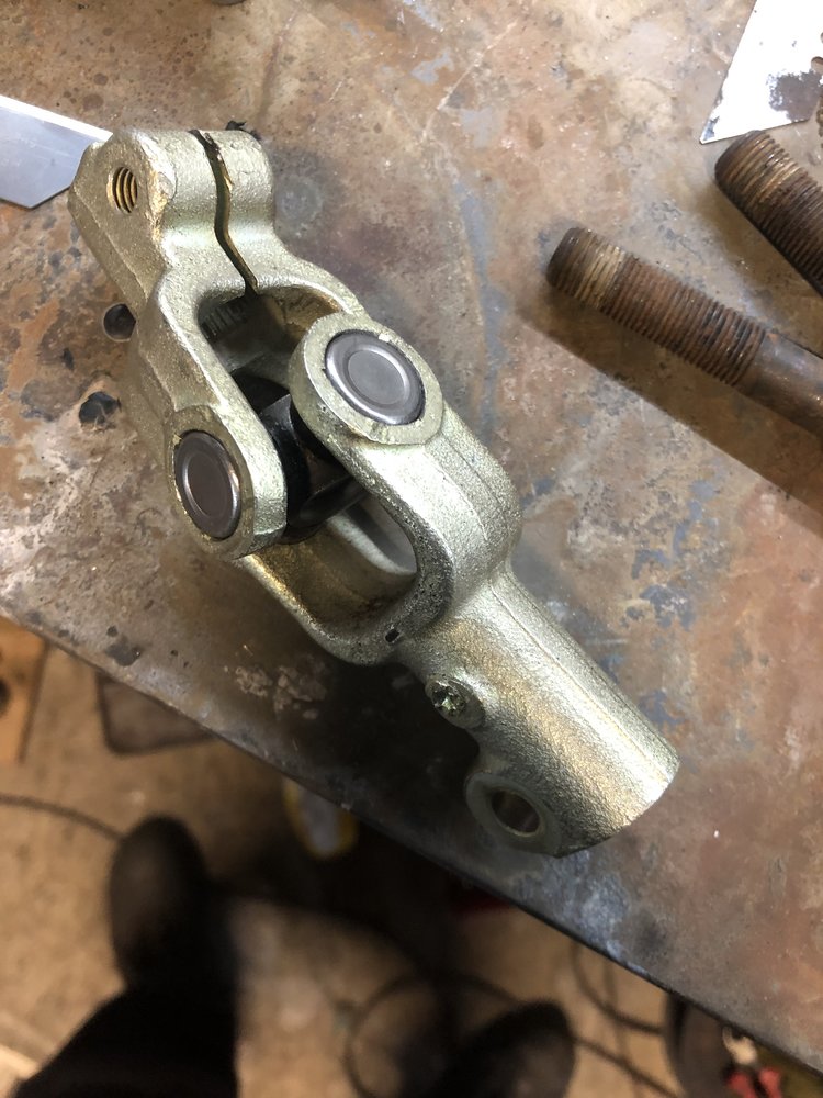

Either another piece of angle , with a pin welded on. Or a piece of pipe, ground down , at an angle, so it is in line with the uj, welded onto a piece of angle, with a lug welded onto the pipe to locate it against , the front of the yoke.Something that worries me, if ever I have to strip mine down again, is one half is tapered on the outside, meaning I shan't be able to press it evenly in the vice. I think it will slide sideways off of any socket I use. Any ideas how to do it, should the need arise?
I just use a bit of flat plate as a packer and continue as normal , done loads,, most folk that spend time round land rovers get good at changing them , its another land rover weak spot. They look like a bit of a Rubik cube till youve done a few then you wonder where the issue ever was ,,, a good vise is a must have though.Something that worries me, if ever I have to strip mine down again, is one half is tapered on the outside, meaning I shan't be able to press it evenly in the vice. I think it will slide sideways off of any socket I use. Any ideas how to do it, should the need arise?
