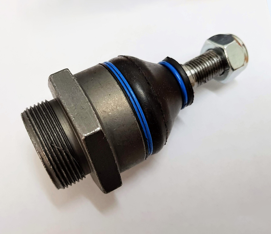

No, I only changed them today but the tracking can not have changed.I take it you've had the tracking done again since changing the upper ball joints?

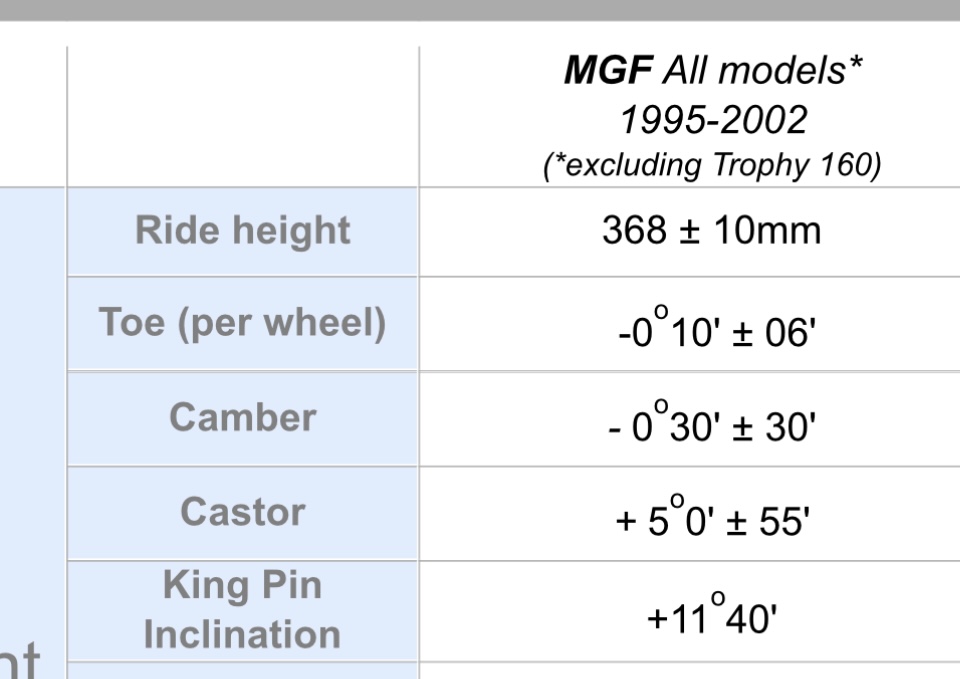

Where are you seeing toe out?
According to this information the setting for tracking is not 1mm toe in . The correct setting is 10minutes toe out +/- 6minutes . As to what that works out to in mm depends on the diameter of the wheels. Nothing else you have tried works so what have you got to lose by trying these settings ?
Not unless it’s made with the pin off centre to the thread.You'd be surprised.
No it doesn’t clearly say toe in! The - before the 0 indicates toe out, if it was + it would be toe in . Your castor readings are a bit short as well as shown on one of your previous posts which isn’t helping.
I know, I did post an apology above.No it doesn’t clearly say toe in! The - before the 0 indicates toe out, if it was + it would be toe in . Your castor readings are a bit short as well as shown on one of your previous posts which isn’t helping
If I place two pieces of timber parallel to each other, measure the distance between the ends then turn them towards each other by 1mm, the distance between the same ends is -1mm of the original value. That's how my brain was interpreting the toe data.Oops! Seems I owe an apology to few of you. My brain has been reading minus as IN but apparently for wheel alignment data minus is OUT for toe data![]()
I was just saying that's how my brain was interpreting the plus and minus.Not exactly, the extra length of the wood over the diameter of the wheel where the tracking gauges would normally fit will have an effect. Imagine extending the wood even further the reading would be exaggerated. Some garage computer programs translate the readings from degrees to mm or the other way according to the wheel diameter . It would be possible to do a bit of trigonometry to come up with the correct reading , I could have done it 50 years ago but would struggle now
