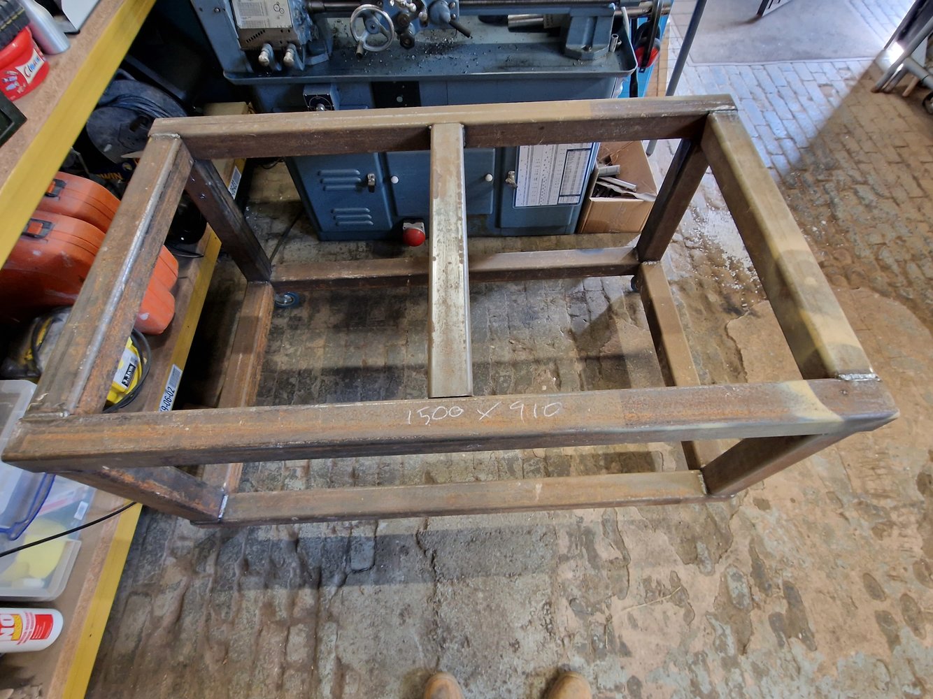

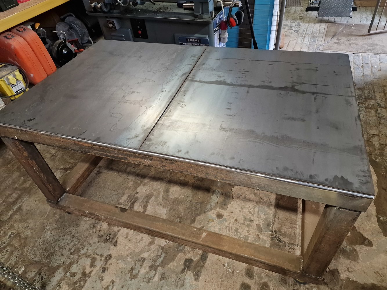

That'd work, probably wouldn't need much of it. The spaces between the box section are 620 x 750.If you go with 6mm, what about welding flat bar on edge underneath.
Make a grid arrangement.
More or less how the tab and slot ones get their strength.
but you'll get the idea...
Like that, sounds more elegant than BFH....
