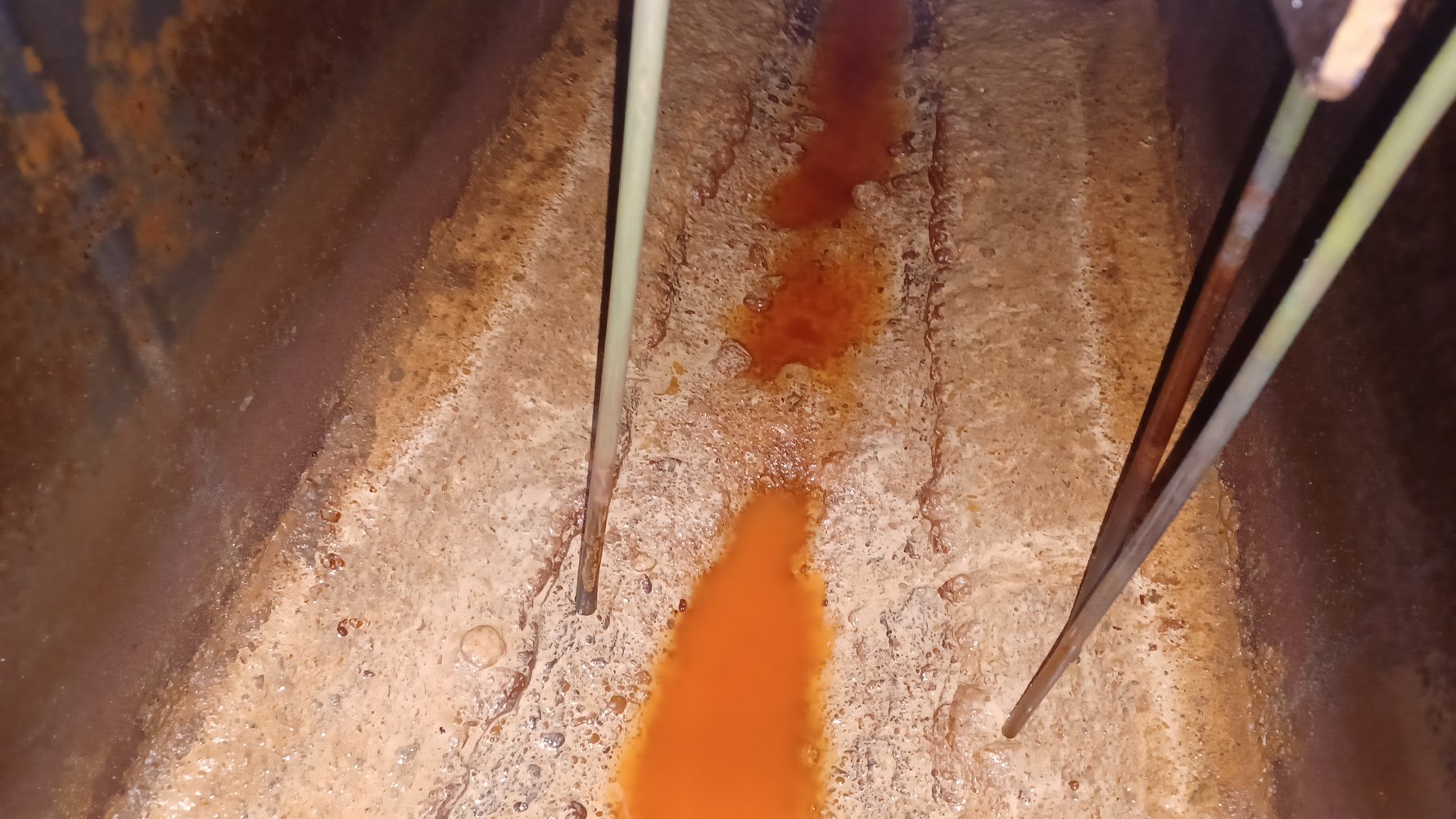

If your tanks not full, condensation in the air gap will produce water in the bottom of the tank, standard procedure to fill boats up when winterising them.That the remnants of diesel bug so at some point had some water in there. The tank is part of the boat so there is no drain. What you can see at the bottom is the Hull.

Once clean use small spray bottle and spray all surfaces with diesel, itll help stop the corrosion.I'm not keeping it past next April so I'll leave it empty till March then put enough in to get it through a sale then it someone else's expense![]()

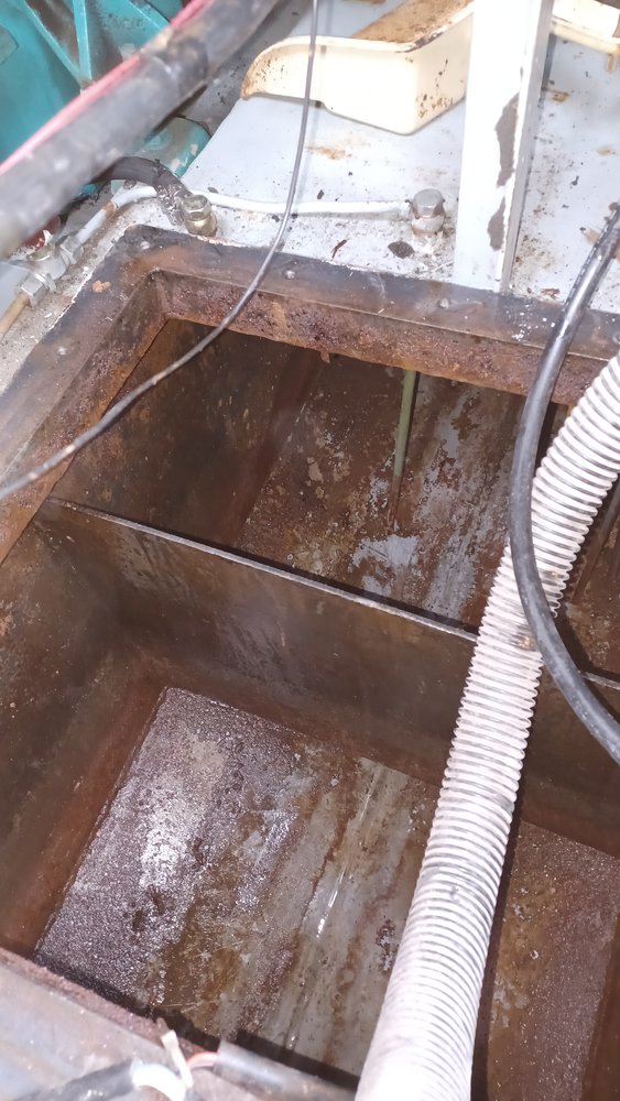

There needs something doing about the corrosion on inside of tankBit of winter work, the diesel in her was bad, really bad and I knew the tank was going to be a state.

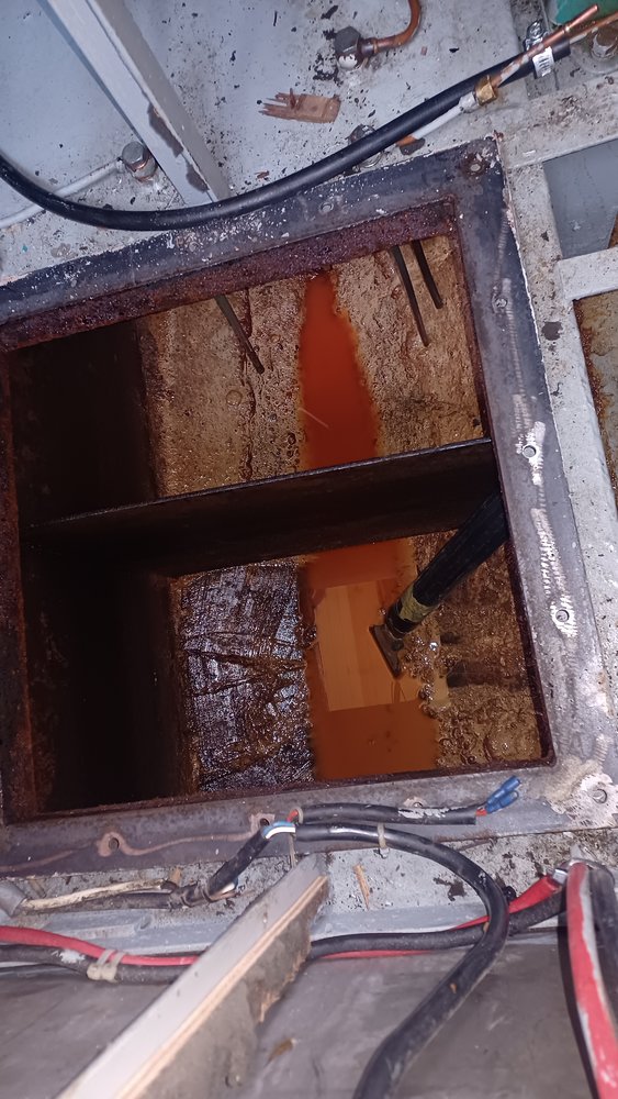

I've drained out the 110l of diesel and got the tank access panel open today.
Any ideas on an easy way of removing that sludge? I was thinking of a scraper and scooping it out.

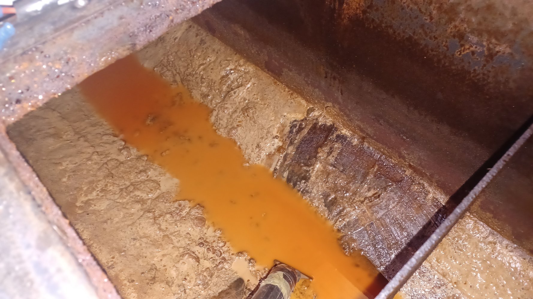

The sludge is the remnants of diesel bug, she did have engine problems the weekend I moved her to her current moorings. Had both engines turn off at one point. I'd changed all the filters a few times which had stopped the issues but I wanted to get rid of the potential for issues for its next owner as I think it will probably go overseas.Are there any maritime regulations regarding fuel tanks?

The bugs grow in the water that settles in the bottom of the tank, some is from the fuel some from condensation, pumping from tank to tank through a filter and water separator would be a good solution. Adding treatment to prevent the bugs also helps.The sludge is the remnants of diesel bug, she did have engine problems the weekend I moved her to her current moorings. Had both engines turn off at one point. I'd changed all the filters a few times which had stopped the issues but I wanted to get rid of the potential for issues for its next owner as I think it will probably go overseas.
After cleaning this out I'm planning of spraying the tank down with diesel whilst it's got nothing in it.
2 stainless tanks would be a better idea as you can pump diesel between them via a filter to keep it cleaner and less likely to have a complete fuel issue.

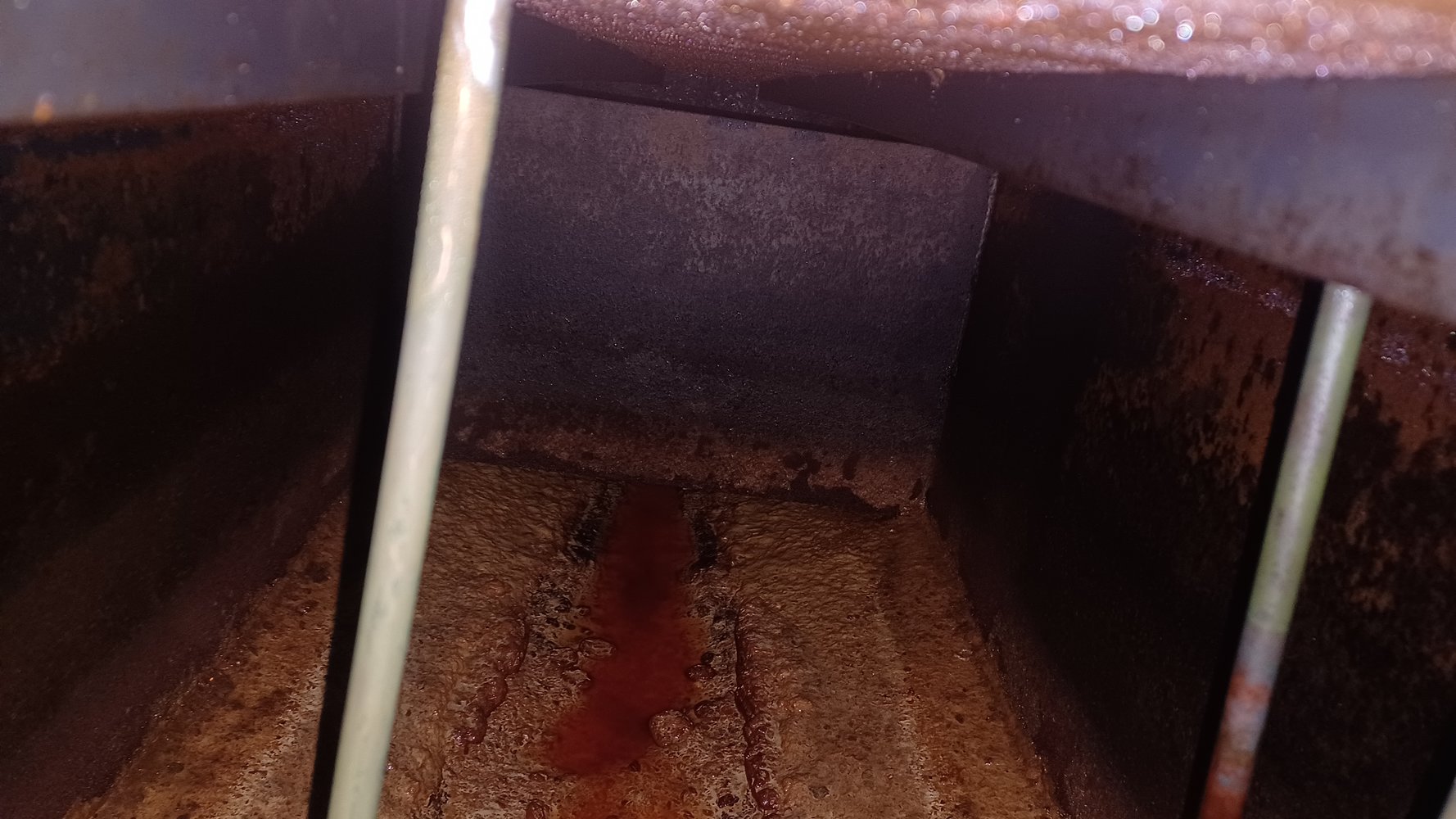

Have you thought about coating it in a diesel resistant epoxy?That'ds the tank finalky jet washed out. Bit crusty looking but it is as clean as its getting. Waiting for it to dry for the next week and I'll start filling it with new red.
You can see its not been "full" for a really long time
