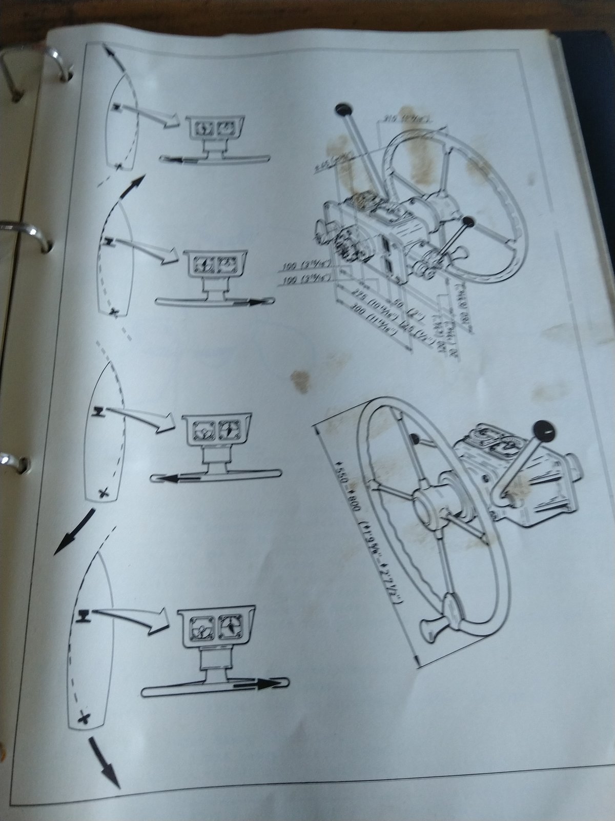

How do the controls work? Is it hard to get used to?

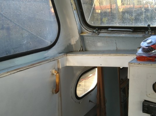

Getting some work in on the wheelhouse
Before
After
Trim to go back on and I still have 4000 little bits to take off the control area so I can clean and paint it.

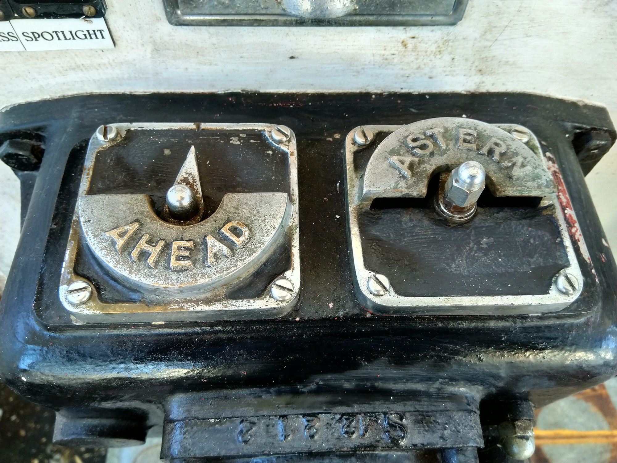

Why would it have 2 steering wheels (or whatver the nautical term is)
She has Twin C6TFLM 6 cyl Rolls Royce engines driving two Schottel drives - which are a 360deg rotating legs with pulling props on the end. This means she has two wheels and is highly manoeuvrable.
