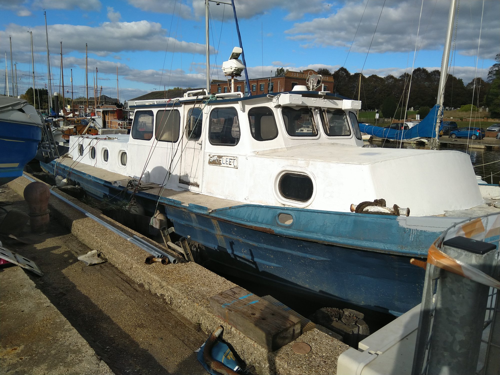

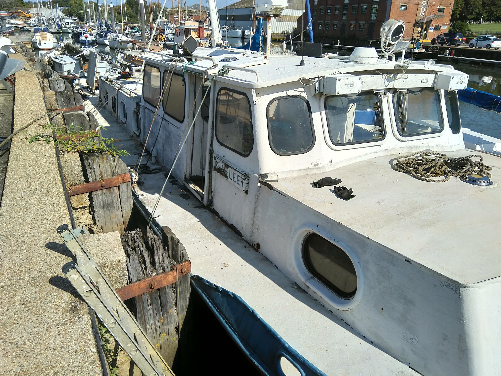

    This is Sunfleet, a 63ft Port of London Authority Launch/Tug/Pilot/Customs boat, we bought her about 12 years ago, lived on her for 3 on the South Coast and the Island, then moved ashore. Apart from a haul out, hull paint and over plate of any dubious bits of hull in 2012 she has been sadly neglected.
    Between a lack of time and an emotional attachment she is long overdue for sale.
    This is her when we lived on her.
    She has Twin C6TFLM 6 cyl Rolls Royce engines driving two Schottel drives - which are a 360deg rotating legs with pulling props on the end. This means she has two wheels and is highly manoeuvrable.
    However after so long unloved the first job was to giver her several hours of pressure washing....

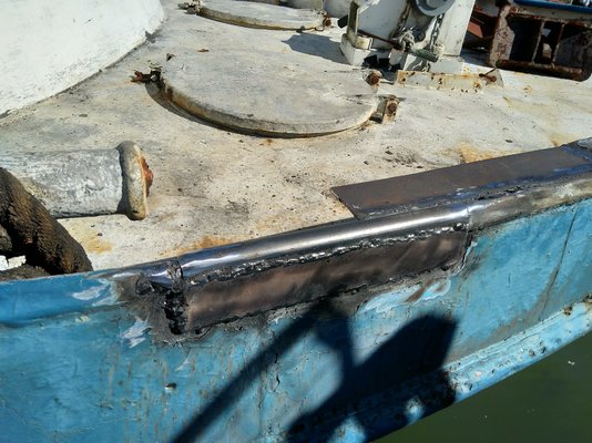

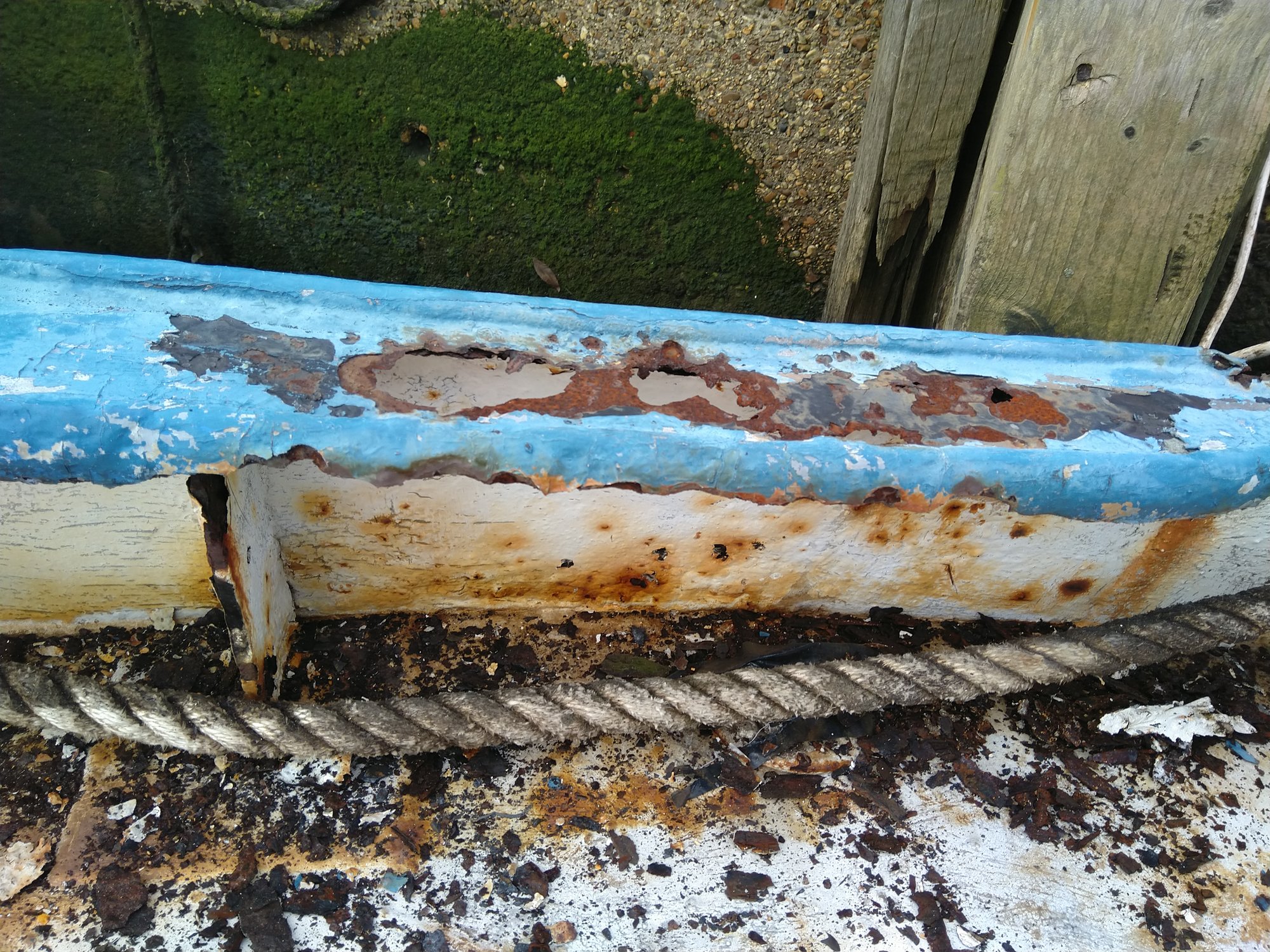

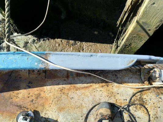

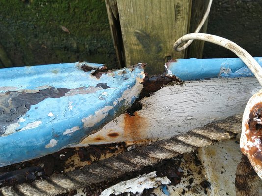

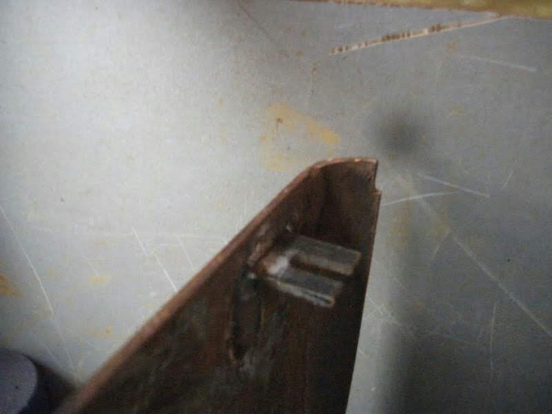

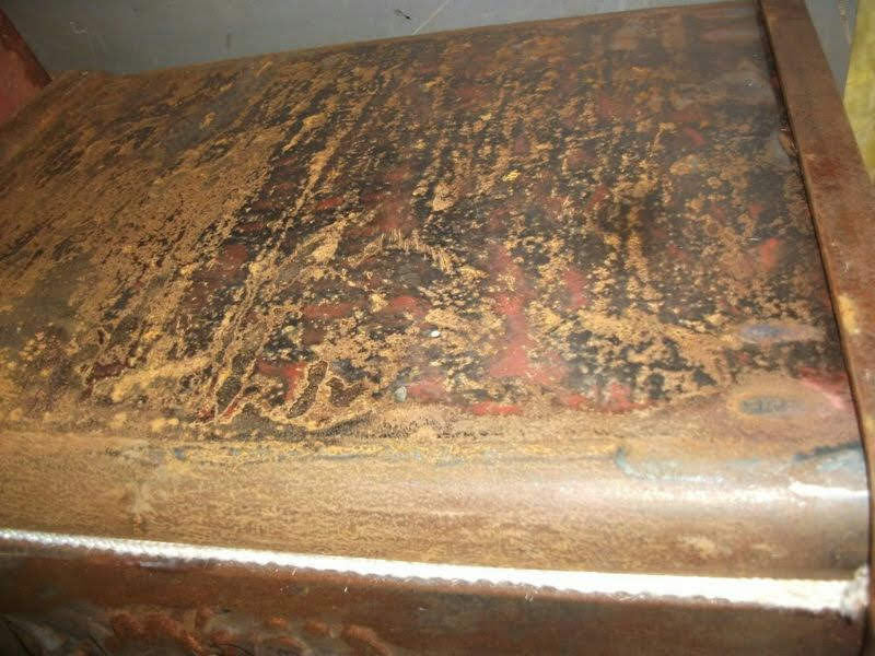

    The bow section had taken a bit of a beating at some stage and the rust had set in so I set about repairing that.
    Replaced the flat section then sliced some tube to give an approximation of the original. Blowing through was a bit of an issue to say the least. As was not falling in whilst "welding"
    Got there eventually

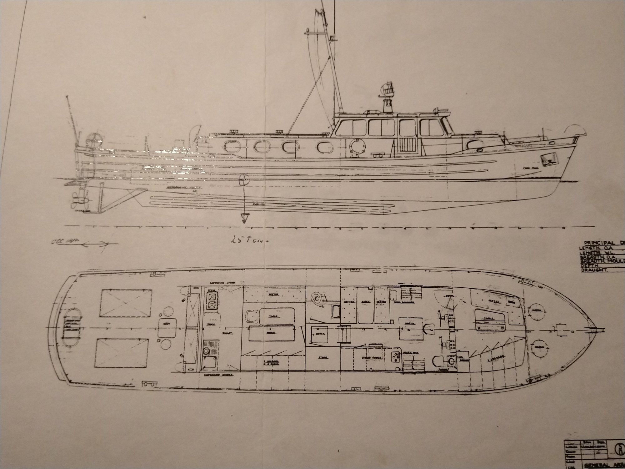

    Found an old photo (1964 I think) of her in service - note she was called "Gunfleet" - her twin was called "Benfleet" . The PLA retains those names to the day so, bad luck not withstanding, she was re-named "Sunfleet" upon decommissioning and sale. - the wooden name plaques on her sides are the originals with the G changed to look like an S!
    Graving plans

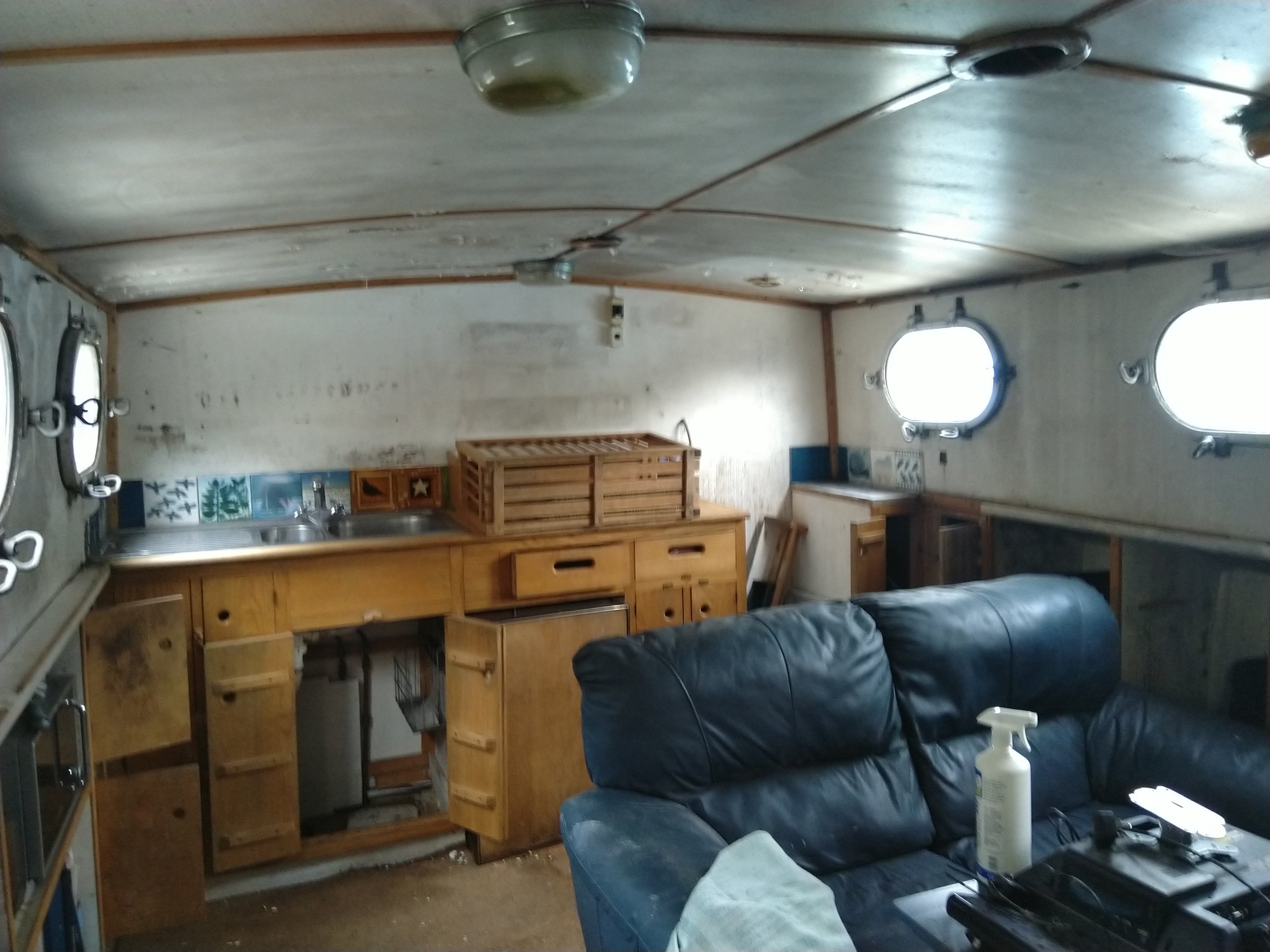

    Inside she was a bit mouldy and some of the paint had started too peel. I'll post some better pictures later but the male half of the previous owners was a master woodworker and the galley area they installed along with a lot of the rest of the fittings was solid oak or beech and all beautifully made, the lady was a ceramicist and made all of the tiles.
    Saloon after about a week of cleaning
    Broken stove
    I mould treated, primed and painted everything - twice
    Not quite finished but well on it's way
    Fixed the Morso stove up - just in time - though the boat is very well insulated. New carpet is last of course!
    More progress pics as I make it...

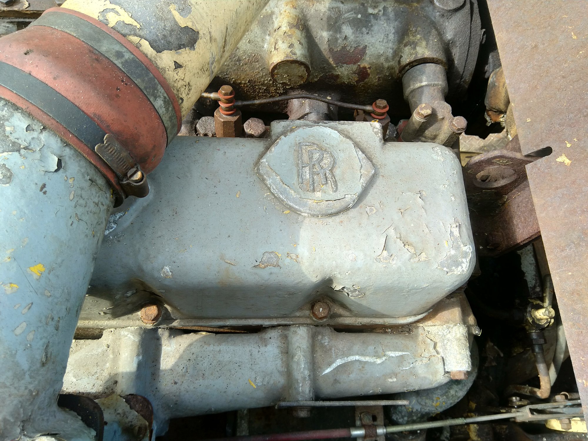

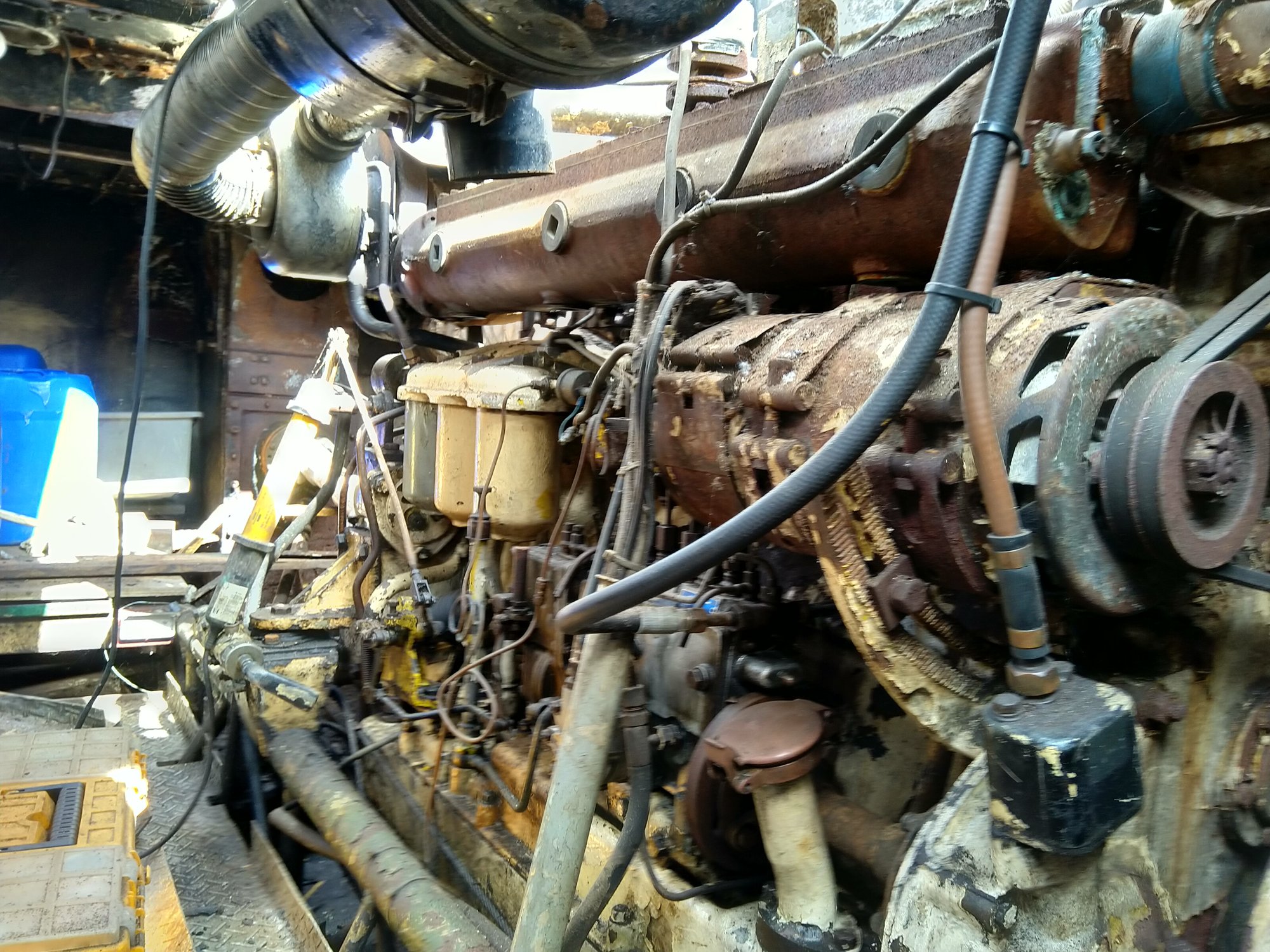

    Meantime have some crusty engine shots
    Garage for the two Rollers...
    Those steel hatches are about 100kg each!

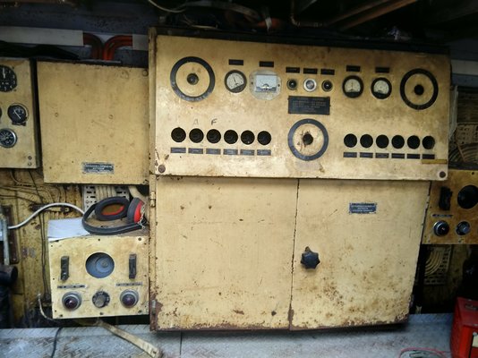

    Engine room controls

    She is keel cooled and there are a couple of big fire/bilge pumps on the engines
    The plan is not to do a full restoration but cosmetics in and out, fix any bits needing fixing, overhaul the systems - shore power, battery systems, water, fuel etc and get her started. Then sell her as a mostly finished project. To do the engines/engine rooms properly the engines should be lifted out and not sure I am up for that sort of work and expense especially if the buyer might just use her just as a houseboat.
