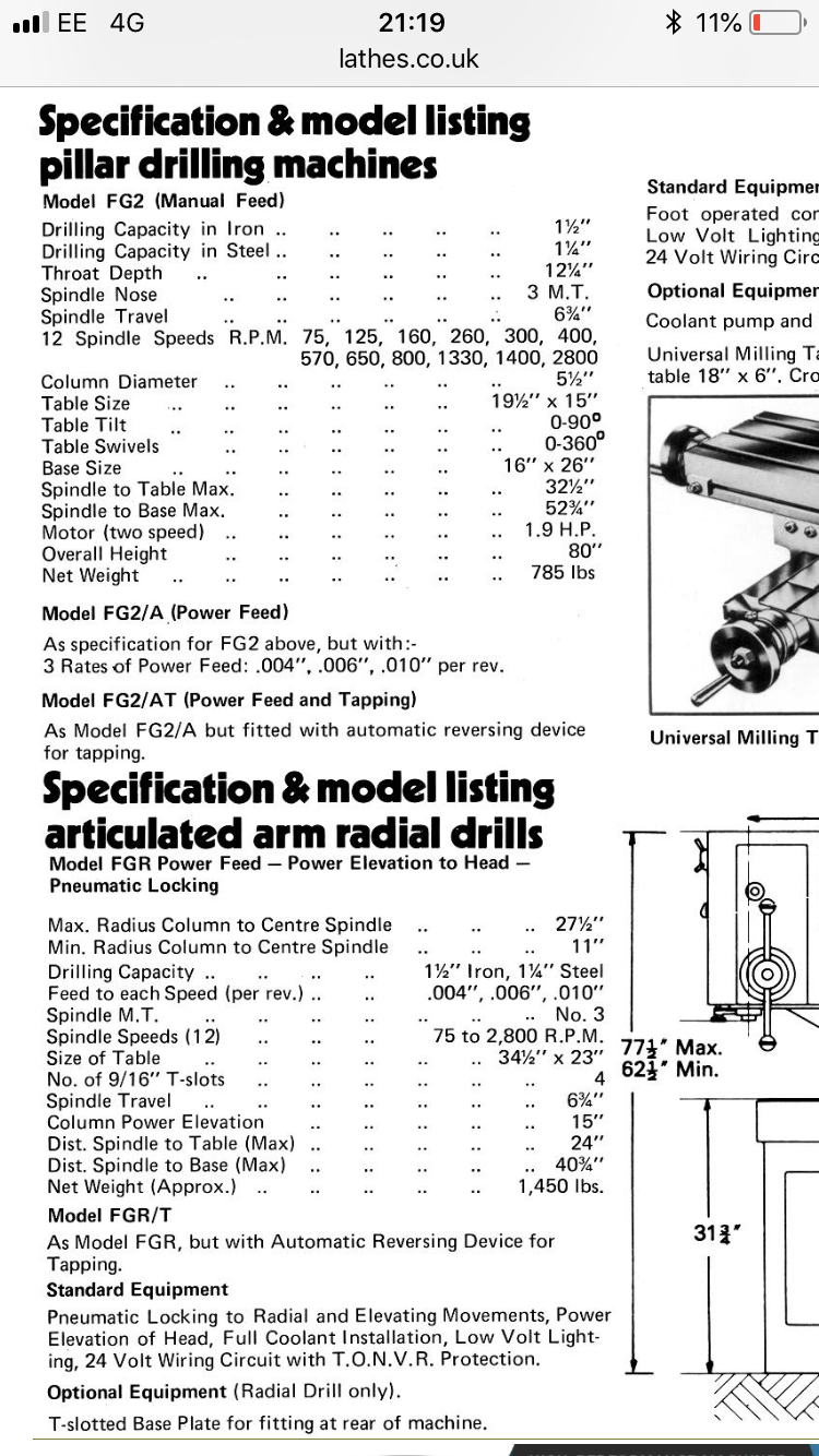

I honestly have no idea mate.@Brad I rather suspect you know exactly what it's worth. Go on, spill the beans, what's it worth then?
I may have something for you. The more I think about it, the more I want to keep this.Brad what part of essex are you in? im setting a new workshop up in october and Im going to need a new decent drill press.
It’s a 3MT apparently, I’ll check in the morning.Gear drive, box table, probably 4 or 5 Morse, it is one I would be keeping over any belt drive.
Me tooGear drive, box table, probably 4 or 5 Morse, it is one I would be keeping over any belt drive.
Two speed three phase motorExcellent range of speeds too.
Maybe just looks bigger in the pic than it is.It’s a 3MT apparently, I’ll check in the morning.
My Arboga is a 3Mt and it looked bigger than that.
Still 3Mt is a decent capacity, 25mm or so.
Also looks to be similar to the Arboga in that the table and head are both on rack/pinion.
Ha785lb
356kg
Blimey.
