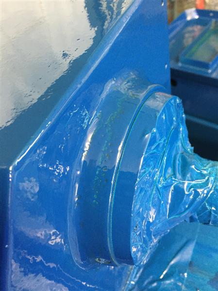

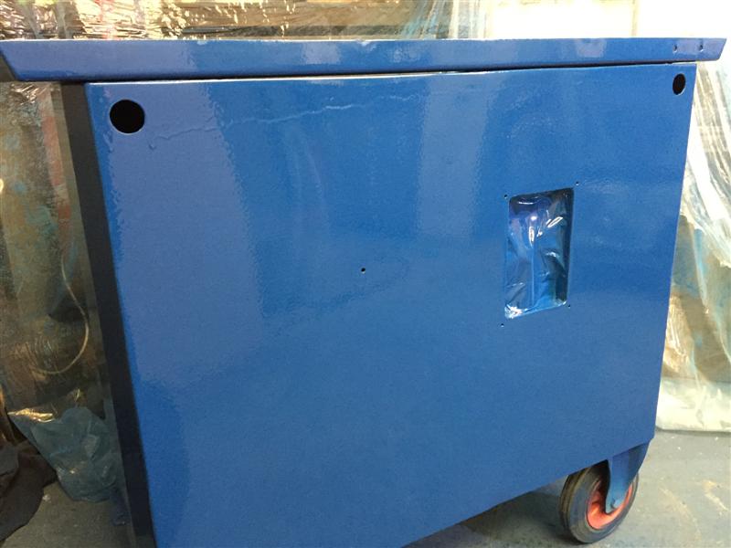

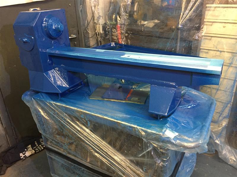

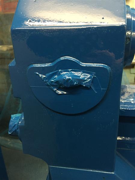

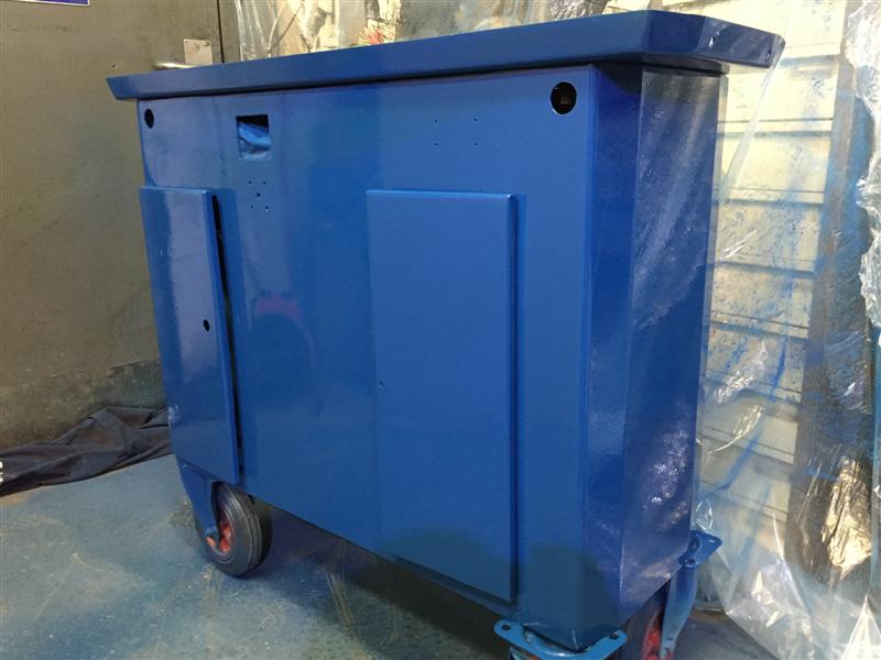

not good then, the primer didn't work at all and would have probably flaked at a later dateYeah scraped the lot.
it shouldn't have come off that easy thoughI don't think the paint exists that can resist this scraper
I suppose there is only so much grip with paint and easier to scrape heavier steel as its solid and doesn't flex, I wouldn't use the same primer again thoughPerhaps no, but that might have been down to the temperature same as the epoxy foul-up.
I've yet to find a paint I couldn't scrape off though, I use a 20mm wide solid carbide flat scraper. The original paint from the 60's didn't put up much of a fight though the red oxide primer was marginally more resistant. I also scraped 3 layers of paint off my 1942 lathe including the original crinkle black undercoat. God knows what chemicals they put in that stuff but it came off all the same.
