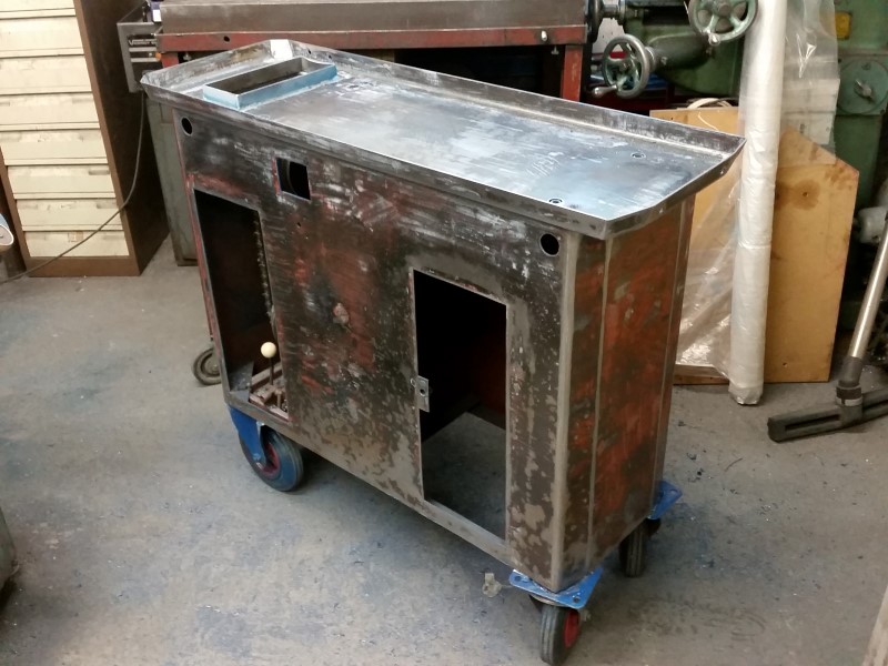

I wouldn't be surprised if they are both the same product, just rebadged and a generic epoxy paint.
I gave a mate a load of left over corocoat epoxy which he used to paint his floor.
Also heat your paint up so that it will be thinner and atomize better, stand it in a bucket of hot water for 20mins before you mix it.
Mixing
Mix at a ratio of 4 parts Two Pack Epoxy base to 1 part Two Pack Epoxy Curing Agent by volume.
Mix well and allow to stand for 5 – 10 minutes before use.
If addition of some thinner is required, this should only be made after the paint has been catalysed.
.......At least if the pot blows up you'll have a nicely painted microwave interior!
Straight on with the epoxy or are you doing primer first?
did you simply scrape it, no heat or chemicals ?I haven't made my mind up yet. When scraping the paint off there wasn't one bit of paint that left the primer behind, which says that the epoxy stuck to the primer much better than the primer stuck to the metal. It wasn't some cheapo crap either it was upol #8 acid etch.
