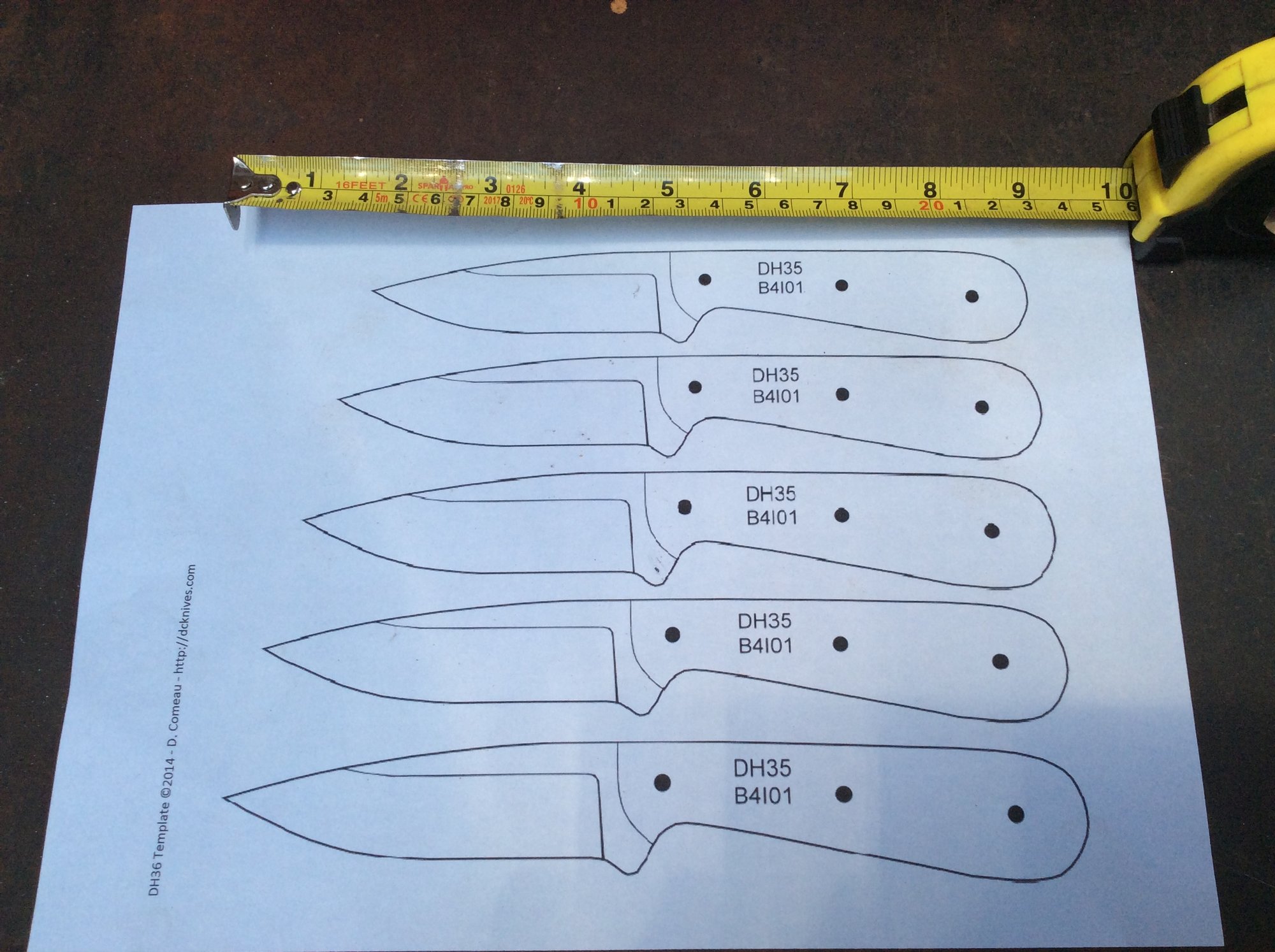

. Bevel is 13mm from the edge. Not sure wether to do a Scandi grind or put a second bevel on it. One thing I do know, I need some decent files and possibly a bench grinder with a linisher attached. What’s a decent brand of flat files? Hers some pics of tonight’s progress and the templates

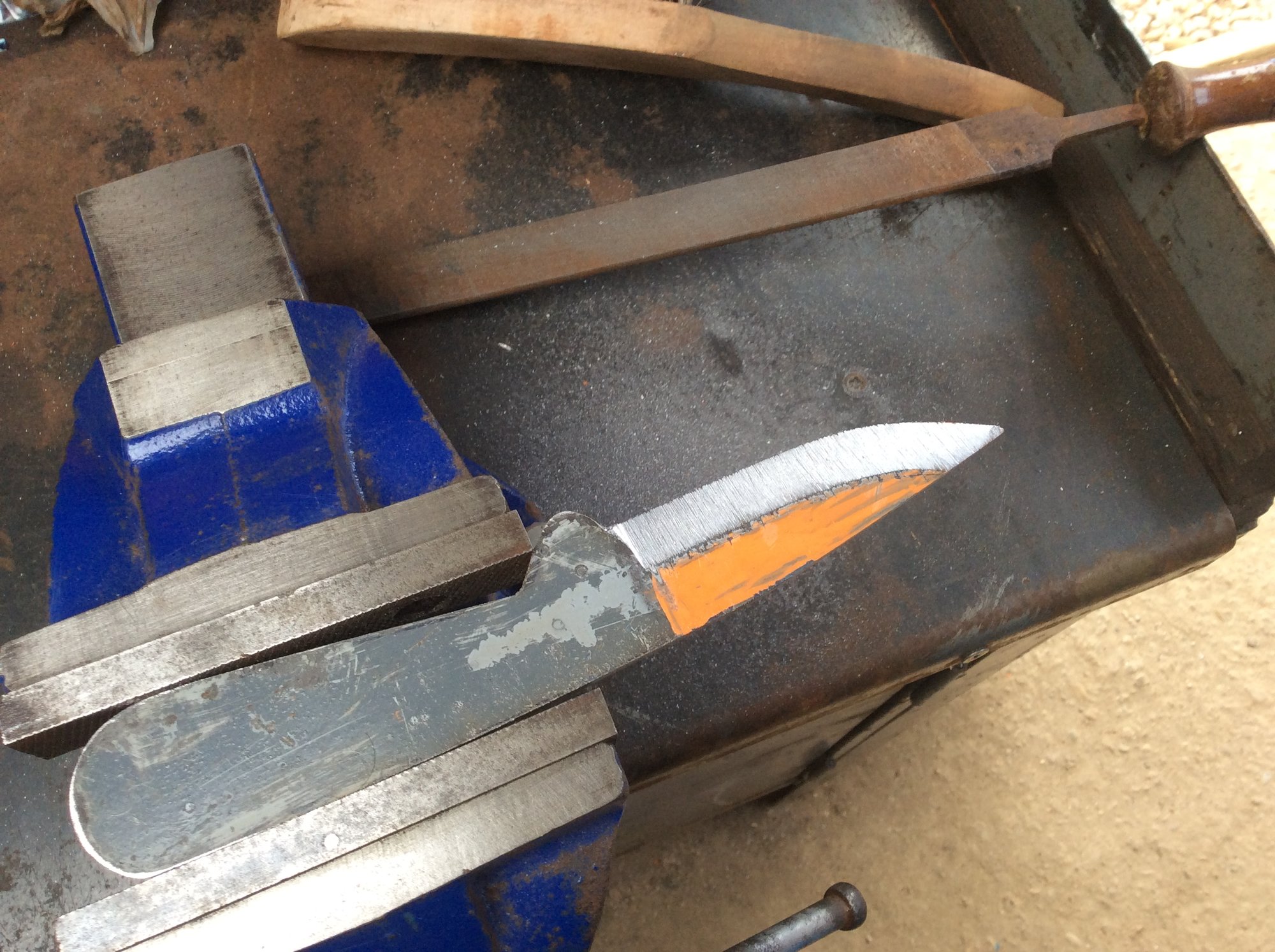

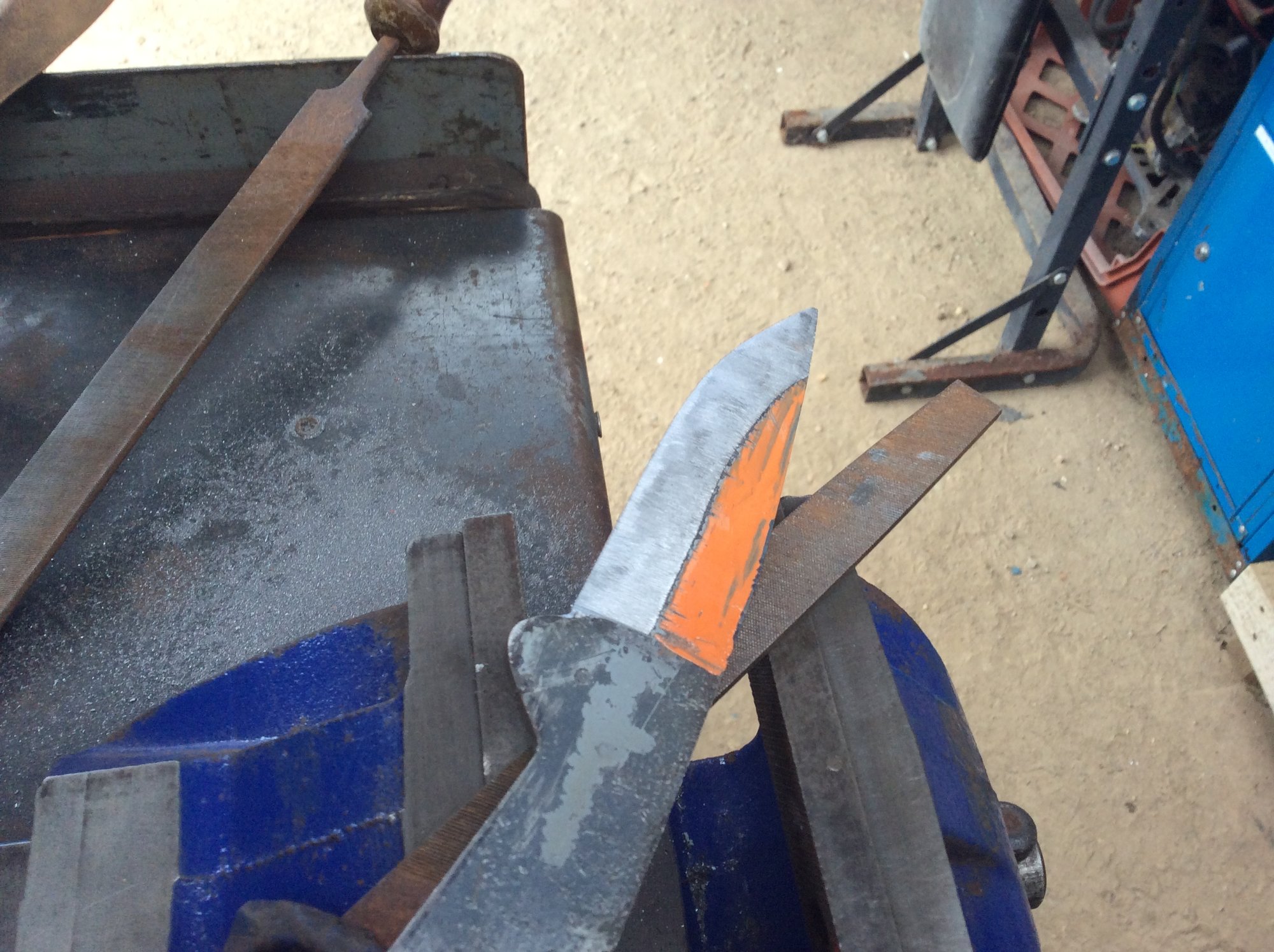

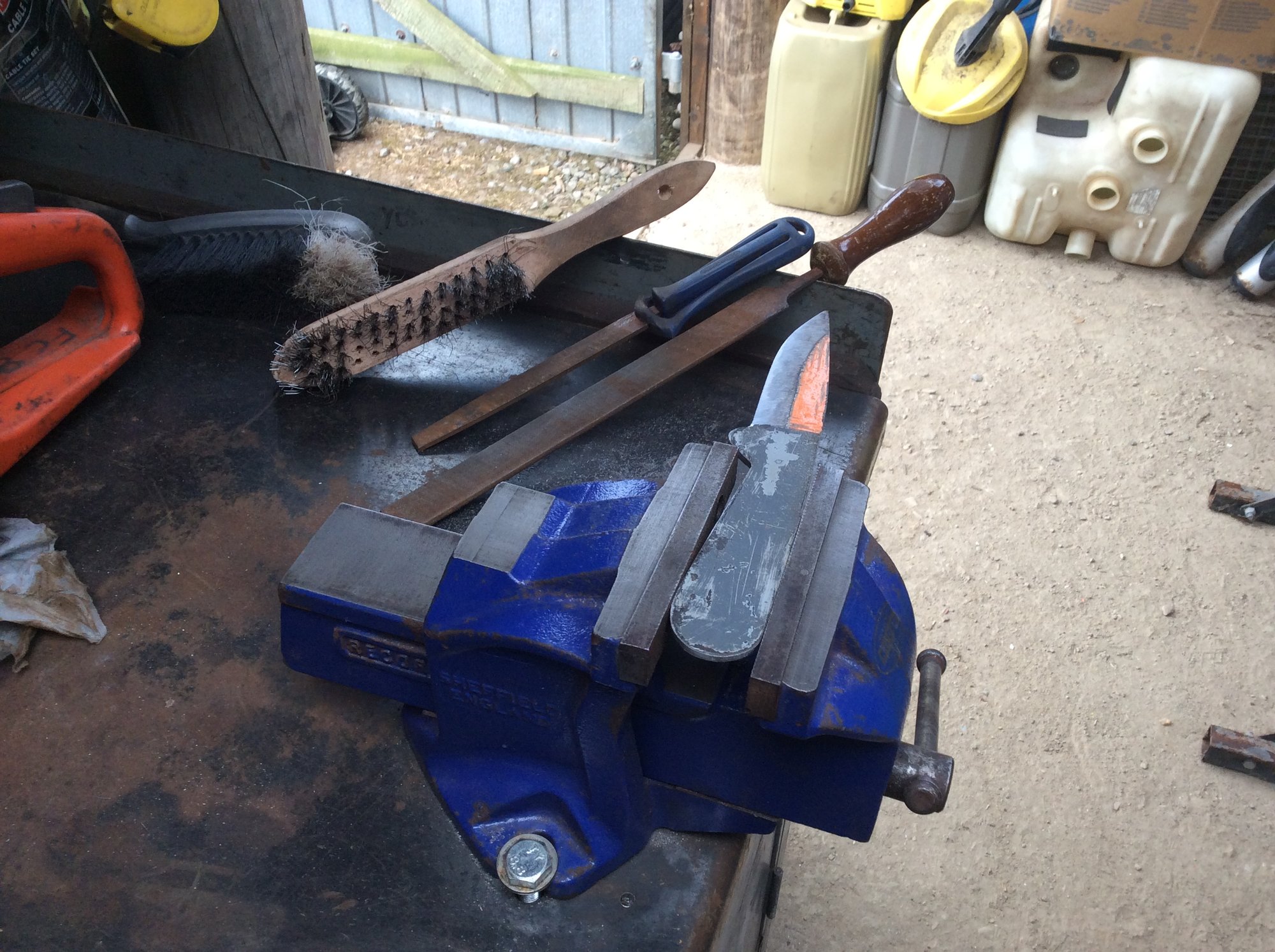

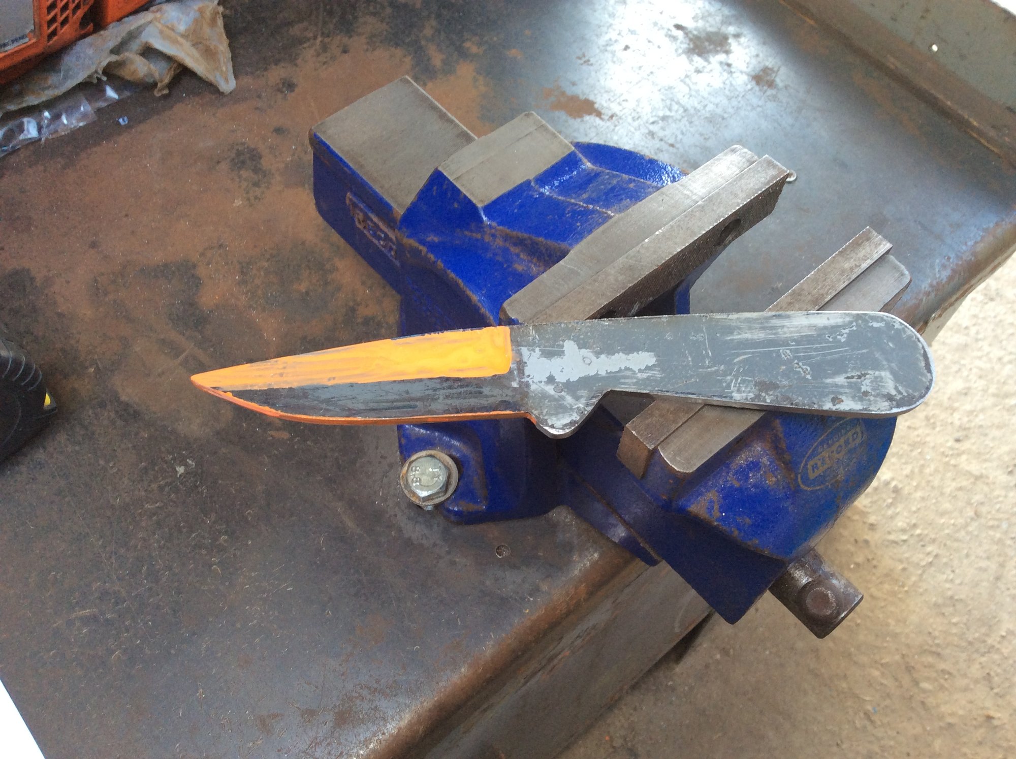

Got 10 minutes spare tonight. No engineers blue here, just one of those paint pens! Did the job and looks cool. Bevel is 13mm from the edge. Not sure wether to do a Scandi grind or put a second bevel on it. One thing I do know, I need some decent files and possibly a bench grinder with a linisher attached. What’s a decent brand of flat files? Hers some pics of tonight’s progress and the templates

Tough durable edge: Scandi, sharp fragile edge: secondary bevel. Depends as much on what the material is as it does the intended purpose.
