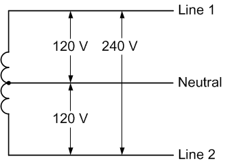

This is the way I see it as regards the US and UK
the first drawing is US household

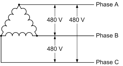

the second is US light ind

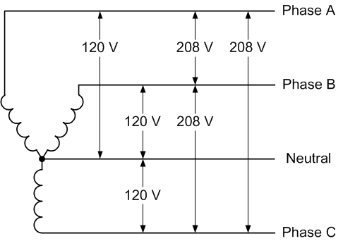

the third is US heavy ind AND UK but should be 415 not 480
so the welder can be wired to suit either the second without the neutral or third but in UK it should ONLY be wired as per the THIRD method
PS dont know why there is a four image. I was trying to find an image with 415 between phases
Also known as an Edison system, split-phase or center-tapped neutral. This is the most common residential service in North America. Line 1 to neutral and Line 2 to neutral are used to power 120 volt lighting and plug loads. Line 1 to Line 2 is used to power 240 volt single phase loads such as a water heater, electric range, or air conditioner.
The most common commercial building electric service in North America is 120/208 volt wye, which is used to power 120 volt plug loads, lighting, and smaller HVAC systems. In larger facilities the voltage is 277/480 volt and used to power single phase 277 volt lighting and larger HVAC loads. In western Canada 347/600V is common.Used primarily in industrial facilities to provide power for three-phase motor loads, and in utility power distribution applications. Nominal service voltages of 240, 400, 480, 600, and higher are typica
