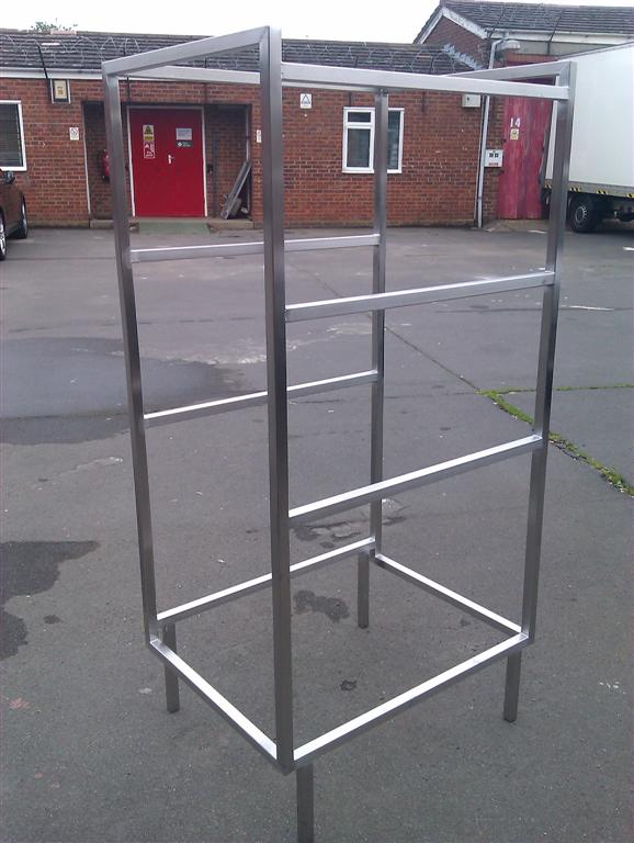

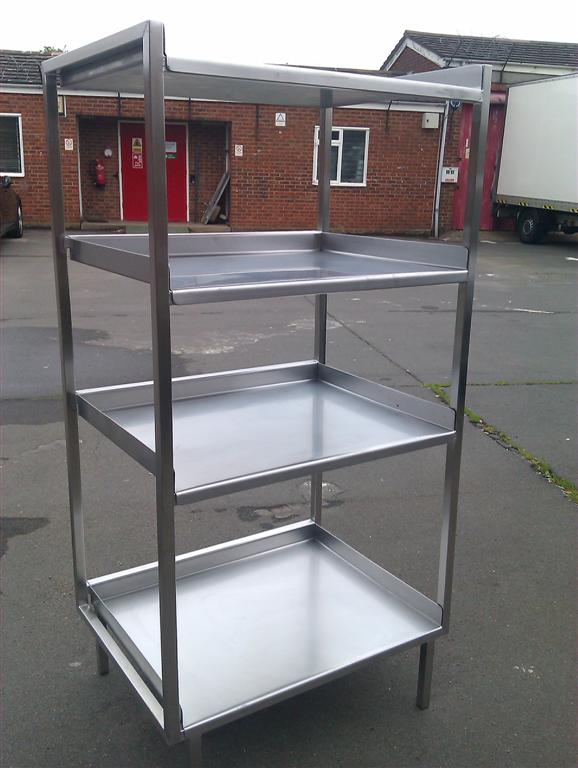

Whats with the feet/leg arrangement Paul?

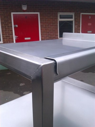

I dont Know how you clean your corners up but if you were to clean with the grain one way then place a piece of masking tap across you can clean up the other way with out ruining the grain.
