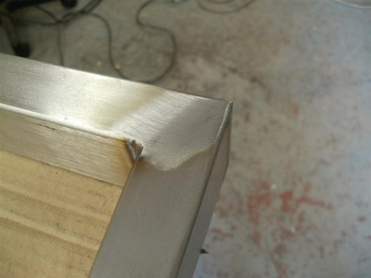

I was asked by a member a week or so ago how to finish a corner joint in stainless box section, this week I have been making a batch of brackets using mitred joints, so here's how its done.

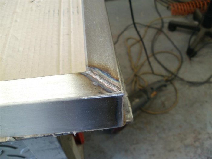

First the weld, appearance doesn't matter its all coming off, but it does need to be full profile with no undercut or shallow points

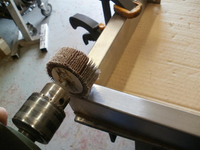

Take the top off using a flap disc, be careful not to dig in, 80 grit used here, if you have trouble with digging in try using a fibre disk with backing pad instead, flap disks are great things but not always the only tool for the job

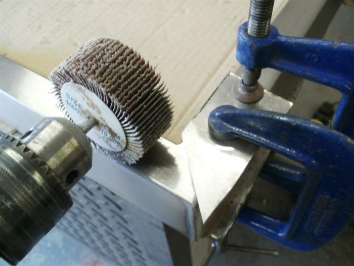

Then using a 60 grit flap wheel reinstate the brushed effect being careful to keep the grain straight, I'm using a drill rather than a die grinder because you can use 2 hands and lean on it

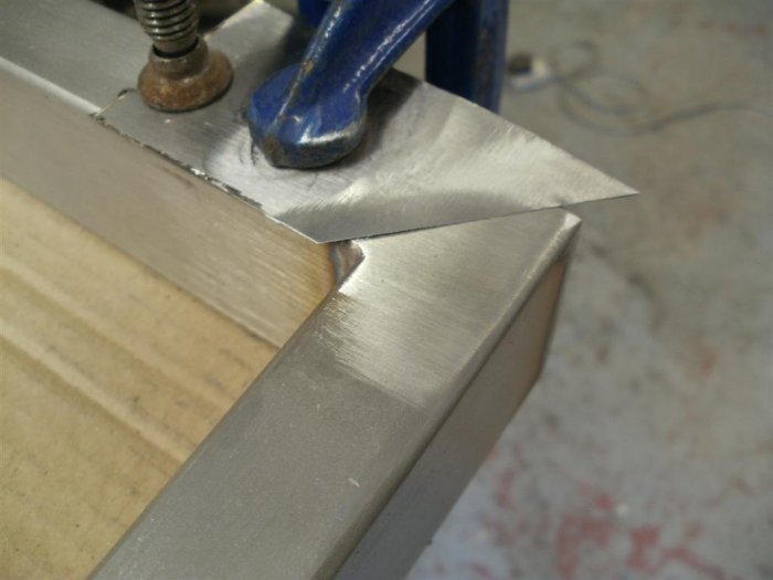

Then using a thin piece of stainless, this is .6mm, mask off half of the joint, set the edge just behind the actual centre
Run the flap wheel straight across the mask, the thinner the mask the easier it is to define a line, it will wear after a few joints so just trim it up with snips, they get very sharp too so watch your fingers

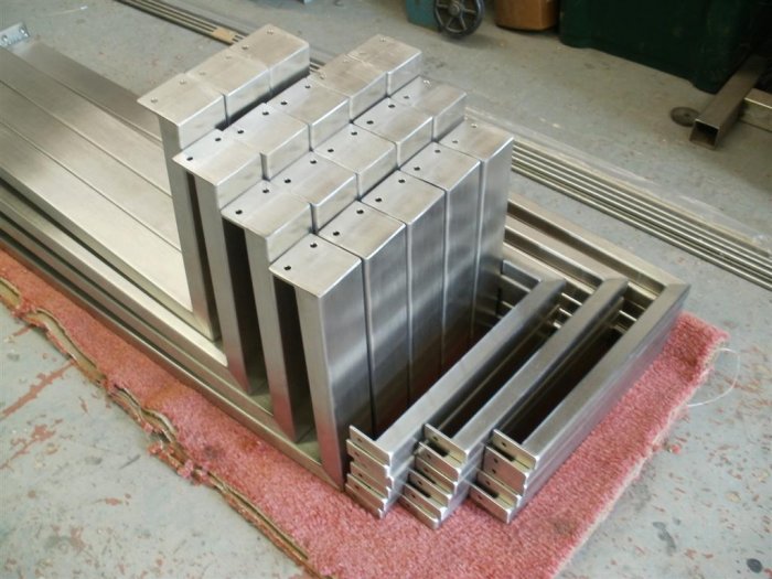

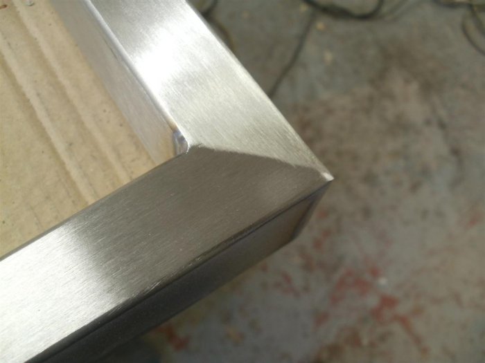

And what it should look like,

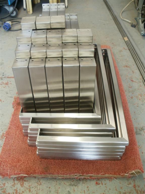

Got plenty of practice on this job, the outer faces were cleaned up with a flap wheel on the bench polisher, and the inside by hand using garryson abrasive blocks and scotchbrite
