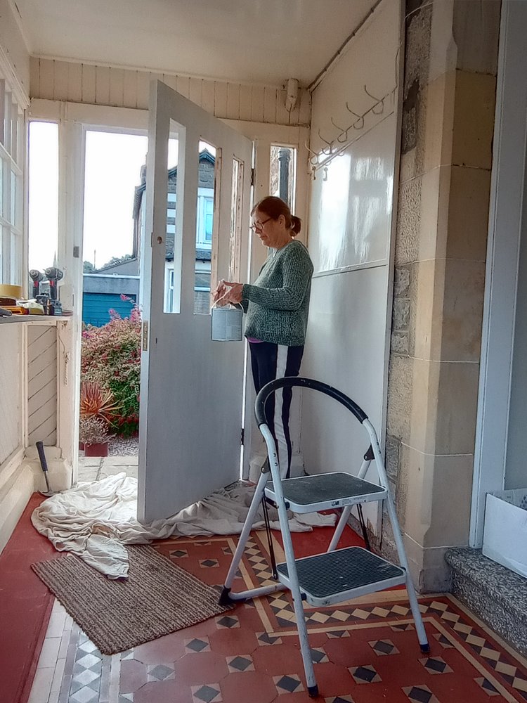

Mrs normally does all the wood painting, but she was out! Thought about braking out a roller.You not got a wider brush....![]()

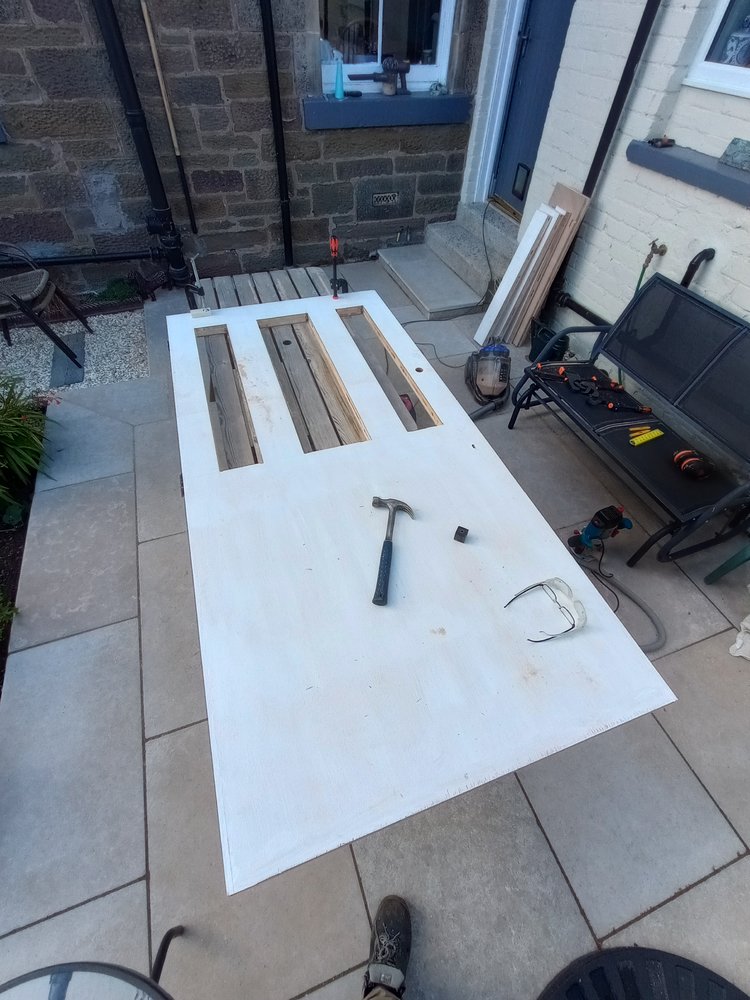

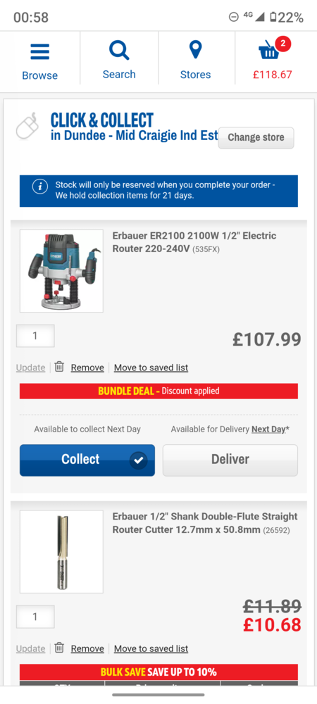

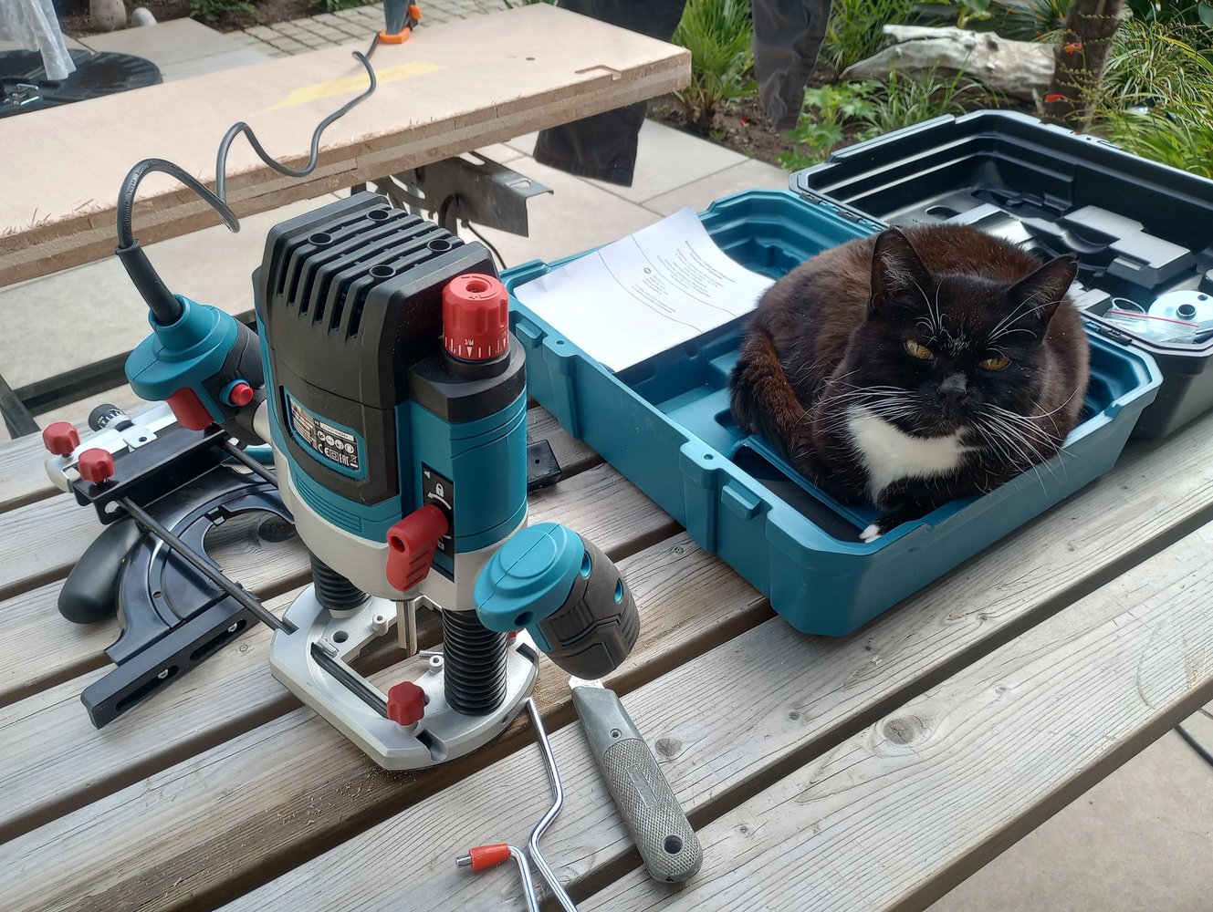

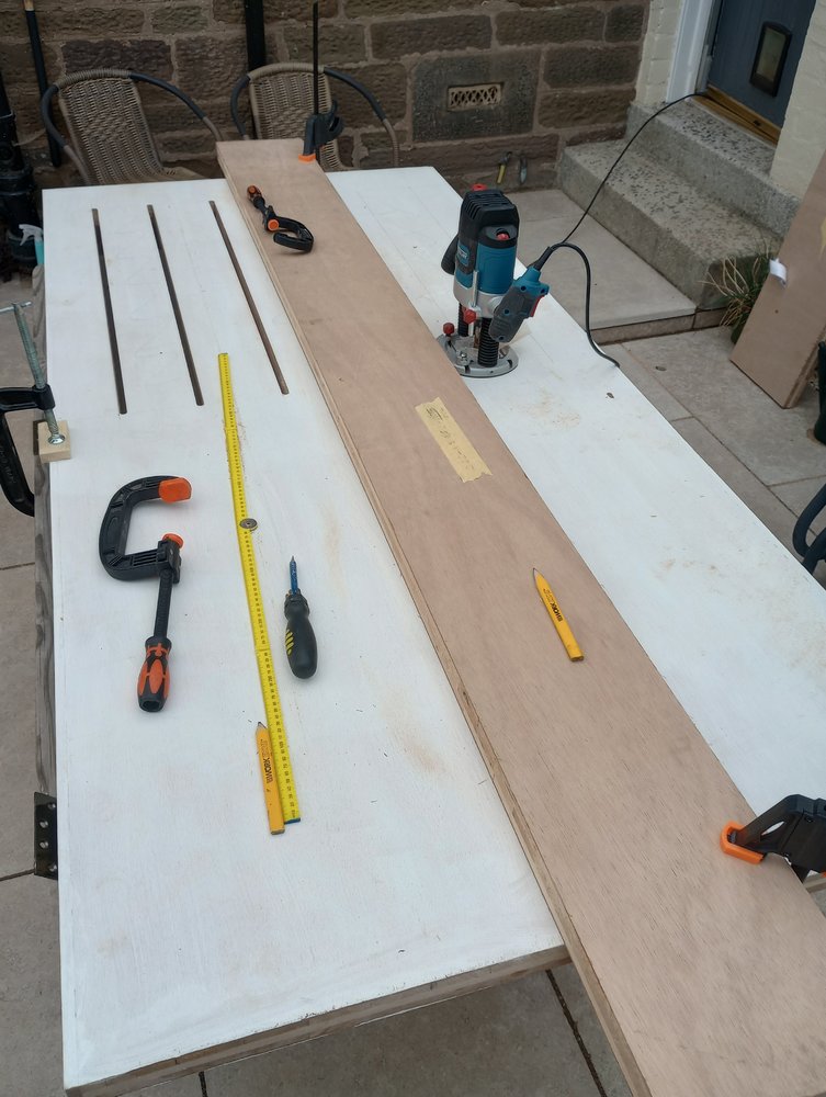

a bit of advice use your circular saw to cut the windows out and finish off using the wood saw, use the router with a straight edge to trim out the top of the windowsI was planning to use my 1/4 inch router to cut the three window openings but can't find any 1/4 inch straight flutes that are 44mm deep.
Looks like I will need to buy a 1/2 inch router to get the flute length I need.
Like this.
I don't want to use a jig saw as I never get good perfectly vertical cuts with them and the plunge/circular saw is not really suited.
Any thoughts on using the 1/2 inch router or some other method?
