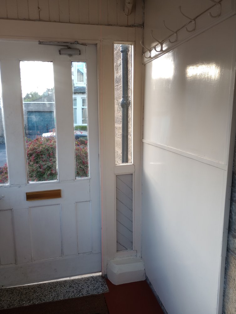

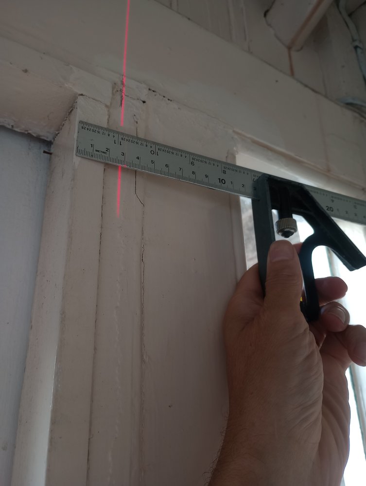

I need to square up my door frame before making and fitting a new door. It's got a bad lean you can see from the laser line.

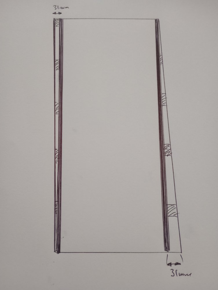

About 30/31mm out on both sides.
My old man says easy, put in a new frame and fix in place with packing pieces like this. Then put fascias on both sides to hide the gaps.
Since I don't think new facias on the outside of the frame will look good, my thoughts were to try to make a wedge out of a 94x44 to straighten the frame and fill the gap. But cutting this long wedge will not be easy, 44mm at one end and 15mm at the other, 94 deep.
Any other ideas?
