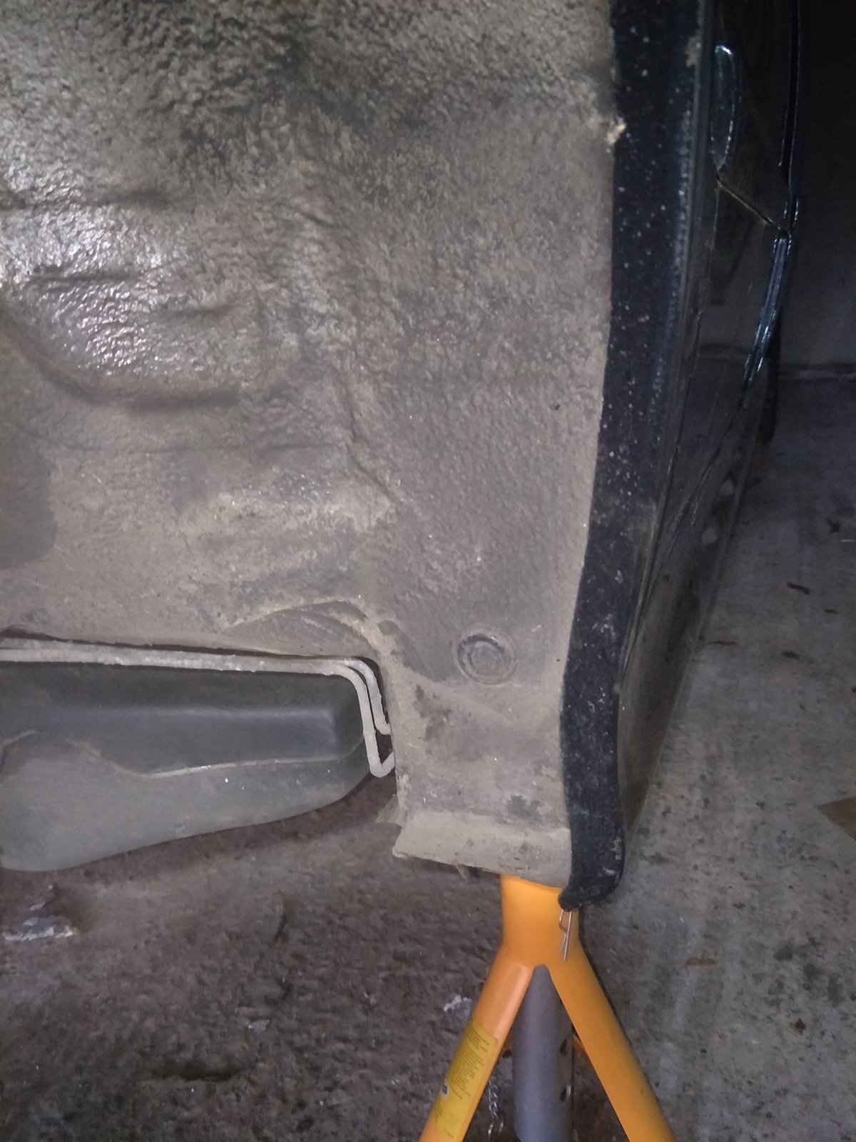

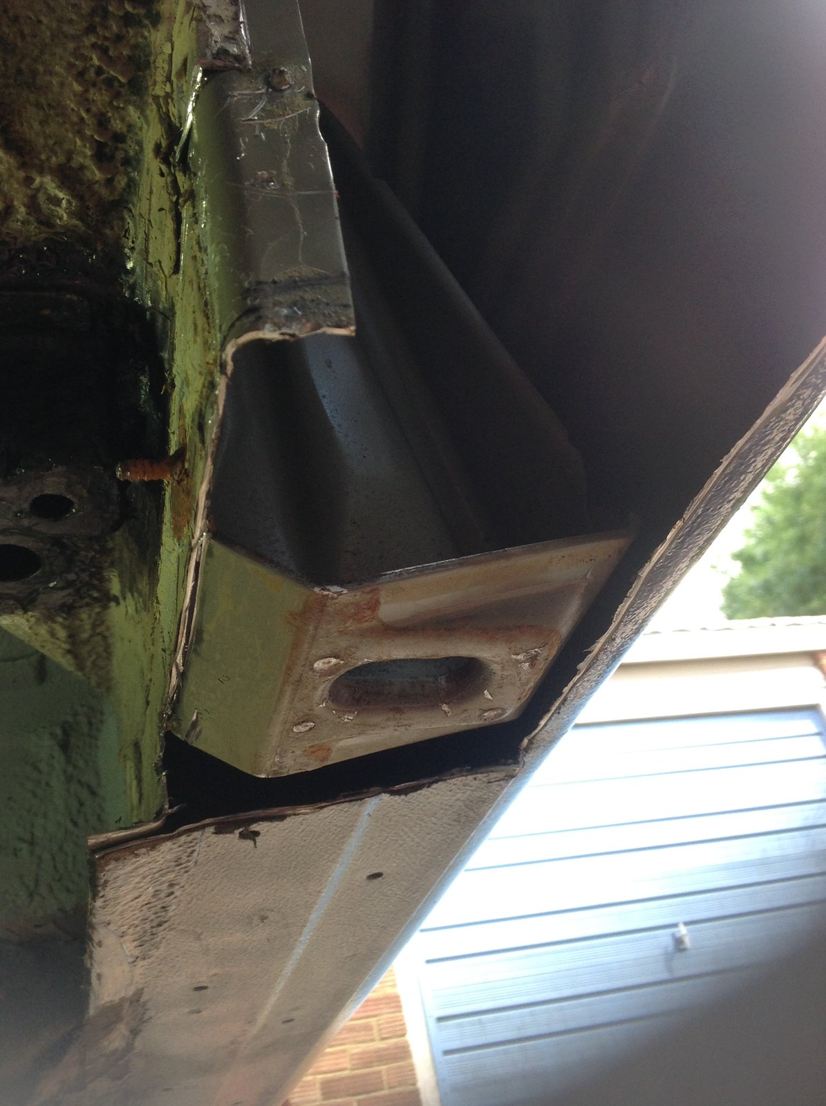

    Hello.
    .i have discovered some rust damage on My BMW E39 at the rear of the sills where it meets arches plz see pic.. i was tempted to tackle it myself but then i thought i ll see if i can get a pro to do it . Unfortunately most welders dont seem to want to do a small patch, most want restoration work and big jobs, so i am again left with no option but to tackle it myself.
    I can put the car on axle stands high enough but i am not very familiar with upside down welding, certainly never has to spot weld underneath a car either.
    Any leads and advice very welcome.

    You're going to have to strip out anything remotely combustible from above the area [+ a bit], or have a fire watcher on hand, so you might as well weld from above in that case.
    It'll help [maybe] to make templates before you start in with the grinder. Check carefully when you've cut out ALL the metal back to sound that the rust doesn't extend as far as the jacking point.
    I'm sure others with 'Australian' welding experience ;) :D will be along to help and advise.

    It is not very far from fuel tank which is behind rust affected area. I am planning to leave the tank alone as it is a big job to remove especially when working outside on axle stands but I will remove all that Underseal and paint with a grinder before cutting it out and have the wife around as watcher.
    The rust doesn't extend to the jack points and the weakened rotten metal is just around that hole...

    What you see there is brake lines and they are well away from my rusty patch.
    I had a look inside that box section with my endoscope and there is nothing inside and there is no need to chop all that box section, i will drill out any spot welds, make a surface cut and remove first layer and see what i have got.

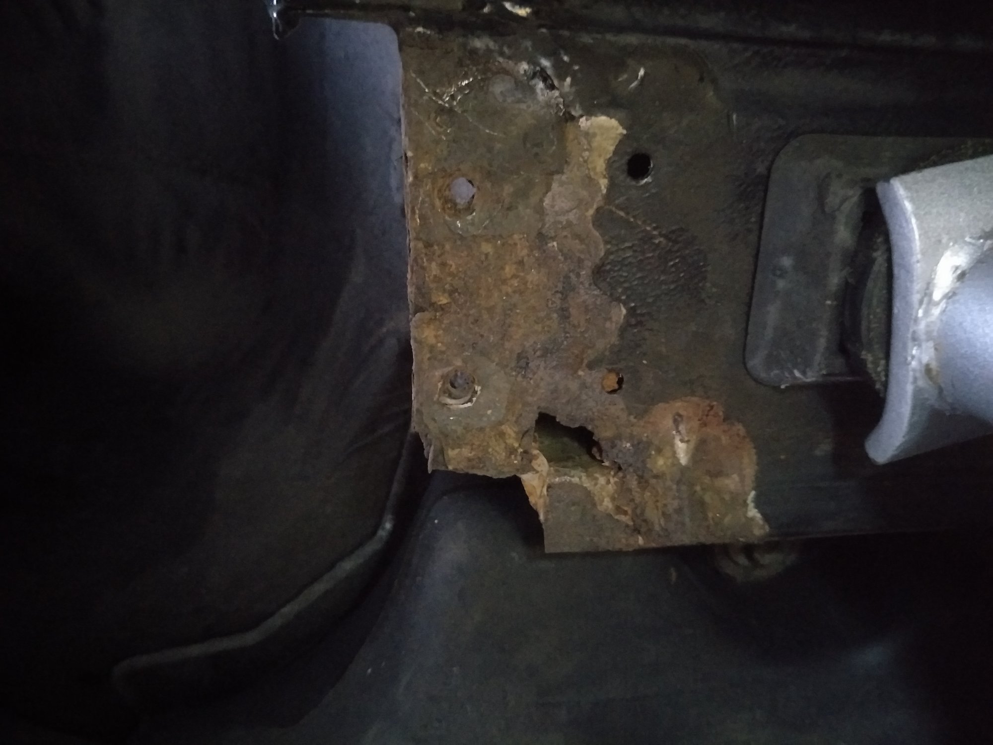

    I cleaned the wheel arches today and i am going to tackle this rust soon if health permits.
    Like you guys said i will strip anything remotely combustible and i will put a fire blanket between tank and sill, i will also invest in a powder fire extinguisher .
    This rusty area is made out of two pieces spot welded together and i have to drill out the spot welds before trying to cut the outer skin , hopefully i can manage that without cutting the inner skin too.After that I will inspect the inner skin for any rust which i will wire brush then use rust remover few times untill metal is clean, then weld through primer to protect the inner skin, the fabricate and hopefully weld it, any reapir i will do is better than rust and rot.

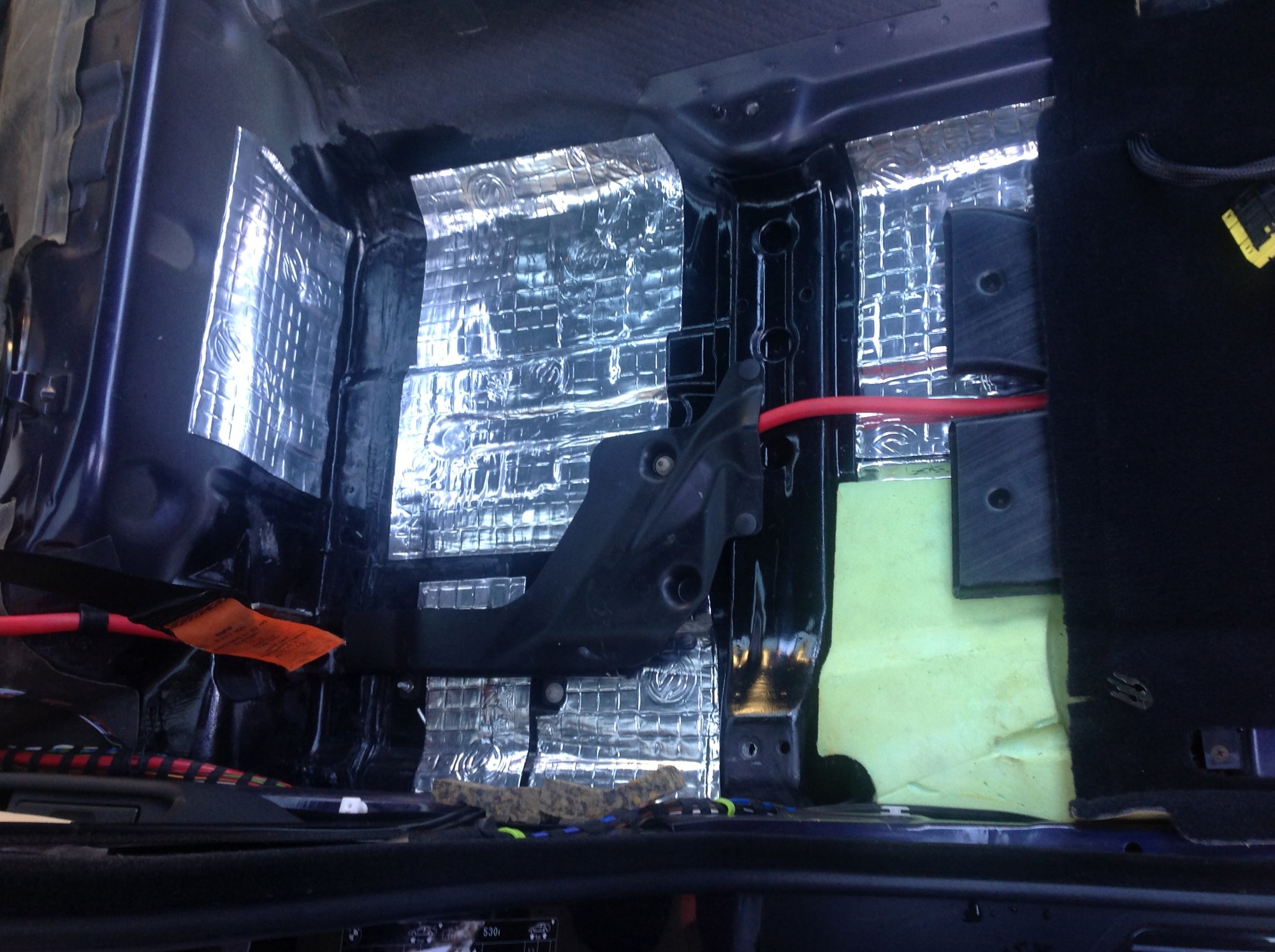

    Did this exact repair on my e39
    http://www.mig-welding.co.uk/forum/threads/an-e39-bmw-530i-with-rusty-floors.67914/
    Drop me a pm if you want any pointers!
    I did it the "hard" way and dropped the tank, although think it was easier in the long run than working round it.
    That sill closing panel is about £12 from BMW, I'll find the part number if you want.
    It's an empty void behind the panel although there is a wiring loom under the carpet not far away.

    Can anyone help with the correct technique for plug welding upside down underneath a car?
    I shopped out the rusty metal and luckily the bottom skin is intact with any surface rust removed with acid all looks clean, it ll get a coating of weld through zinc primer before the top skin patch is welded on.
    Wanted to take some pictures but was getting dark, will update soon.
