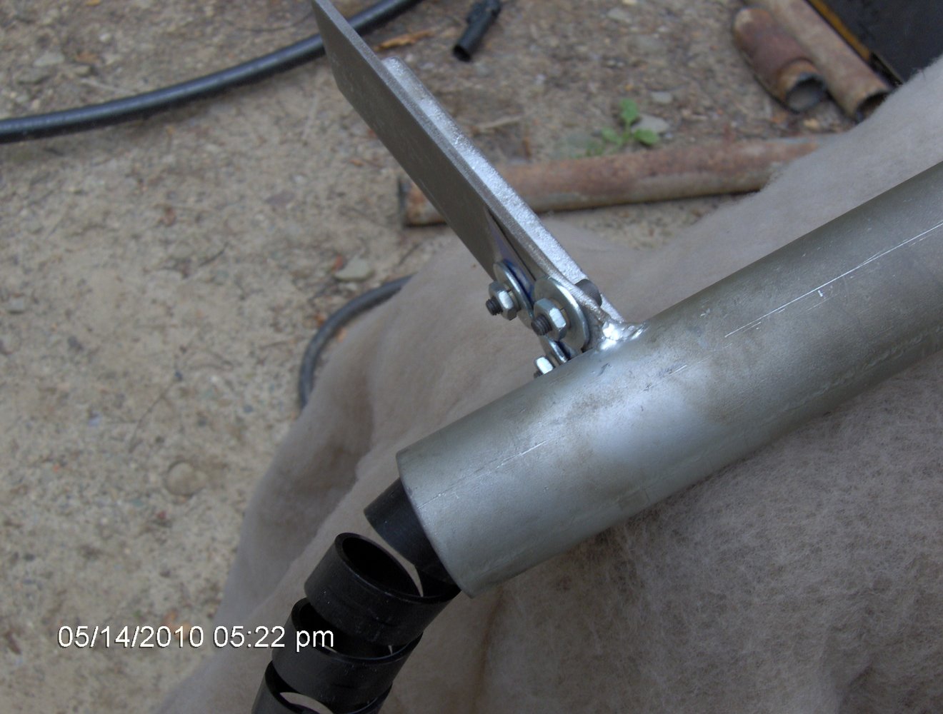

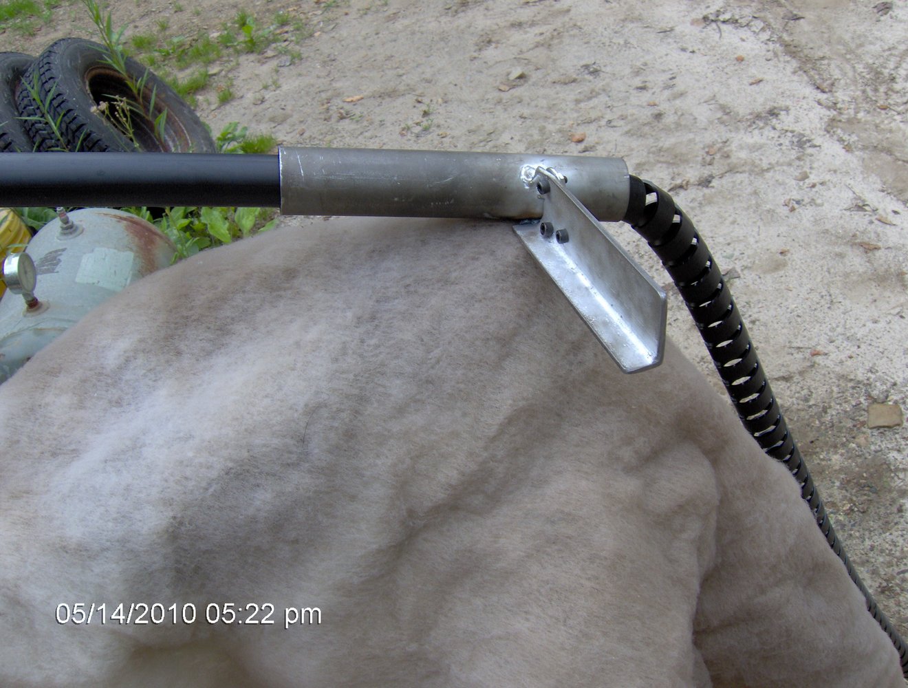

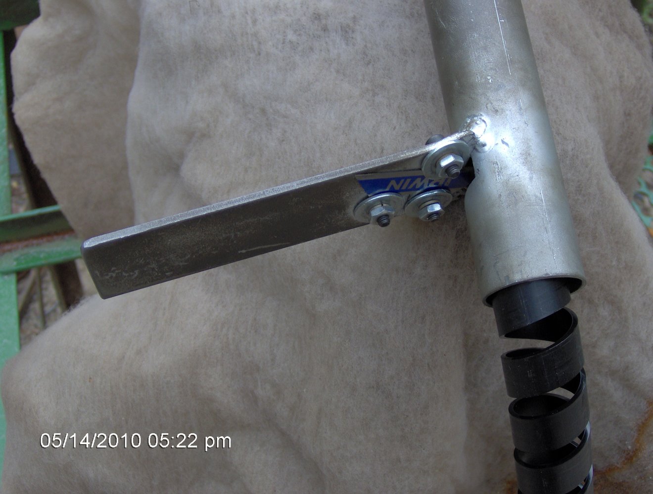

I made a simple cutter with a utility knife blade to spiral cut PEX water tubing, always have scraps of that laying around.
This is the one for 3/4" and I used 3/4" EMT conduit, I later made one for 1/2" as well.
View attachment 397449View attachment 397450
That's really neat!I made a simple cutter with a utility knife blade to spiral cut PEX water tubing, always have scraps of that laying around.
