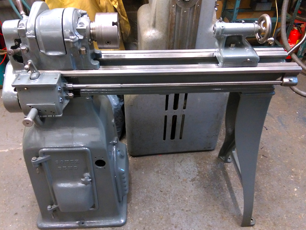

it has what's called a 'war finish' which means that the machine was made to the same standard as any other except they didn't waste time on the cosmetic details.
What paint did you use Pete? It looks really good in your photos.
It is going to make a very nice lathe.

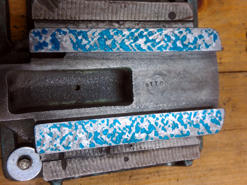

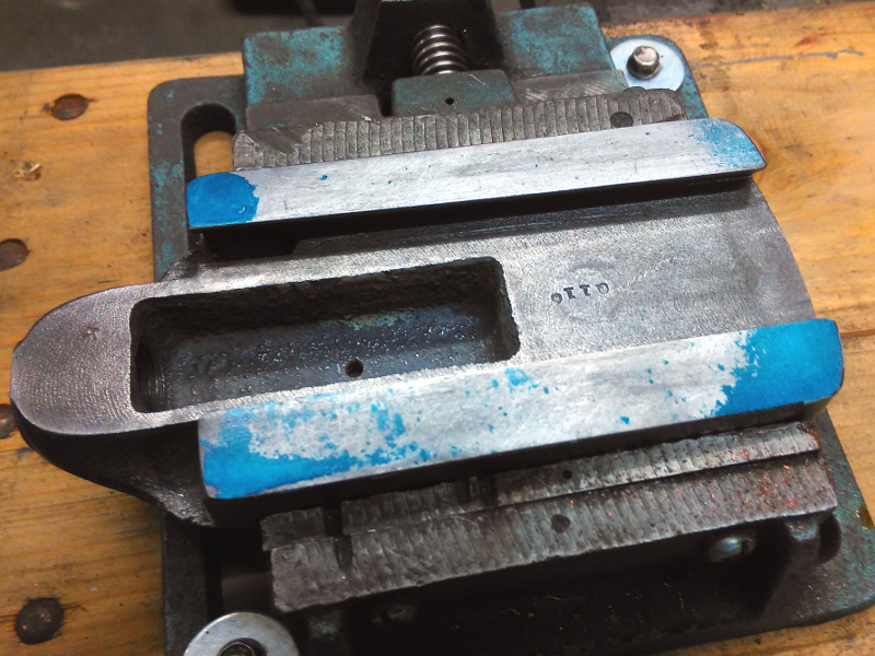

That's the same as what I have to do on mine. Strip. Clean. Scrape .Cheers Matt!

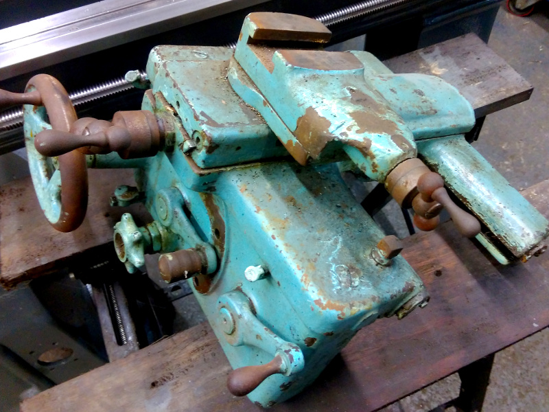

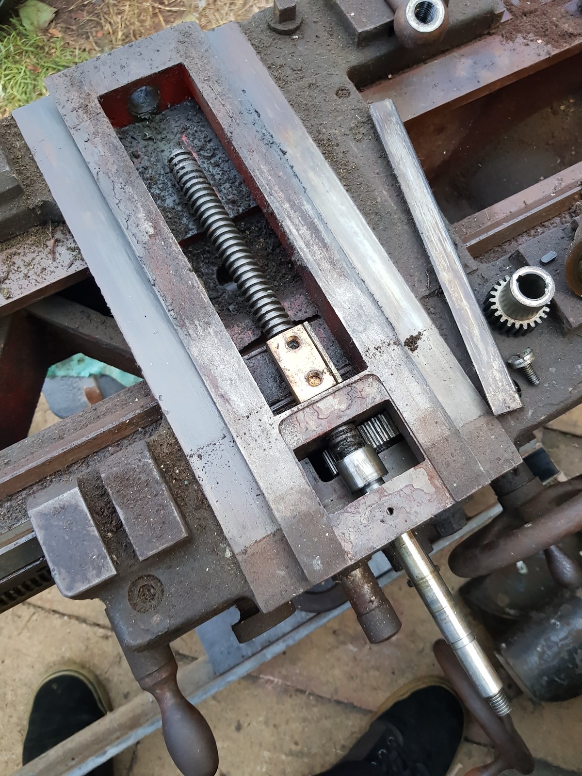

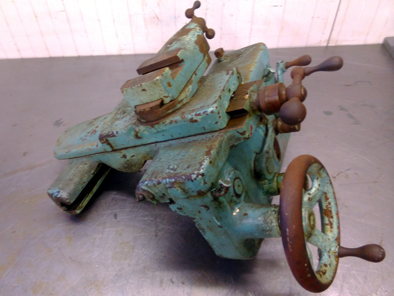

So what's left to do is all the drivetrain in the cabinet, electrics, try to find (or make) a belt tensioning handle, and the biggest job - this!

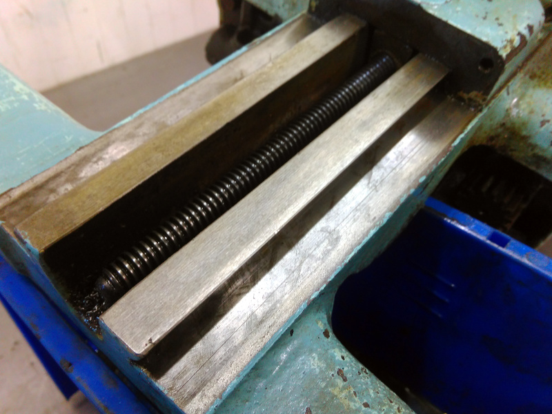

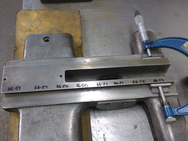

The whole lot is getting stripped, serviced and scraped then rebuilt with new wipers. Despite the rough appearance it's all actually in great condition. Apart from the scraping I might convert the dials to the bigger type, and perhaps make them diameter-reading instead of radius. I'll have to see about that.
Nice to see that it's not overly worn
