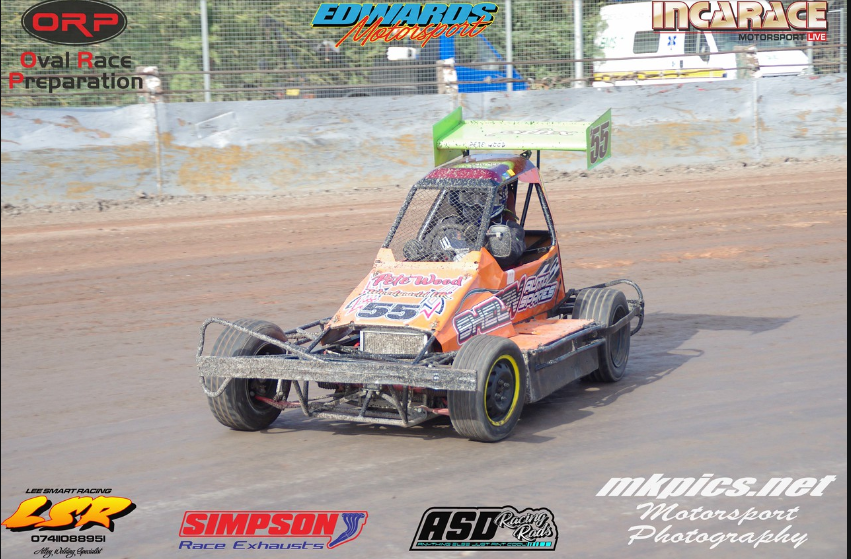

    Had a nightmare with the car just as we thought we were sorted - the car ran fine when fired up - but then the intermittent starting reared it's head again - with sudden random engine stops for no apparent reason, but only when idling - been tracking that down again over a lot of wasted weekends.
    Finally traced it down to what we thought was the alternator or the ballast, so I pulled the loom apart and added a larger ballast to the field coil, no difference, bought a new alternator in case that was a duff one - no difference.
    Take alternator off, starts fine.
    Much head scratching.
    Turns out the alternators we were getting from the local supplier (an electrical specialist, not just a factors) - were basically noisy as hell when they were trying to get to the right voltage at low rpms (i,e - startup only) - a cap in the line doesn't fix it, some shielding might but we've just sacked it off and got a different type of alternator instead, need to alter things to get that to fit properly again now, but after rigging it up today it's purring like a kitten. Need to retime it now though as not certain it was 100% before as it idles smoother now.
    It never rains, it pours!
    On the upside, I was rebuilding some other dampers* so I rebuilt/revalved the rears on ours to suit the new arms and bled them, so that's one more job off the list and ready to go - although I have just acquired some new go faster parts to machine and fit - I got told these were top secret so...there we go:
    [​IMG]
    It's all very well getting shiny adjustable parts for your dampers but then you have to spend hours modelling the damned things - nearly there, housings next.
    These are high and low speed compression adjusters, that hopefully with a bit of work on my side will be adaptable enough to use both on the small fronts and large rear dampers...hopefully.
    [​IMG]
    [​IMG]
    If it works they'll end up costing us about 1/3rd of what it would to buy the kits you can get for the Fox dampers, and these will fit the fronts too which the kits don't.
    *Might put some pictures up later if someone wants to see just how much damage some debris in a damper can cause...
