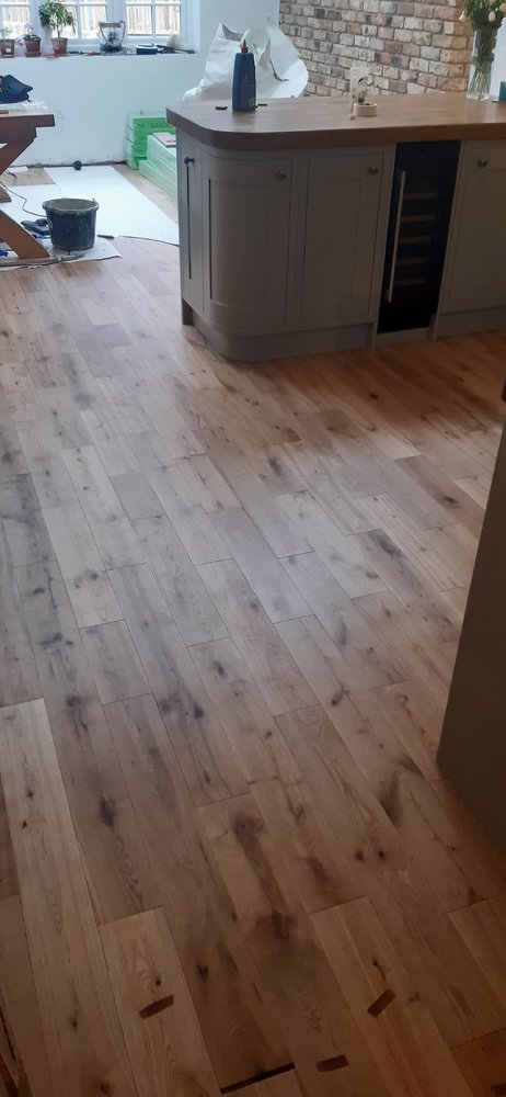

Might be lucky. If not. Get grading.
Match up sizes and keep em to each run.

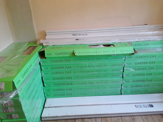

If all the short planks are narrow then your in with a good chance of getting your money backProblem is that 38 packs (out of 53) are the same batch! It's all the short planks that are too narrow so unless I have a full run along the walls in short planks I'm fooked!

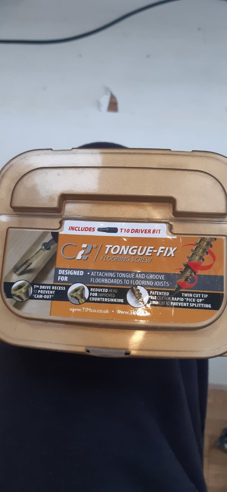

i tell punters its not a good idea to glue them down if theres electrical joints and central; heating pipes underneathTongue Tite screws, Found them after some searching and they look very promising
I can buy them in 35mm so there's no risk of going through any services below the floorboards! And they're removable if ever I need to get under the floors again. It's probably the sparks in me that does not like not being able to get under the floor in the future, most people don't think further ahead than next week with things like that!
Done.
Yeah, that's them. Mine don't go right through the floor, and as you say can be lifted should there be a problem underneath.Tongue Tite screws, Found them after some searching and they look very promising
Update. After lots of emails and being fobbed off by Wickes they finally agreed to swap the whole lot for new packs all from the same batch.
